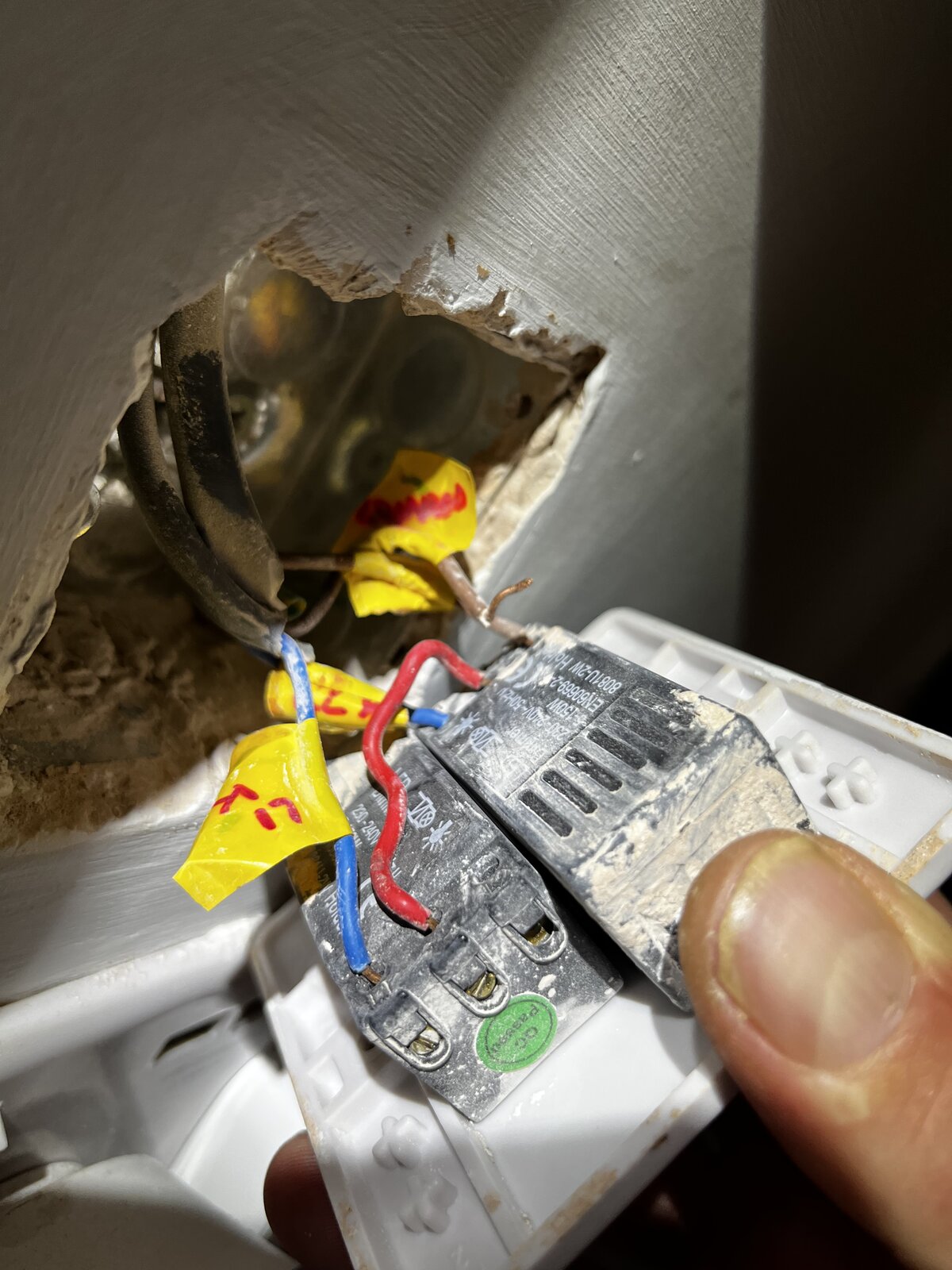

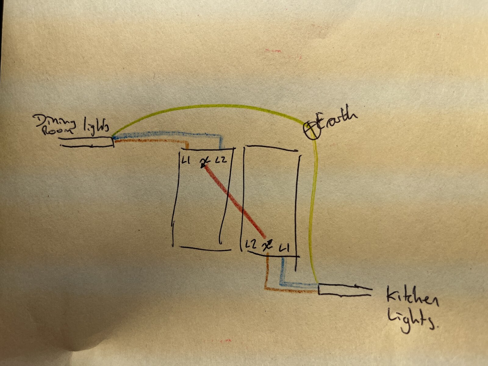

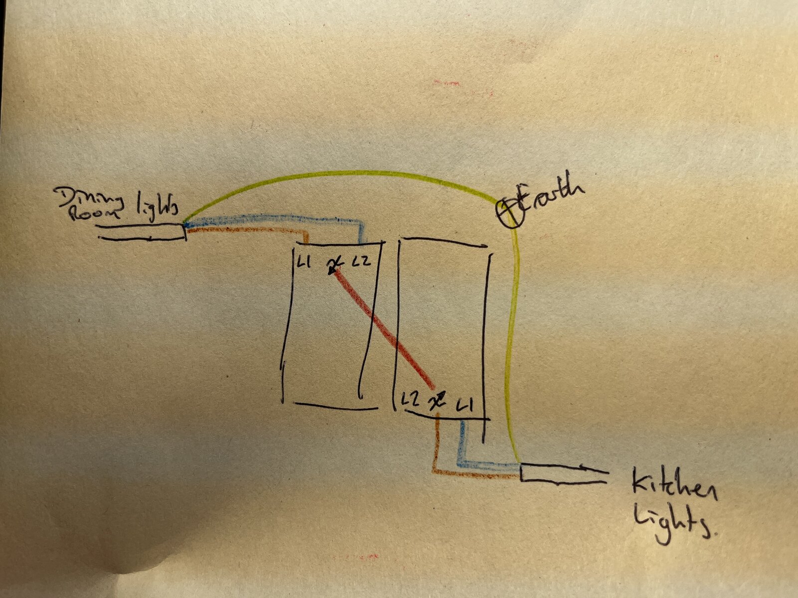

Hi, I’d like to swap a double dimmer which controls kitchen lights & dining rooms lights.
How do I wire this up?
Below is my rudimentary wiring diagram.. apologies!

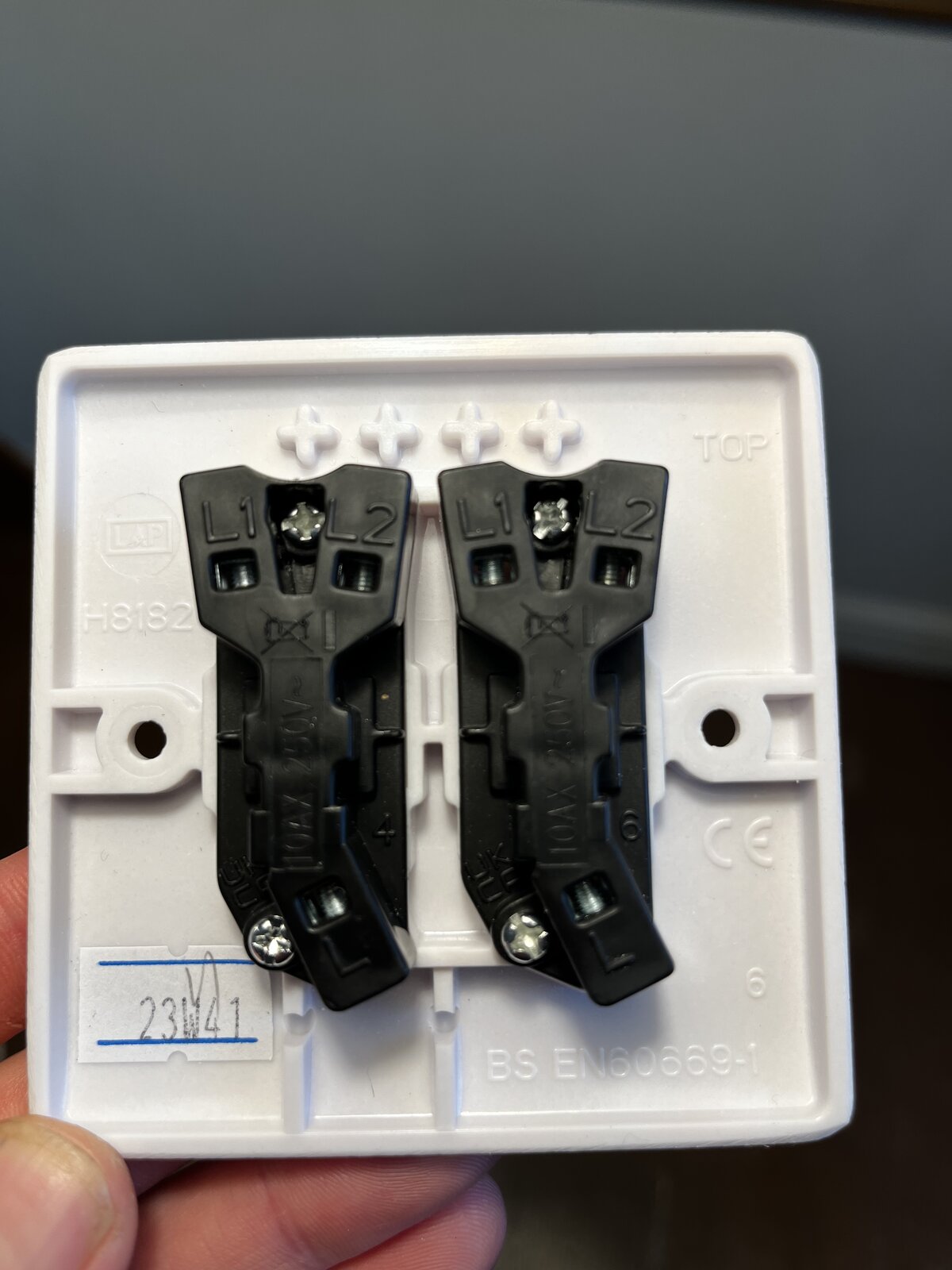

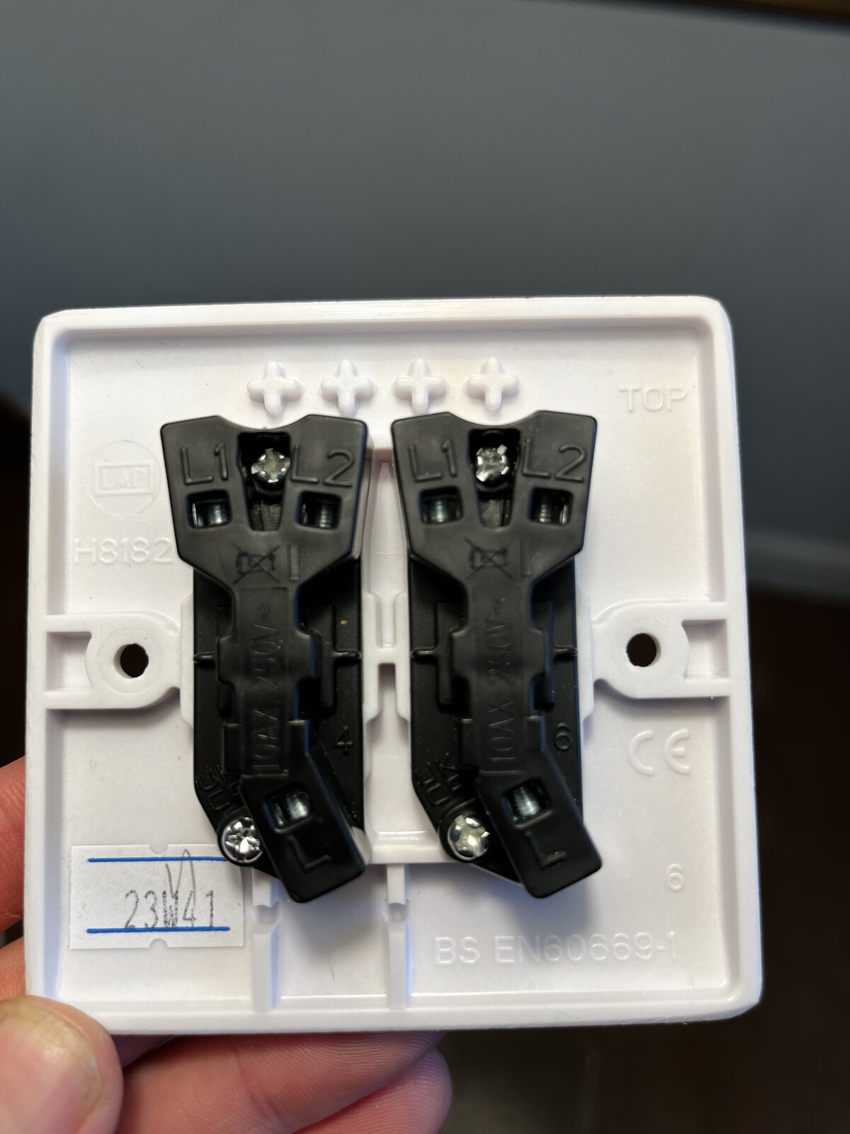

The new double switch is pictured below.
Many thanks.

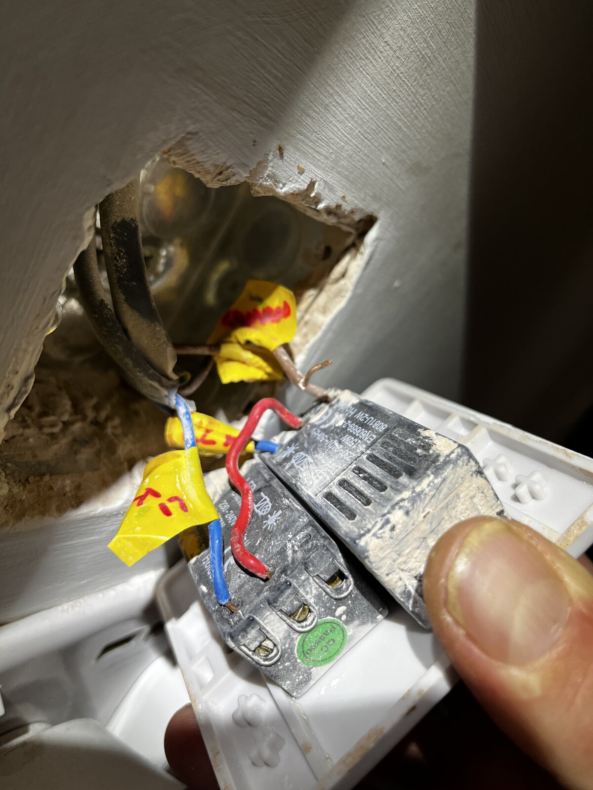

Have you got a picture of how the dimmer modules are connected now?
The loose brown wire has come out of the common terminal in the image above
Same as before, only difference is wavy line on old switches = L on the new ones.
L1 / L2 are the same.
