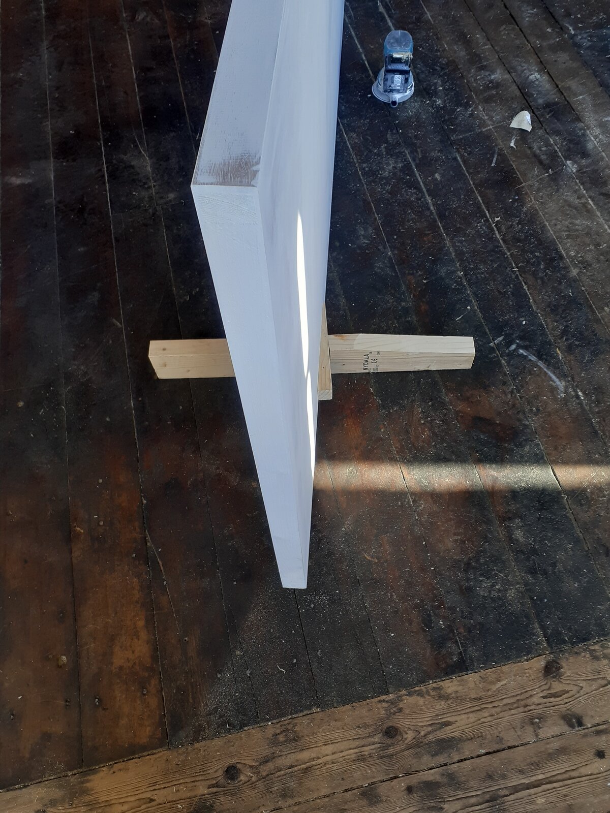

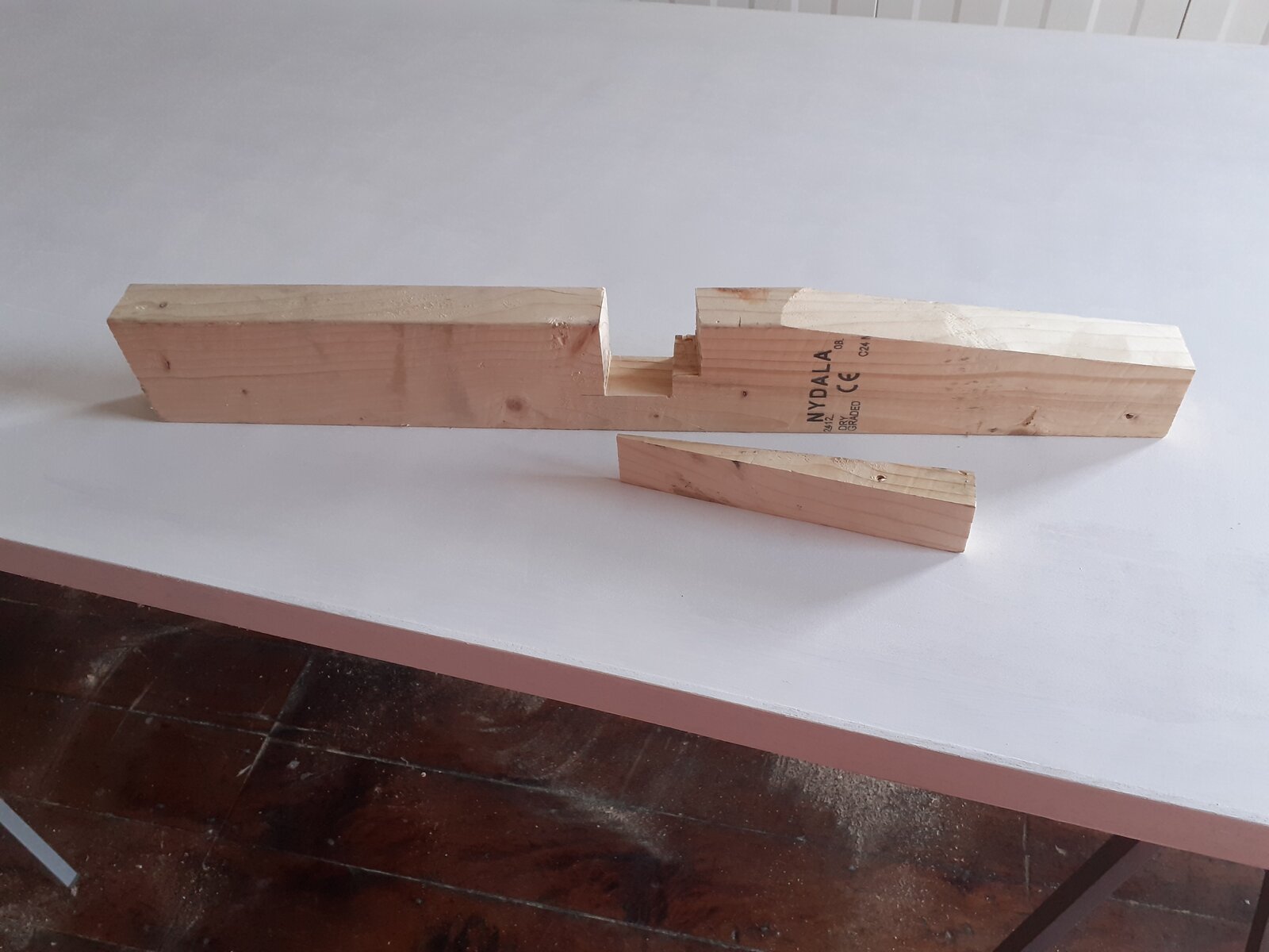

You are going to have to bite the bullet and learn how to shoot the door in correctly to fit the opening (and not to match the existing door - after all it's the door casing you are trying to match). A few tools make the job a lot easier, though, like a circular saw (to adjust the length, if needed), a home made straight line guide (if using a circular saw), maybe a sliding bevel, a sharp block plane or smoothing plane (another skill to learn - power planers just don't cut it for door hanging), a home made door block (I've made two of those this week for different jobs), chisels for the hinge recesses, etc. It isn't rocket science, but it does take some basic hand tool and measuring skills (which might explain some of the gawdawful workmanship I've seen masquerading as the work of "professional joiners" in recent weeks!).
Above and Below:A traditional door block used to hold a door in the vertical position whilst the edge is worked on (e.g. lipping, cutting hinge recesses, cutting lock mortises etc). This one was made from an offcut of 4 x 2in CLS
Sorry if this sounds a bit sour, but door swinging, proper accurate door swinging, just can't be done with short cuts and really isn't that difficult with fairly basic hand tools. Trying to do it with a router is using a sledge hammer to crack a nut
