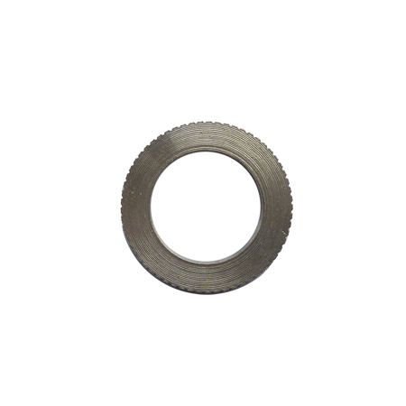

The biggest issue with this is finding 165mm blades with the 16mm bore.
What you need, @^woody^ is a 20 x 16mm (OD x ID) blade washer, like this one:
then you could buy "standard" 165mm diameter x 20mm bore saw blades like the DW ones I use :)
