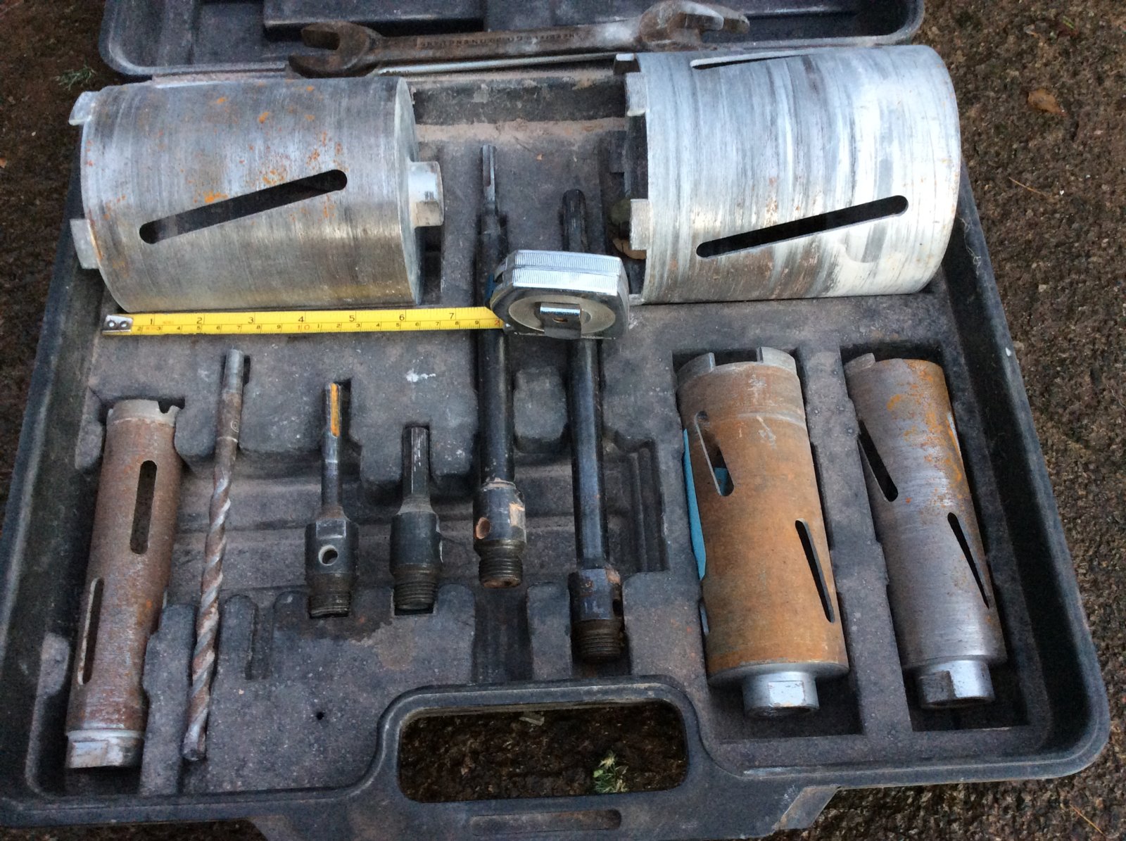

207C9719-AB7D-4F12-830C-CC2BF44581C5.jpeg I have , and used extensivly a set of mexco diamond core bits which are superb.
You will need a taper bit and arbor if they are not included.
You may want to buy a drift key as well to get the drill out the arbour.
I've got a grey mexco 162mm and a couple of smaller blue spiralled mexco ones which I got to replace some other basic ones. I recon the blue ones do cut faster than the standard designed ones. It still takes a while to drill a hole mind, but since you've an appropriate drill it shouldn't be too bad.

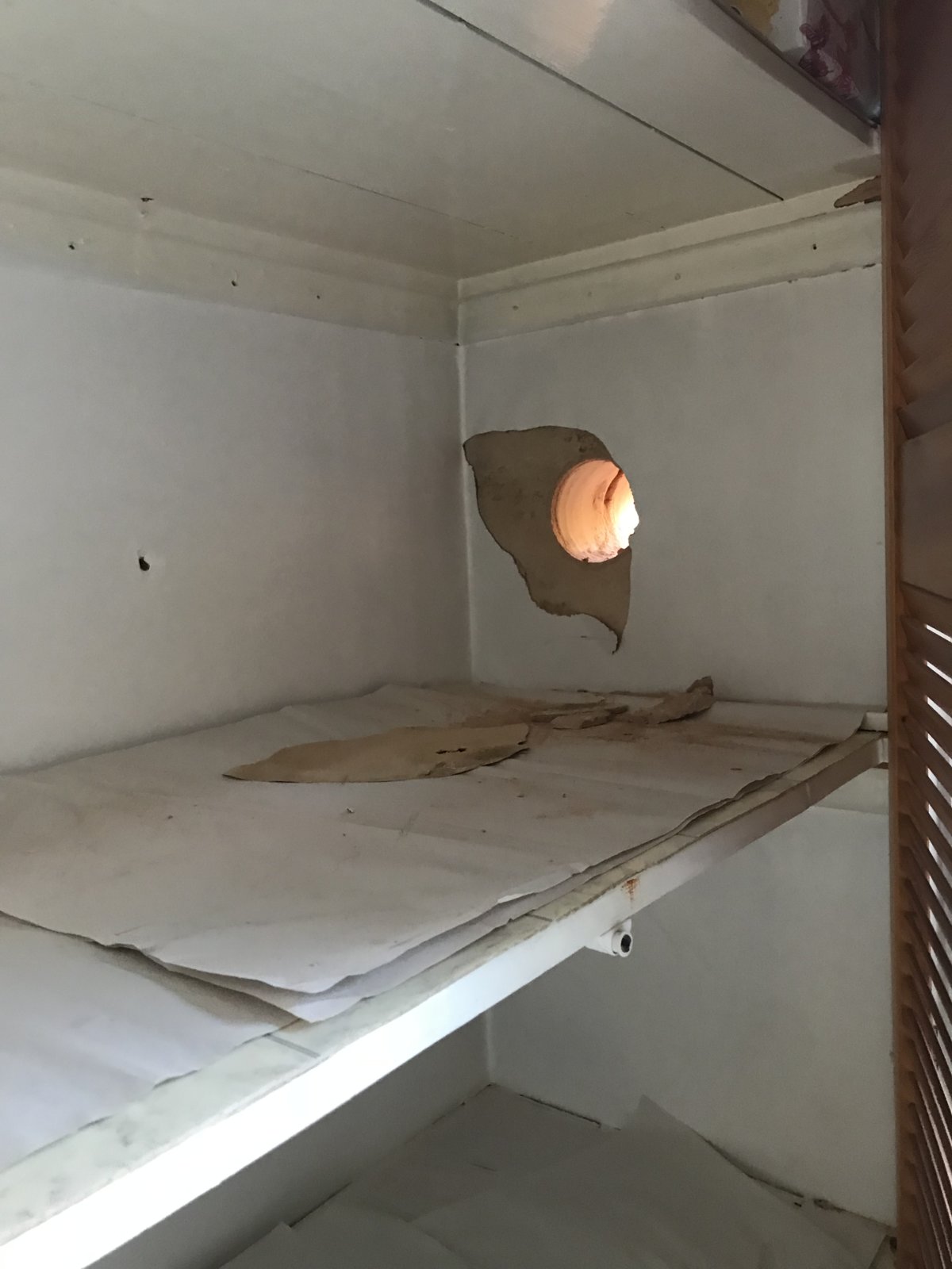

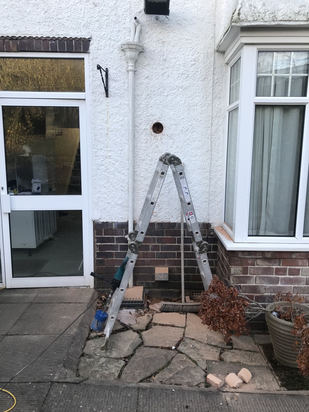

Just to update, got the hole drilled yesterday. Took no more than an hour with a few breaks. Makes such a difference using a dedicated core drill.
Thanks for all the info
