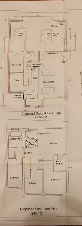

My architect has produced a nice design for our rear/side extension, however it depends on a 9m steel moment frame to support the existing back wall and new side bit.
Anyone care to guesstimate the cost of this bit of the build?
I suspect the horizontal beam(s?)will be quite large, they're supporting:
  • Rear existing house wall (+gable) 6.5m wide
  • First floor joists (3m long joists)
  • Point load from adjoining UB taking load from 2m existing side wall
  • Rear wall of new side extension(2-storey) - 2.3m
  • Whatever load transferred from roof elements
See plan for more detail:
Later on we'll get an SE to spec it up of course, just want to get an idea of rough cost (both the steel material cost and the 'fully fitted' cost)
Cheers!

Those sizes sound reasonable. If cavity wall just stick in a 305 97 UC beam to properly support both skins of the wall. He has shown pad footings which need to be factored in too. Splicing will add cost - maybe £100-£150 per splice so I'd try get it in one.
That window right next to bi-folds is awful though. Pier looks weak and will maybe need a steel post in there too.

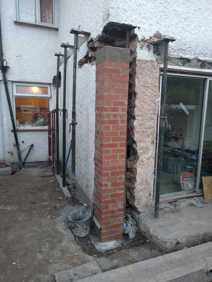

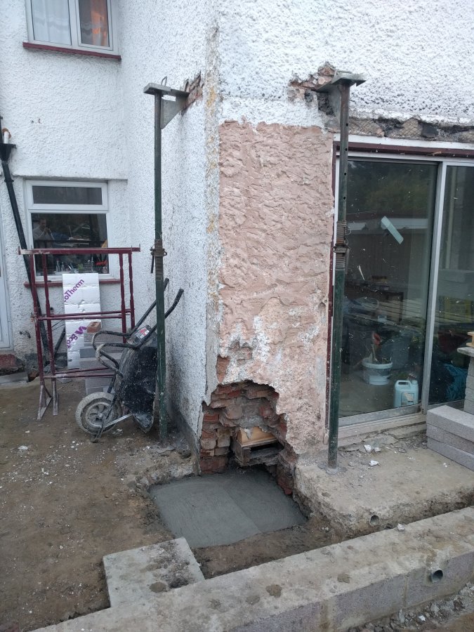

What's the procedure to install the column in place of the existing corner? Underpin the existing strip with a 1m3 pad, or completely break up existing foundation and start again?
I was hoping the knock-through could wait until the new extension was water tight, but sounds like it may need to be done first as this massive beam won't be able to be fitted at the end
With ours they demolished a bit at the corner up to skirting level and dug a 1m deep hole under and filled it with concrete. The actual knock through was a bit later. I'm really struggling to add an image bit I hope you can see it correctly!
Those pics are a great help thanks - looks like it may be possible to install the frame without fully knocking out the back wall (which would leave us without a usable kitchen, not a good plan as we'll have a toddler and a newborn!)
