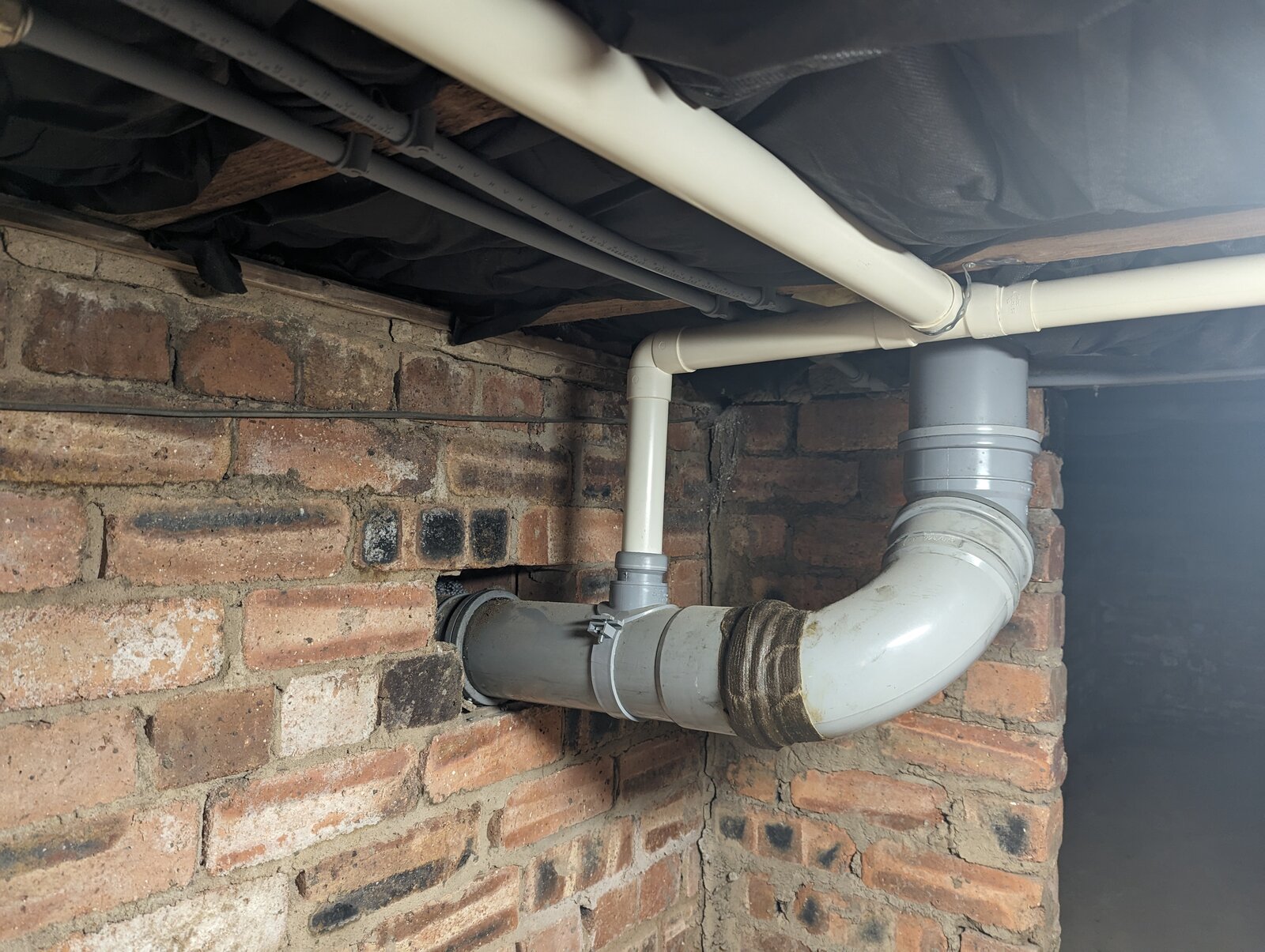

Hi,

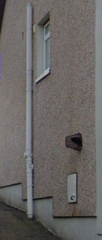

I clipped the soil pipe on the side of my house when reversing my car up our driveway :rolleyes: It cracked around the T-junction where the horizontal pipe coming from inside the house joins with the vertical soil pipe on the external wall.
I had the boiler serviced just before Christmas and asked the guy from the gas/plumbing firm to take a look and he said he'd provide a quote to repair it. The total quoted, ex VAT, is just under £800. This was quite a bit more than I was expecting. To be fair I know next to nothing about plumbing, but to my untrained eye it didn't look like a particularly time-consuming job or one that needed lots of materials (besides a new pipe and fittings), so £800 feels quite steep to me.
I was just looking for some advice if this seems like a reasonable price or if it seems too high?

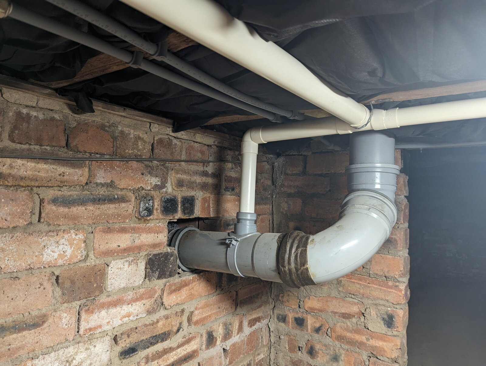

I've attached photos showing the pipe externally, and internally (under the floor where the pipe exits the side of the wall).
Thanks!

Is that price to replace the entire stack ? If it's to make a repair to part of it ,show us the part that is cracked and needs replacing.
The quote is to replace the stack.
The cracked section is the elbow of the T-piece and the lower part of the vertical stack. There's some "emergency repairs" my Dad did on the damaged section that at least reduced the amount of water leaking out, but combined with the tight space means it's not straightfoward to get a decent photo of the cracked area. Sorry I can't provide a clearer image.

My suggestion would be to obtain two more quotes and see how they compare.
But it should not be necessary to replace the whole stack and with careful investigation perhaps only a relatively small part could probably be replaced. Although most now use solvent weld which makes any repair quite difficult.
Just to close this thread off - I got another quote, for £230 + VAT, 1/3 of the original £800 quote! It took two guys just over one hour to cut out the damaged sections and replace them.
