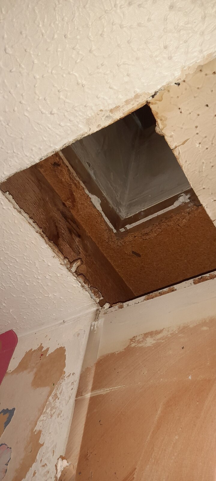

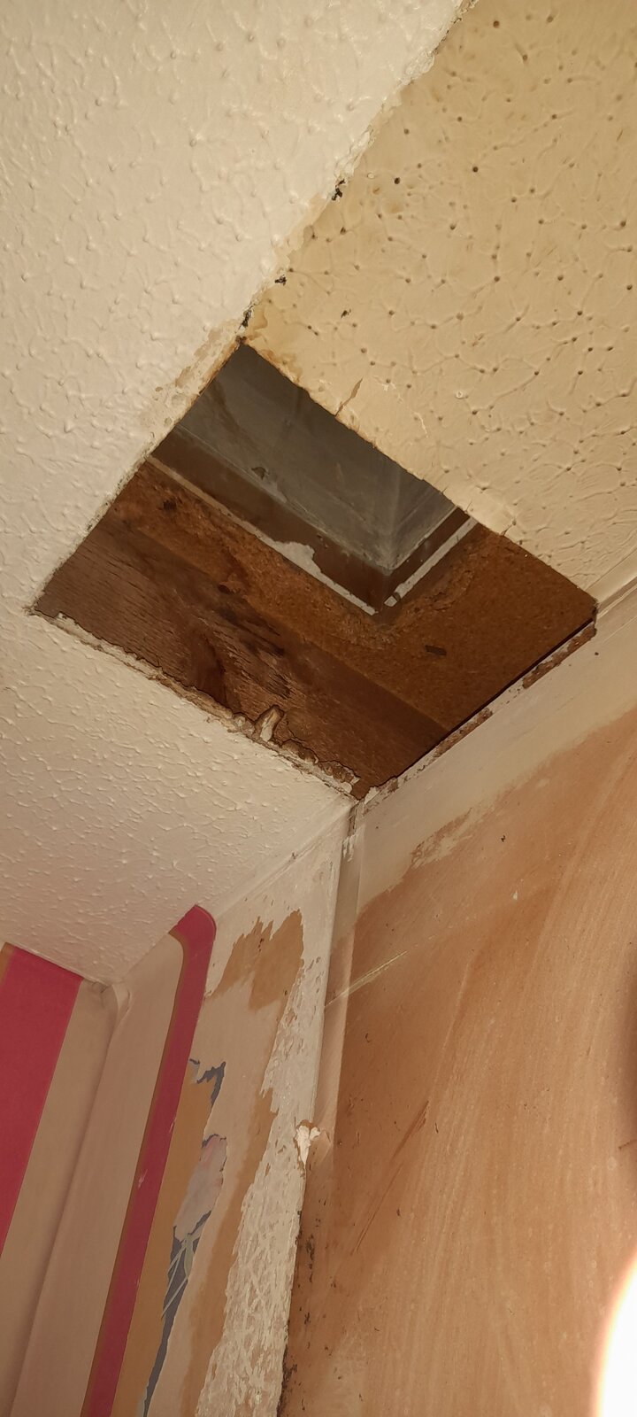

Any tips on covering this hole in kitchen ceiling? There was a 1970s air vent there, goes upstairs, now obsolete of course.

Inside on the right is brick,no space. Opposite that inside is wood which hss about an inch of a ledge. The other 2 opposing sides have plenty of space. I was thinking of using bendy pliable metal which would stretch over hole as I let it unfurl inside hole.
Batten around the edge of the hole and fit a piece if plasterboard flush with the existing ceiling.
I'd get a couple of bits of 150mm celotex, cut them to be a tight fit, ram them both up into the hole, foam any gaps, then Id use some 2x1 drilled and screwed around the hole to fix a piece of plasterboard too
What do you mean by use 2 x1? Which foam would you use?
2x1 timber batten.
150mm celotex, you can probably find an offcut locally either on eBay, gumtree or Facebook instead of buying a full sheet or just use loft mineral wool as suggested
