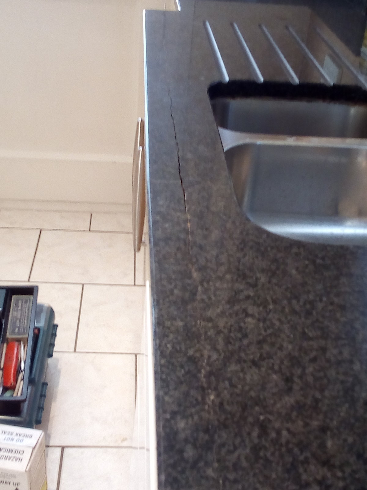

Hi,
I have a huge crack in the kitchen granite worktop starting in front of the sink and expanding both side of the sink over 1 meter maybe.
It was a tiny hairline crack 2 years ago so I did not bother. 2 years of tenancy later and the crack is so big that I fear loosing half of the worktop. The groove is larger and the crack is much longer as it was maybe 20cm only before.
Don't want to spend huge amount of money in that as I plan to redo the kitchen in a couple of years. I can't imaging replacing the worktop by something else similar in style like a laminate as it would look nasty. Just want a repair solid enough to last 2 years.
I did not ask a granite specialist as I am scared of the price they might give me. Could I find something in Wickes or online which I could use to do the repair myself?
Thanks.
Letty

Oh dear!
If you look underneath that crack, do you see a metal insert?
It's used to reinforce the thinned part of the granite where the sink hole is cut.
If so, it's a manufacturing defect.
After they chase the groove they're suppose to stabilise it with a special mastic and then insert the metal bars.
Seen it done in factory.
What i would do now is call an expert and get that crack filled.
They now have mastics of matching colours and once filled and polished they become invisible.

There is no metal bar under that section of granite.
I had a trade in the house the other day and he was surprised to see that crack as granite is so tough, he said that probably it has not been damaged but the material might have had a defect from origin. kitchen might be 20 years old. Not me who installed it.
Could I buy a filler to repair myself or can I install a reinforcement thing under that section?
Letty

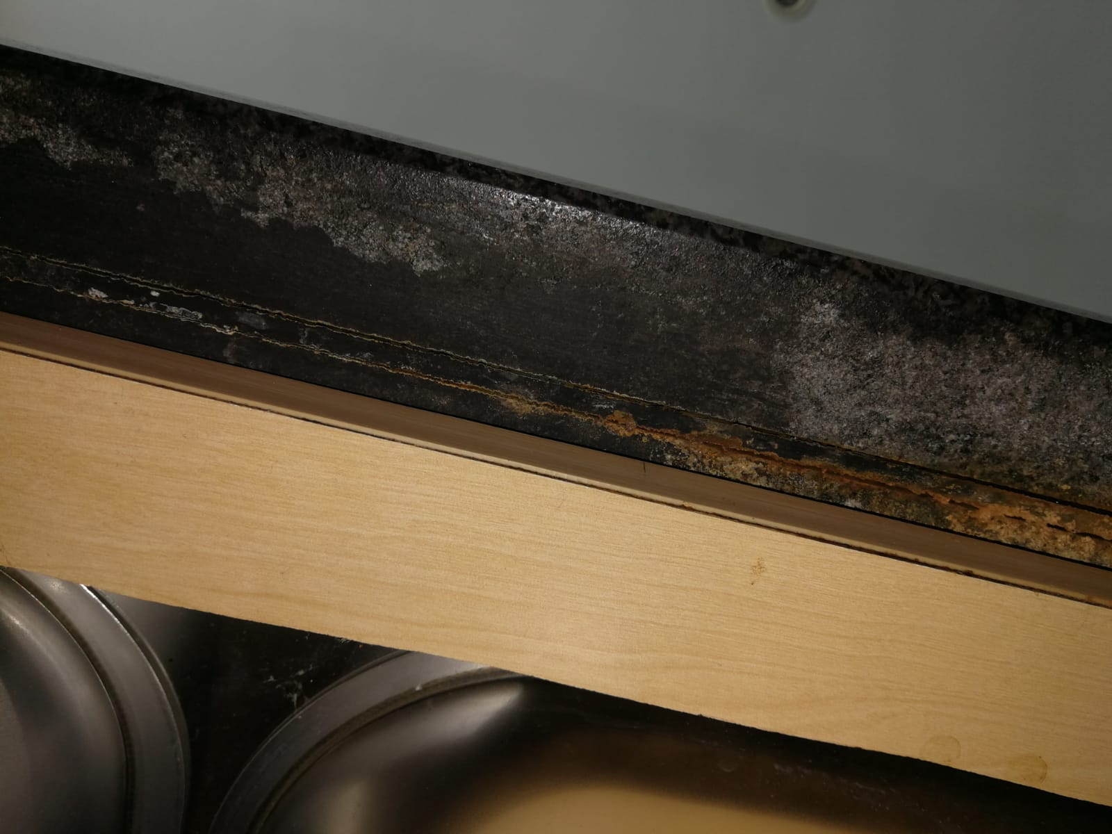

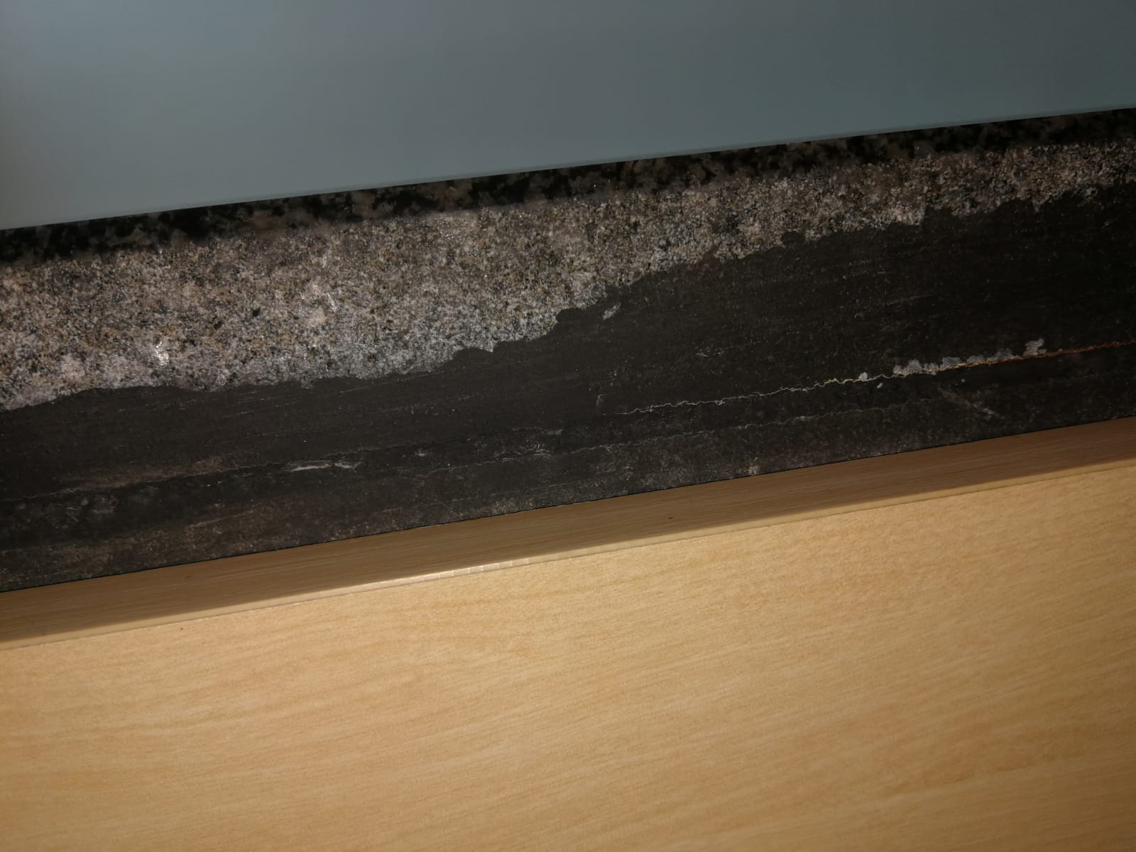

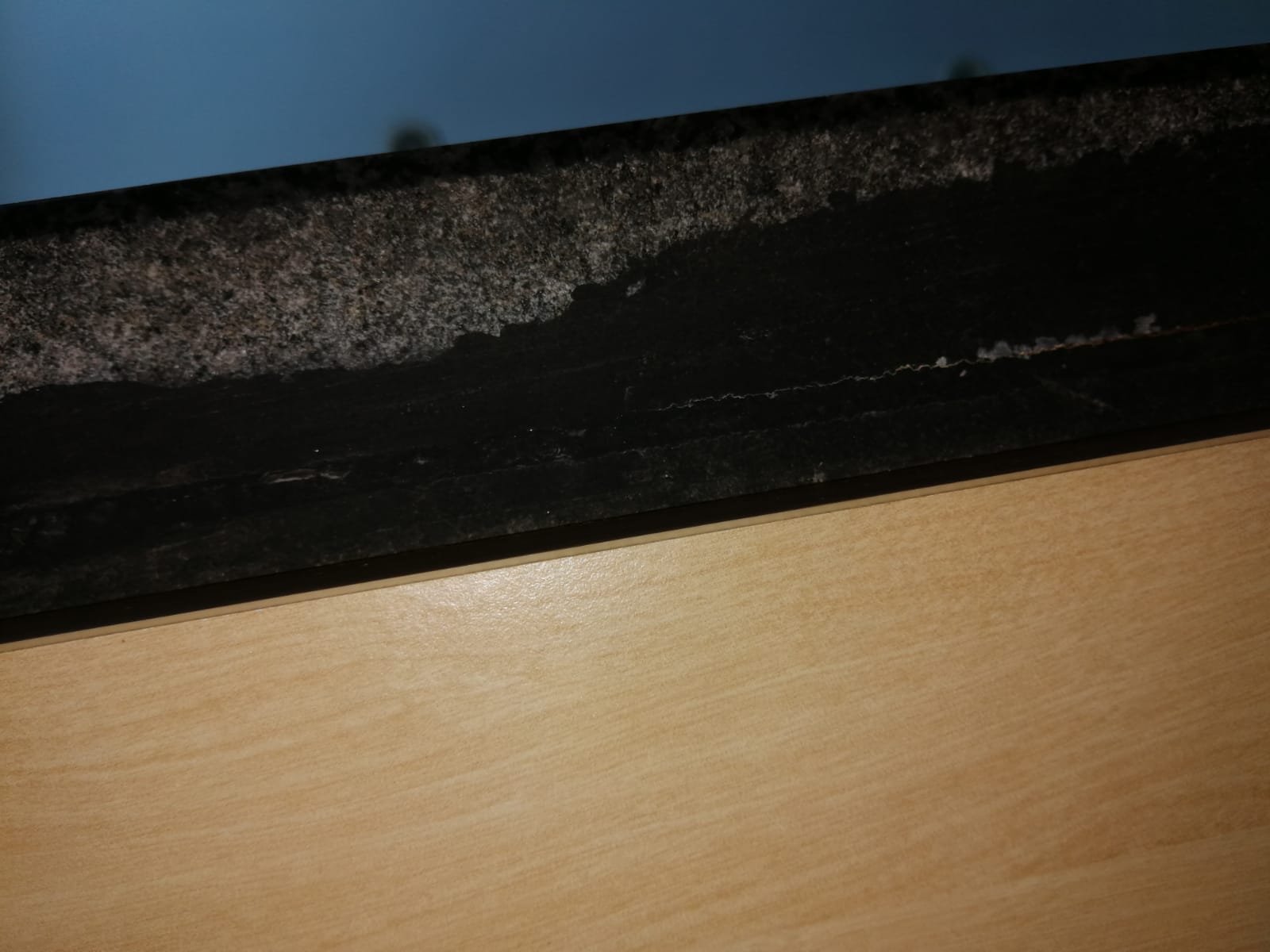

"The crack is due to a mental rod that was inserted into the granite underneath to strengthen the sink cut out however the bar has rusted and swollen the granite making the crack.
The crack can be filled to improve, make water tight & strengthen however would be difficult to disguise due to the size of the crack, damage being on the surface & colour of granite. If your looking for invisibility replace the worktop.
The cost to repair would be £150".
I checked again the kitchen for that rod which I couldn't see before, and I saw!! See pictures.
Thanks.

Rusted?
They're supposed to be stainless steel.
Well, anyhow, £150 is not too bad and believe me, stone masons are perfectionists.
When he says that the repair will be difficult to disguise, he means to the careful eye of someone who knows about it.
IMO you should have it repaired.
Hi again,
I have notice that the undermount metal sink is detached form the worktop. The joint of silicone is dry and rotten and nothing else seems to hold the sink in place. It is resting on the plumbing plastic pipes!
Water must have leaked through the gap left by the missing silicone and this has caused the rod to rust and amplifying the crack in the granite.
Anyway, now I have to re-attach the sink before repairing the crack.
