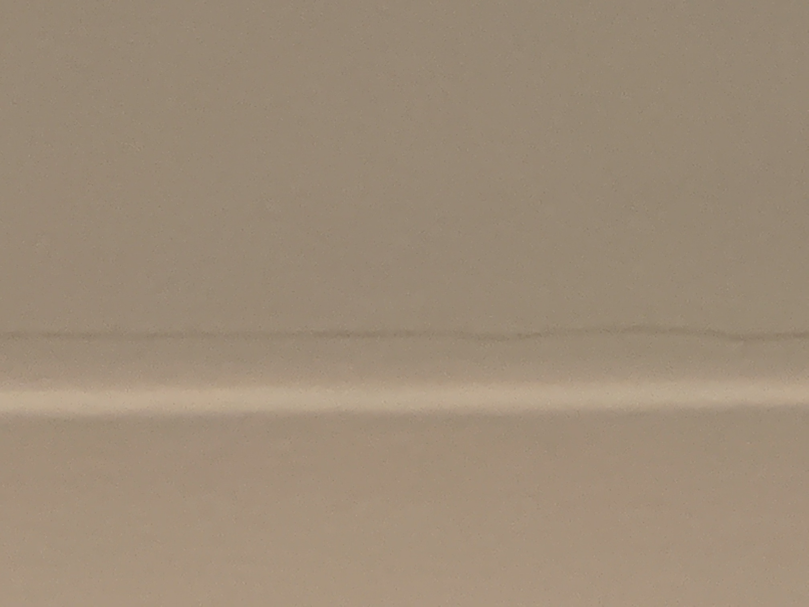

I had the ceilings skimmed last year to cover artex and since then we have a crack 1 inch away from the architrave about 3 feet long prob caused by waking in the loft, what the best way to fix please.
do I need to make it a v shape first or just fill with flexible filler
thanks
Just fill with flexible filler.
Get a decent non shrinking one, ever build do an extremely good one
don’t dig too deep to break the tape underneath.
I use car body filler. isopon p38.
flexible and doesn’t shrink . and you can rub it back in 10 mins
nah , listen to turbo , it’s the same advice.:p
