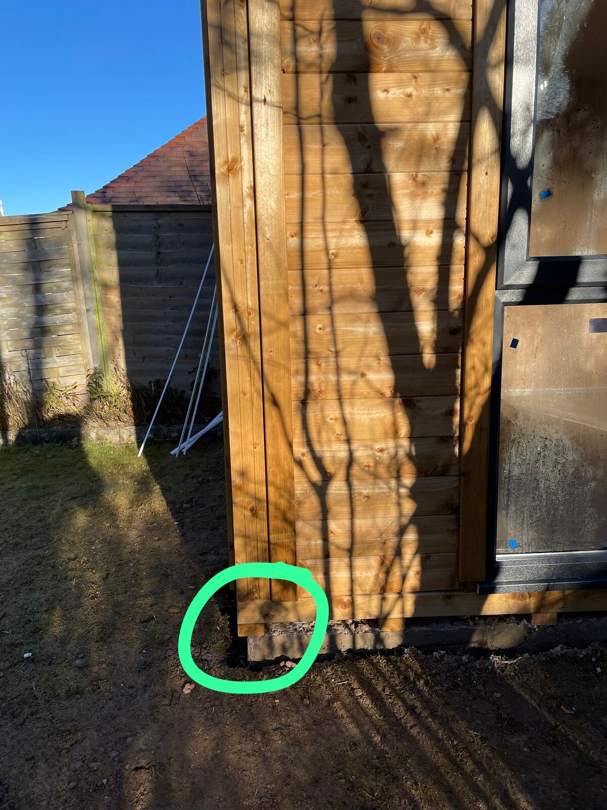

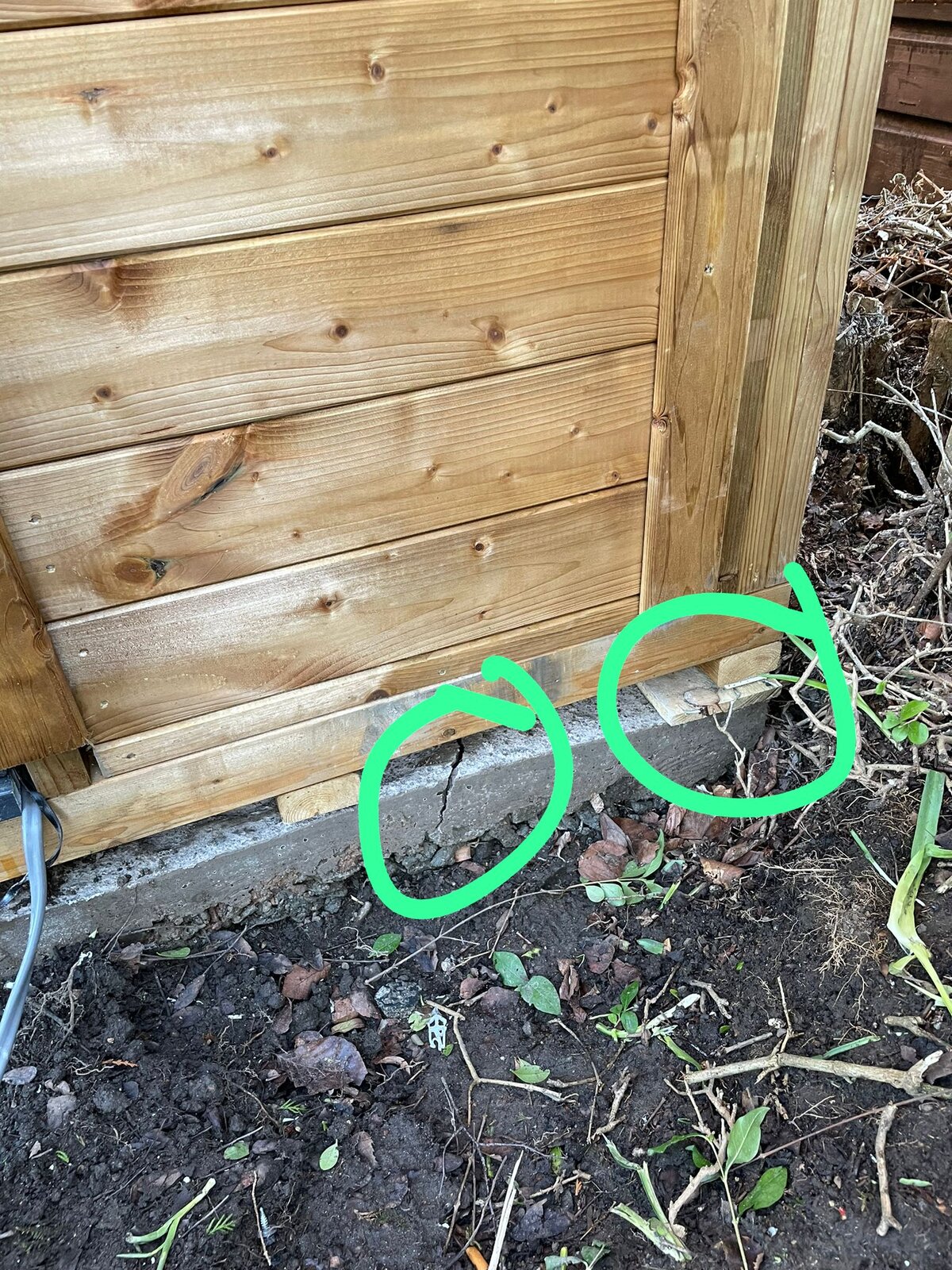

Hello everyone!
We've had a garden office put in and are unsure if what the guys have done will last or not.
There are already several cracks in the concrete and bits that are over hanging. I'm no expert at this but it doesn't feel like it's been done properly so would be great to get someone else's thoughts on this.
Cheers!

> Poured on soil it seems
> poor load distribution of the support beams, which will create stress points as you can see
> should have used rebar
> the concrete is exposed and no water barrier which could lead to rising damp
> are the support beams properly sealed ? last thing you want is for them to rot away
> the power (?) cable should be SWA not twin & earth

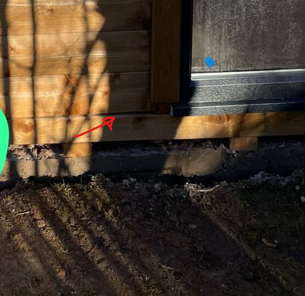

I'd be more concerned about the whole design of the base area. Water running down the cladding goes where exactly when it meets the wall bearer? To me it looks like it just runs in on top of the floor bearer and makes the structure wet.
Cladding should stand off from the base so that water running down the cladding is thrown outside the concrete base and can neither run in to the building or across the top of the concrete allowing the bearers to rot.
The power cable is a big cause for concern - it is not compliant and potentially hazardous.
Test it by putting a hose (on "shower" not "jet" to simulate rain) on it and see what happens. If the building leaks, get them back PDQ. If it leaks it isn't fit for purpose.

to me it looks like it will run in here

That foundation needs sorting before even being worried about watertightness.
Personally, i'd be getting it taken down and the slab cast to a decent thickness. Then worry about watertightness on the rebuild.
My large wooden shed stands on concrete lintels on top of just 100mm of wacked MOT. It hasn't moved a smidgen in years. Yes, that slab is not great, but it's a slab sitting on top of the ground. Unless the ground moves, it won't go anywhere - it's a glorified wooden shed - what's the worst that can happen? - pragmatically better to leave it now it's done. If it does move dramatically and needs taking down and redoing at some point in the future it's the same amount of work then as now. Unless the builder would be doing it all for free (doubtful) there's nowt to gain - pick your fights, and watertightness is a good fight to pick because it's binary - it leaks or it doesn't.
