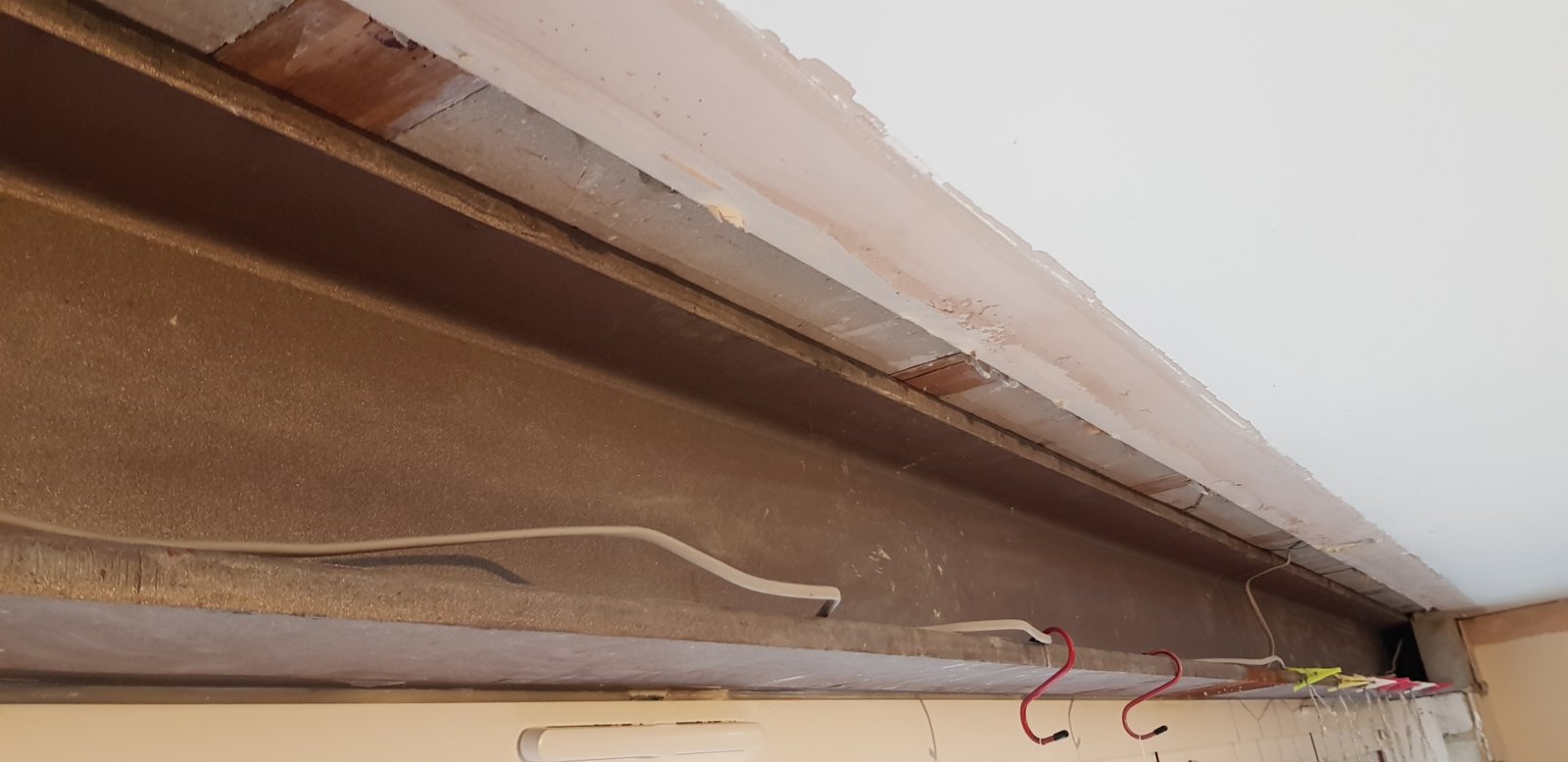

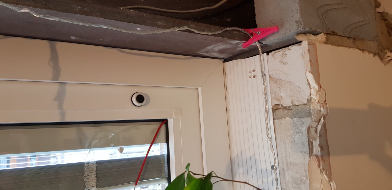

I've had a set of bi-folds installed which required a 5m RSj to be installed too.
The RSJ has been installed onto two pieces of cut steel and not padstones due to my exposed brick outer wall.
The RSJ over it's length has in excess of 10mm difference in install height and the RSJ is not level. There is approximately 10mm of silicone at one end above the bi-folds and it's practically touching at the other.

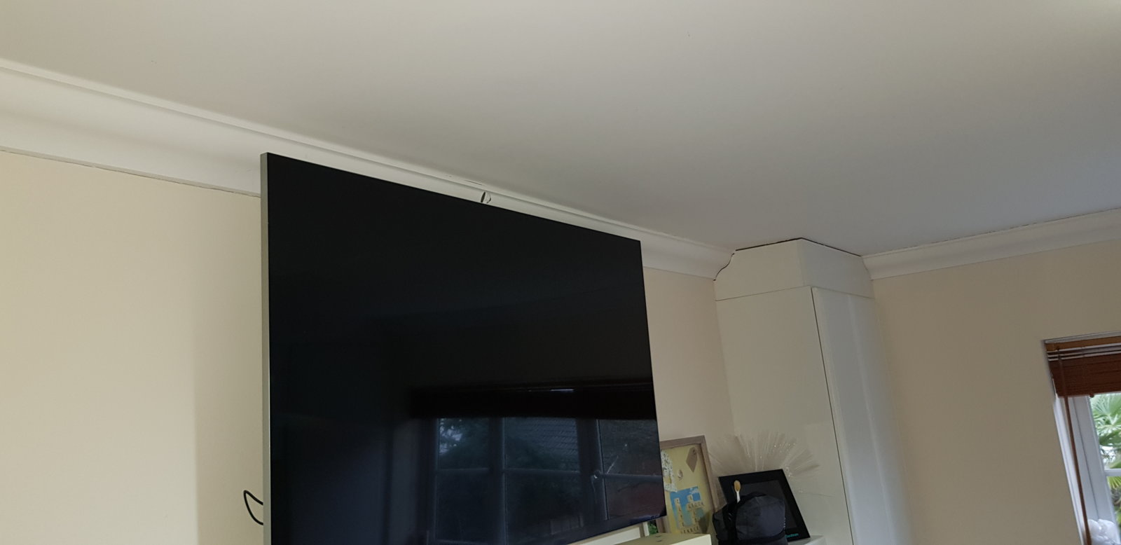

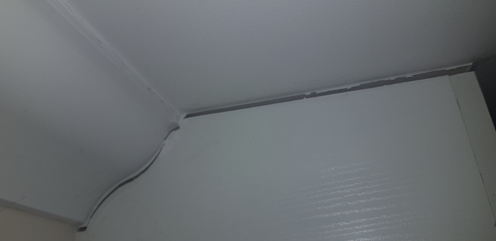

I have a stud wall upstairs which runs perpendicular and it meets the RSJ at the mid-point of it's length. The fitted wardrobes upstairs now has a ~6mm gap above them and the upstairs coving running along it's length has separated from the upstairs ceiling with a similar gap present.
The company installing the bi-folds insists that this is normal movement, but I believe that the unlevel RSJ has caused the upstairs joists to drop and therefore put a strain on the stud wall and it's cracking due to the difference in the install heights of each end of the RSJ.
No additional packing above the RSJ was used and it appears that the installation company is insisting this is acceptable. Is this right?
What is the height/level tolerance in the installation of a 5m RSJ?
If there is a difference in install heights at the ends would you expect that there would be some packing on the inside skin above the RSJ to make the supported joists and bricks level once again?
The outside skin of the house needed packing (builder used wood and pushed in a little cement) as cracks were creeping up and across, but nothing was used inside. Would you have used wood or slate to achieve this?
I would love to get your feedback as this issue has been going on for about 6 months and the install company is not accepting liability or offering to rectify the issue as I see it.

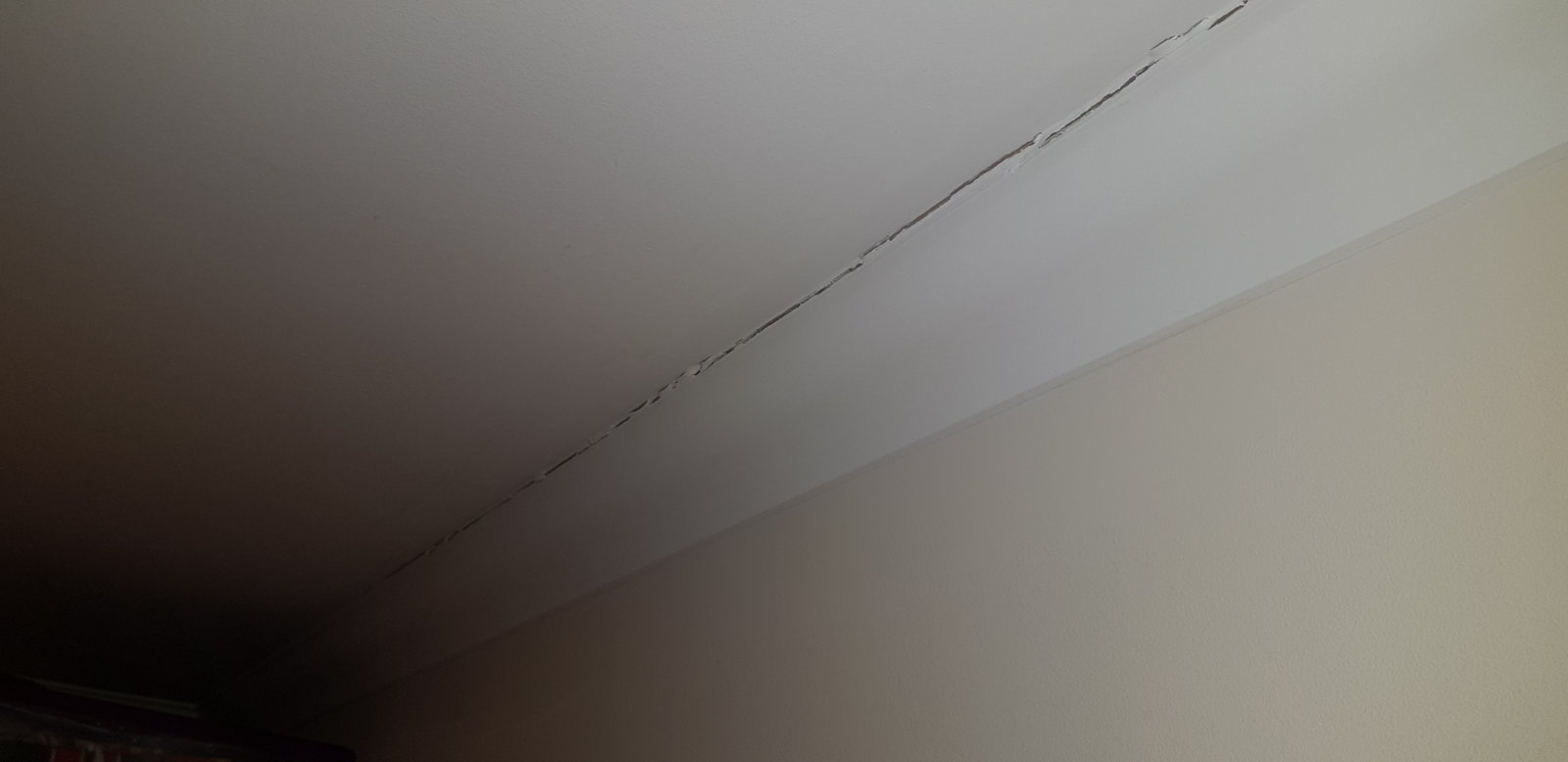

@wessex101 The beams sit directly onto the beam itself. So due to the slant on the RSJ/I-beam I feel that the joists are no longer level themselves and over the entire length of the
beam the whole of upstairs has dropped by over 10mm. As you can see there are cracks in the back inner walls as well :( These are plasterboard with a skim, but have cracks in them.
I've uploaded more files to the link in the initial post.
@Notch7 I understand that maybe being 100% level could be an issue, but wouldn't you expect the wall above to be packed in order to eliminate the slant of over 10mm?
Also one of the files uploaded to this post you can see that the RSJ sits on top of a piece of steel and then on the wall itself. No padstone due to exposed brickwork outside.
Just to confirm I had my painter and decorator in a month or two before work started to do a little minor hairline crack fixes which occurred due to paint/filler shrinkage.
This was the first touch-up since we painted when we moved in 7 years ago. So the huge gaps 5mm or more isn't expected.

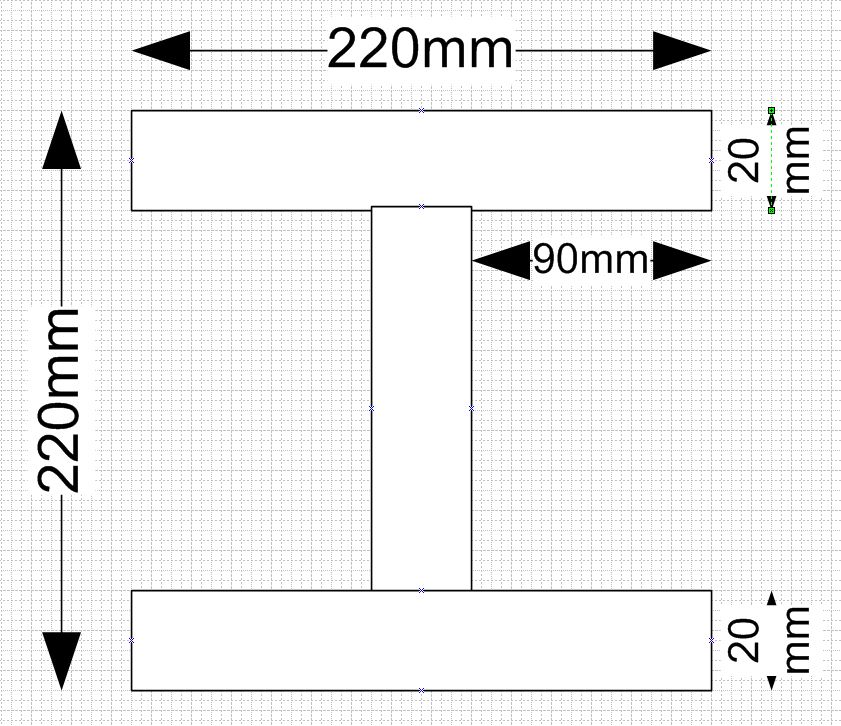

What is the actual section-size of the beam, ie width of flange and overall depth?
Am I being a bit thick here? From the new photos the beam seems to be sitting under the outer leaf of the wall. What's supporting the inner leaf? Is that a concrete floor slab above?
I appreciate everyone's help - thank you.
The size was approximately 5m long, bi-folds are 4.7m.
The measurement of the top and bottom of the I is 20mm thick.
Measurement of the bottom and top lip to the centre is approx 90mm I assume the outer top and bottom lip is the same, but it's been filled.
The height and total width measurement of the beam is 220mm.

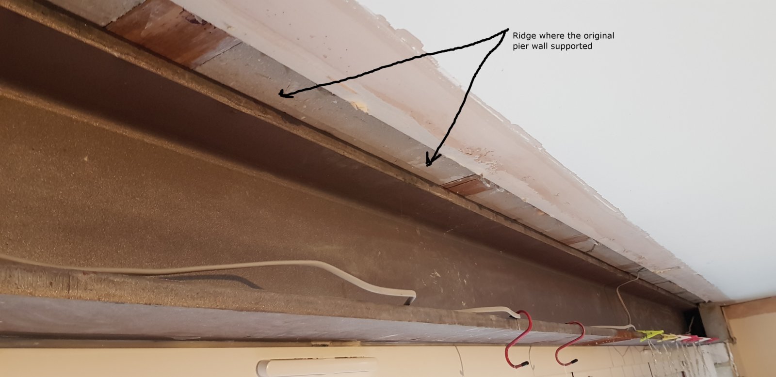

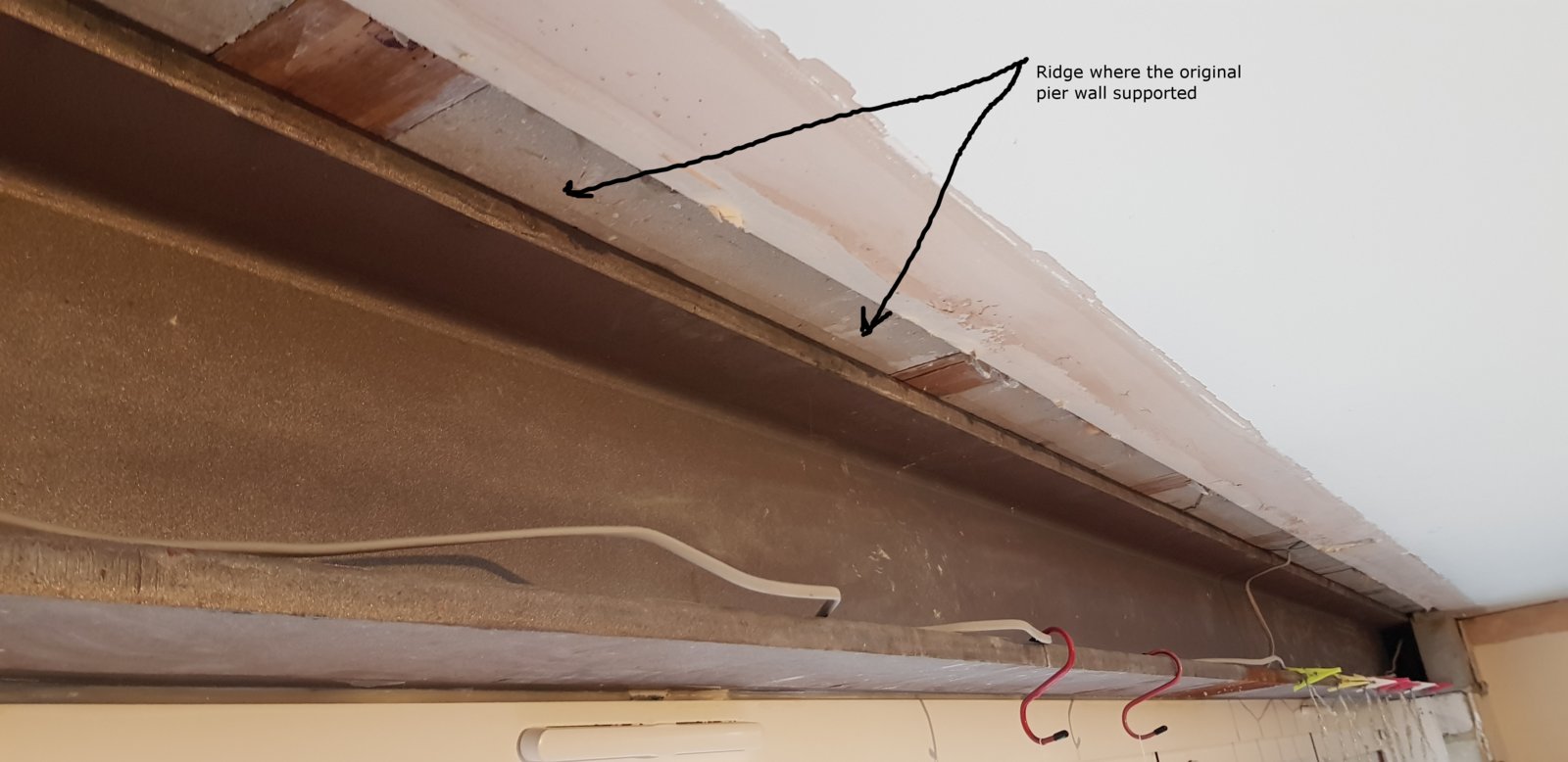

The upper floor is just wooden.
I guess that the inner leaf is partially supported by the I beam?
You can see a ridge in the concrete blocks of the inner leaf and I believe that ridge shows where the original pier wall supported them.
