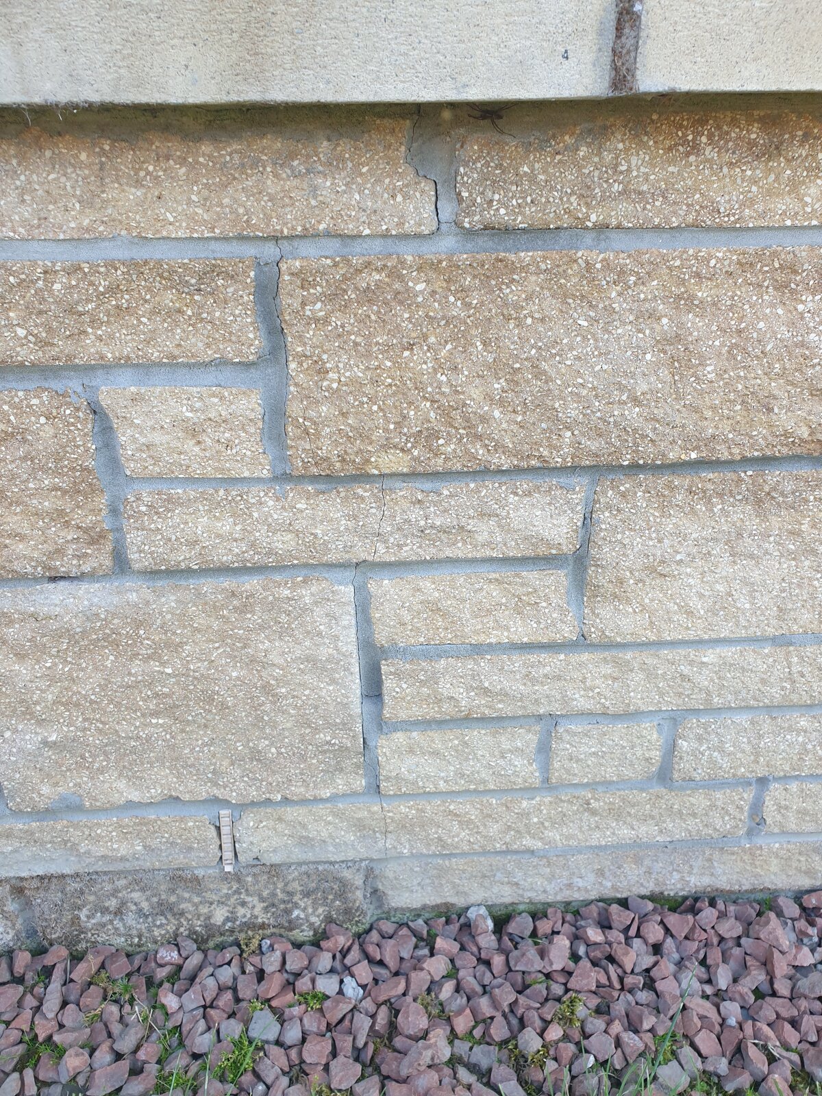

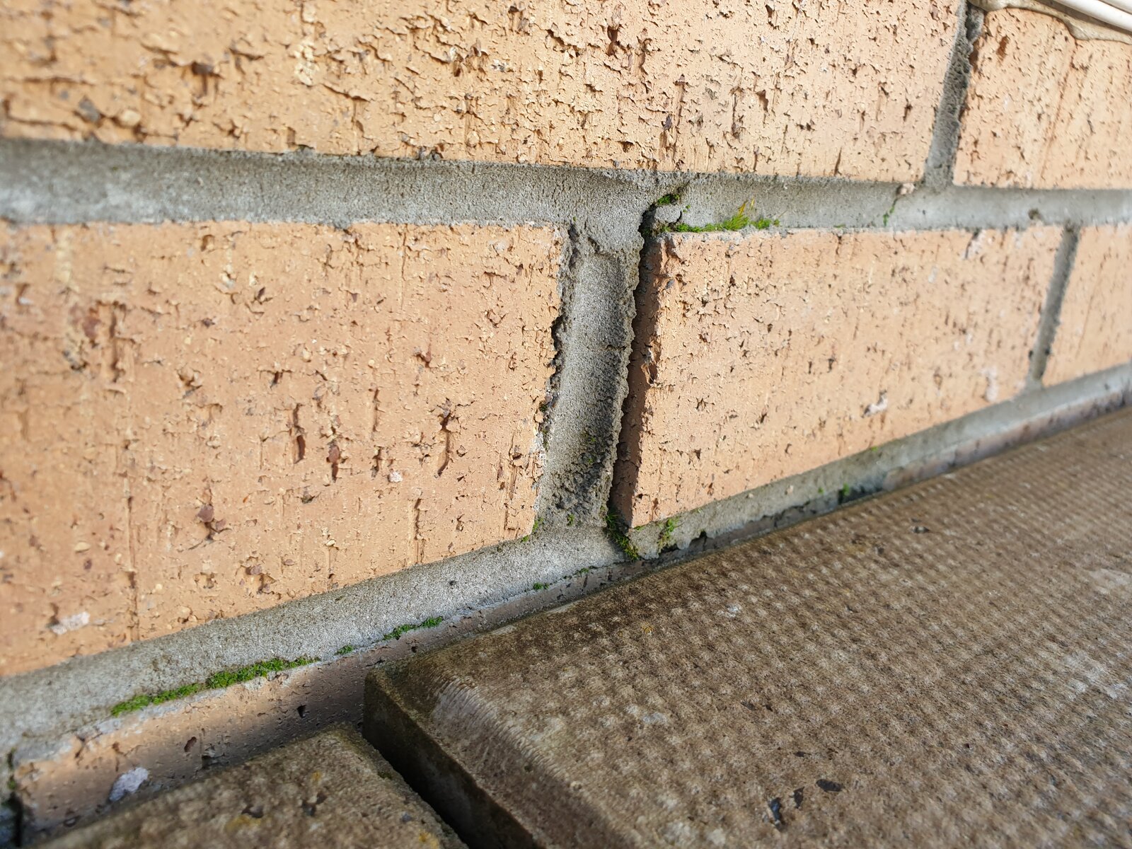

We moved into this 2014 built house a year ago;

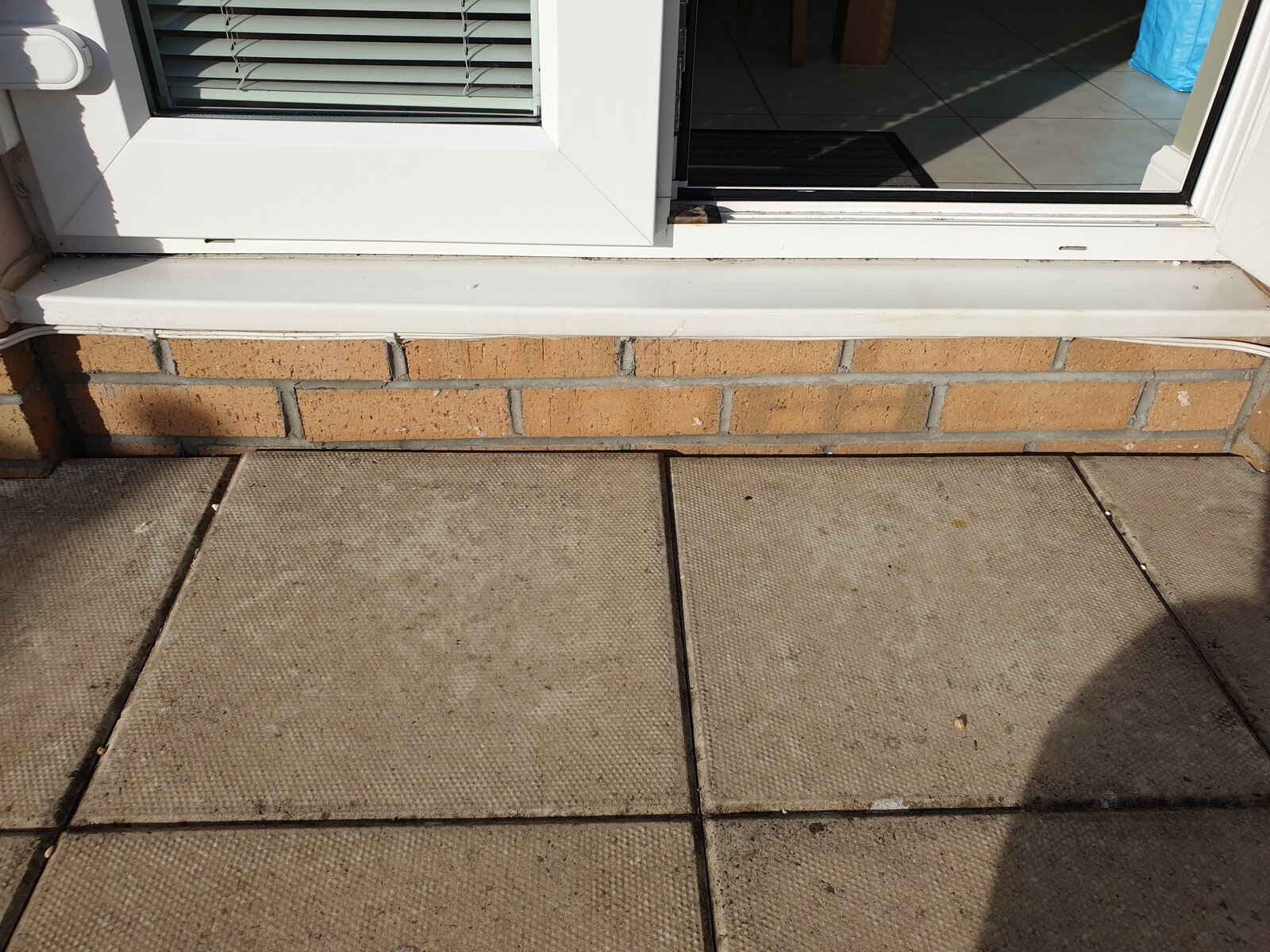

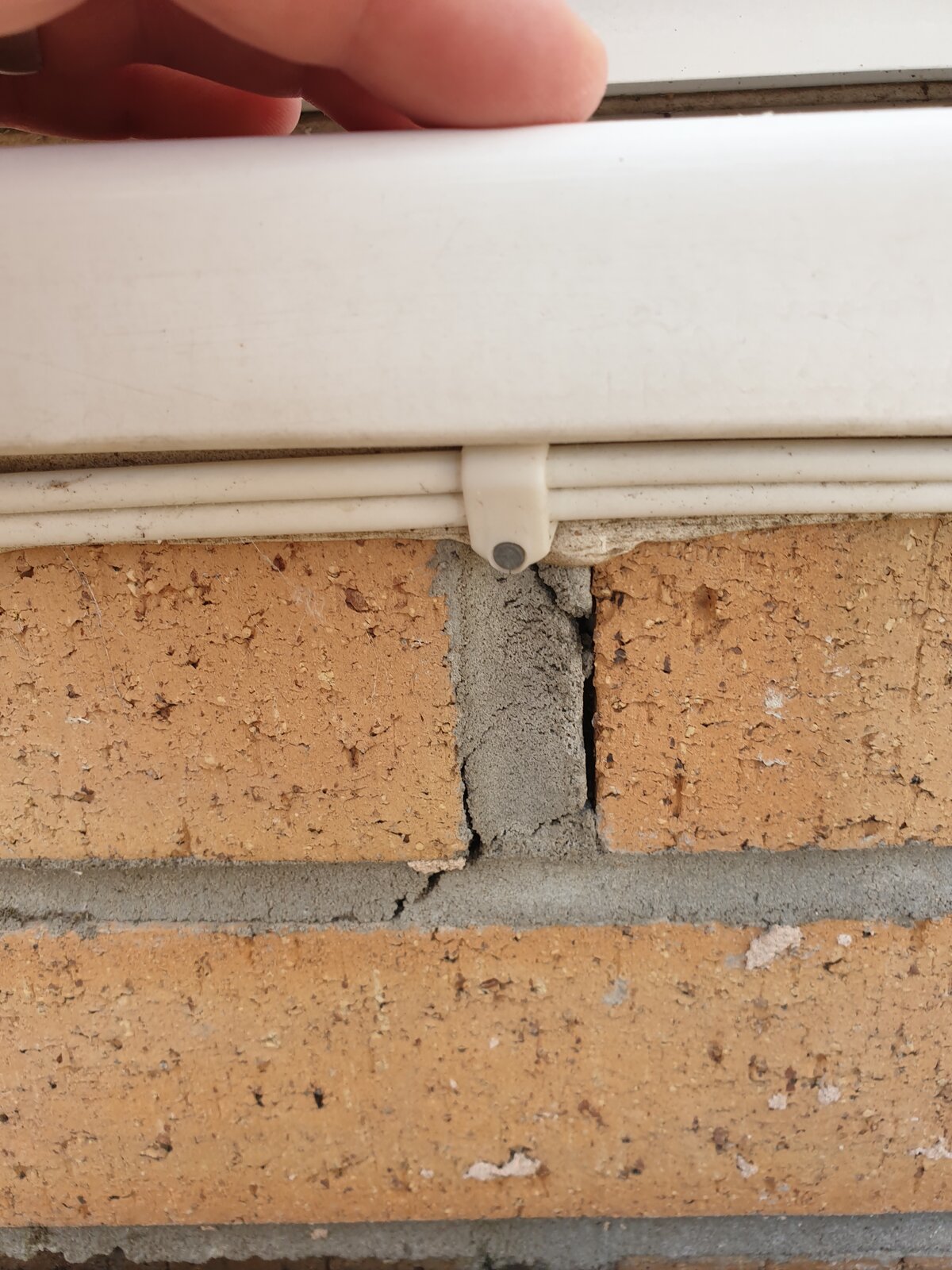

1) Shortly after moving in we discovered some brickwork under the rear south facing patio doors seems to have shifted out with cracks in the mortar, we think this has been before we moved in as we noticed after a couple months.

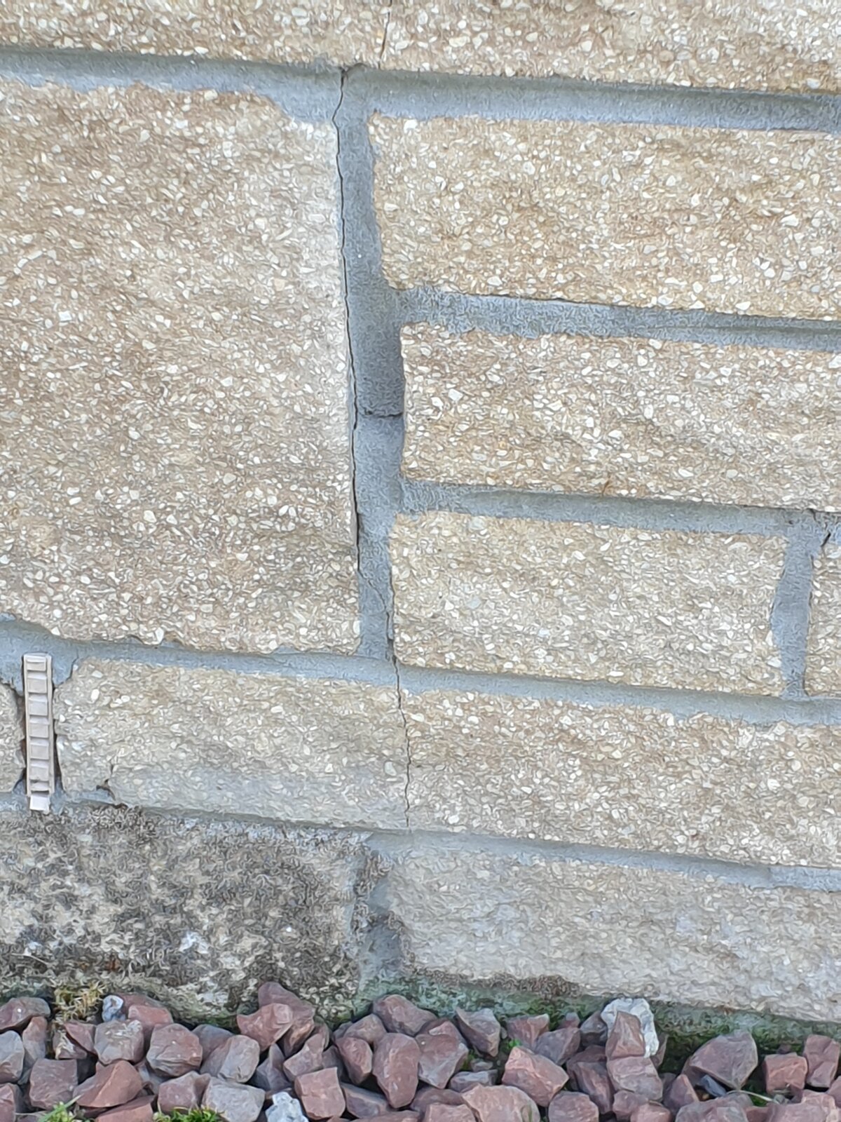

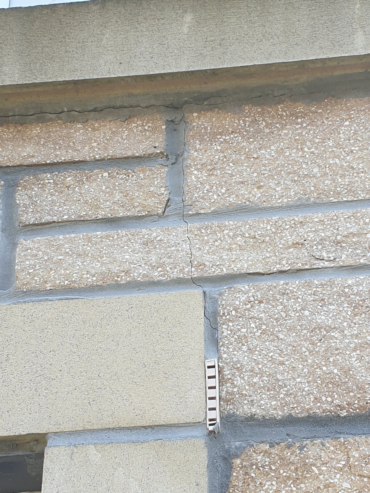

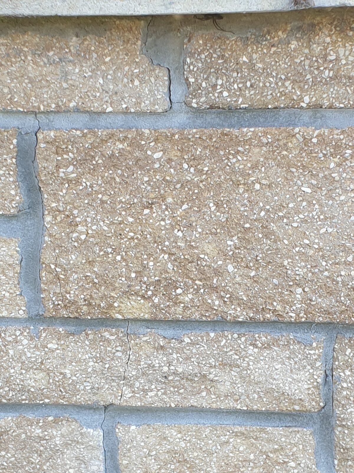

2) Yesterday, I noticed what I am almost certain are new cracks in the mortar and bricks in the front north facing wall, below/around the living room window up to the Juliet bedroom doors. I have previously cleaned algae from the front wall and sure I would have seen these cracks if they were there before.
I am wondering what has caused this (settlement, movement, shrinkage/expansion?), what needs done to fix it, is it an insurance job etc.
We have 3 upstairs doors that don't close properly, the door frames are literal squint, and a the slightest tilt to the upstairs landing, so slight it took 2 months living here to notice. We should have spotted this beforehand but we didn't.
Obviously worried as this is our forever home and discovering issues is really disheartening.
Any advice is appreciated.

Thanks tony1851.
That's what I suspected for #2, would you recommend any course of action? I am not in the building trade so don't know, but would the cracks let in moisture?
Do you think the same for #1? the bricks have physically moved outward so I was thinking settlement, but with the interior changes to floor and door frames, again I'm not sure.
Looks like reconstituted stone facework to me - maybe it cracks easy
