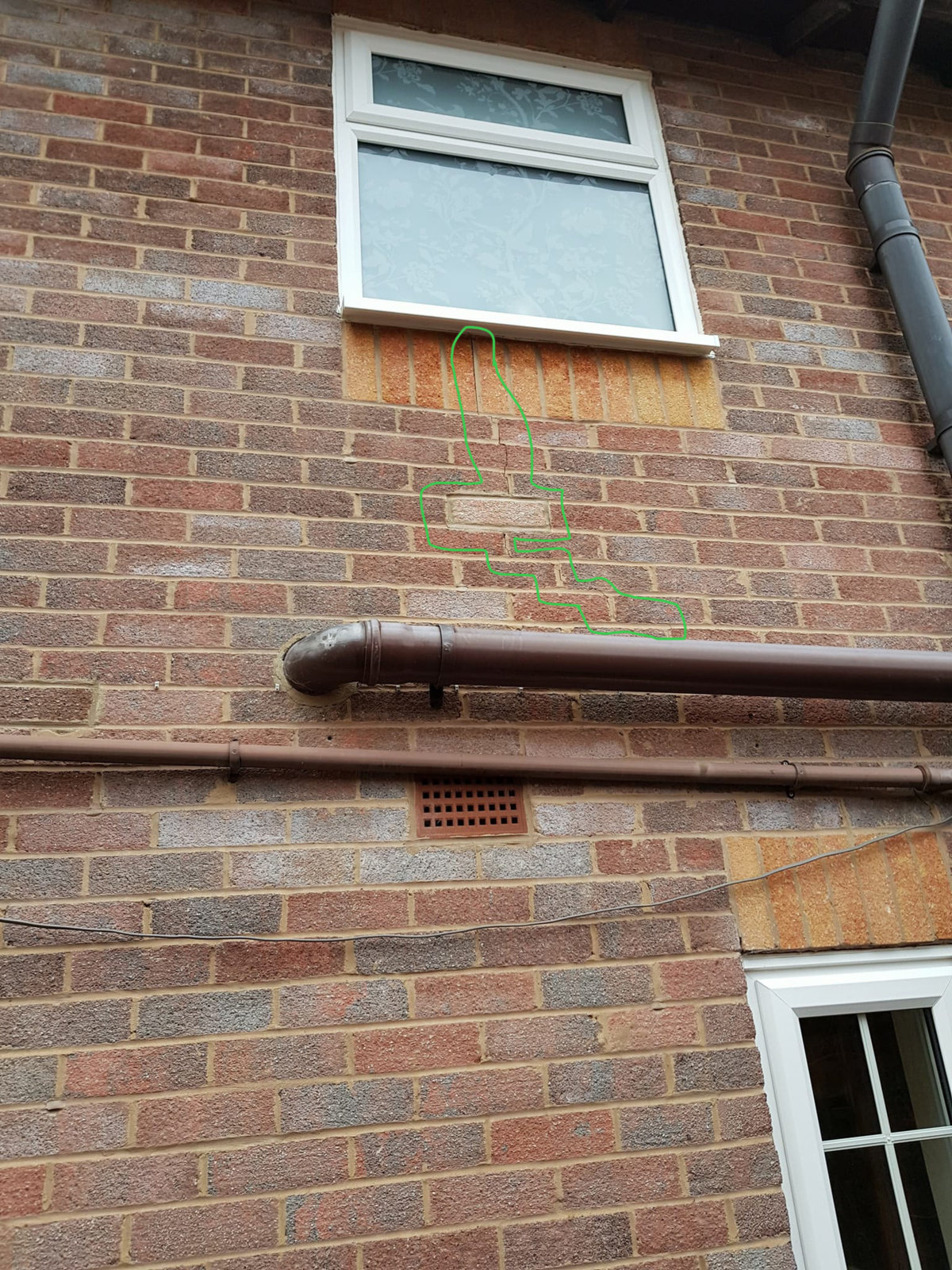

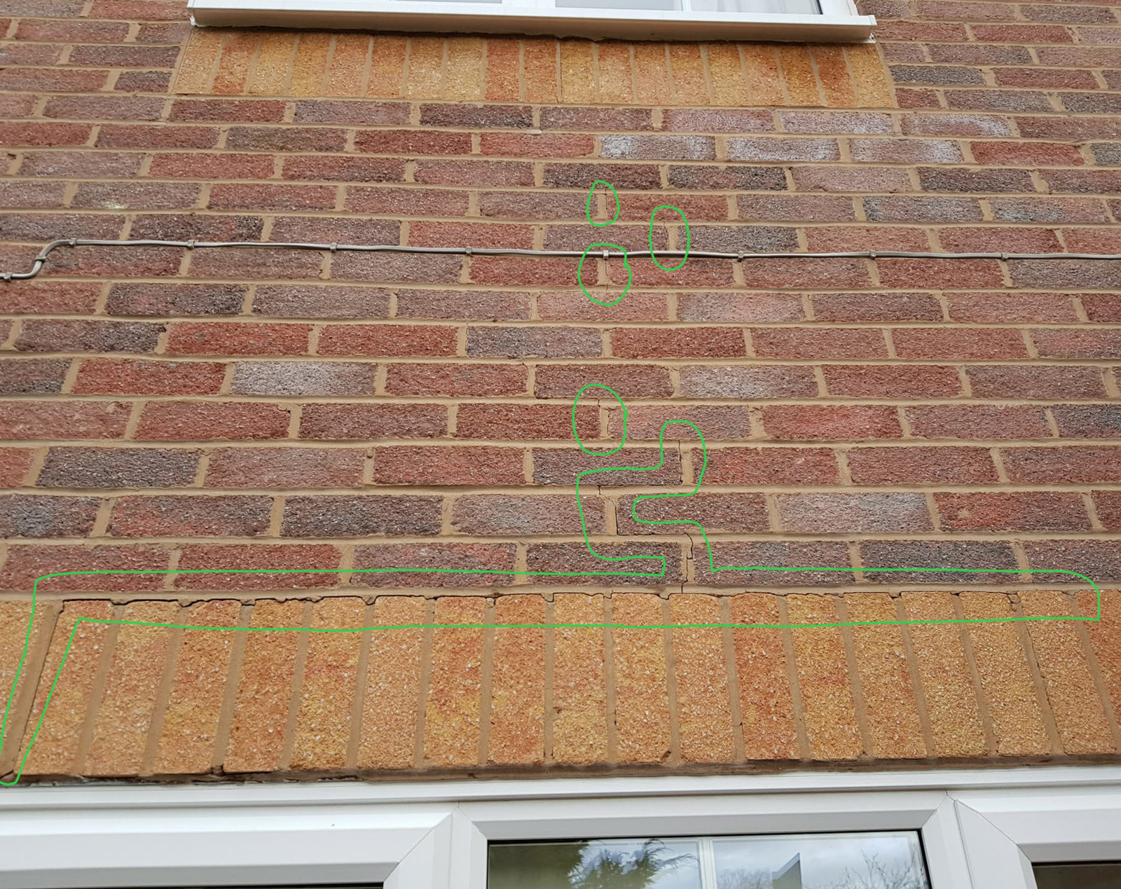

Hi,
I viewed a house today which fits the bill in every way but I am concerned about some cracks in 2 outer walls. Does anyone know these are likely to be indicating subsidence please? Thank you for any advice!
Sorry about the dodgy outlining!

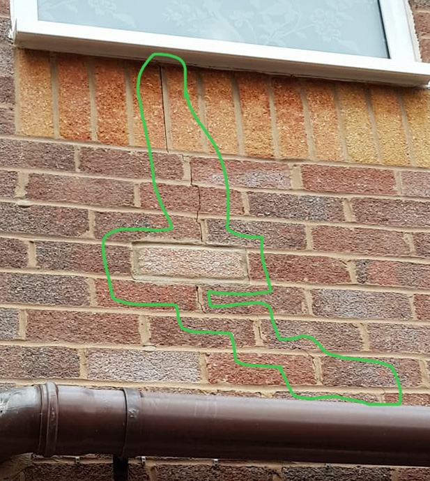

Close up of one I'm most worried about, looks like a brick has been replaced?
Wider view of same area.
Cracks along the mortar and above the window

OK an almost vertical crack between ground and first floor window? Any indications of any sorts of cracking below the ground floor window?
Any internal cracks?
If we step back from the dreaded word "Subsidence" ? what is it? it is the vertical downward movement of the foundations, the images posted are all between ground and first floor in what appears to be a relatively modern property? about 10 years old???
Is the wall in question South facing?
From the images posted the cracking appears to be simply thermal movement, that is the elevation does not have a movement joint?? is the crack roughly central on the elevation??
if it were to be Subsidence then i would expect to see cracking from ground level, not between ground and first floor?
Sorry for all the questions
ken
You need a structural appraisal from a suitably qualified surveyor or structural engineer - don't rely on a standard building survey though. There could be several possible causes for that type of cracking, and you wont get a diagnosis here.
Corresponding internal cracking would more concerning than just external cracking - which could be innocuous.
Many properties have cracks, and these can be fore several reasons, so don't automatically let a property go that is otherwise OK. Get a survey if you like the property.

There were no cracks at all below the ground floor windows.
No internal cracks visible anywhere.
I think the property was built in 1995 ish, it could be a bit later though.
The wall with the waste pipe is roughly north easterly facing and the other one is south westerly.
The cracks are roughly central on the NE facing waste pipe wall and left of centre on the other SW facing wall.

Not sure about the first one, but I suspect the 2nd one may well be a lintel issue, but as the house seems quite new, there should be one there.

What have the owners said about the cracks, as the first crack appears to have a new brick in it 4th course down.

You can see lintels in the picture.
Any property with cracks would normally need a structural appraisal. So as a buyer there will always be a cost. So don't think that if you walked away, you would not be potentially in this same situation at the next house.
Don't be put off by cracks. Buildings move, and cracking is common and more often than not, not an issue. But there are occasions when there is ongoing movement, as that's why a survey is needed to determine what's what.
