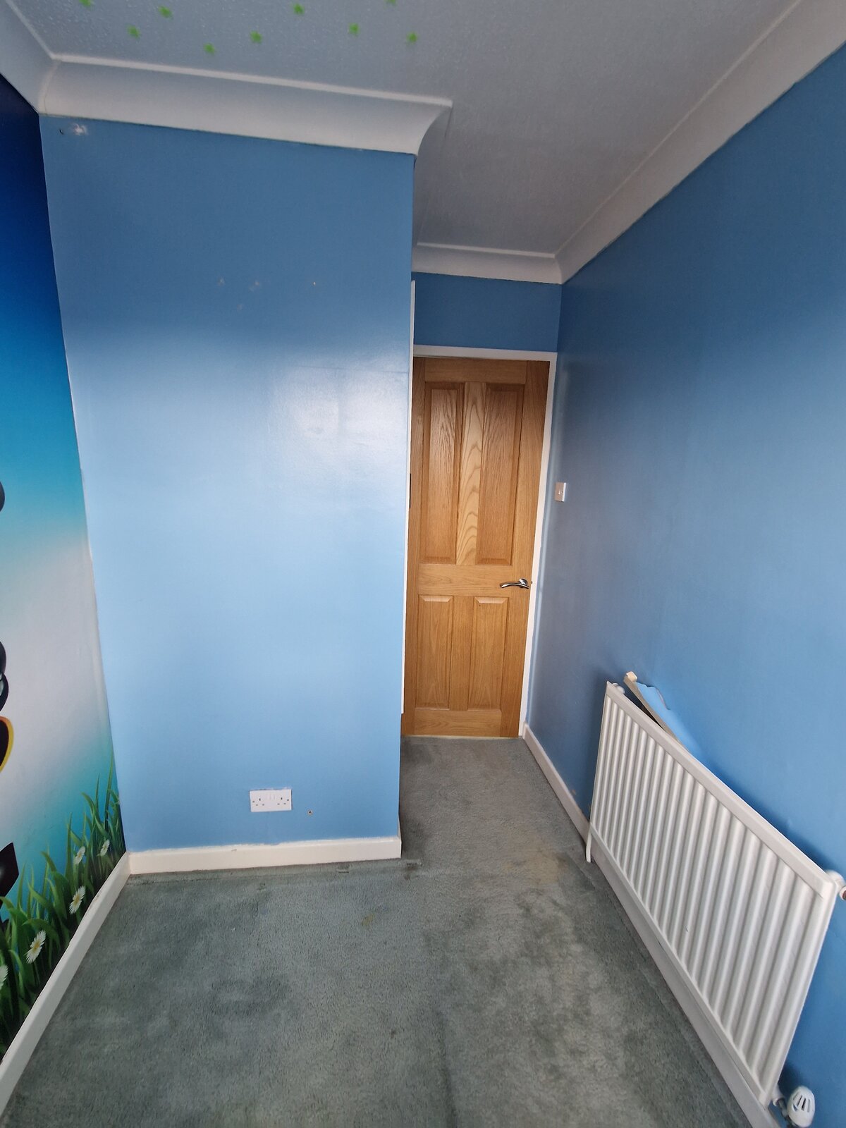

This is the bedroom for more context, wall at back with socket on is the one I wish to remove.
Thanks for the pic, now I understand.

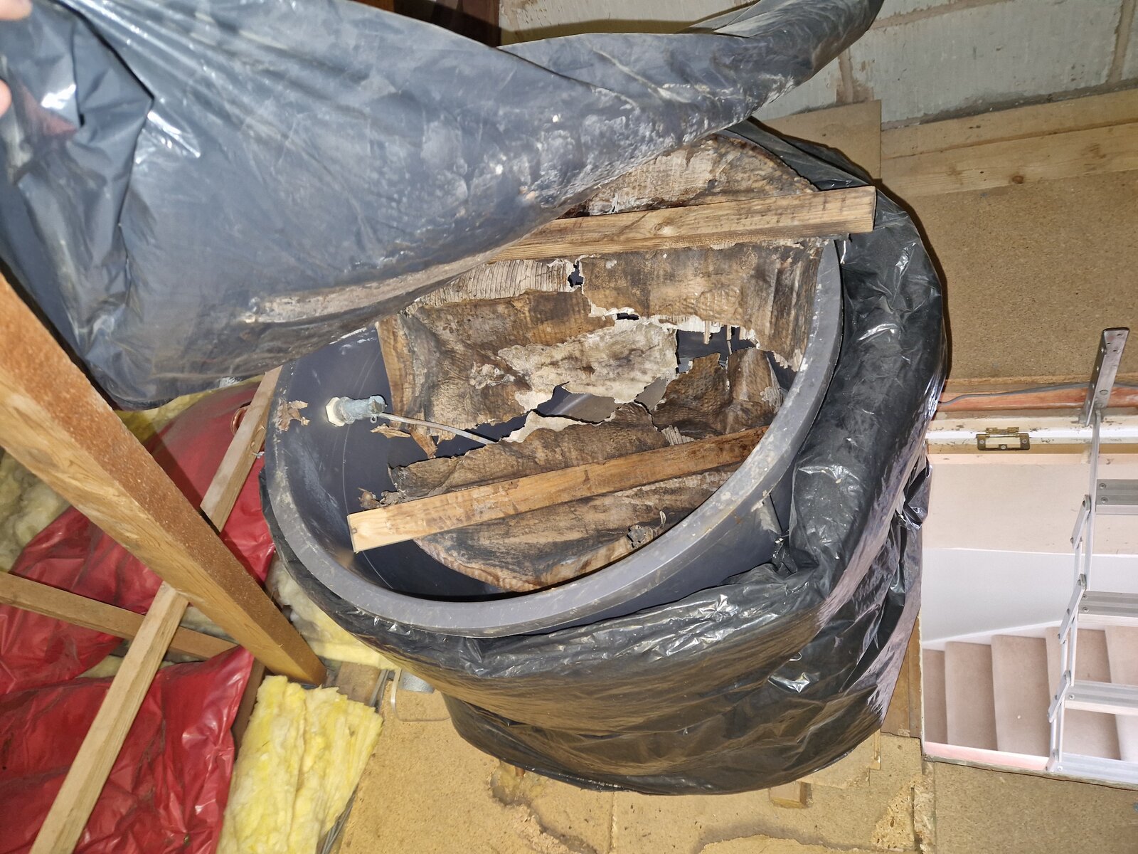

It's a plastic tank in the loft which is already empty. It's just too big to come down through the hatch! Might cut it up and bring it down if I feel like it. I need to get rid then!

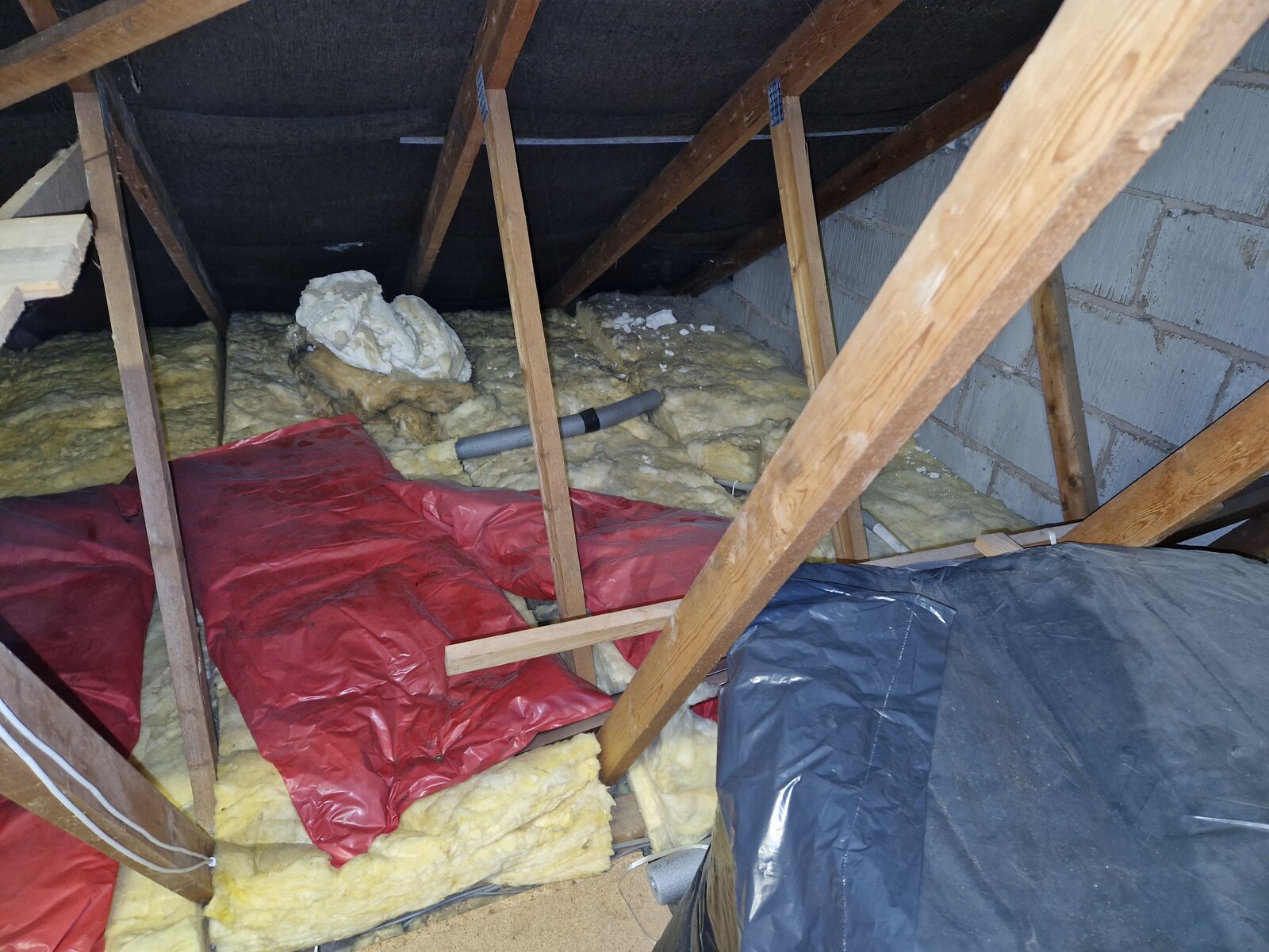

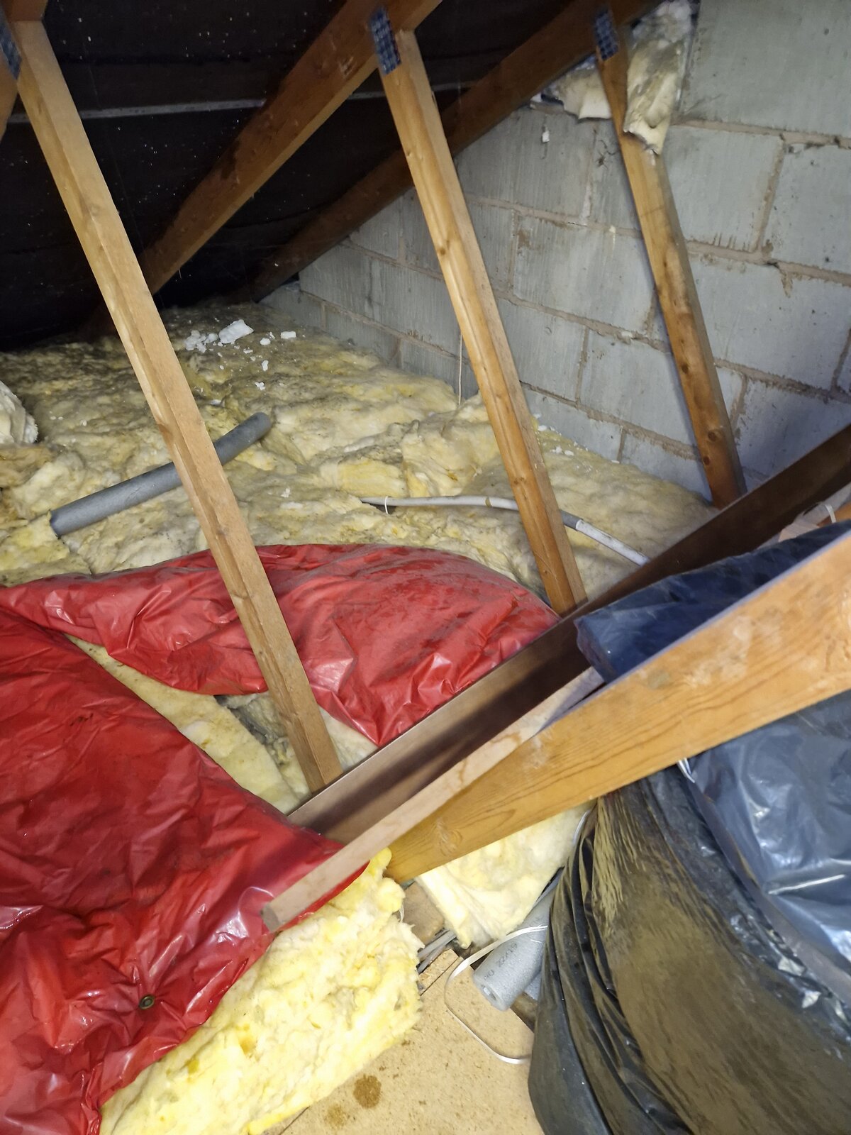

Looking in the loft I have these rafter supports coming into the joists. Does this positioning suggest the wall is load bearing in the bedroom?
Surely not?
They're tied together and into the joists with metal ties.

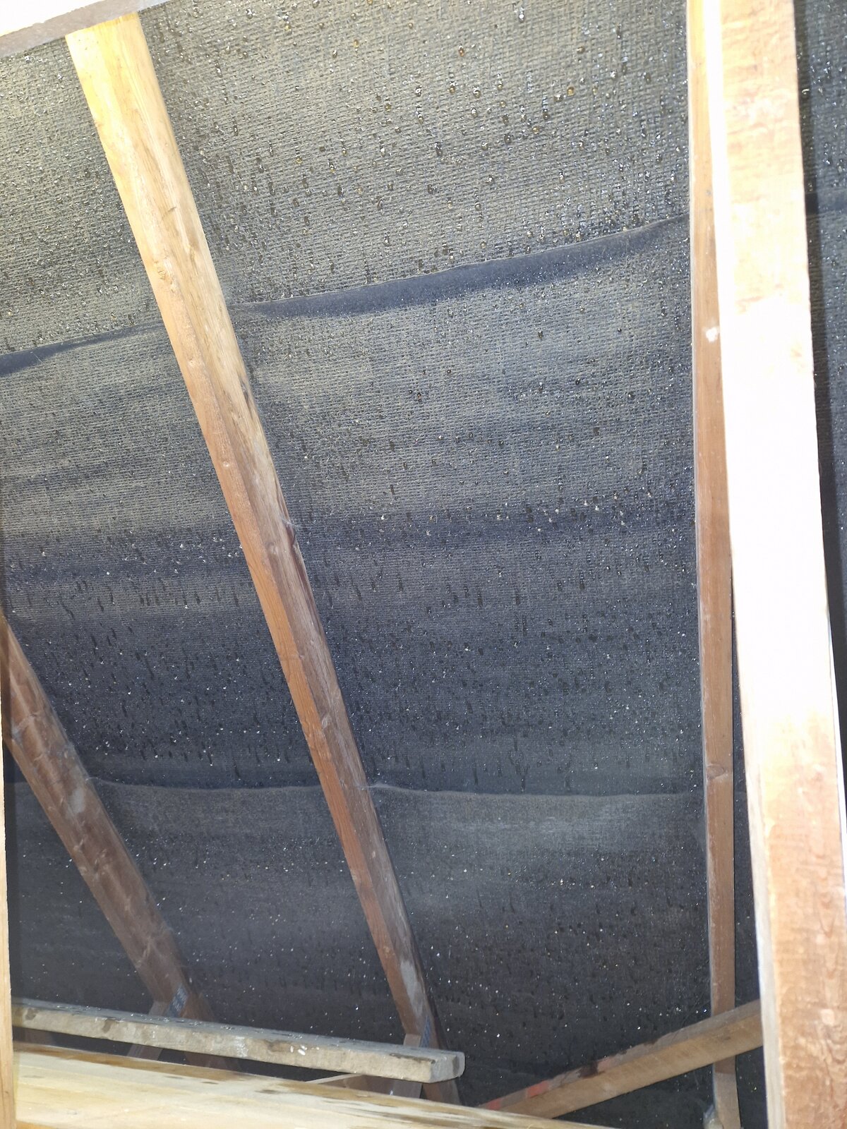

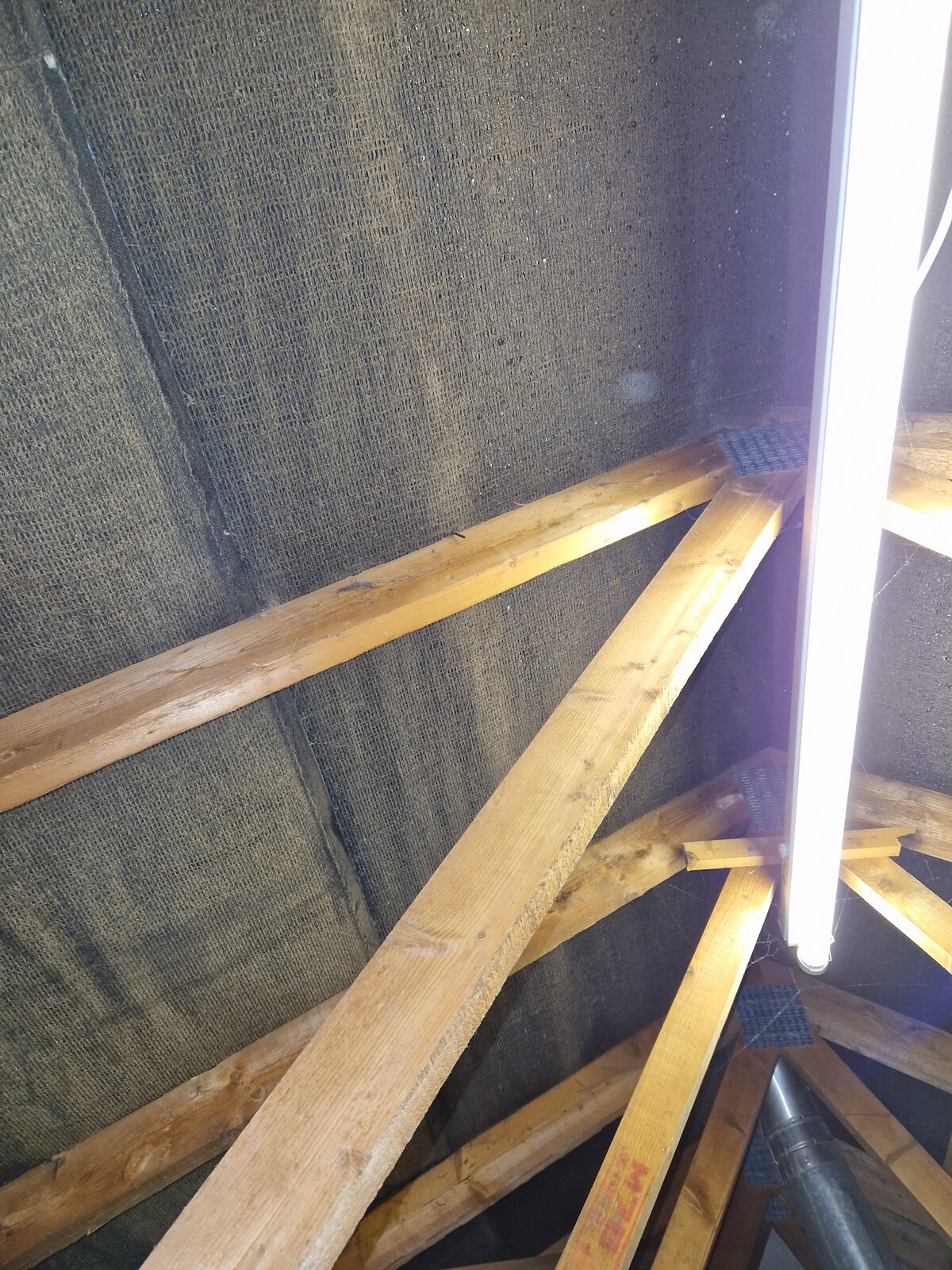

Also noticed there's condensation in our loft. It's finally below freezing today so presumably why I'm seeing it. It's visibly dripping from the roof.
Is this down to the insulation not allowing the house to breathe?
The roof trusses you show have built-in ceiling joists - they were sometimes spaced 24" c/c.
I cant say much more because I cant see much more? But your probably OK with the plasterboard pinned to the trusses.
The condensation is a result of unusually cold weather and a very warm loft.
You should try to seal off your loft from heat rising from the house.
