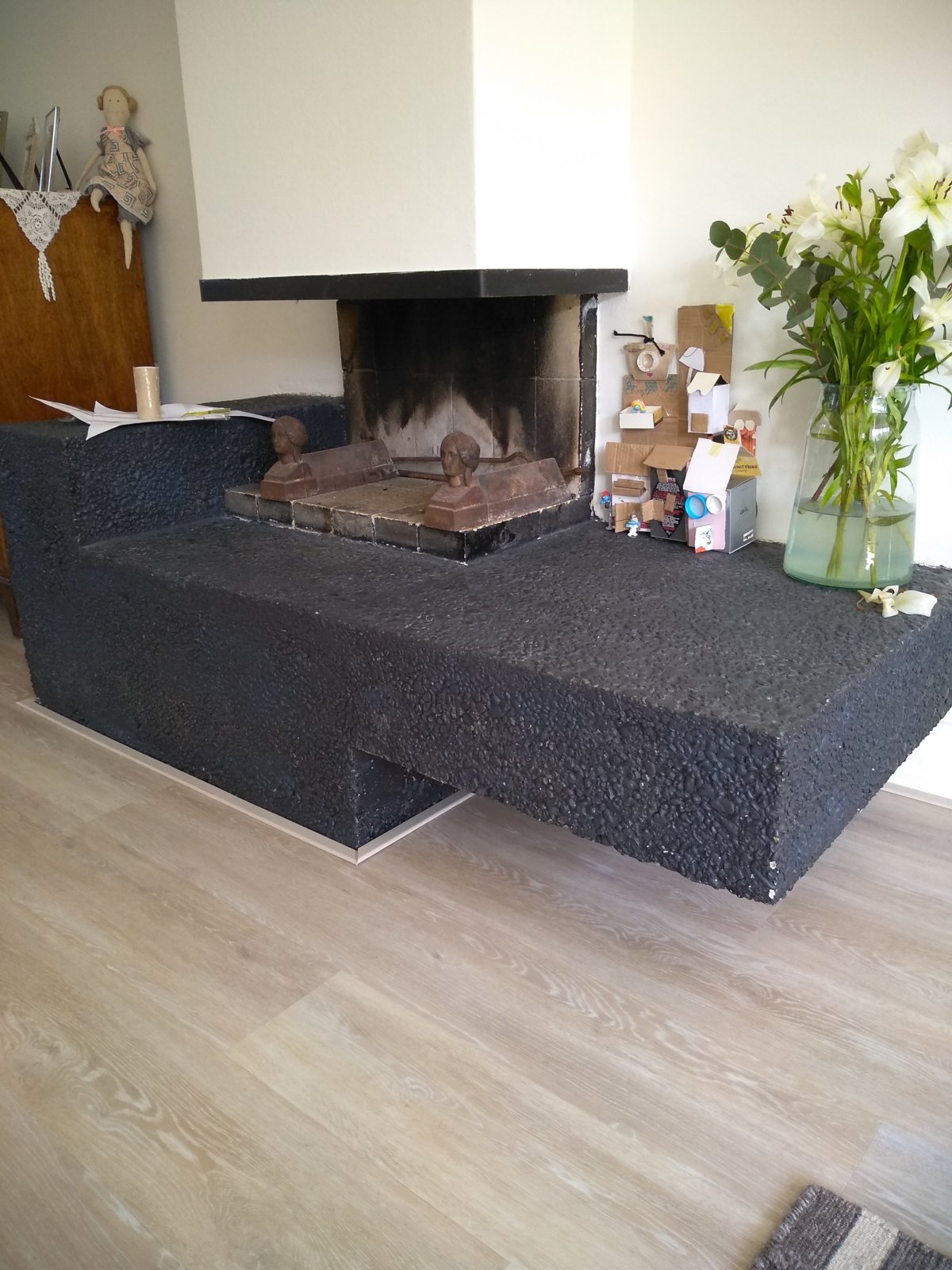

Hi, I have an old fireplace with a large concrete base in my living room. A large concrete piece is overhanging been attached to the wall. I want to remove the overhanging concrete piece to square the base. I do not want to create a lot of mess.
Any ideas how to cut it? I have plenty of time to complete it. I can work few hours every weekend until Easter. Can I use a hand saw like the ones used for aerated concrete?

The only way you will ever know is to try it. I doubt that you will cut that with a handsaw though and any other way is going to cause a mess, lots of mess and the cut edge, probably, wont look very nice.
There is no mess free manual way to cut that.
if its concrete made with flint aggregate and prob with reinforcing bar, only diamond will cut it.
flint is harder than steel, so you wont cut it with any hacksaw blade.

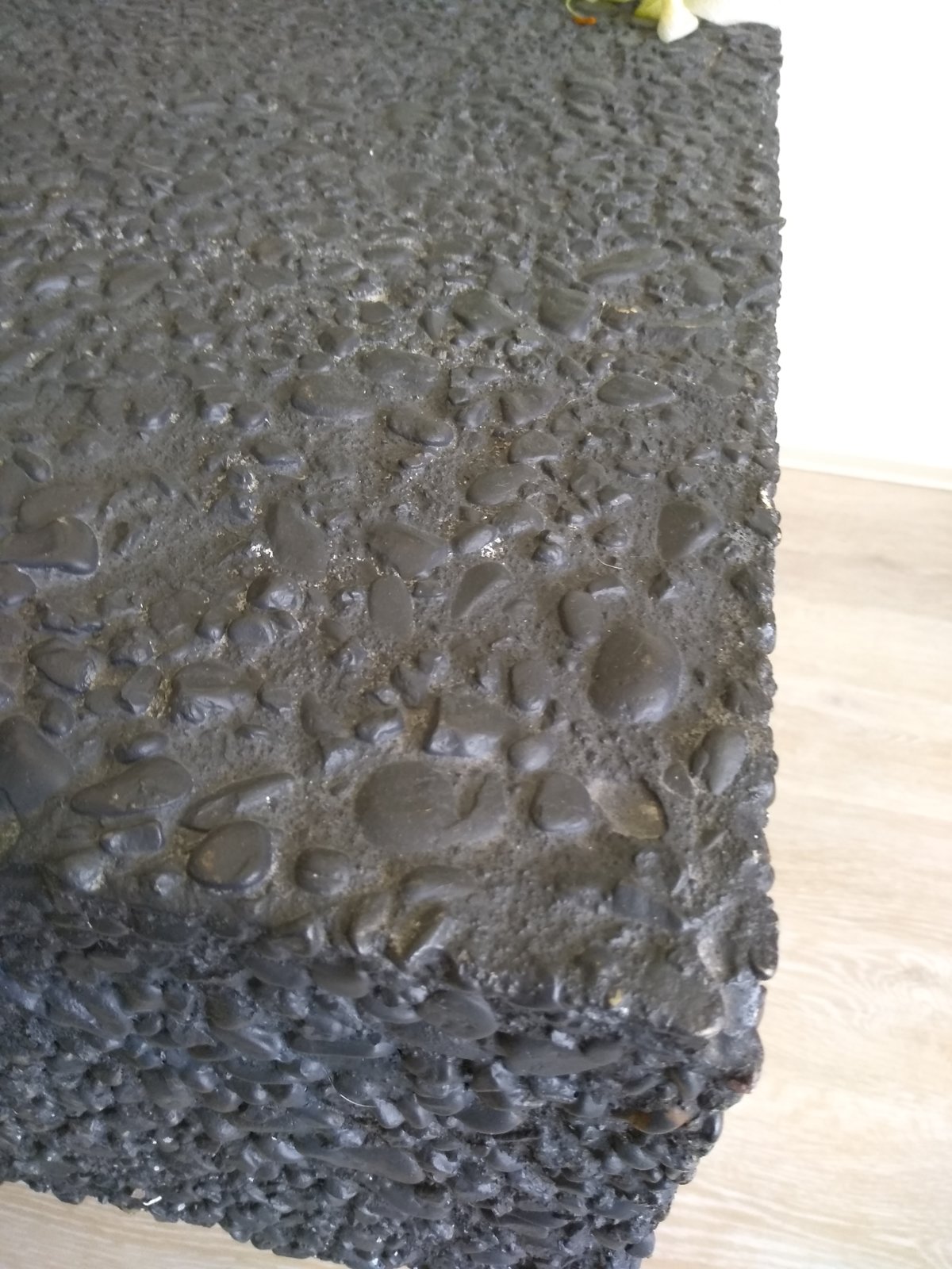

here is a closer picture of the concrete block.
In there any angle grinder with good dust extraction system?

I imagine that you will repaint it afterwards? If so, you maybe able to use a method that doesn't give you a clean cut, and patch it aftereards. That means a manual method, or the use of a breaker, maybe an option. Still messy, but not as messy as using a diamond blade in an angle grinder.

Yes, I will probably add some decorative tiles or firebricks or so. I do not need a clear straight cut. Just to remove the big chunk of overhanging concrete.
what the breaker option? using wedges or hammering with a chisel?
A rotor stop SDS drill, pneumatic breaker or even stitch drilling it then using a lump hammer and chisel could work. Even if you take a bit at a time, rather than trying to just break it at the joint between the base and the overhang.
It's a hell of a lump to get through, but that is how I would approach it if I didn't want to make a huge mess.

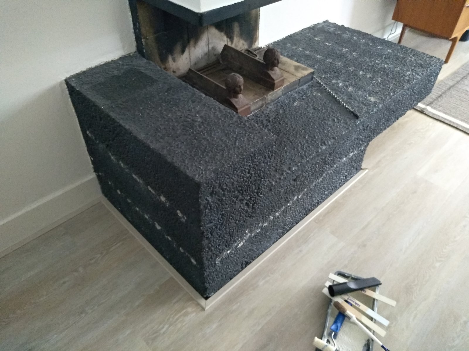

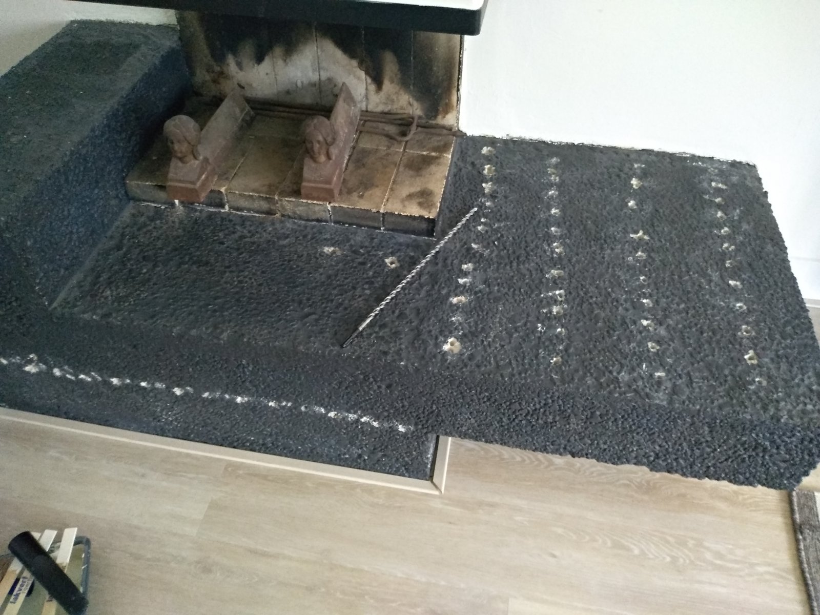

I started drilling holes in 40 cm depth. Later on today I will do some more. then I will try to brake it with homemade wedges...
your thoughts always appreciated...
