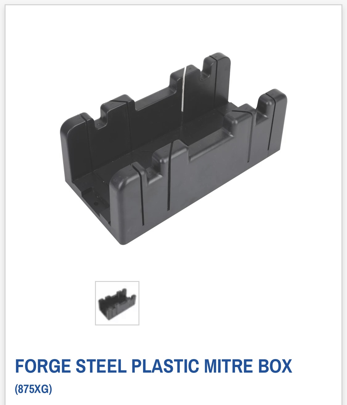

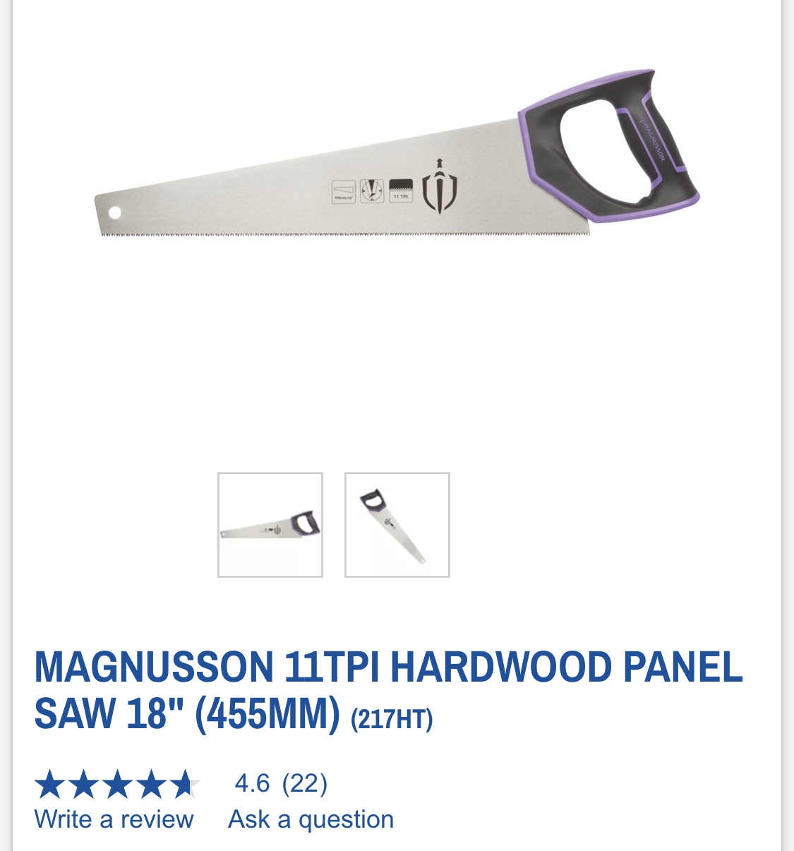

Or forget the power tools and get some triceps in :D :
If you're accurate you don't need the block: just clamp one leg to another and use the top of the leg as a guide for starting the cut. I'd say buy a new saw so you reduce the risk of cutting a curve if your old one has lost its set on one side

What the hell is a 'Forge Steel Plastic Mitre Box'?

You might want to buy a new one before doing this, unless you like the ragged look (and a new blade will probably cost more than a hand saw and mitre box)
Cut slow and still expect a mess where the blade exits, compared to a hand saw
So I elongated the riving knife adjustment slots and that works now but It seems the base plate is slightly bent and the saw isn't cutting at 90 degrees. I've got a 4 inch mitre box which I don't think has ever been used, so I'll give that a go. It's good to have other options.
