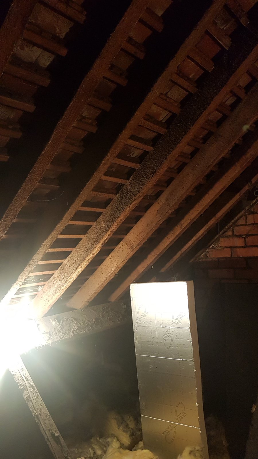

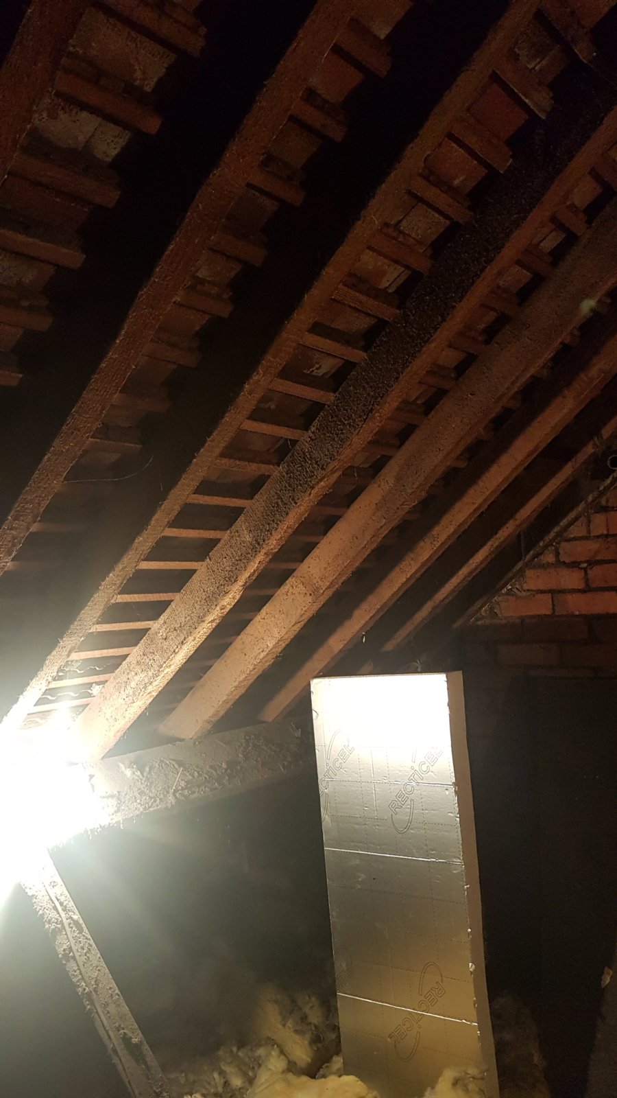

Installing a new Velux roof windows in the loft.
Need to cut two 2x4 rafters for a 1000mm opening, rafters are app. 300mm apart. Purlin is 7ft down from the top ridge board. Rafters are appr 14ft long. Standard flat clay tiles.
Question - as I need to double up on the side rafters around the window opening and can't place a full length rafter due to the purlin being in the way, can I cut the new rafter from the ridge just past the purlin? If yes, what distance can I go past the purlin, 1ft/2ft? What would be the best place to cut the existing rafters, 1ft/2ft up from the purlin? I would like to place the window as close to the purlin as possible.
Please see the picture, the window is to go between the strut and the board.
Thank you
Some would say that with that perlin being there, you could leave the joists as is, and others would say just fit a new piece from the perlin upwards, but you could also fit it in two stages, one part going downwards, and the other part going upwards. As long as it's well secured, the Perlin being there would negate the need for it being in one continuous piece.
get some one around that knows what there doing you will need to cut out 3 number rafters to be able to form a 1000 opening
can you not get a couple of standard size veluxs you only need one rafter cutting out so no need for doubles just trimmers
Thanks doggit, that's what I thought. it's probably not needed but I want to be 100% safe. How far do the rafters need to overhang the purlin?
Bobsuerita, The rafters are not equally spaced, some are 35cm, 30, 25, etc. There are couple of spaces to fit the 94cm wide windows with two rafters being removed. The one I've chosen is next to a couple of middle rafters at 23 and 25 and 700mm from the chimney stack.
I didn't say it wasn't needed, but I was warning that some might; I think you're being sensible. In your case, it's not going to be a case of how far do the rafters need to overhang the purlin, but how best you manage to get them in. Measure above and below the perlin, and that'll give you the longest length that can be slotted in, and it'll be a bit of a wood puzzle job really. If the Purlins in the middle, then just put in 2 7ft sections, and trim a bit to get them under the purlin. I don't think it's essential that they go top to bottom, but work it out as you go. Put a support across the rafters you're going to cut to keep them in place, and then fit a double trimmer above and below the window opening.

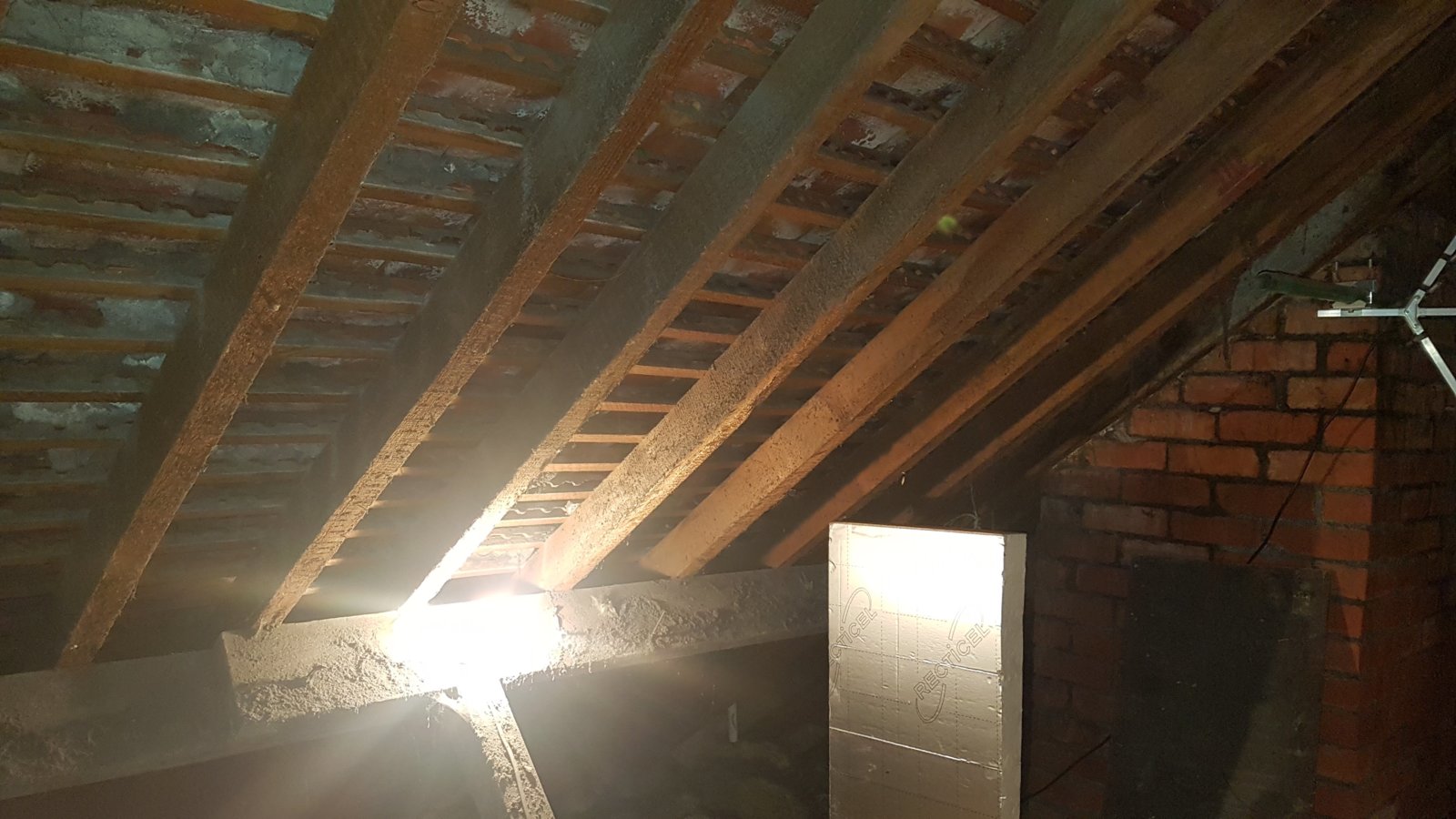

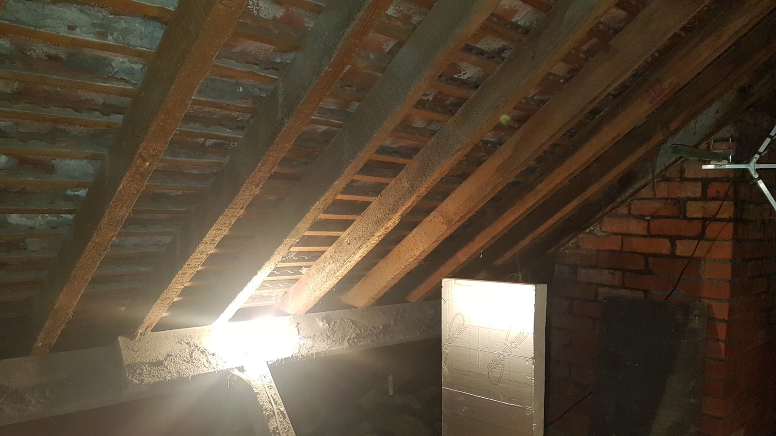

Here is a better picture, 700mm away from the chimney is important BTW as there is a wood burner chimney present and must be greater than 600mm according to the J Reg
Except that you've still got other rafters closer than 700, so it's not actually that important. The distance is only relevant by the wood burner, not at that height.
Your purlin is acting as your bottom trimmer so doubling up in this instance will only be necessary to supplement any roof elements that are above the head trimmer of the Velux window. It may just mean fitting a deeper pair of rafters either side of the Velux which may be a wise move in any case. Are you converting the loft?
The trimmer rafters do not need to go beyond the purlin.
