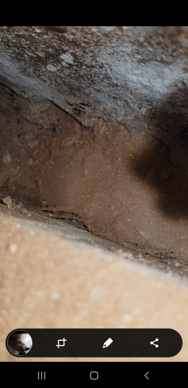

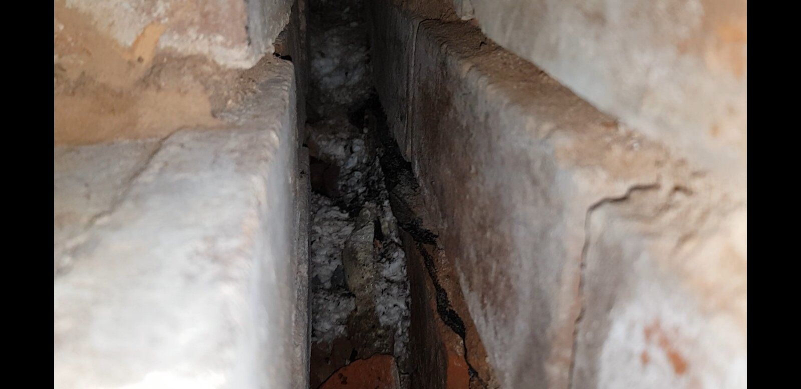

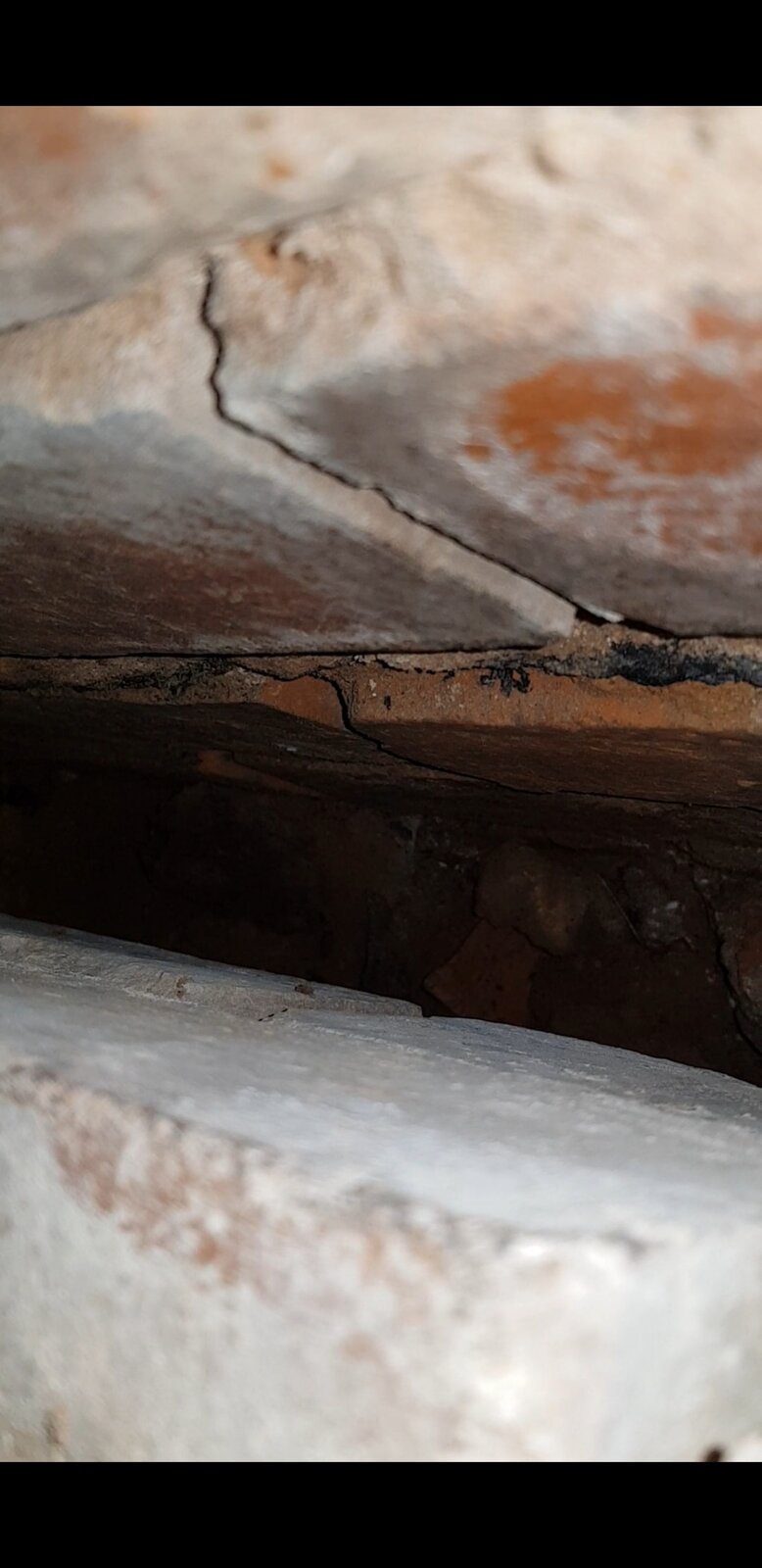

Took a deeper look today.
The cavity was completly bridged by 2 bricks above inner dpc with broken down mortar, sandy stuff, rubble, crap all mixed with insulation..
I pulled a few bits of insulation out at floor level a few more bricks along and although it was a little moist in places it was by no means soaking. And the insulation appears to be in good order.
What i didnt notice last night was that the inner dpc was actually one course of bricks lower than the outside. So when i thought i had cleared a lot out, there was still a lot more to go!
I will get some pics up as i took some of before and after
I have a builders canister vac, and poked the tube down the cavity to suck out sand, snots and broken brick. It can lift a half brick. The metal tube will loosen or break up blobs of mortar
hey john, i got the good old henry out mate. it's doing the job well but blocks up a few times with the big stuff. filled quite a few hoover bags.
here's a few pictures. to be honest they dont do it justice for how filled it was. bear in mind the slate that you can see, is the outer skin, as it's higher up. the inside DPC is a brick down at least, so it was filled good and proper!
i am still a little worried about insulation dropping down below again but to be honest, its not really insulation alone i have sucked up. its pretty much broken down mortar and snots/ old plasterboard.
There's a badly corroded wall tie in there. i have not seen one that bad anywhere else in the house so far
