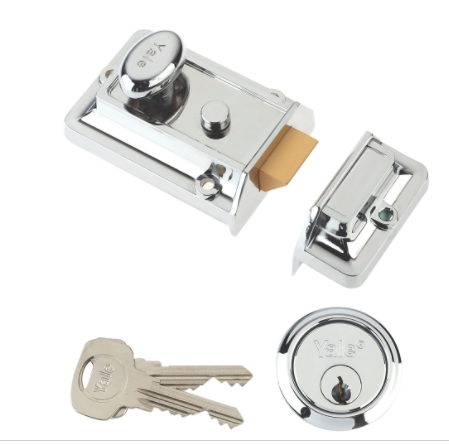

Thinking about adding more locks to our various gates, newly installed ladder brackets, etc. But I really don't want a priosn-guard key-ring because I know I'll not both using locks if it's a PITA.
I would love the same key to work in my garage door and also a bunch of padlocks but how can I do that? What is compatible with what? I know euro cylinders are widely used but this is the sort of lock I've got on the garage now, is something like that going to let me use the same key if I switch out the cylinder?
you can buy padlocks to the same key easily. If you want to use them outdoors you would do better with padlocks having brass levers. They are much more durable than cylinders, and generally stronger too. You will first have to decide what level of security you want to pay for.
You can buy Eurocylinders to the same key, and, if you buy from a real locksmith, can have your nightlatch (of the same brand and range) altered at additional cost. However a nightlatch is not a secure lock so consider getting something better.

Realisitically fairly minimal security is OK, but I don't understand which types of lock could be made to use the same key. The lock on the garage failed and I replaced it but swapped the barrel for instance. To get to this door you already have to get through a locked gate, and the door is not very sturdy anyway! We're talking casual thief deterrents here, scrapman, etc.
I had seen you can buy padlock chassis for a euro cylinder which made me think that might be the way to go - my fear was otherwise you buy some matched padlocks and then later on want another one and can't get it on the same key, over the years you end up with a mismatch. Padlocks are expensive, even not very good ones, so I want to be able to set myself up for future expansion/replacement.
