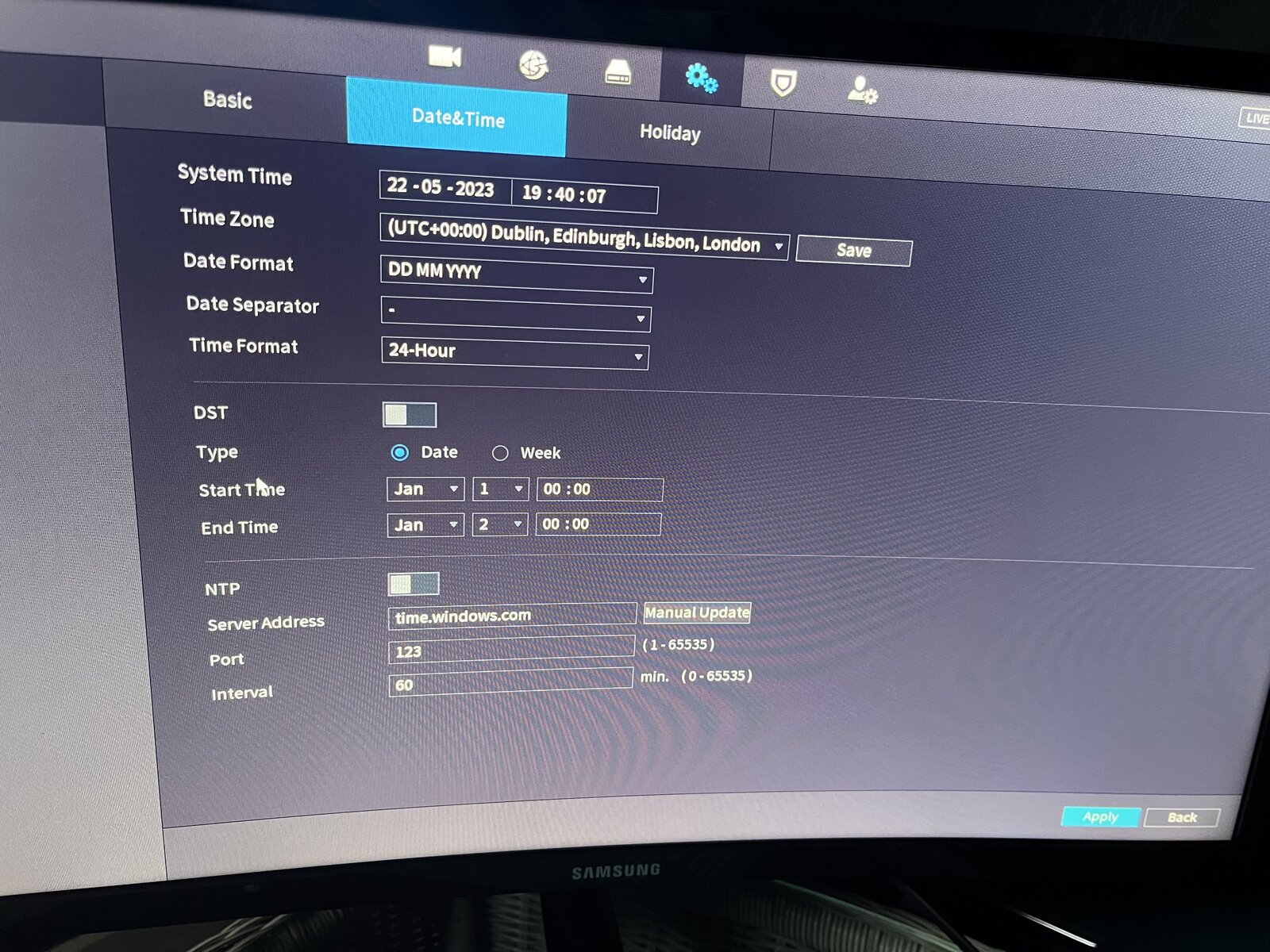

I’ve got dahua cameras and i use the DMSS app. Since the clocks went back they’re an hour out. I’ve changed the time umpteen times on the hard drive, clicked save then apply (and apply then save) but after a few hours it reverts back. It’s only really a problem on playback after 11pm and i think by the time i suss it the clocks will go back. Any help appreciated.
Not sure. I’ll check when i get home. Thanks.
Is it simply a case of checking that box and changing the summer/winter dates ?
Just tried it and it’s worked. Thanks again (y)
