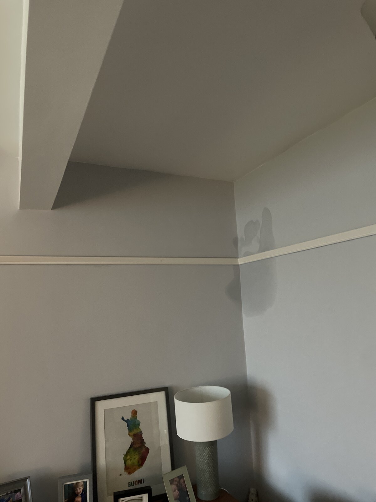

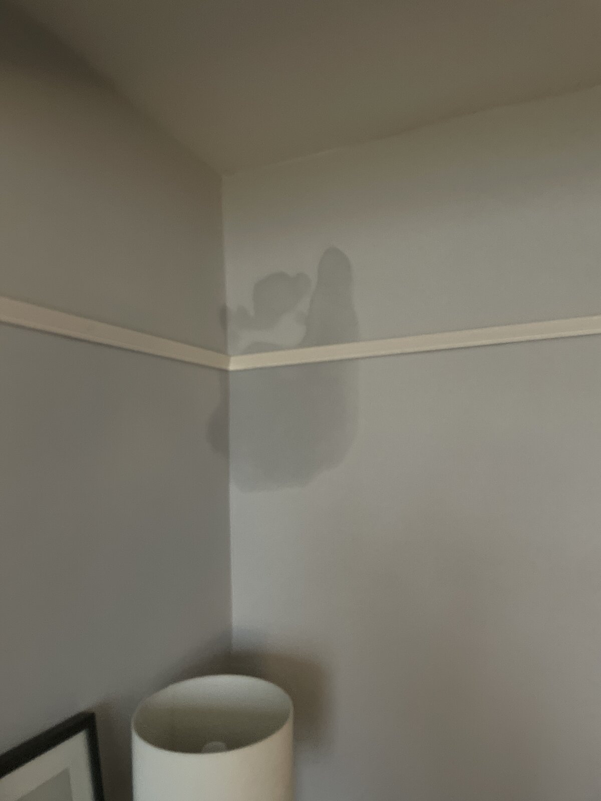

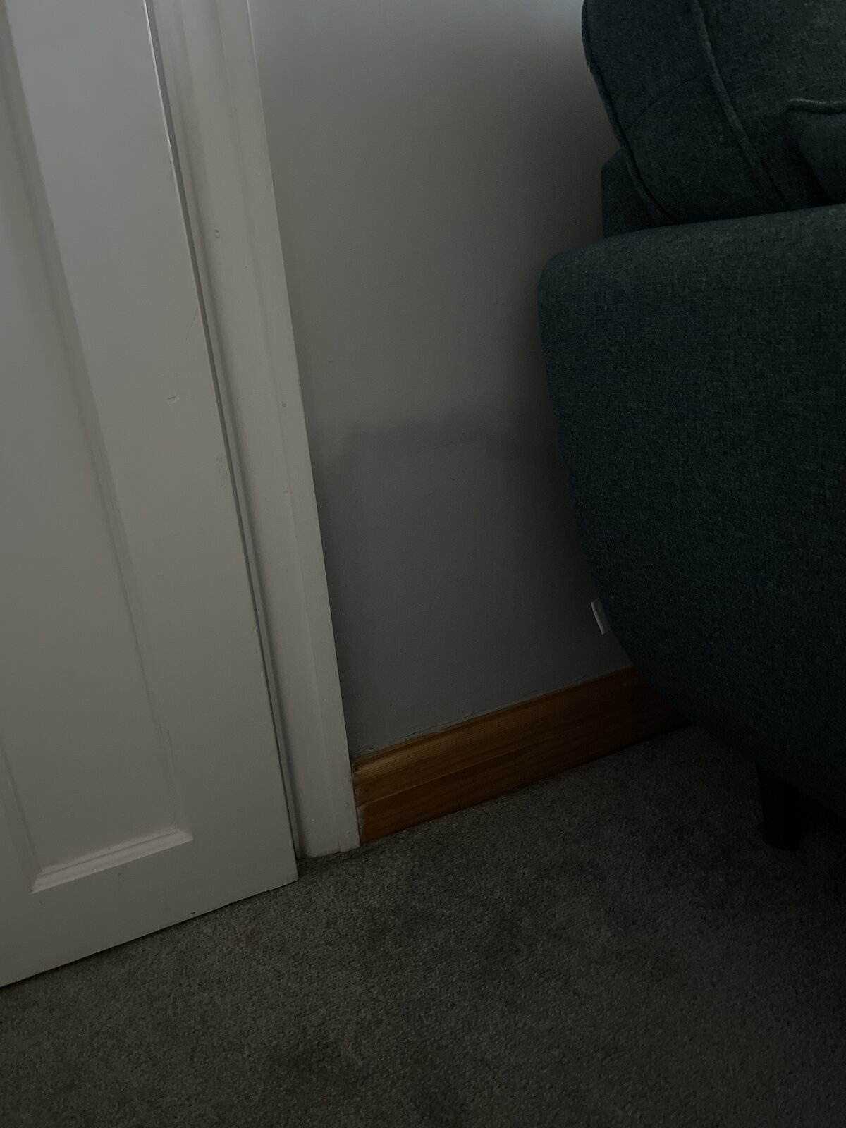

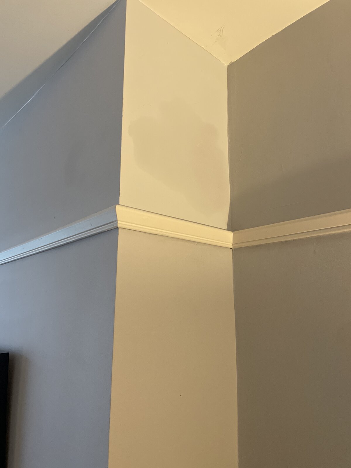

Any ideas what is causing this wet/damp patches in our lounge and dining room please? It’s a 3 bed 1930s semi. This is all downstairs.
3 patches are either side of chimney breasts but one is on the floor near where a door has been blocked.
They fade completely in hot weather but come back get darker when it’s has rained. They only get darker not bigger. They have not spread so I don’t think it’s a leak. We don’t have the same issue upstairs.
A previous owner moved the lounge wall, the door and blocked the chimney.
Chimney recapped recently and roof checked - all ok but it’s still happening. See photos please

Chimney + dark "damp" spots that appear when the air is humid = salt contamination. It'll be in the brick of the chimney as a result of combustion gases and moisture reacting with lime-based building products. When the walls are plastered the evaporation of the water in the drying plaster pulls salts to the surface. In damp weather these hygroscopic salts absorb moisture from the air. I have it in my house. 80% fix has been to paint the wall with a damp seal paint to stop room air getting to the salts. 100% fix has been to strip back to brick, tank the brick with SBR slurry (only the affected area) and fix plasterboard with foam adhesive which isolates - unlike "wet" dab adhesive.

Huge thanks this is really helpful. It’s probably been there ages as they blocked but didn’t vent the chimney back in 2002 ish. We have just repainted ( over egg shell) so I wonder if that was hiding it.

Properly ventilating the flue will reduce the source of water vapour to the chimney salts. Give it time to dry out and see the effect over a year. Try a solvent based seal such as zinsser cover first before progressing to more costly solutions. If you're in more of a hurry board over it with appropriate fixings in plastic wall plugs.

As Blup's advice. Salt contamination gets into the plaster, which then absorbs atmospheric moisture. During wetter periods the absorption is greater, which gives the appearance of a dampness, when it is really just condensation. It's not a roof leak though so save your money there. The only 100% remedy is to re-plaster with a renovation plaster.

Start by venting it as this is essential anyway.
Top and bottom, both flues
It will take months to dry out. Then see what else (if anything) you need to do.
