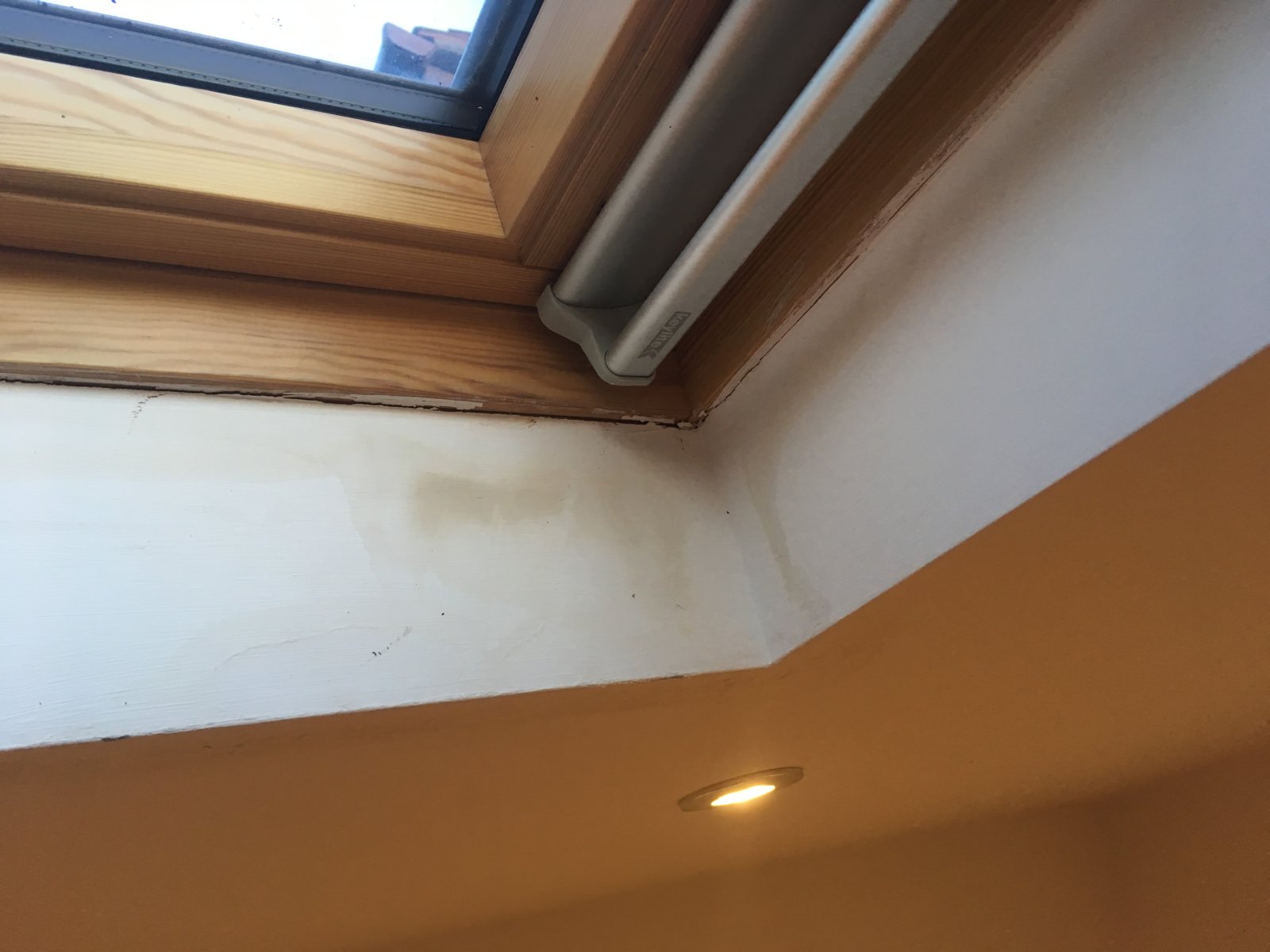

After having an extension built about 4 years, I've just noticed some damp on the ceiling around one of the rooflights. (Its a single storey lean-to extension with a pitched tile roof). We are having a lot of rain and wind right now, however I can't understand why all of a sudden there is something wrong - unless something is failing. My first thought is a lot of moss has built up around the edge of the rooflight and flashing, and whether this could be retaining moisture and some how water finding its way in? Any assistance would be most welcome

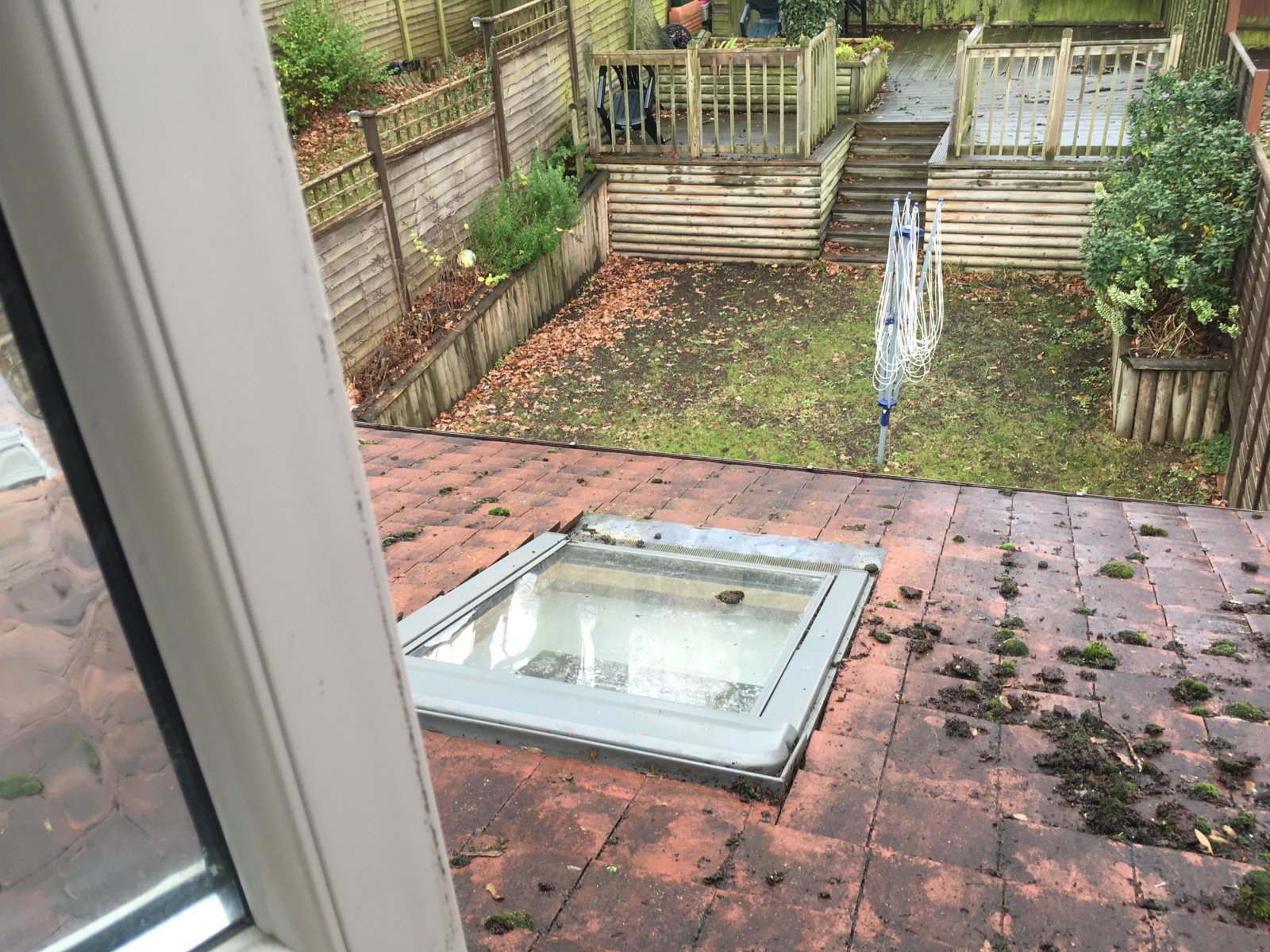

I cleared a load of moss off that was built up around the roof light flashing, and all tiles look sound and unbroken etc. Not checked the flashing at the top of the roof, so will look to see if that is compromised. I’m hoping the build up of moss has something to do with it

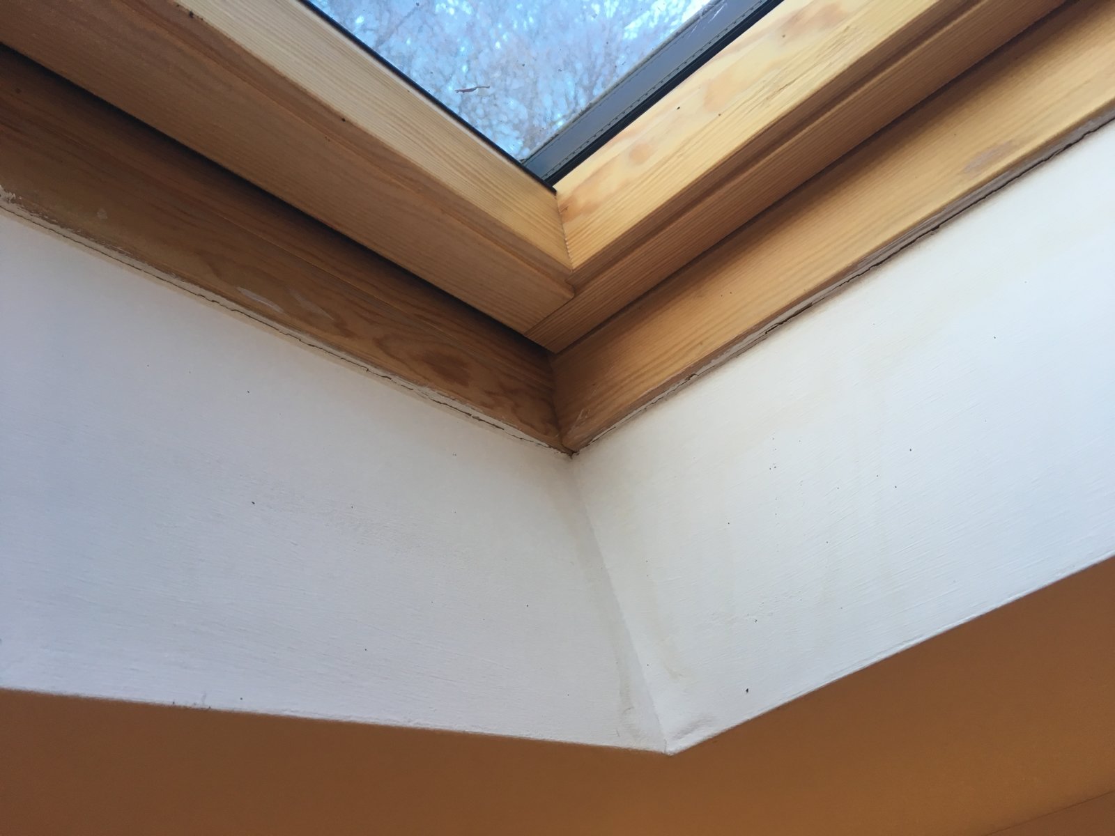

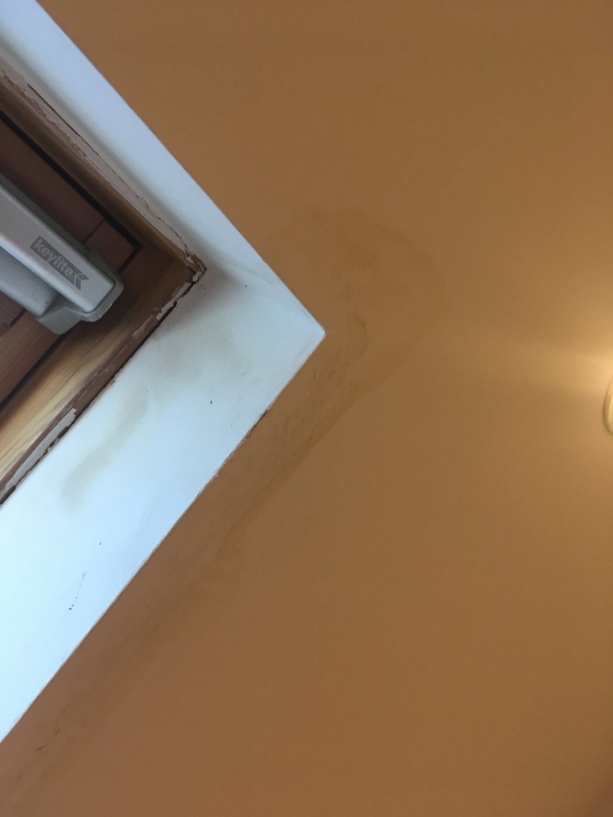

Looking at the pictures it shows damp at the top corners. This indicates to me the underlay isn't totally perfect on the corners of the frame. This then will allow ingress from faults above... lead flashings etc . any pictures looking above?

All the tiles are too tight to the frame, moss will restrict flow and cause dam effect.
the tile course behind the window is incorrectly fitted
