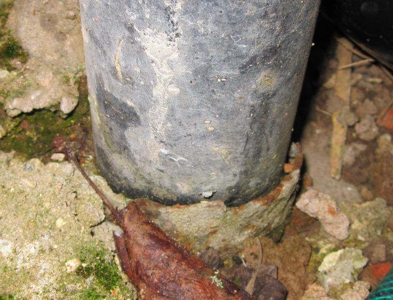

I also noticed that the plastic downpipe outside connects to what looks like a metal socket in the ground - the socket is pretty rusted .....

Here is a close-up of the down-pipe - it looks as though it is connected to a metal (rusted) pipe ?
Dig it all up and have a look. It's pointless all this guessing.

b) Investigate the down-pipe and its rusty metal connection

I reckon that down pipe might be a good place to start.
I have seen similar problems in the past and when I dug it up it only went in the ground 6" and that was it.

1) Would you expect a Victorian semi to have separate rainwater and foul water drains ?
2) If I wanted to rent a drain CCTV - is it possible to cut a section of the downpipe and patch it afterwards ?
They often have a soakaway. Don't bother with a cam - dig de bogga up.
