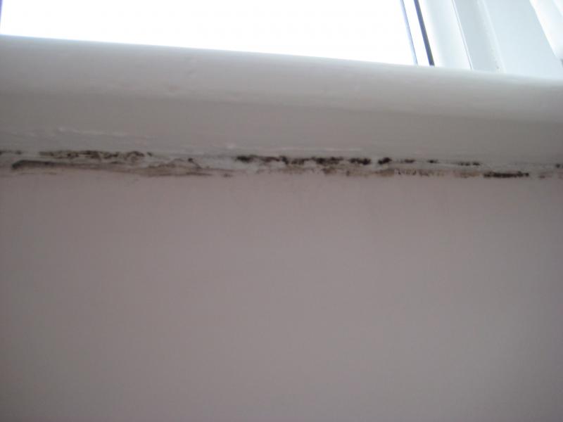

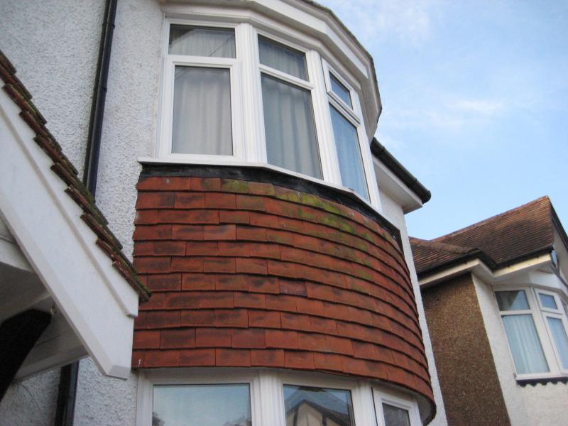

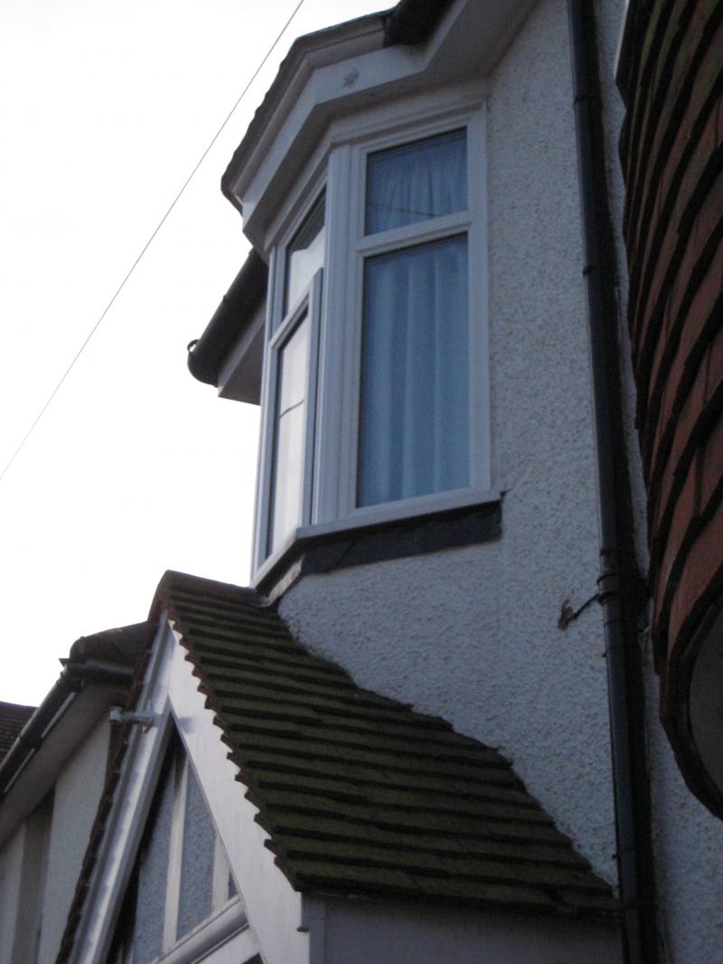

I've beeen in my property for a couple of years and the DG was already fitted but in both front upstairs rooms I have damp problems under the windowsills. The main bedroom has tiles on the outside of the house and lead flashing under the sills. The small bedroom has a pitched roof outside it and also has lead under the window sills.

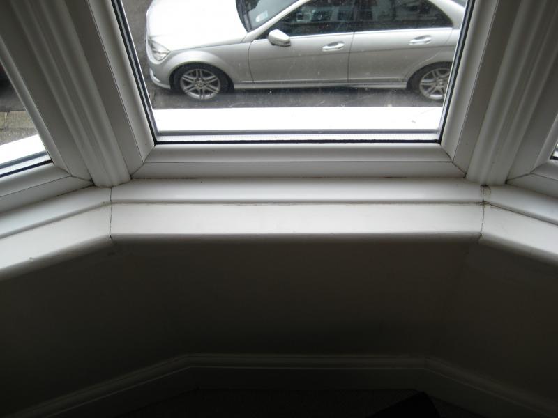

In both rooms it looks like the lead is poking out underneath the wooden window sill in places and this appears to be where the damp and mould grow the worst. We get a fair bit of condensation in the bedrooms which pools on the window ledge and I don't know if this is leaking through the window frame and down into the wall cavity or if the cold is condensating on the lead and making the areas where the lead pokes through damp.
Don't know if anyone has had any similar problems or any ideas as to what the solution might be. I've took a few pics of the small bedroom.

Is that the lead flashing coming all the way through?
If it is then your problem is cold bridging, most likely...pinenot :)

Yes it is the lead coming through, I think whoever fitted the window just bent it in under the frame. Originally I guess it would have just bent up towards the outside sill.
I would imagine this is quite a job to rectify am I right? Am I looking at taking the windows out or would I be able to remove the insde wall and poke the lead back out? I don't know how the frame is supported. The window in the bedroom isn't a brick wall I don't think, my neighbour has a very sinilar house and said the walls were hollow and tiled on the outside. I don't know about the small bedroom.

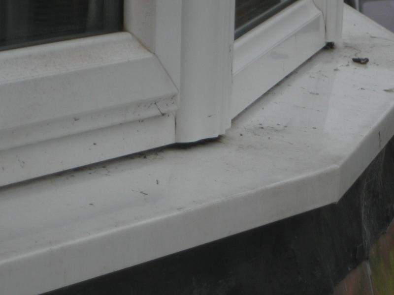

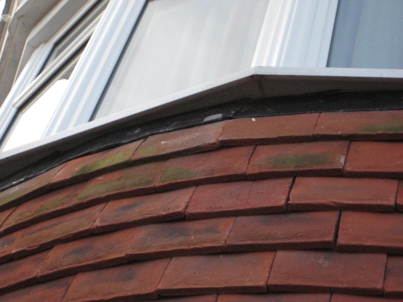

So I took a few photos of the outside of the house showing the tiles and where the lead is. Don't know if they'll help. I took another look over the weekend and theres defo some lead poking through under the sill in the small room, it looks like a wavy line, can't think what else that would be.
Anyway let me know if these help at all.
Cheers
Ian

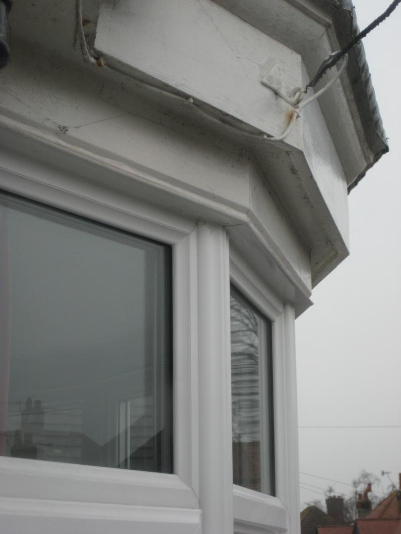

It's more than likely the lead showing internally under the cills is a full width piece with the flashing dressed over those tiles, that complicates things. if you can expose the window head(s) as a means of establishing if the windows can be lifted in situ, it may be possible to proceed without removing the windows.
It looks to me like plastic profile cills, are the reveals also plastic?

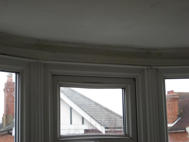

I'm not sure what you mean by window heads, do you mean the top edge of the windows? I've taken a couple more photos. I think it sounds like what you mean is lifting the window in situ off the sill and then dealing with the lead, would that be right, also what do you mean by the returns?
Anyway here are the other pics and once again thanks for your help.
Ian
It's best to control the condensation first before you do anything, very common in the bedrooms when breathing in the room at night
Essentially yes, lifting the windows at the cill, but pvc windows normally have their cills fixed to the window frame, either delivered that way or fixed on site (depending on horn cuts required) So exposing the top of the windows by removing the curtain plates/trim (window to ceiling) we can establish if there's any space to allow the windows to be raised clear of the lead. This may seem like a tall order, but believe me it can be done, but we need to establish the facts first. Also, if you can try to establish how the windows at each end to the walls...pinenot :)
