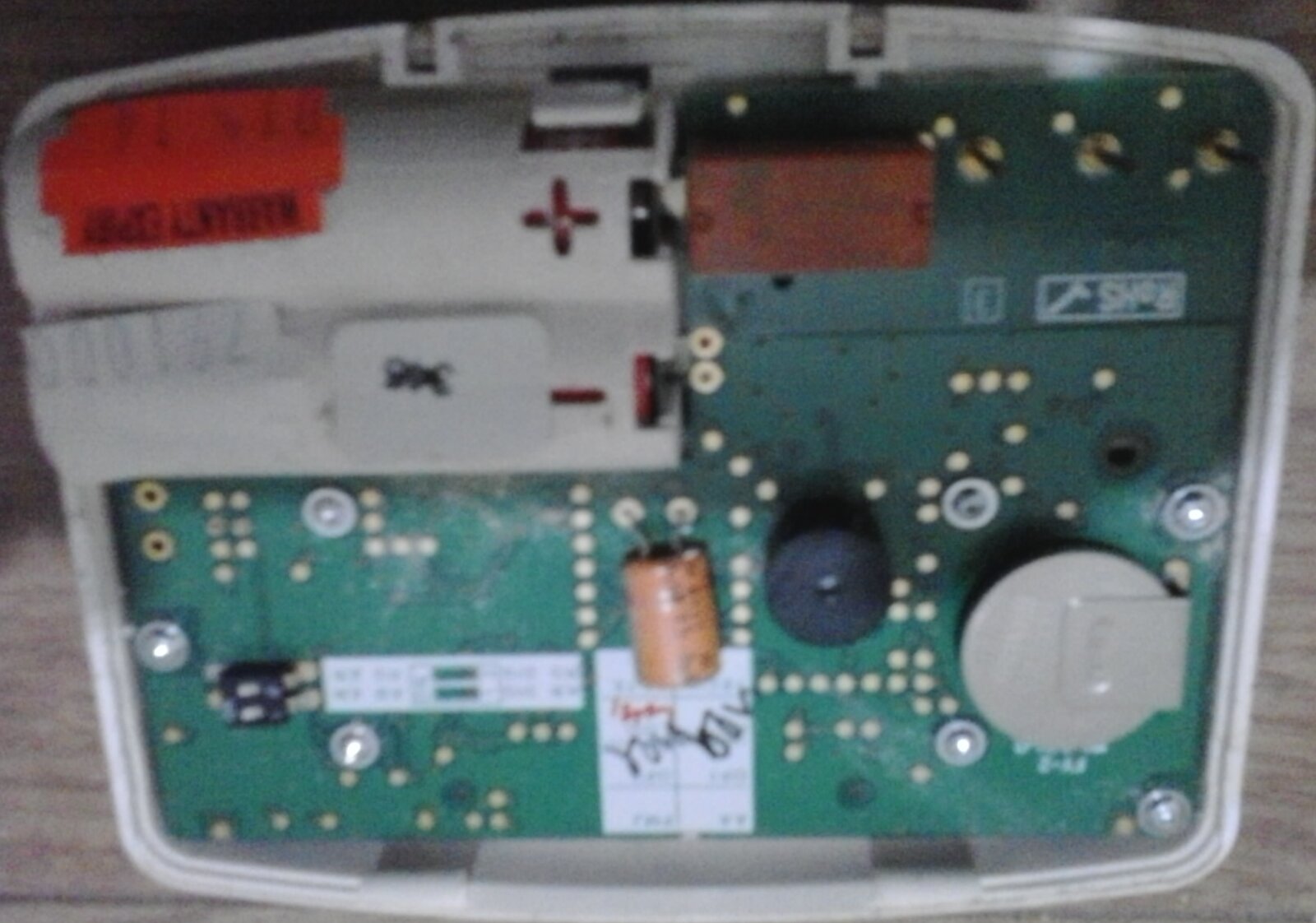

Hi all.
It was working fine and then suddenly stopped working. Radiators not working but hot water is. Workmen were working at the house to repair a leaky roof and I found the property's fuse box cabinet open, so I am not sure if it could be the workmen that broke it or if it could possibly be water damage. I am not sure how to tell which exact model it is but it looks like the one in the picture below.
The display is completely blank. I have tried new batteries but that hasn't made any difference. I have read that if it needs replacing, it needs to be replaced by the same item as it needs to match with something in the boiler (Vaillant ecoTEC plus). Is this true?
Are there a million things that could have gone wrong with it or can anyone suggest the most common likely issues?
Thanks.

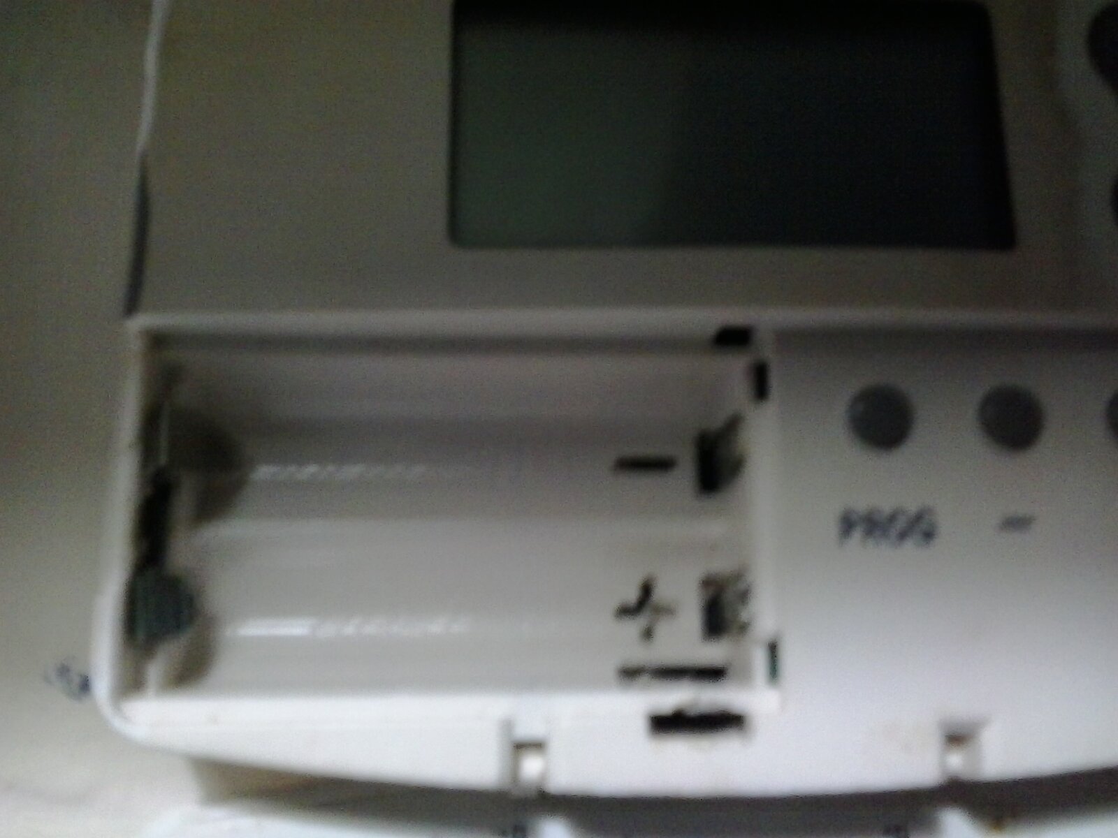

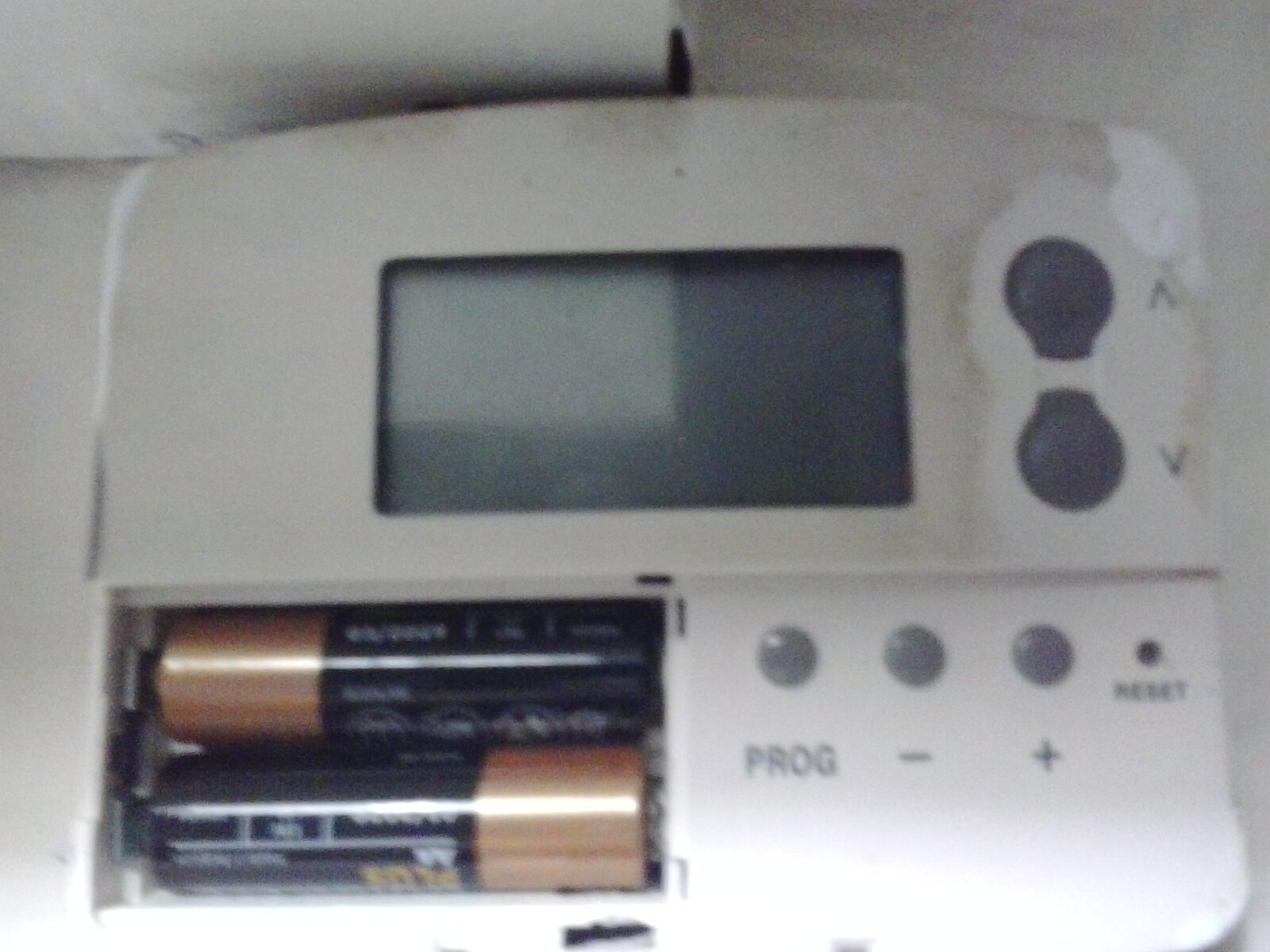

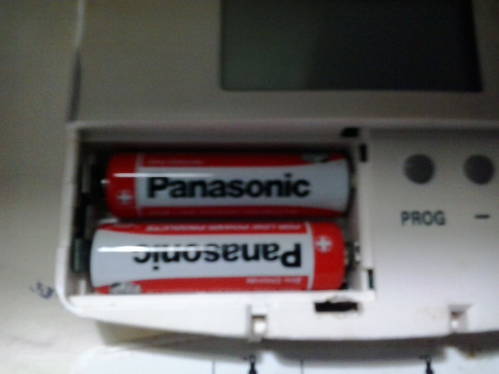

Are you fitting the batteries correctly ,they are not both fitted with the + signs at the same end ?
Show us a pic of your actual unit
Thanks for the reply, terryplumb.
Yes, I inserted them correctly.
Sorry, the photos aren't very good!

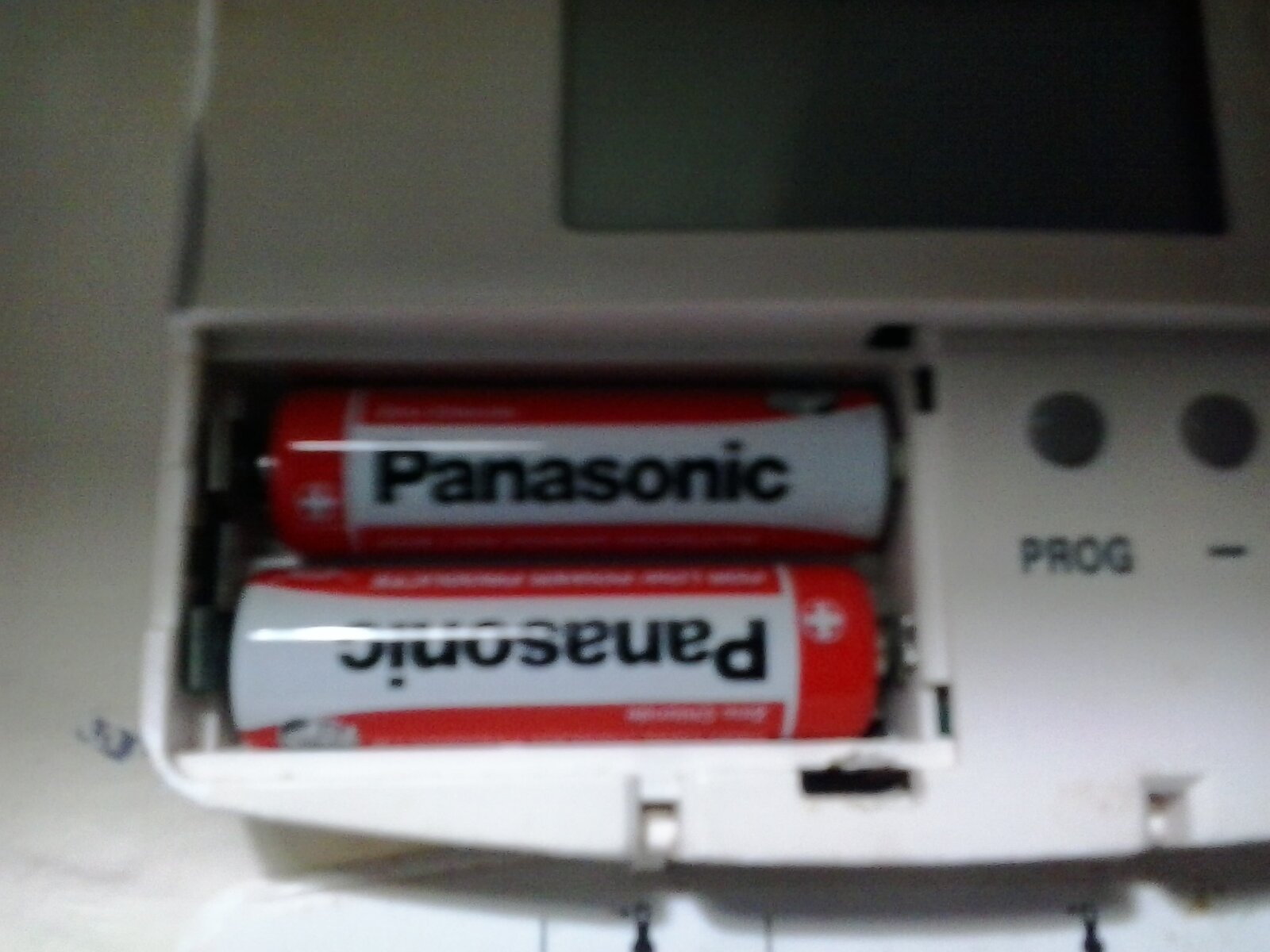

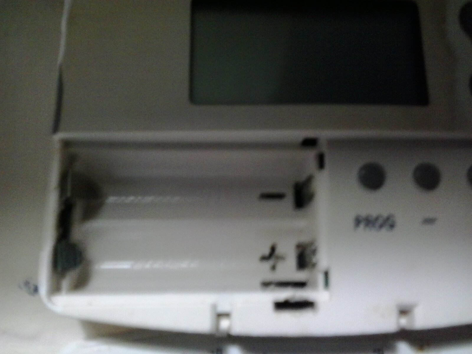

Is the polarity of the batteries correct ,beneath them is a pictogram of which end is + and - .
Have you tried pressing the reset button ?
You can reset the unit as follows
Partial reset: Press RESET (used to restart micro-computer) if display
freezes for any reason. This does not reset any programme, clock or
date. It is recommended that this is done at time of installation.
User full reset: Press RESET whilst holding down PROG button. This
resets event times and and temperatures back to the factory presets.
The unit must be re-programmed. The correct time will be retained.
As it's battery powered the appearance of something on the display is independent of your boiler, fuse box, etc.
If that does not work, then it probably needs replacing by another battery powered programmable thermostat. For example Honeywell T3/T4 or Drayton Digistat battery. There are a number of similar battery powered models available. You could also look for something 2nd hand on ebay.

terryplumb, yes, I've taken more photos to illustrate there is no error regarding polarity or batteries. As you can see, I've even tried taking out the old Duracell batteries in the previous photo and replaced them with new batteries. I also rubbed the slightly green contact on the bottom left with paper. Yes, I pressed reset also. I also tried inserting one of the batteries the wrong way round because both negative ends of the unit have the springy metal contacts and usually, the metal springy contact is on the negative side in most appliances.

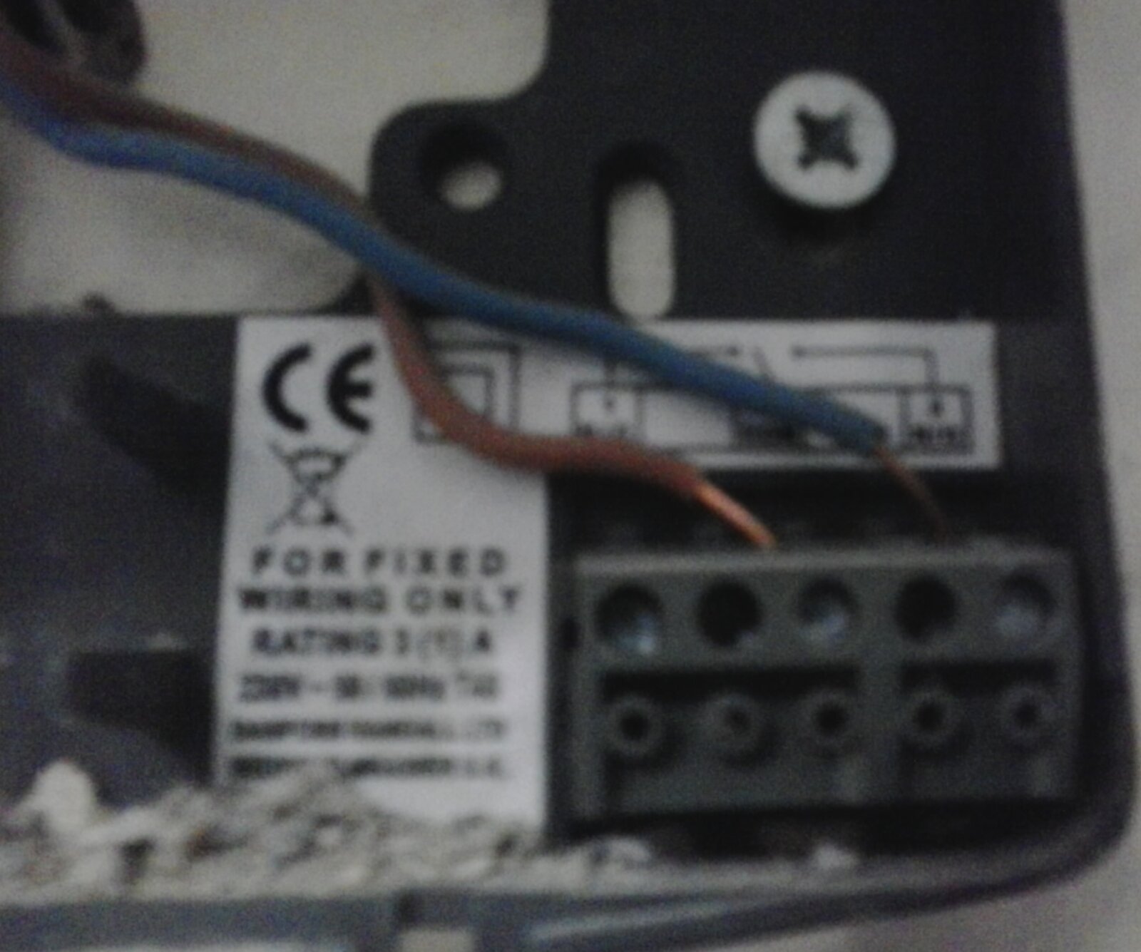

Whilst the wiring could be a faulty it's unlikely in your case. As it's a battery powered model the display would be visible even if the boiler itself had no power. You can indeed prise the thermostat off the wall following the instructions from the install guide
Note you should power off the boiler at it's fused spur prior to disconnecting the thermostat.

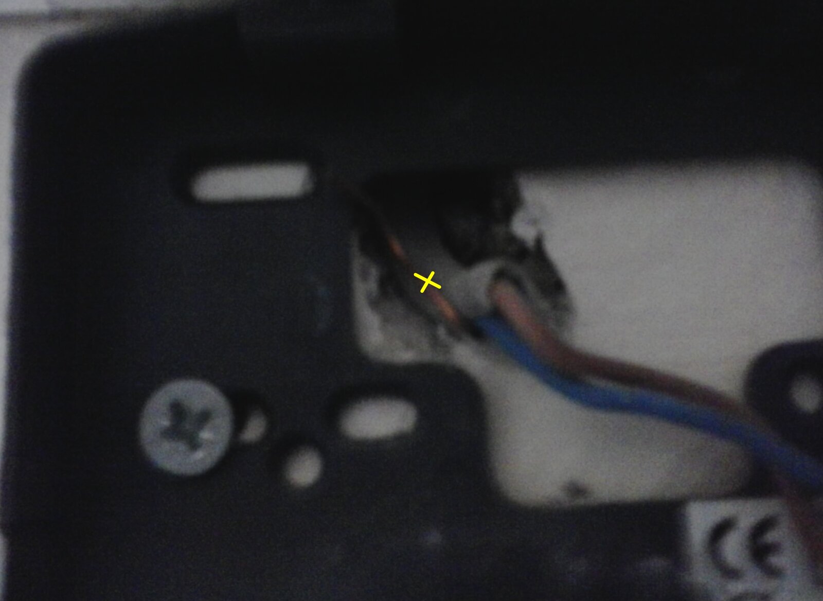

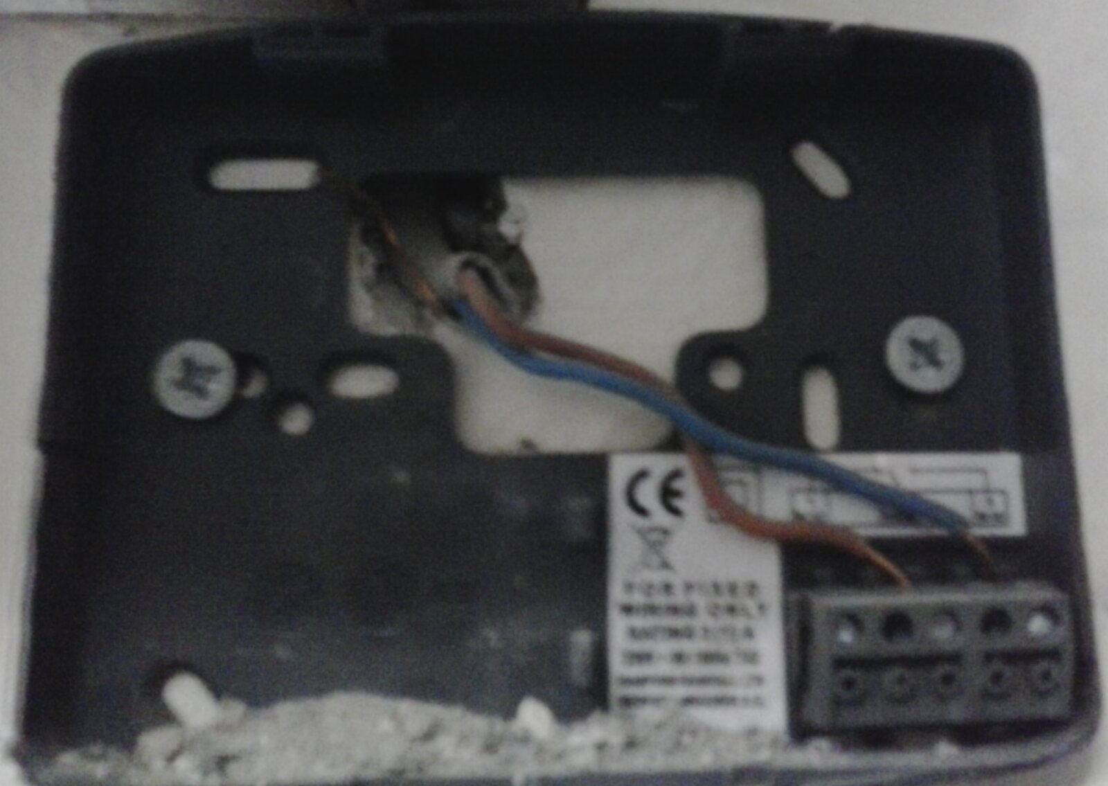

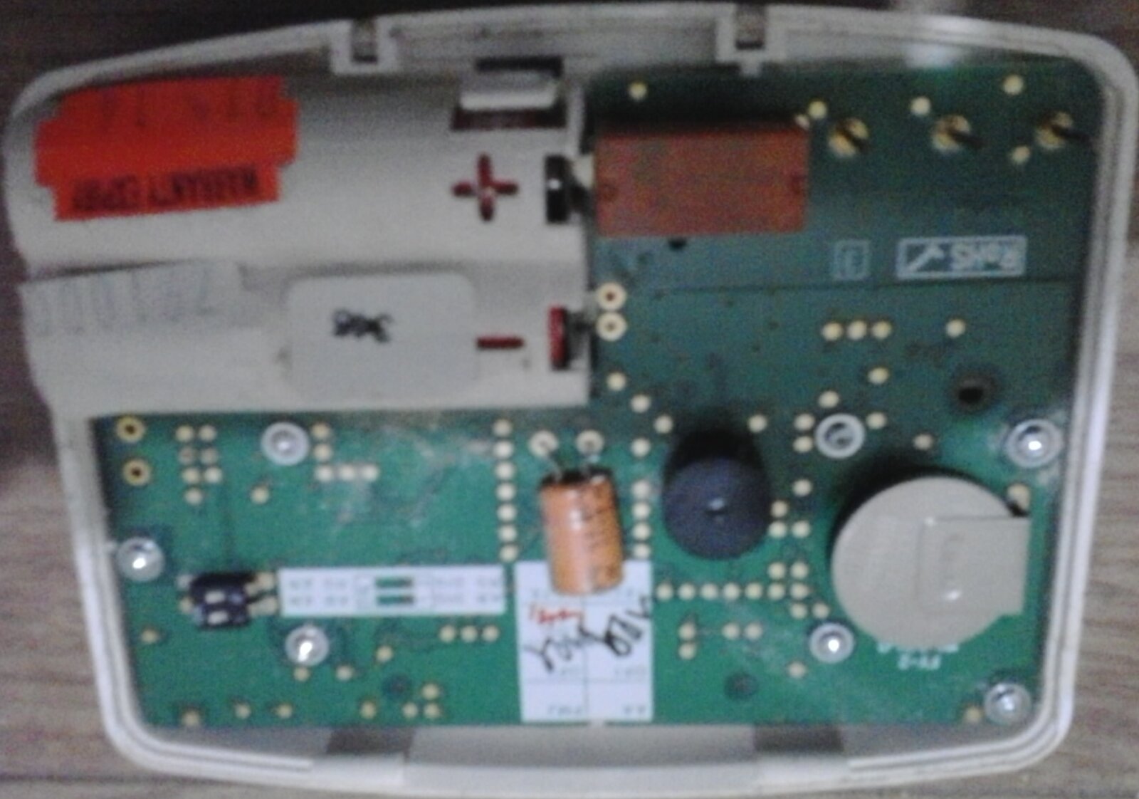

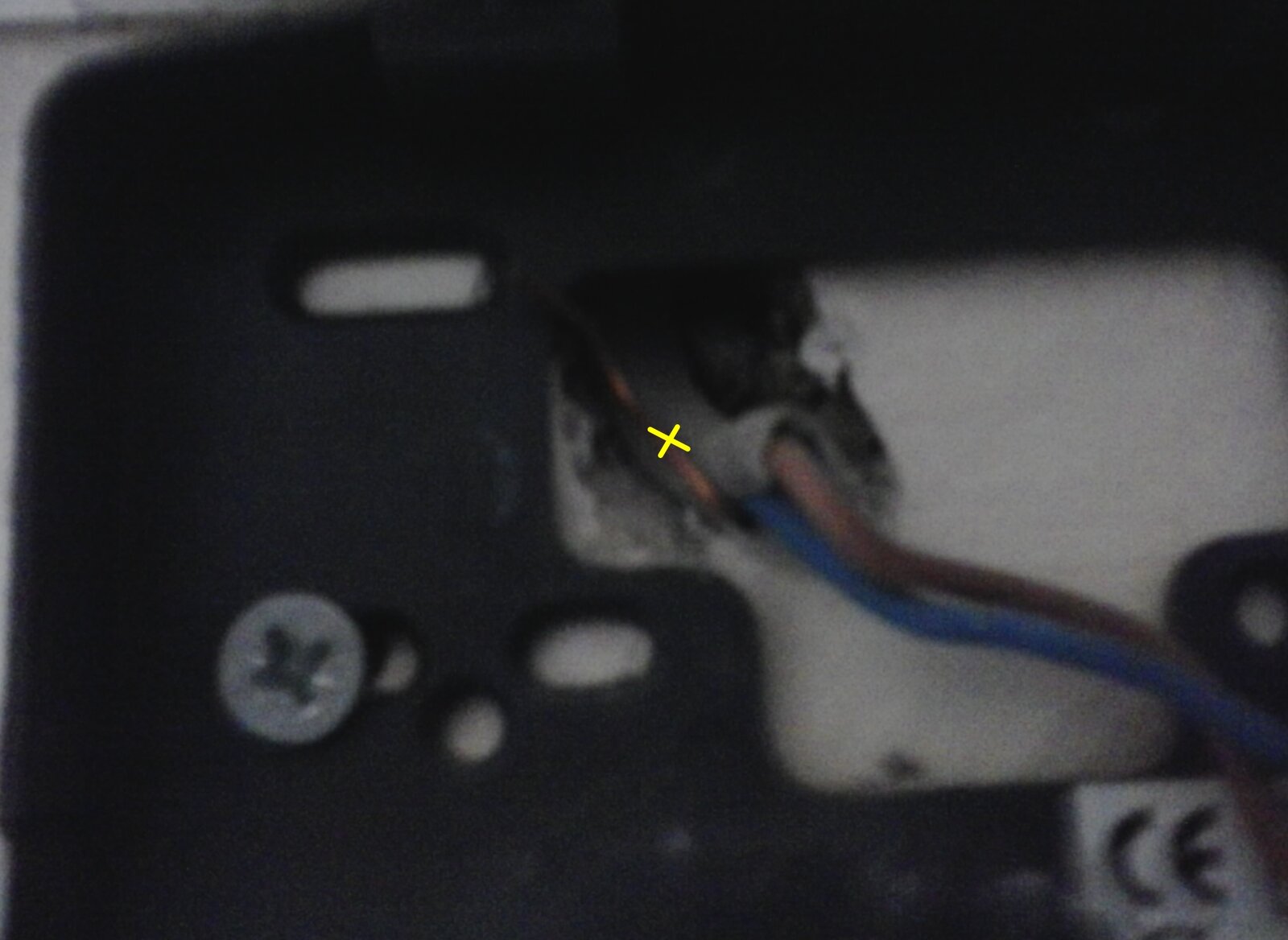

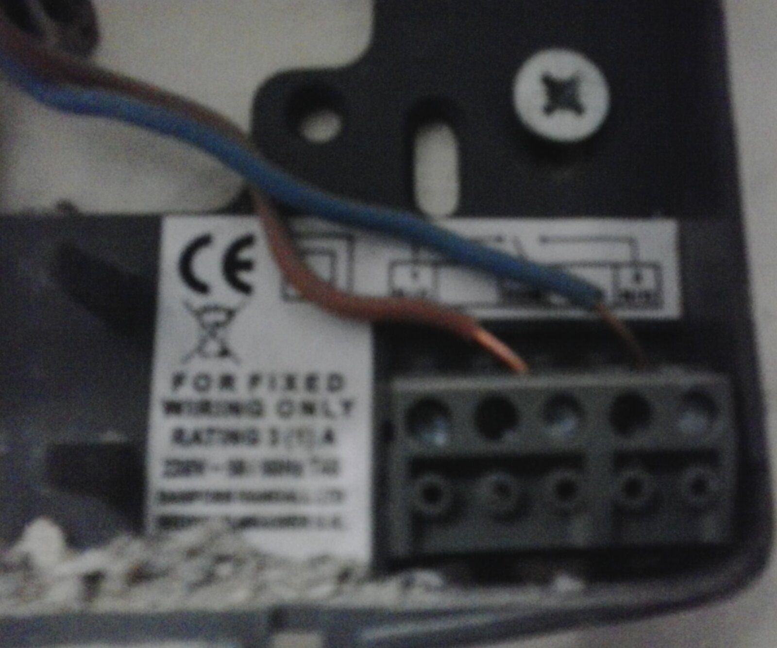

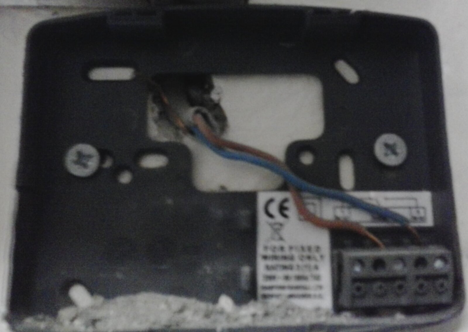

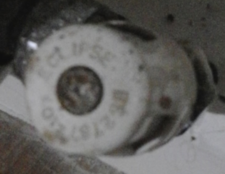

I managed to open the unit (see the photos). The yellow 'X' in one of the photos is to highlight a copper wire that isn't connected to anything in the unit.

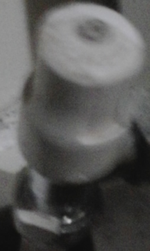

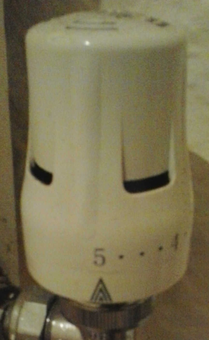

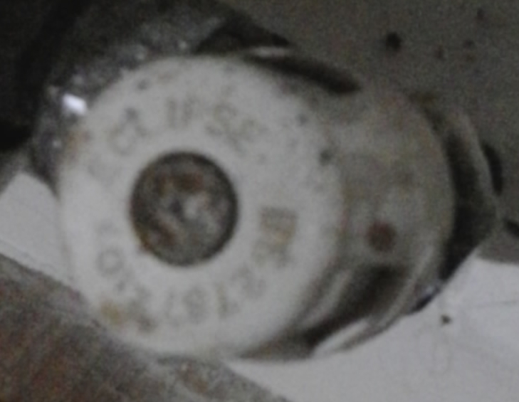

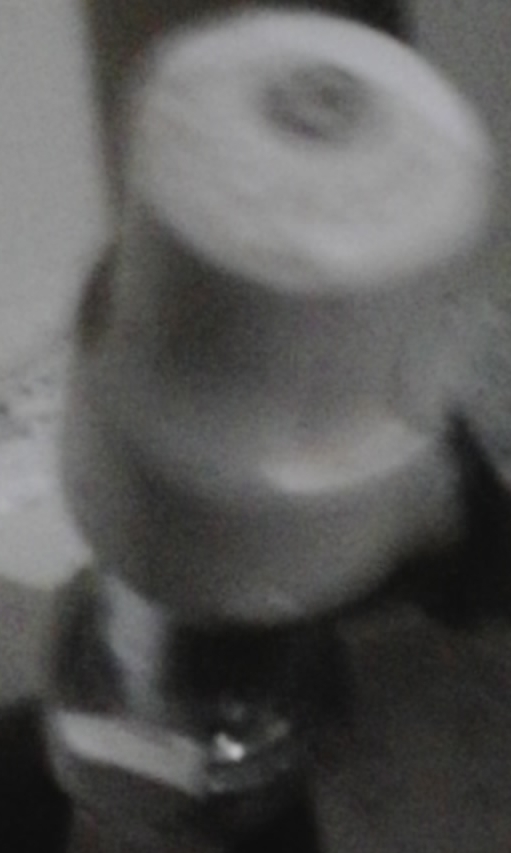

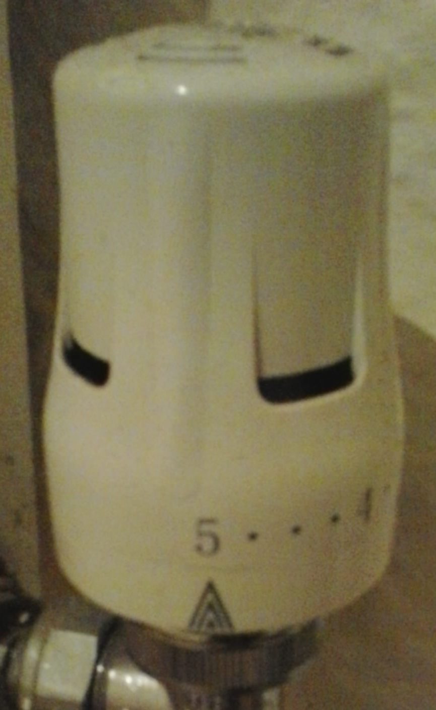

Before I go spending any money on things, is it easy/possible to have a system without any thermostats of any kind, that is, if I want to turn a radiator on heat setting 3, I want the radiator to stay that hot, until I turn it up or down and not for it to automatically go hotter or colder to try to maintain a constant room temperature?
I am assuming the current radiators have thermostatic valves (see photo) and am also assuming there is a main thermostat radiator which has different smaller valves (see 'left' and 'right' valve photos for the valve on the left and right side of this radiator).

You need a thermostat and/or timer otherwise there is nothing to tell the boiler to stop. The TRV closes when the individual radiator is up to temperature but does not control the boiler in any way.
The X wire you highlighted is a earth which is not required, so it can be happily ignored.
As you can see there are only two wires to connect at the thermostat. Assuming you have a few tools it's fairly simple to take out the old and install a new.
You should allow £80-£100 for the programmable battery powered thermostat and probably that again if someone fits it for you.
