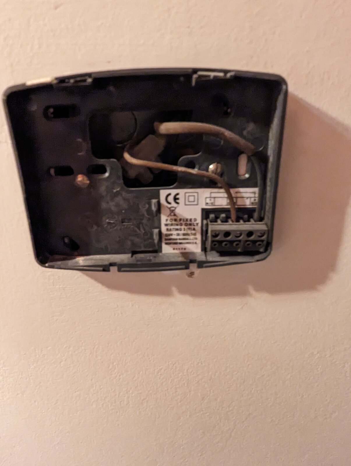

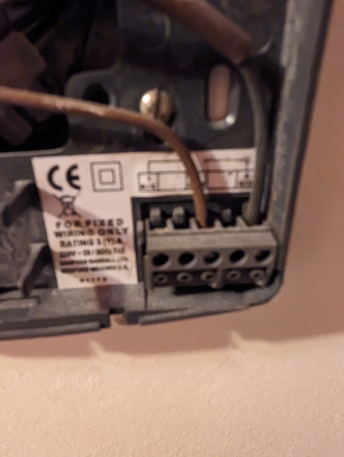

Hi all, I'm a bit confused as to which wires go to where on the tado thermostat I'm installing.
Coming from a danfoss tp4000 with LCD display - pictures attached of the existing wiring
Any help appreciated
What are you confused with? The existing is battery operated, which allows the switching of the 2 wires. Tado will likely need a permanent live and permanent neutral with switching wires too
