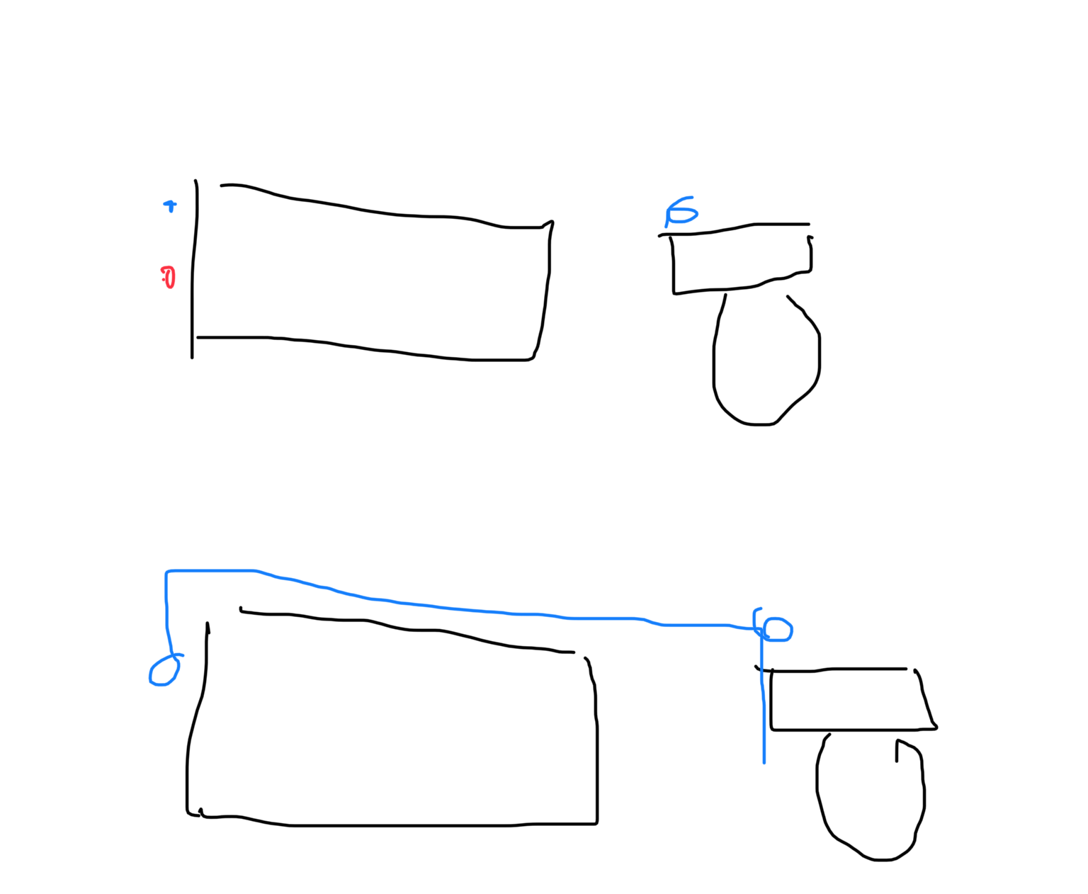

I have a first floor flat that I am doing a refit in . The current wc is plumbed using 10mm jg. The bath is being replaced with an electric shower . There were originally 2 drain offs on vertical’s for the bath and one drain off on the 10mm vertical for the wc. All other pipe work is 15mm speedfit. If I were to do away with the 10mm wc connection, I would be left with a dead leg in excess of 2m. I cannot start pulling the original ceiling down . Can I combine the old 10mm and new 15mm cold feeds to both shower and toilet with a single drain off to avoid this dead leg ? Unvented system boiler. All feeds drop down metsec stud walls from inaccessible ceiling void.
cheers
paul
I would think that 10mm will struggle to supply suitable flow. Would never consider using 10mm to feed something like an electric shower, certainly not 2 outlets, if that's what you are saying.
  • Thanks
Reactions: CBW
the 10mm feeds the existing toilet. There are two existing 15mm feeds to the bath. I intend to use the 15mm bath cold feed to provide water for the new shower. I was hoping that a 15/15/10 tee near the toilet, combining the shower cold feed and existing 10mm toilet feed would prevent the dead leg in the existing 10mm.
I wouldn’t personally use 10 mm for much on plumbing side of stuff. Are you able to incorporate it into something else? What about changing the fitting where it branches from?
Perhaps this helps. Top sketch is existing. Bottom shows proposed using the tee by the toilet and position for drain off Also by the toilet. If I keep the toilet on the 10mm supply it would then mean two drain offs. All new pipe work will be in tiled boxing. Apologies for the drawing.

I would also not use 10mm. It is existing. It is not accessible.
  • Thanks
Reactions: CBW
Number of drain offs doesn’t really matter too much
They do to my customer when they’re exposed .
