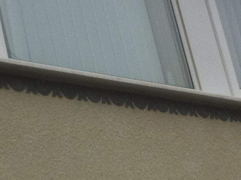

You can make your own template - set a piece of cardboard behind the lead and mark the outline on the c/board.
The lead is probably code 3 or code 4 and it comes in 150mm, 225mm 300mm for your flashing purpose.
