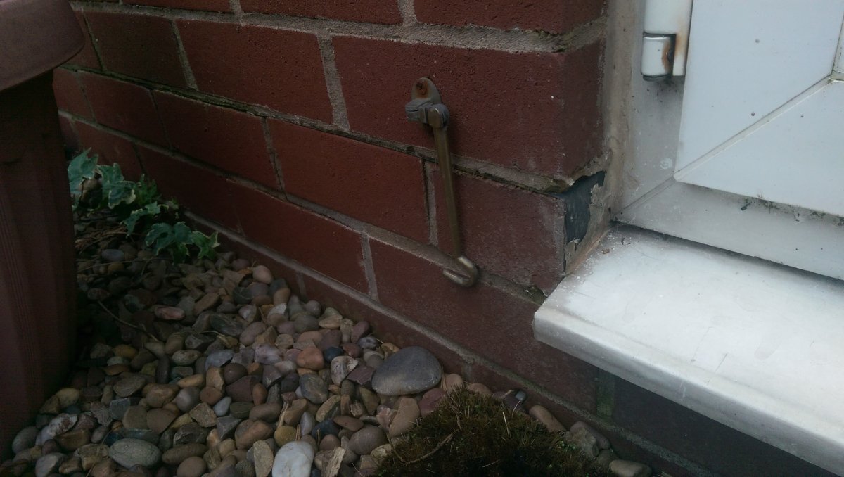

Your pics show an air brick just below ground level thats blocked with soil.
Clean out that air brick - and then search and find and clean out all the air bricks around the house.
The ground level should be below the air bricks - and 150mm below the DPC.
I cant see the DPC line - perhaps its behind the black cable?
There's a very thick mortar bed just above the air brick.
Someone had miscalculated when setting out - its bad practice to have such thick mortar beds but the bed doesn't show any signs of instability or pressure.

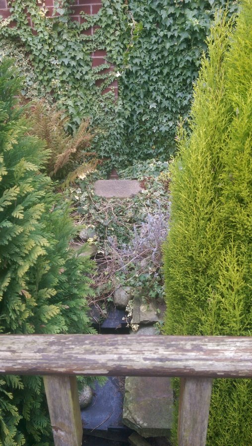

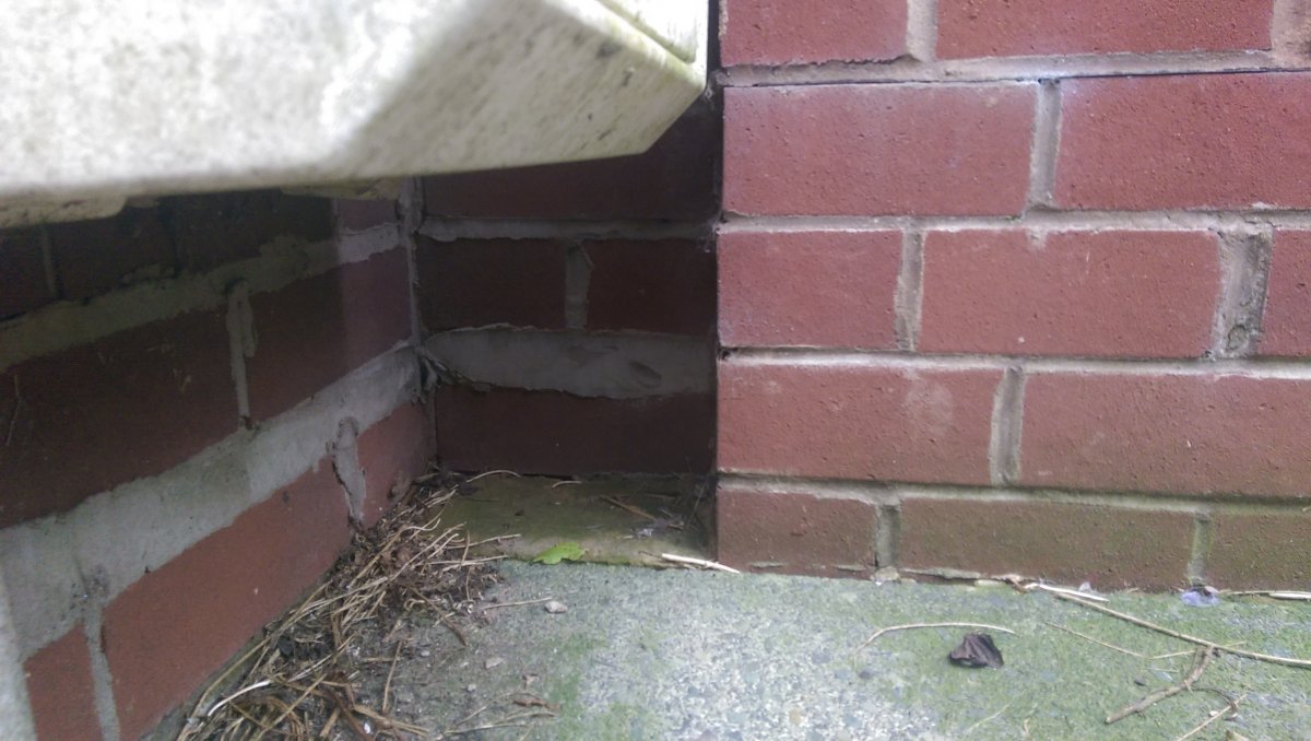

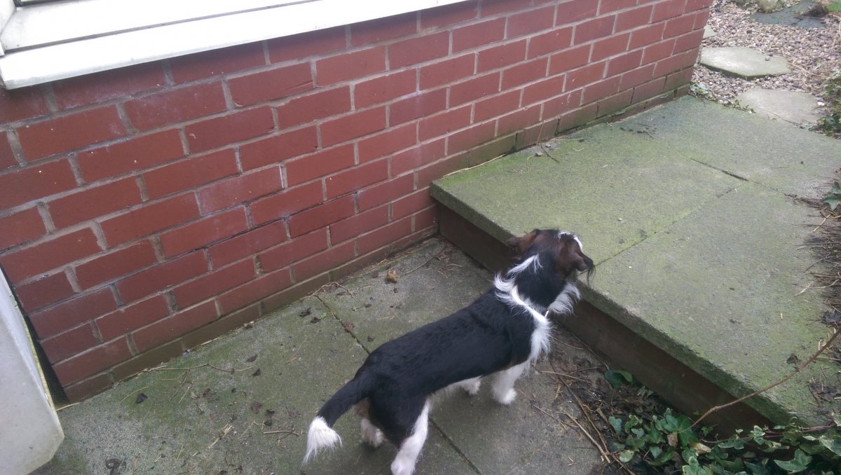

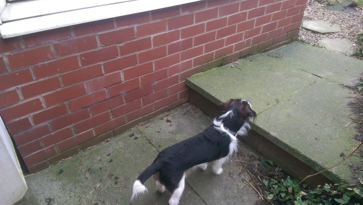

We were told in the survey that the dpc was bridged and I was going to post a new thread in relation to this but since you're here I'll pick your brains if you don't mind... It said bridged but didn't say where. But basically could be any of the following (all pictured)... The conservatory, stupid pond thing which seems to have its only blood foundations! or decking... or like you said just the ground in general.
Because of all this I wouldn't know where any other airbricks are. There's one on the inside of the dining room (other side where the chimney breast is on the gable end) not sure if it goes into the chimney breast but it had been blocked up for a long time. We had that wall replastered because there was water dripping down it and have left it open and the wall seems to have stayed dry since. Again not shown in the survey. The building next to the decking with the hose on is an external utility joined to the back of the house with no access inside.
The white door which looks like there's dpc showing or i'm assuming that's what the black thing is and where the dog is standing next to is the conservatory and how it joins to the house.

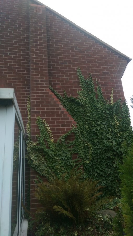

Bridging means the mortar covers the DPC material which isn't a big problem. CWI leaves drill holes, usually at the base of a perp and the bed joint.
Edit: just noticed your wall tie reference. So the regular pattern of white circles are wall-tie positions?
What exactly happened with the wall ties?
I've no idea. The survey came back to say houses in the area are well known to have wall tie failure.
Apparently it was checked and all was fine but we never saw any proof of this just took the estate agents word and the fact the mortgage company were still happy to lend. The previous owners said someone had been to put a camera in the wall but we didn't see any other evidence of it.

I can now see the DPC in a number of your pics, and it appears to be well above the ground - however, your ground levels appear to alter dramatically as you go around the house. So its possible that the DPC is bridged here and there.
Bridging is to be avoided, even in a cavity wall.
Bridging can also occur inside the cavity due to debris build-up. Is there any damp inside the house at skirting level?
And in a 1959 house of your type there would be no slate in the DPC.
The conservatory DPC is doing its job.

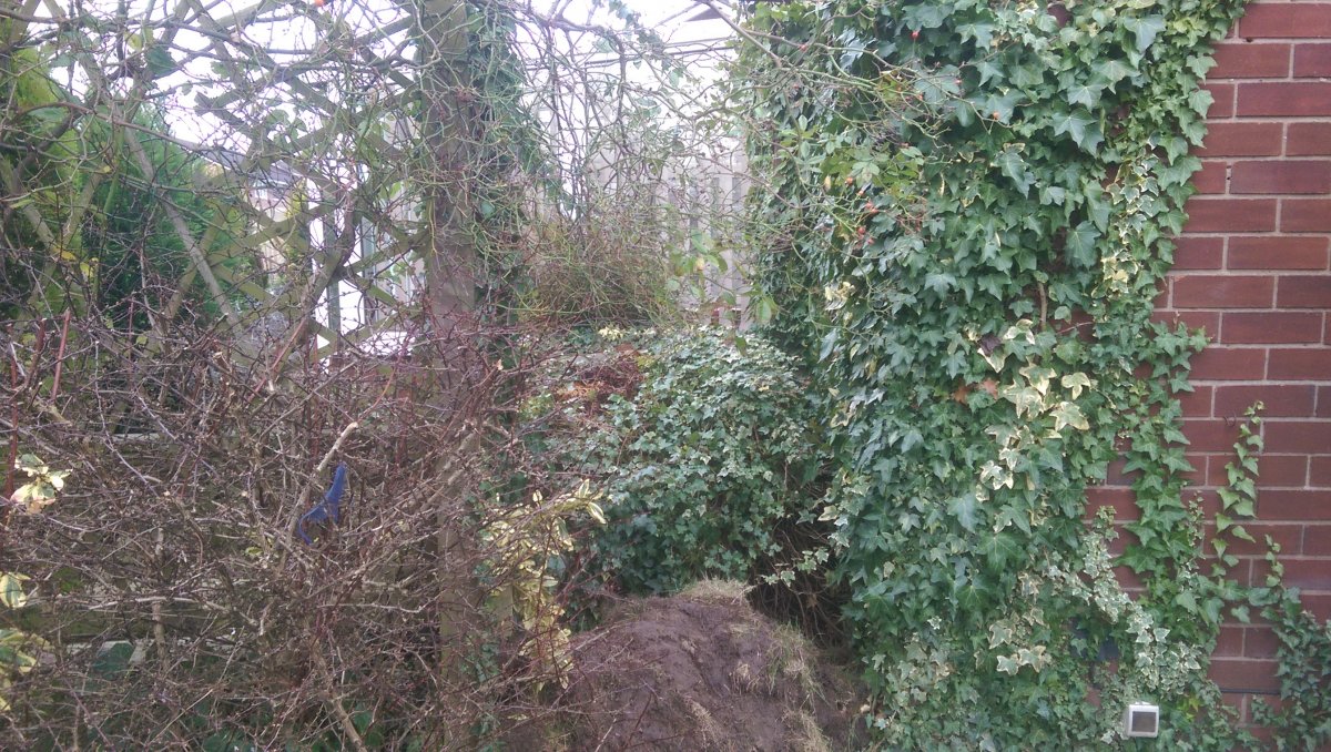

Wall tie inspection is best done from various points and different heights using a camera or boroscope in the cavity.
There's a brick with newish mortar low and left, near the ivy, where the only inspection on that wall was possibly made - post #5, pic2.
The brick was removed for the inspection.

The circle pattern doesn't fit the profile for CWI so I guess that someone somehow determined that thats where new wall ties needed fitting or replacing.

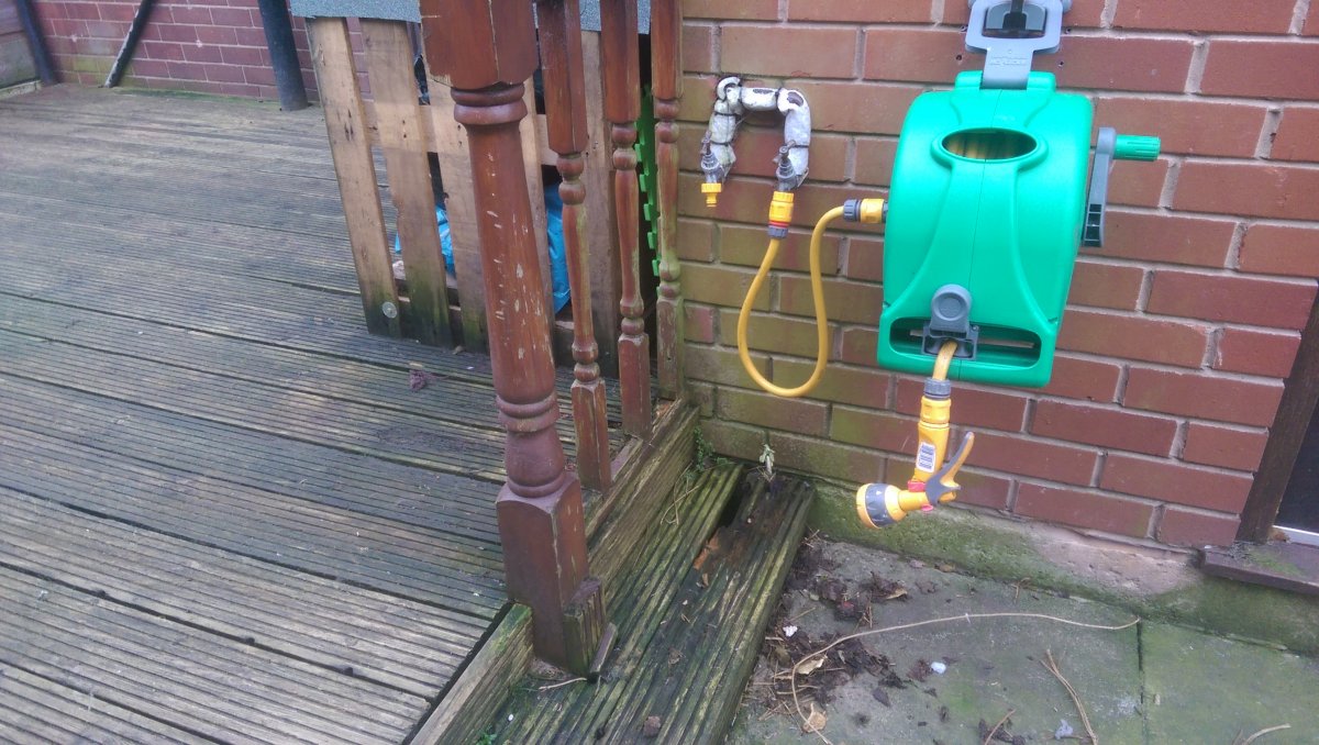

As you recognise, the deck and garden are probably bridging the DPC, and the wall is being soaked with splash near the hose bib.

You have a knock-through at the deck - is there a nib of brickwork supporting the right hand bearing of the lintel, or does the lintel go into the chimney breast cheek?

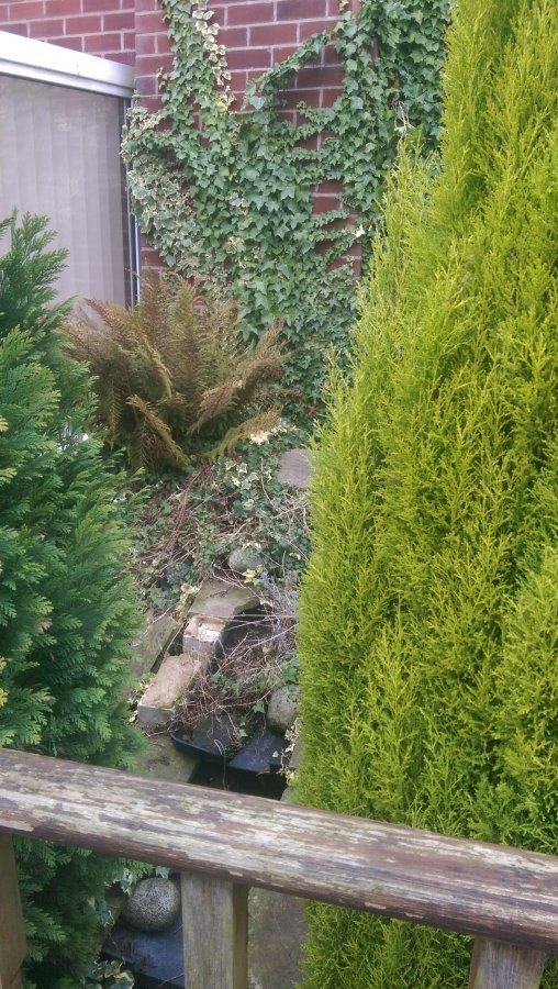

Just been thinking, the pond lining is leaking and has been for a while. It starts about 4 meters from the side of our house and about 1.5m diameter. When it's been dry the level drops about 20-30cm but then refills and maintains its level when it rains frequently. Could this be causing an issue or is it no different than if the rain that's refilling it was to fall?
