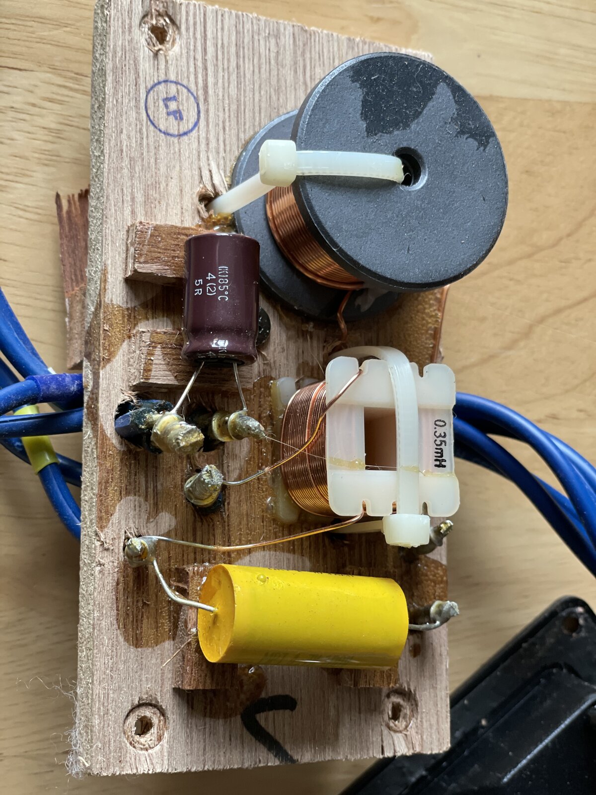

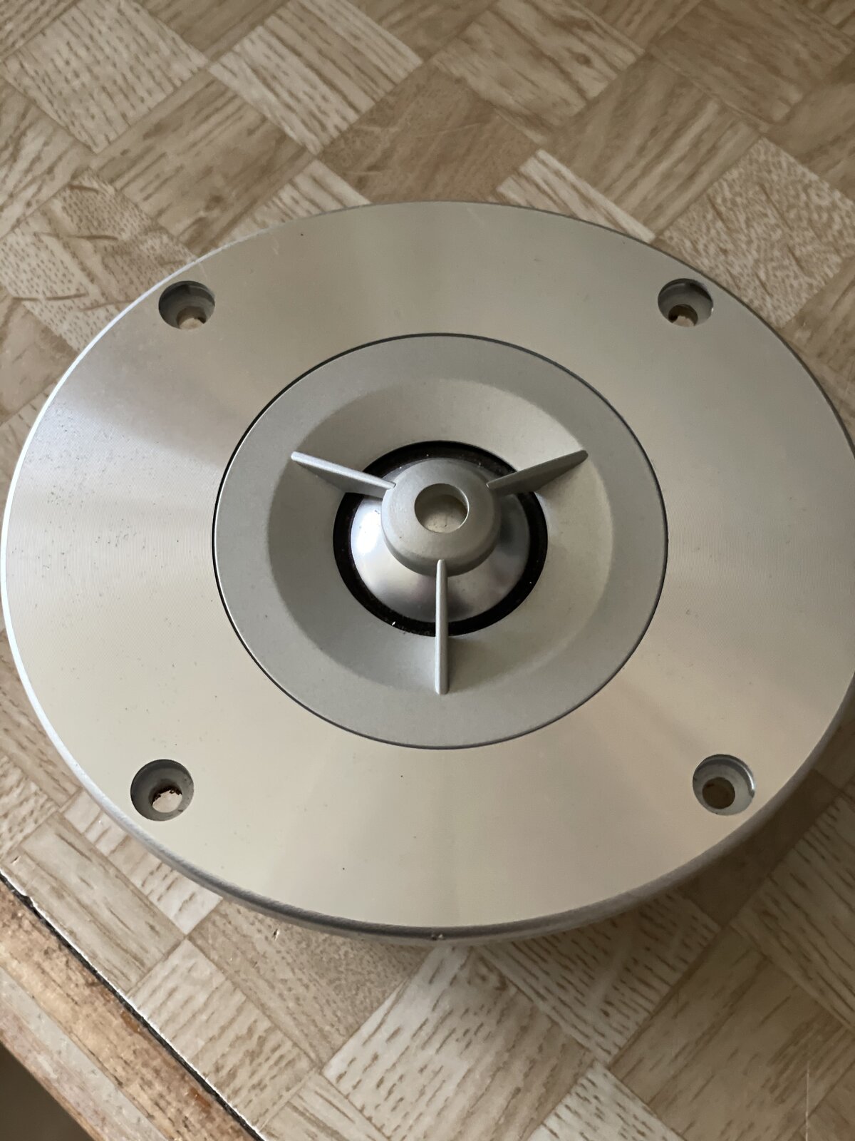

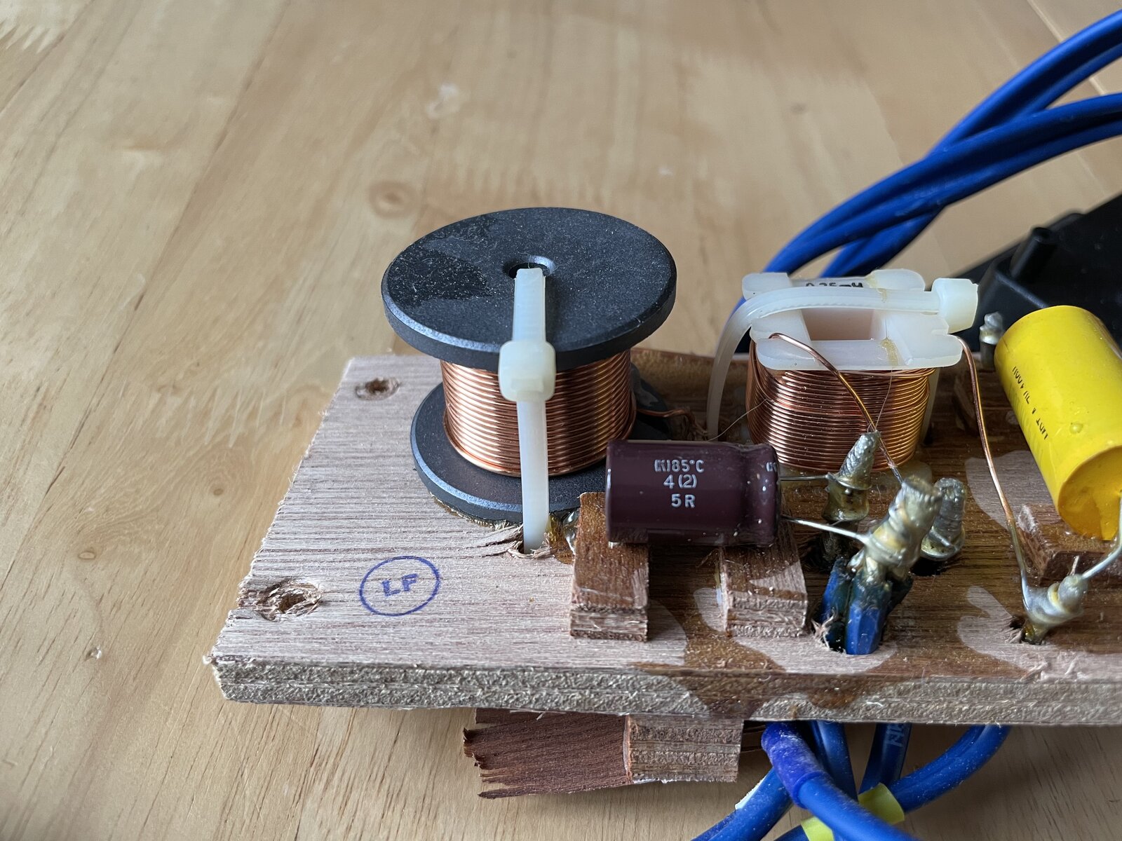

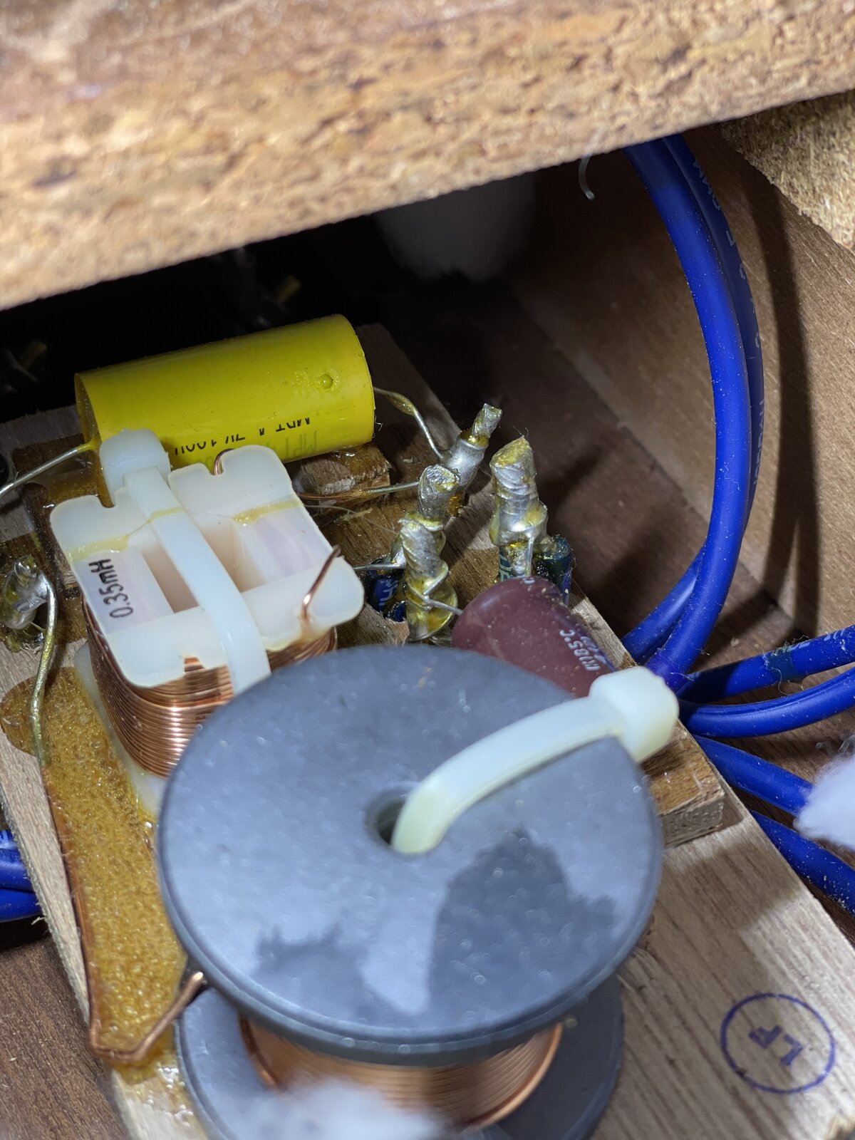

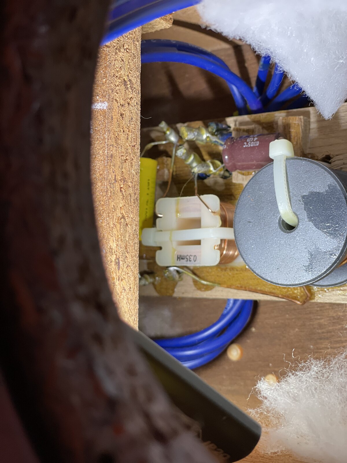

Ok I’ve just taken the cover off and first there is no sound coming through the centre speaker, that’s rated to 6ohm so will stick a meter on it tomorrow to see if it knackered. There is obviously a crossover circuit inside (pictures attached) what usually goes on these things ?

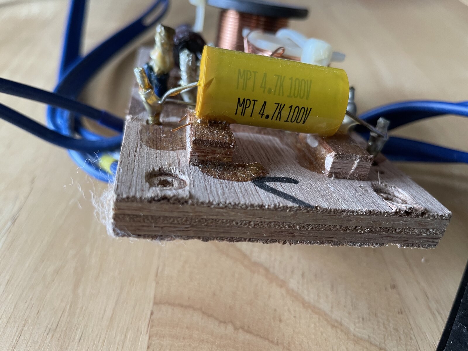

I guess the yellow resister or the brown cap ?

Although it can't be ruled out, generally speaking, crossover components take a long time to fail unless the speaker has been abused in some way. There isn't the sort of heat levels inside a loudspeaker that you encounter in amps and other active devices, and so decent capacitors don't dry out as quick.
At a guess, I'd say that the centre speaker is roughly 20 years old. The big yellow component looks like a film capacitor. They last a long while. The small brown one could be an electrolytic. If so, then they that's the one that will have a shorter lifespan.
As @ninjacat suggests, check the speaker binding posts/banana plugs/HF-LF bridging links first if the speaker is bi-wired. After that, the most likely item to fail is the tweeter itself. A quick test with a 1.5v battery will tell you if the tweeter is duff. Set up a couple of wires off the battery terminals. Touch them on the speaker terminals very briefly. You'll hear a little click if the tweeter is good.
