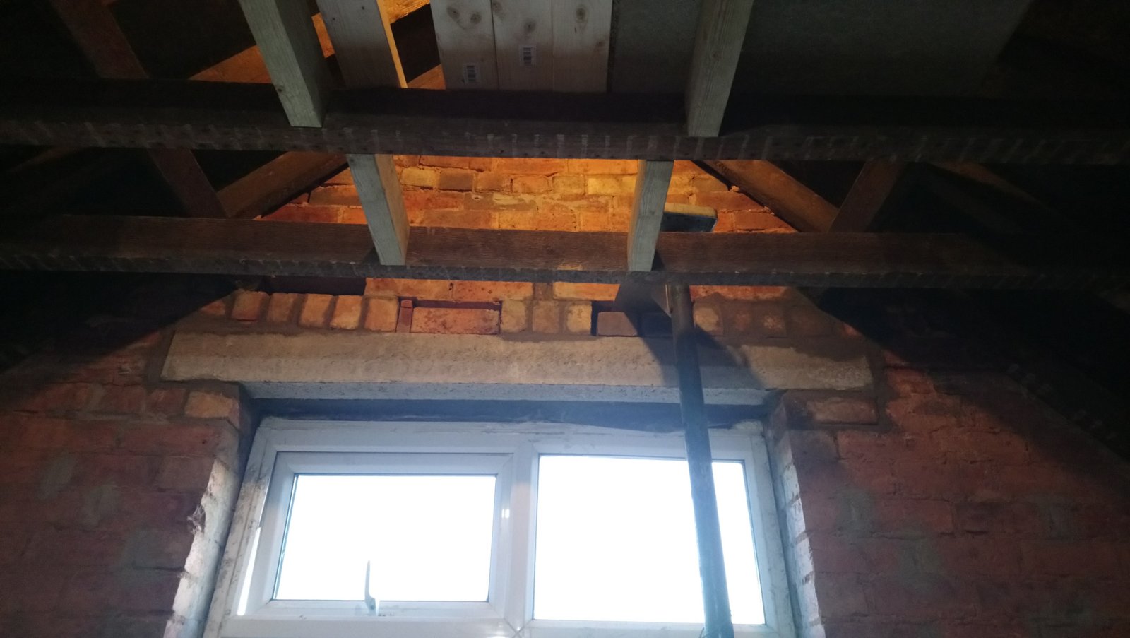

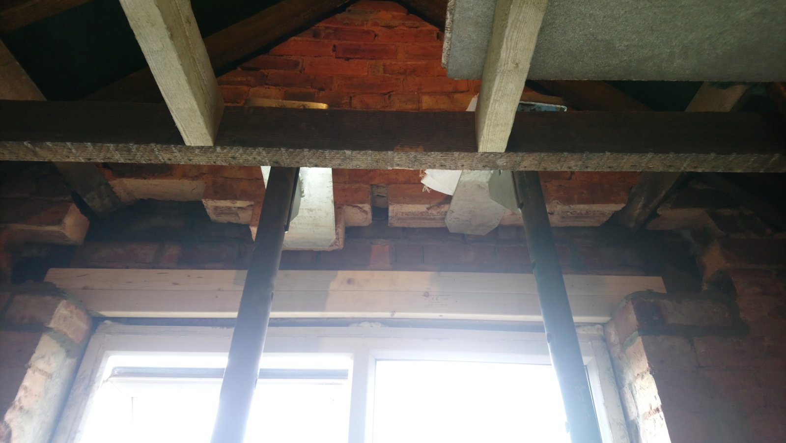

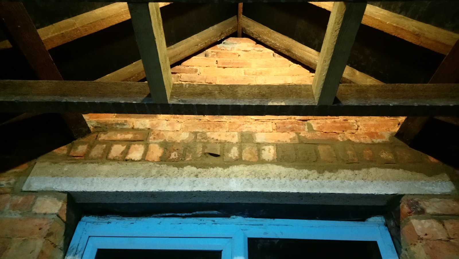

Just an update for clueless people out there like i was.That was a lot easier than i initially thought its gonna be. Work was done in a couple of hours with my helper Ian big thanks to him. The plan was to go with the oak lintel but upon order there was a mess up and so on so we canceled the order and my helper showed where to get good concrete lintels and that eventually were delivered with wickes truck hi said there are a lot of companies that go under one big company and that is Travis Perkins! It was fine with me because the price was right quality seemed to be good and delivery was as promised so we rented out 3 strongboys one was faulty (welded) not important i got my refund... a bit of mortar and my self made platform where to stand and whoala

Nice.
However - is that softwood being used as a lintel for the outside bricks?
Ahh no there is another concrete lintel on the other side that softwood in the middle is just there to fill the space in between them as it was before. That would be crazy to use that as a lintel hehe
