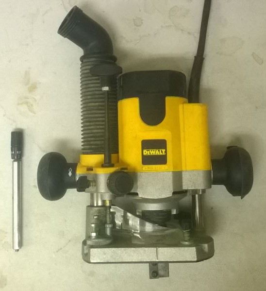

As promised, pictures of the DW622 with standard depth control fitted (this is used in plunge routing):
It's the silver "rod" to the left of the main body. It works like the depth setting on a million and one other routers, namely:
1. Install cutter. Withdraw the depth rod to highest position
2. "Zero" cutter by plunging the cutter to surface level and lock the router in the plunged position by twisting the left hand knob
3. Release the depth rod and drop it so that it touches the to of one of the screws on the turret
4. Using a piece you wish to recess into a piece of wood (e.g. a hinge into a door edge) lift the depth rod and insert the piece on top of the turret screw before dropping the depth rod onto it. Lock the depth rod and release the router from the plunged position lock
5. When the router is switched on and plunged the cutter depth will be the what is required for the piece (hinge). Fine adjustments can be made by releasing from plunge and dialling in more less depth by twisting the thumb turn at the top of the depth rod to advance or ****** the rod. Then replunge and check
If you wanted to plunge an inch then you'd use a piece of material 1in thick instead of the hinge (say an offcut of the material you are working on). I find joiner's plastic horseshoe packers are invaluable in helping to set-up plunge cuts as they come in 1, 2, 3, 5, 6, 10 and 12mm thicknesses.

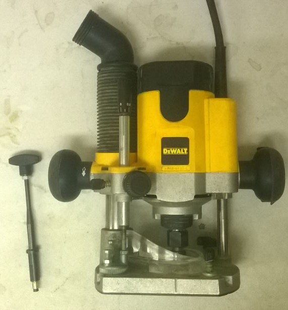

The DW622 with fine depth adjuster fitted instead of the standard depth rod (this is used in precision overhead routing and table routing):
in this case the thumb turn advances or retreats the cutter 1mm per full turn. A lot of routers use a variation on this system.
Either way you pretty much always will need to make a test cut on a piece of scrap to check that your depth of cut is right (same applies to when you use the fence to check the side depth)

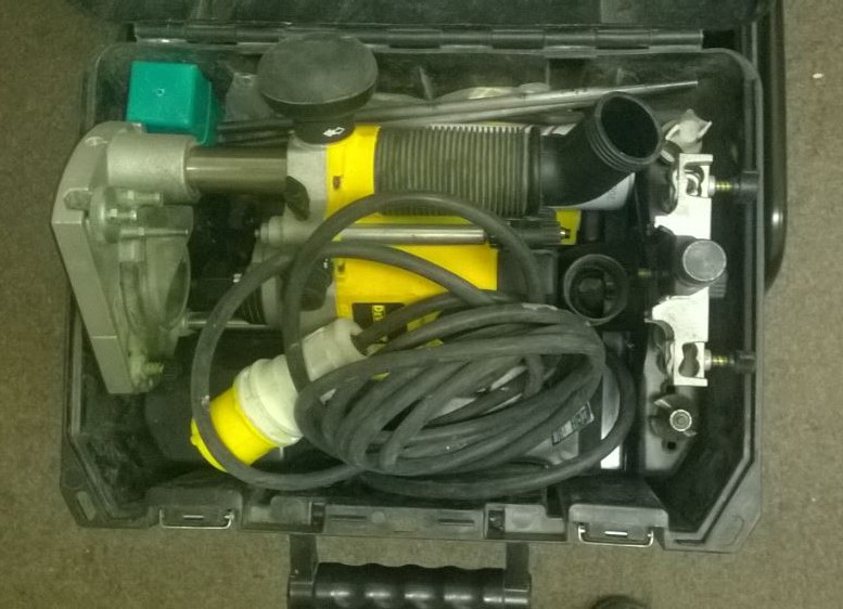

To show the compactness of the DW622, here's the kit in its' box:
That's the router, side fence, fence rods (pr.), 8 x cutters, 4 x guide bushes, 2 x extra collets, extra depth control, 2 x wrenches, screwdriver, square corner chisel, etc in a relatively small box. A bit messy, but this has been a heavy week!
