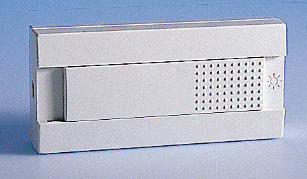

ok i've got a new lamp £50 for my living room and its 240 v with three 40 what bulbs in it and one switch to switch it on and off with, ive taken out 2 of the bulbs because the lamp is well to bright brighter than the main light in the room.
? is there a place where I can get a dimmer switch so i can put on it insted of the on and off switch thats on it now so that I can lower the power and dim it right down with the other 2 bulbs back in as it looks crap with just the one when it should have three.
ive had a look around the net but can only find ones that go in the wall socket and i no you can get them cuss you can bye lamps with the dimmer switch's on them.
Any help would be good as its doing me head in only having the one bulb instead of the 3.
Cheers.

2 core? 3 core? the number of cores doesn't determine what power you get from a cable or dimmer :eek: whatever dimmer you buy, only the live is switched/dimmed. earth and neutral are direct connection. earth is NEVER switched, where it is present.
Where do you get 50% power drop from? AFAICT, they all dim to 0 brightness. for 120w load, you would need the slider one. The touch ones are only rated to 100w.
click for description
@ Crafty ? is that dimmer twin and earth m8 as i carnt find data saying if it is or not.
If so then it would do the job as the lamp on and off switch that im leaving on is 3 core twin & erath not 2 core L/N.
theres a PDF file available on the product page on TLC. Its got the wiring instructions in it. I think you'll be pleased at what you find in that ;)
Please replace the cable at the same time - twin & earth is not suitable, you must use flex.
