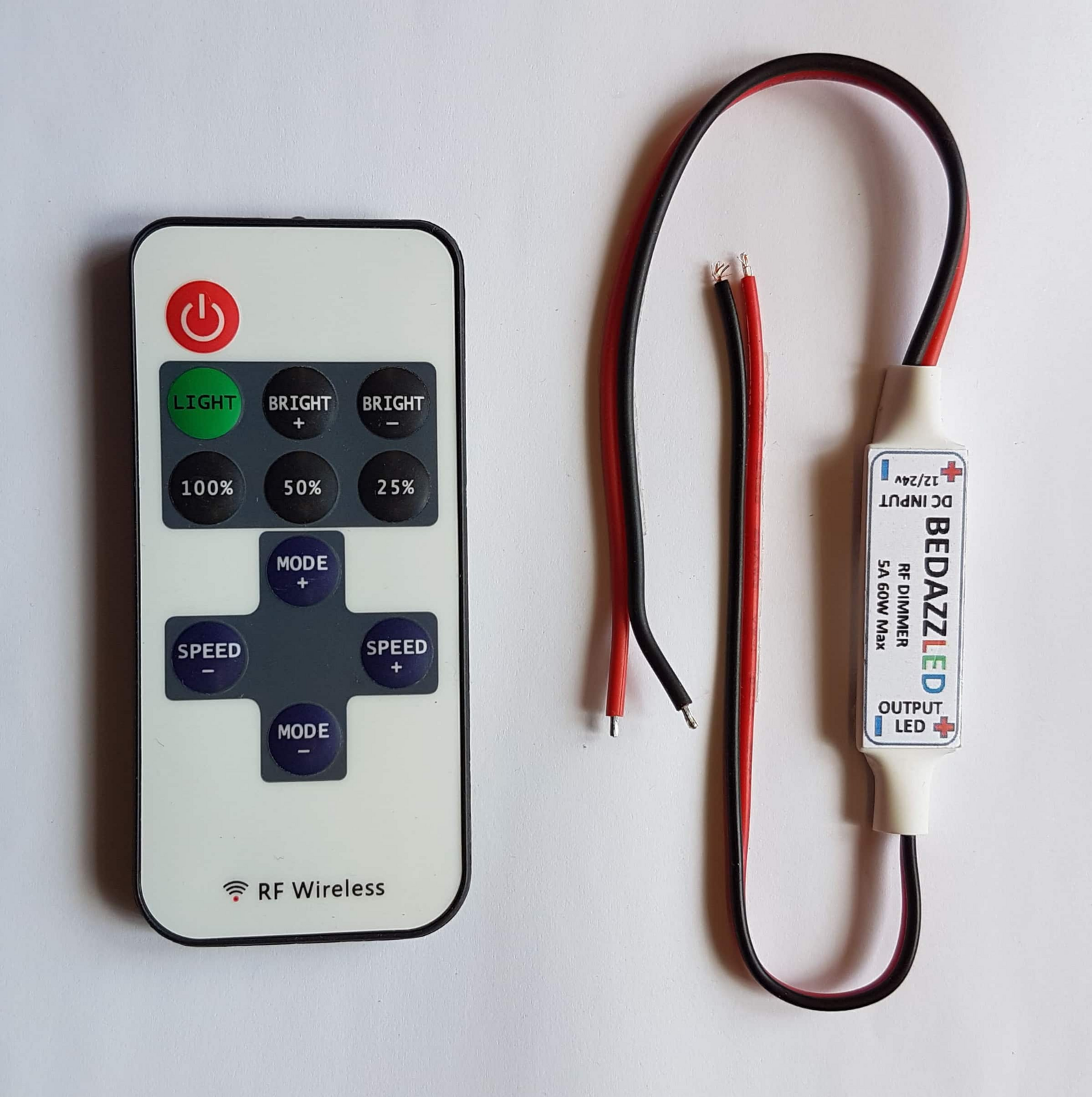

For LED strips you can get controllers 1684090090953.png but 3 x STATIC brightness buttons (25% 50% 100%) not anything in-between it seems.
