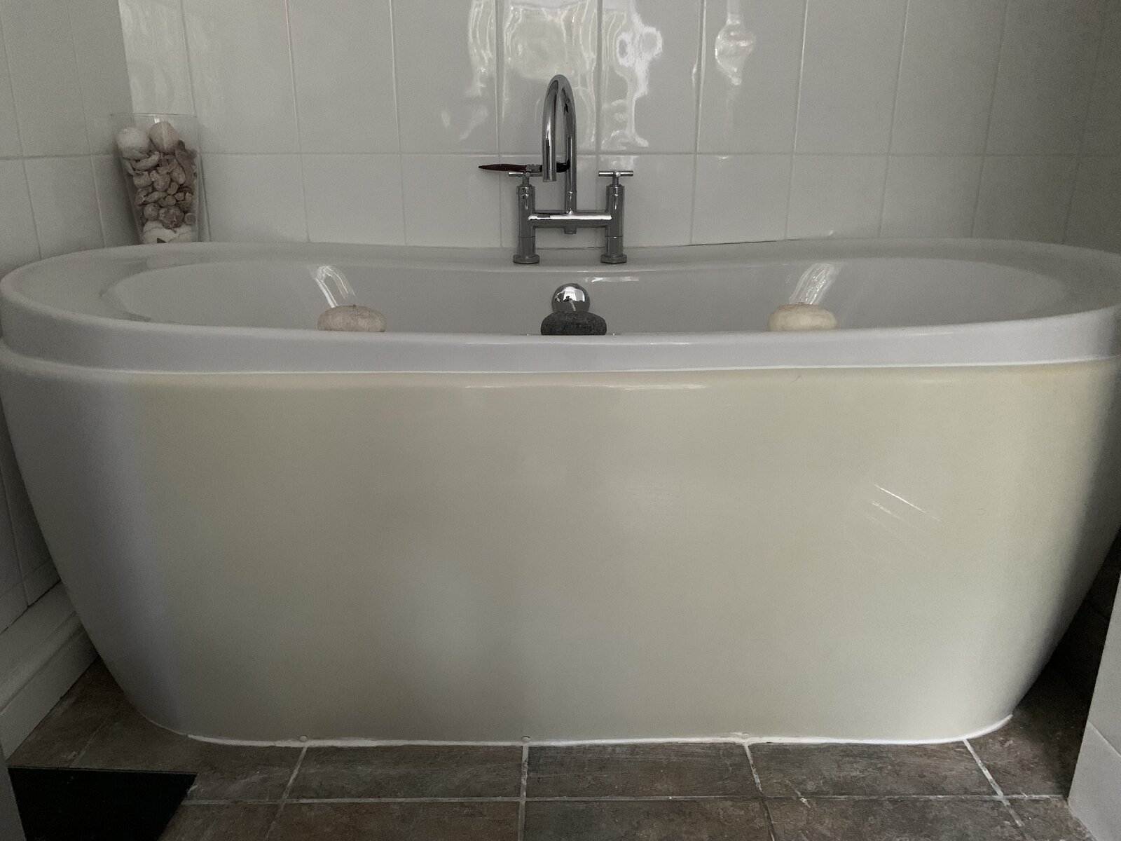

So my bath panel has become discoloured (yellow) and I'd like it back to it's original white colour.
I've tried mixing bleach and bicarbonate of soda - didn't work
Bought chlorine tablets,disolved these with water and mixed in bicarbonate of soda - didnt work
The photo shows it's current state
Any ideas what will work (apart form buying a new panel)

Does anybody in the house smoke, or burn candles?
Odd.
Does any sunlight fall on it? Does it have light and dark patches?
That has nothing to do with the summer temps, that's something else. If it was the temps then it would all have gone the same colour.
Funny how the shadow in the pic seems to fall very close to the discoloured lines, is that a south facing window behind?
It's the type of plastic that's yellowed.
Replace or paint it with rattle can

White plastic isn't UV stable, when sunlight hits it, the UV causes a chemical reaction that yellows the pigment.
There are chemical ways (soak in Bleach/water - H2O2 - etc) to recover it to some degree but none ever get it back to white properly. Given it's a bath panel then it may be difficult to find something to soak it is without affection the container it's in.
1. Try cleaning a small unobtrusive part of the panel with chrome cleaner. If the light discolouration hasn't penetrated too deep, may work.
2. Rattle can = aerosol spray.
Not sure we have rattle can in the UK?
Spray can from DIY store that is OK to use on plastic.
Fine scotch pad as don't want to scratch. Clean surface.
Warm spray can in hot water and spray. White I guess and may need two cans for that's panel.

Ok so decided nothing can clean it so I want to paint it, without removing it and taking it anywhere.
I'm in the UK, - what do I need to use on it to paint it please?
I've seen online epoxy paint or shall I just go to B & Q/Wickes and ask.
