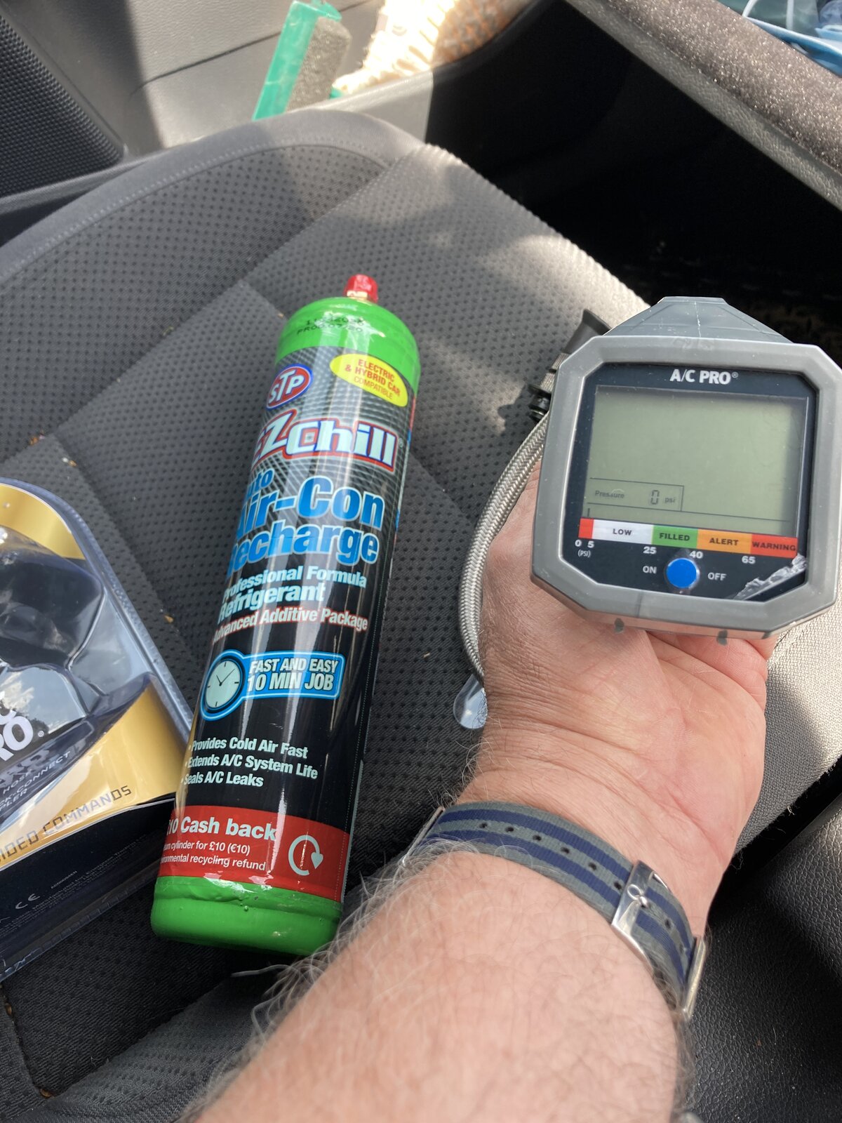

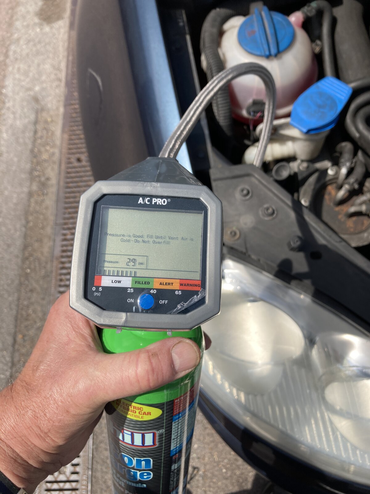

So, with the hot weather we're having, our old Golf is struggling to get cool inside so rather than pay £60+ for a top up, I decided to take a chance and DIY it. We've had the Golf 8 years and it’s never been topped up. Went to Halfords and bought a bottle of gas and a trigger and digital gauge which came to £72 with my trade card. Would have cost £90 without. Cheaper gauges and gas cans are available if you shop around and are prepared to wait for delivery. Anyway, I came out of the store, connected it all up, followed the instructions on the gauge and I was on my way less than 10 minutes later with the car blowing nice cool air. I used approximately one third of the bottle of gas, so still have enough for another couple of top ups. :)

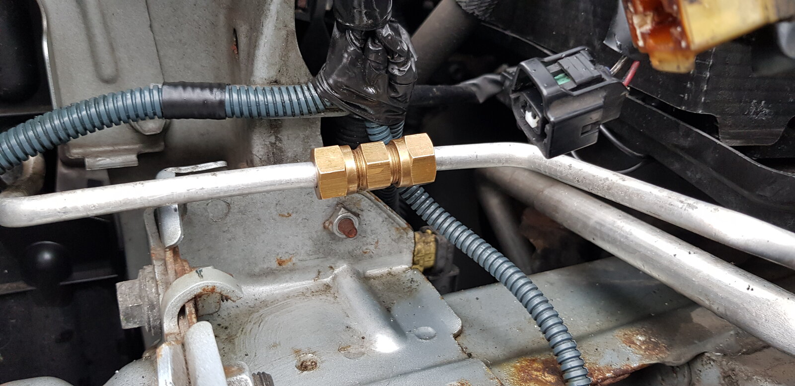

I had a burst pipe in my Avensis in February. I did an unconventional repair on it using an 8mm compression fitting and it's still going strong.
I weighed the can of gas before I started gassing it up, so that I knew how much I had put in.

I’m not sure although when they do it at a garage, the machine recovers the gas and holds the system under vacuum for a while to check for leaks. It then refills to the exact amount with gas and lubricant. The gas I used includes a lubricant too. I suspect in most cases where just a top up is required, the vacuum test/print out is just a bit of time wasting/smoke and mirrors to justify the price charged. Maybe needed if you have some repair work done but for just a little top up, a bit unnecessary for most. I think our Golf's top up was its first in 13 years.

Well, excluding the cost of the gauge (£22 trade, cheaper ones available but none in stock when I went there) the gas works out at £50 for the canister including £10 deposit so £40 in reality. I should be able to get at least three top ups out of it so not too bad in the long run.

There does seem to be a lot of misinformation and confusion between topping up what has escaped past the seals over 10 years and repairing a broken system.
An AC looses it gas because it has a leak. The leak needs repairing, or the gas will continue to leak and continue to damage the environment. A garage will reclaim the gas then do a vacuum test of the system to check it is secure - and should not just bang more gas in it
