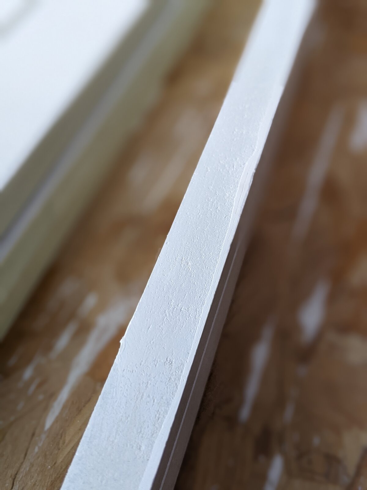

This is an attempt at homemade MDF Skirting. It's the moisture proof MDF that my husband cut himself. I've tried to prime and paint them but was left with a rough finish.
The photo shows where I have tested by sanding with sanding machine and painted one coat of satinwood.
Even though I've sanded till smooth after I apply paint I'm left with these small indents.
Can I try anything else or is this just a lost cause and should we just be buying ready made primed MDF skirting??
TIA
What size sanding paper are you using?
MDF is a soft wood, and needs a fine paper.

We've already bought and cut all the MDF so I have to make it work!
It is very very difficult to get rid of that finish on MDF - it really is horrible stuff.
try oil based gloss paint, it seems quite good at filling the surface (but then you won't be able to finish with water base. Real wood is far better.

The trick, in part, is to use MR-MDF or HDF rather than ordinary MDF. Both of those machine to a better quality edge finish and absorb finishes less, so less grain raising.

TBH applying any water-based finish to a timber or timber-based product will raise the grain because wood fibres always swell when you dampen them. MDF is particularly bad in that respect, hence the preference to side step the issue by using oil-based primers
What I have done in the past was to sand through the grits to something like 320 grit before (spray) finishing. The finer surface seems to absorb water less readily, although spraying as opposed to brushing or rollering also makes a difference. Even so it still requires 3 to 4 coats, denibbed between coats, to get a good quality finish
I've been watching some YouTube videos⁹ trying to find a sealant of some kind. Wondering I have already primed then sanded and painted over so this technique didn't seem to work for me.
How fine (what grit) did you sand to before priming? What type of primer dud you use? (Water or oil based? High solids?) Did you denib and prime a second time then denib and prime a third time? (For high gloss piano finishes you may need to go through this process 6 or more times - a lot of work)
Sorry, but there is no magic bullet product out there, although oil-based high solids primers get close

P21 grit sanded first then primed then water based paint. Sanded again and painted to test. All seems too time consuming!

Yes the primer was water based. We thought this would be money saving as we are spending a lot of money on other parts of the house. Didn't realise timber was cheaper. After watching many YouTube experiments on MDF it seems the finished look still has a mottled effect.
