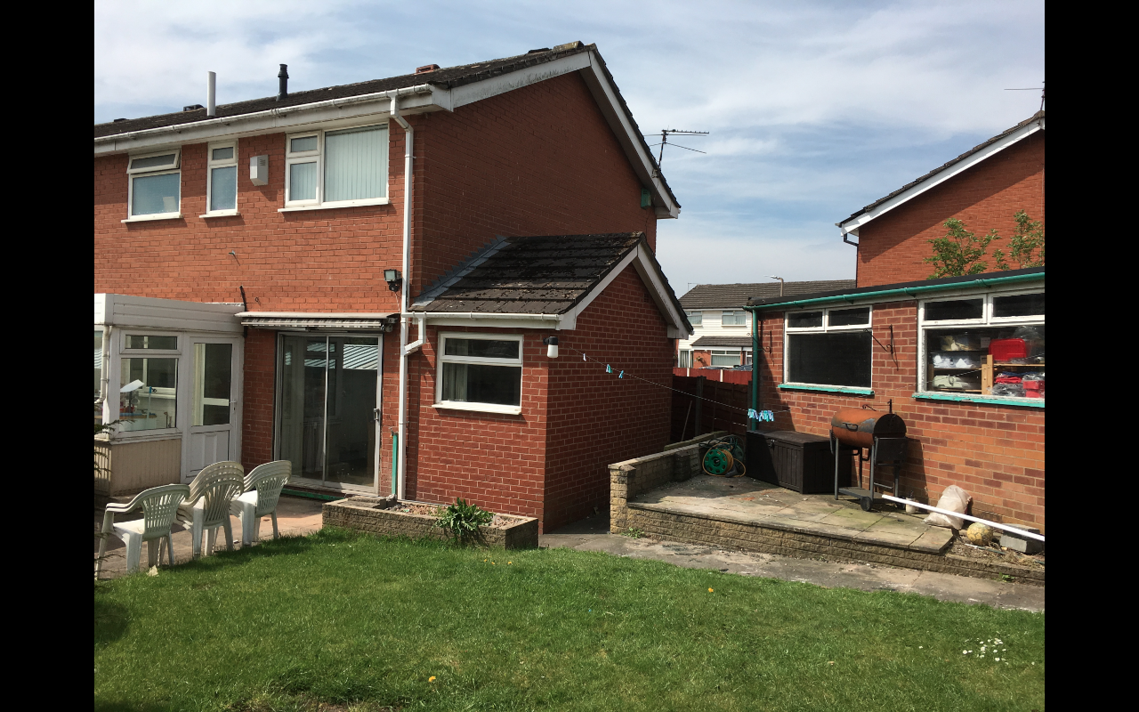

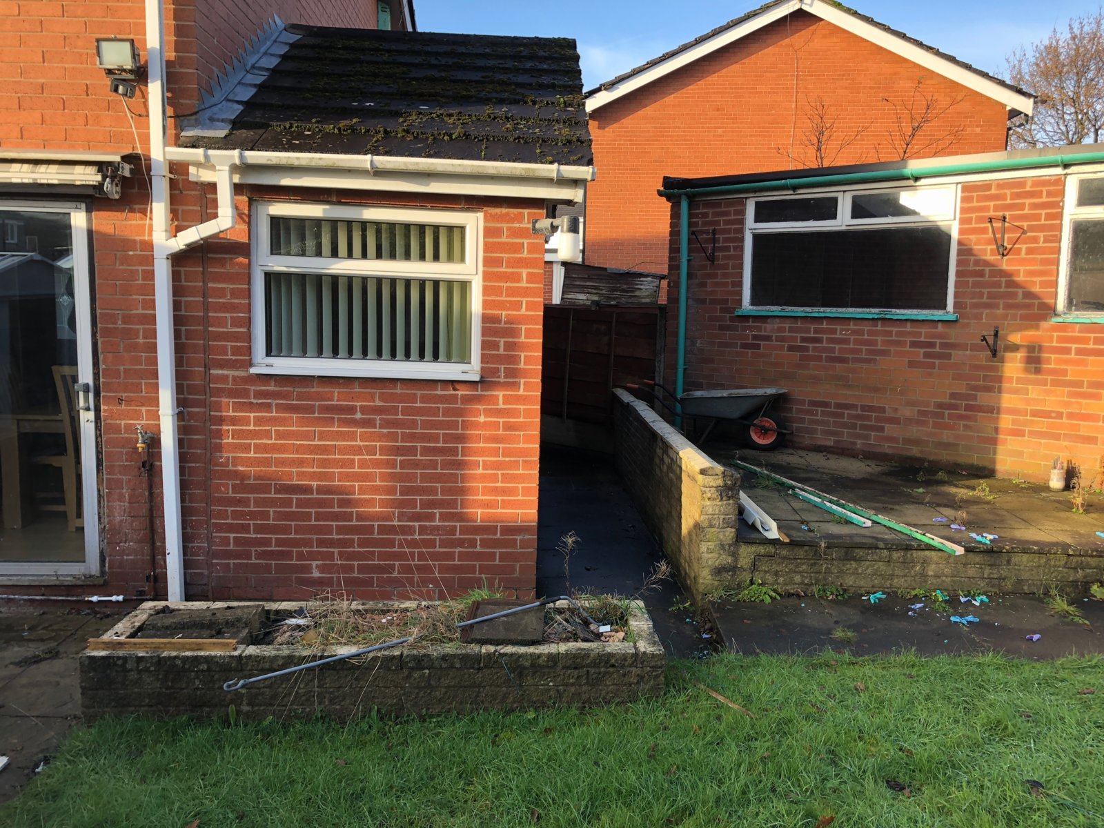

Knock down the detached garage, knock down the small single storey extension, lean-to and rebuild a two storey side extension.

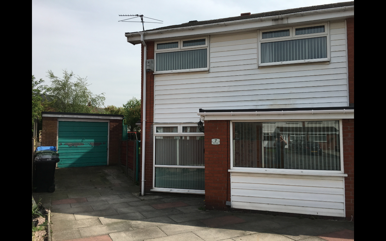

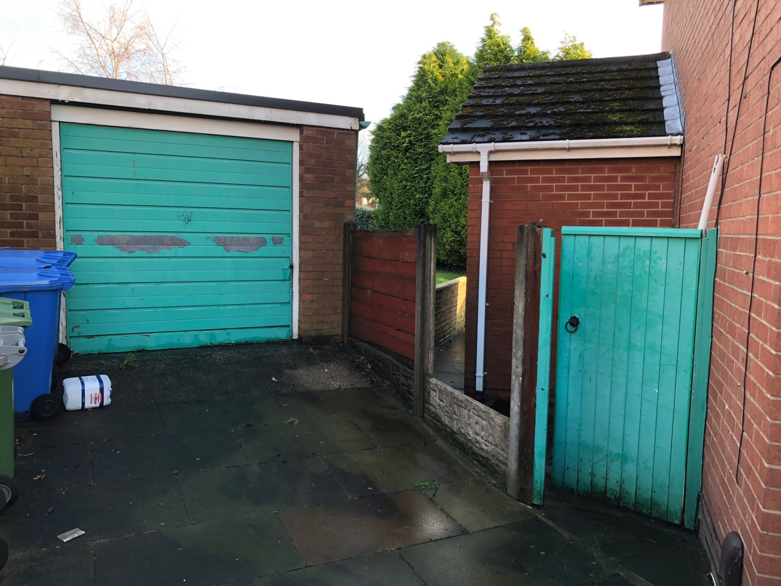

The Current House
Not a fan of the cladding, so hoping to have that removed and rendered in future, but here is my 70's box.
This is the side of the house... the green gate, fence, side extension and detached garage all going to come down.
If you're wondering... yes that window was actually sloping! :LOL:
That horrible white lean-to will be going... wife has even offered to demolish it herself!

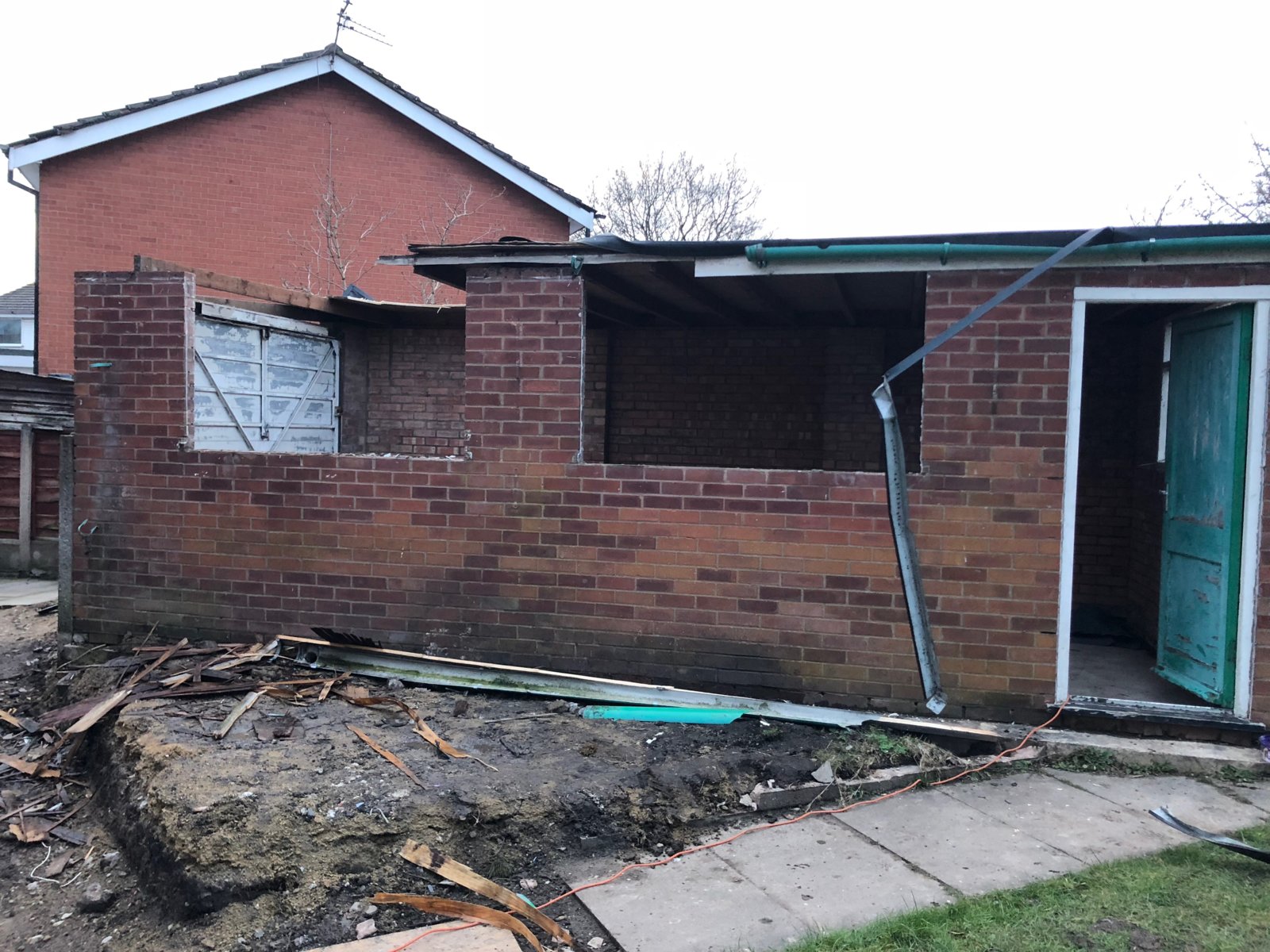

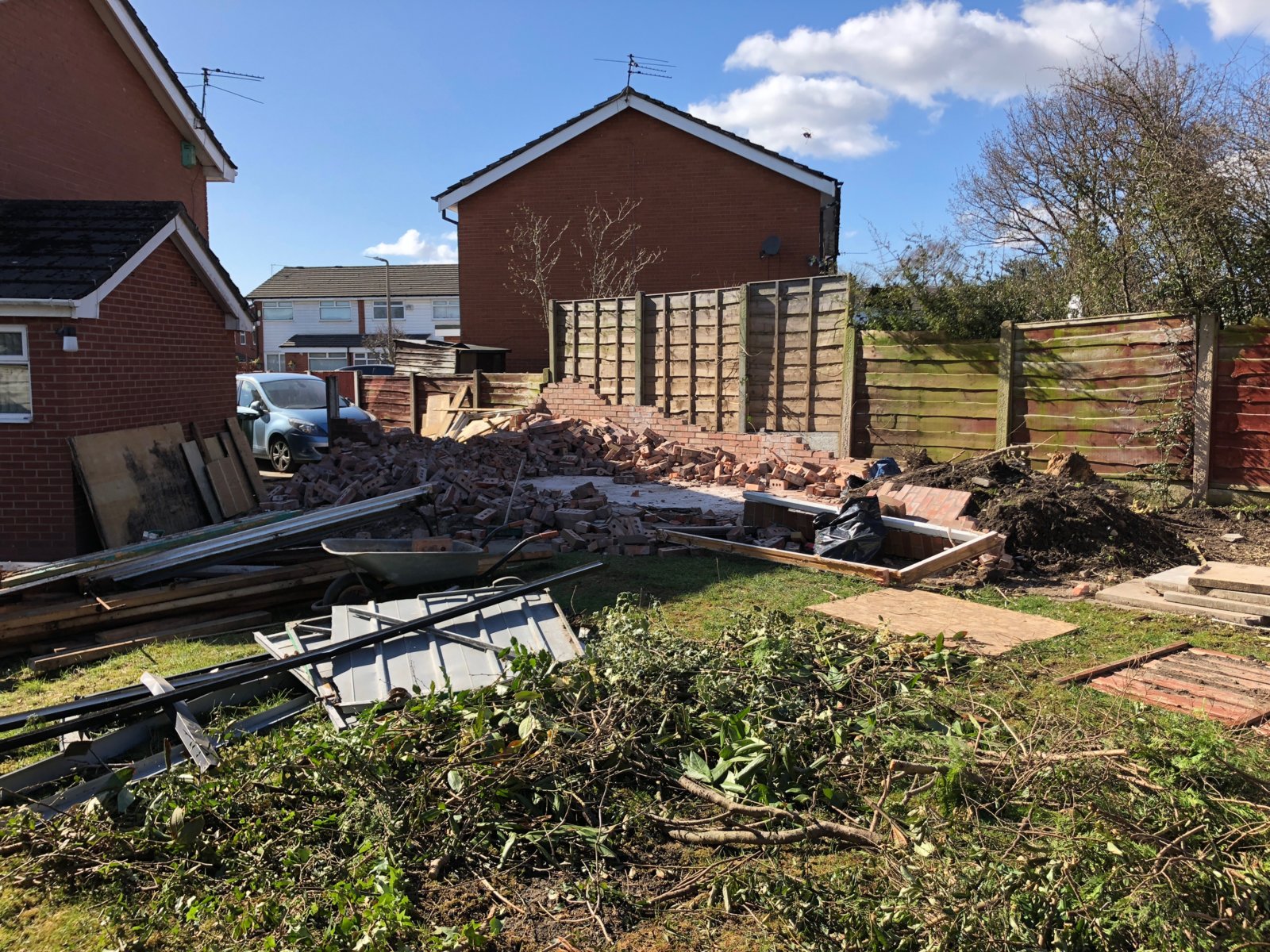

Demolition of the Garage
I totally underestimated how difficult and expensive the demolition was going to be. I didn't use any plant machinery, just a few basic tools; a sledgehammer, drill, reciprocating saw. The wife and kids chipped in a little to whack the smaller walls with the sledgehammer!
Roof off...
Garage down... now just need to remove that slab!
3 skips later.... :eek:

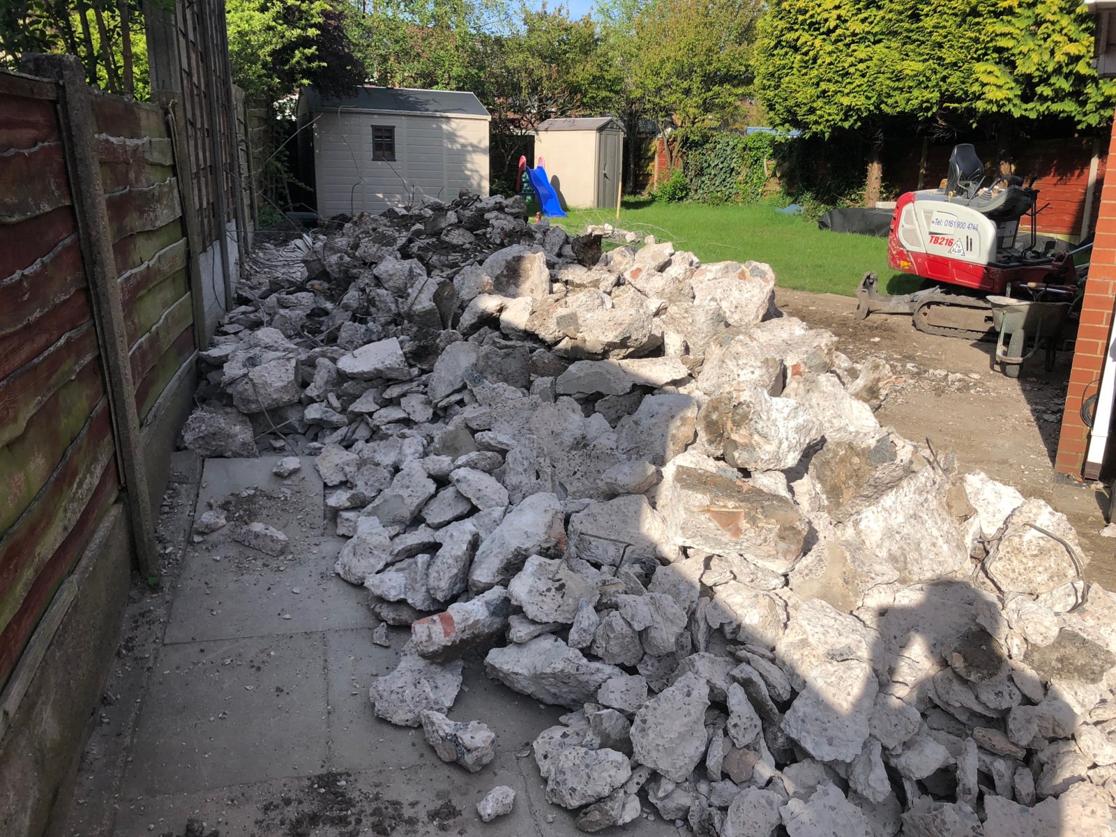

The garage slab was the biggest shock, I attempted to use mini breaker to remove the slab although find it was a fully re-inforced raft up to 600mm deep.... :eek:
I ended up paying a local builder to demolish it with a mini digger, took two guys two days to break it and remove it!

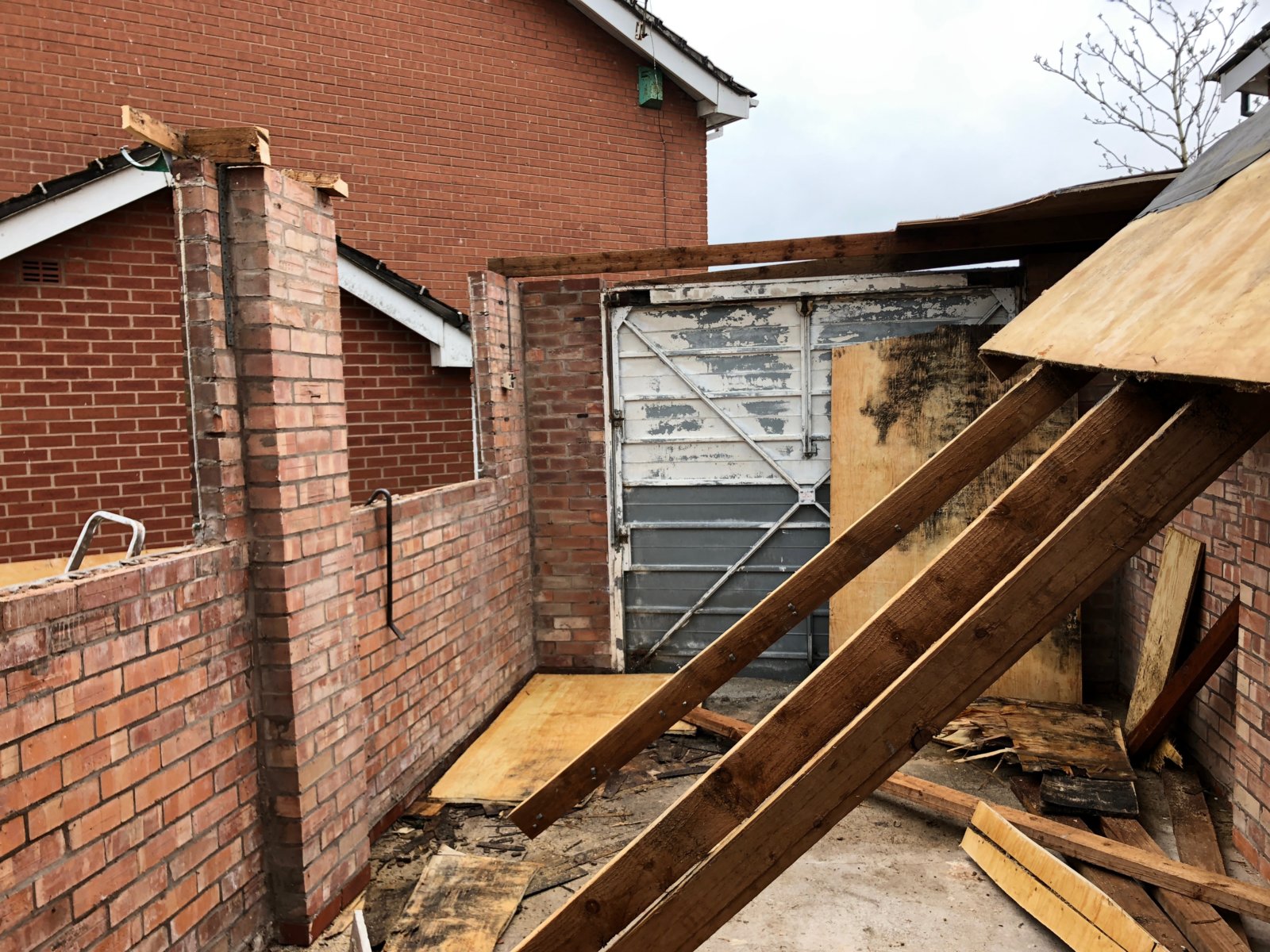

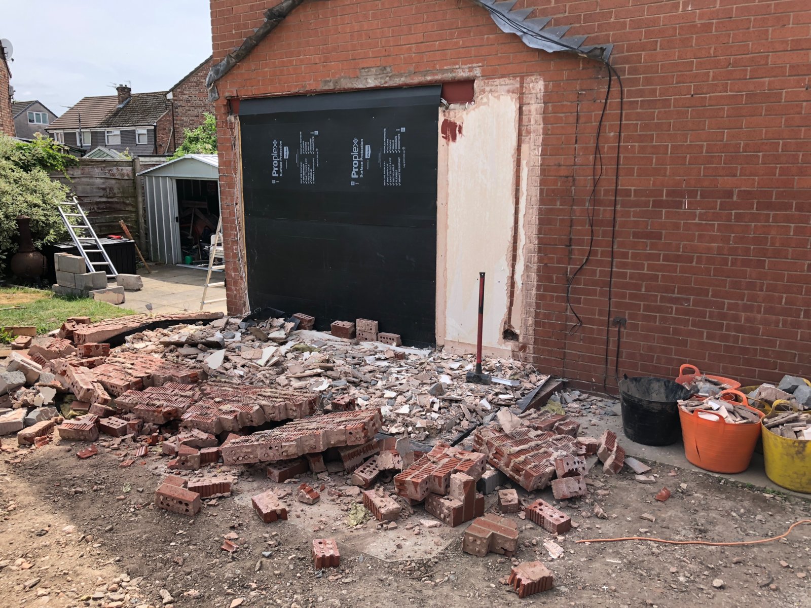

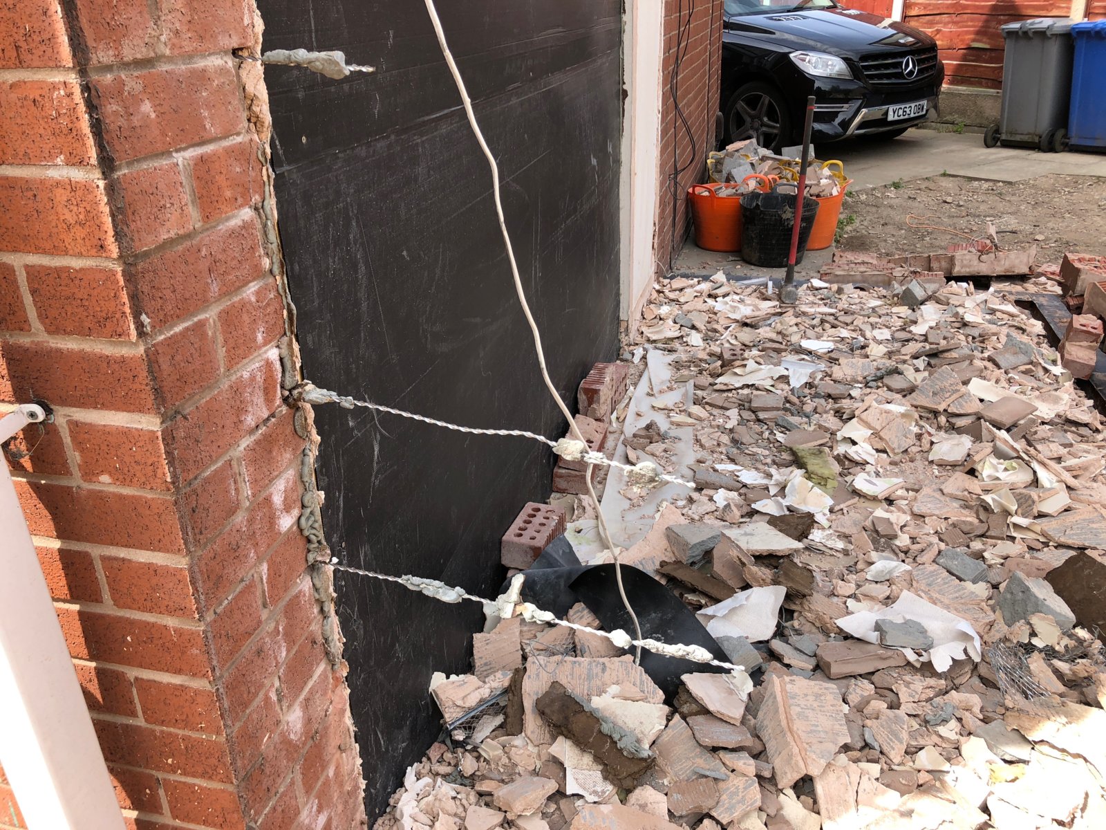

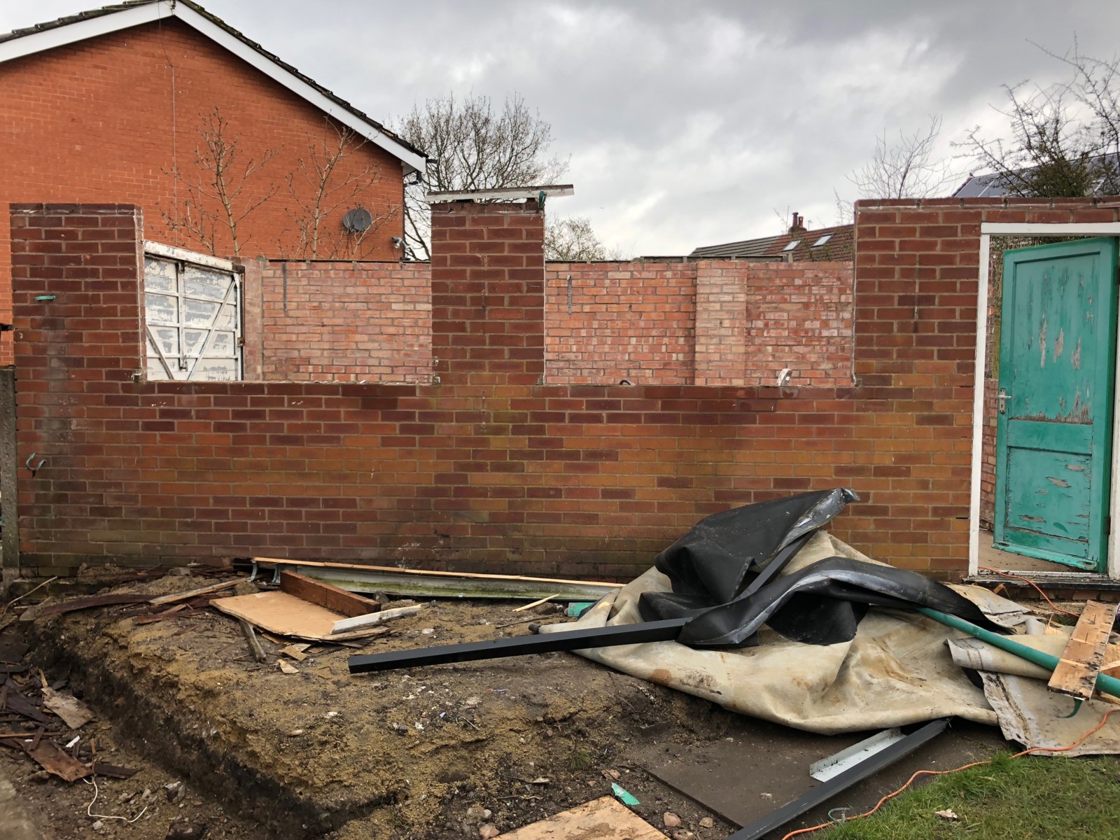

The small extension was next. I didn't want to just rip this down with machinery, so I took it down slowly from the roof down.
Lintels already installed to the last extension so i just stud walled the opening and covered with protective sheeting and sealed.

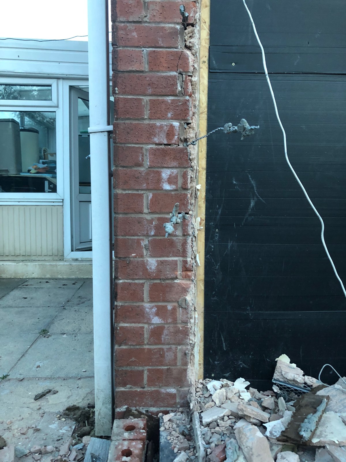

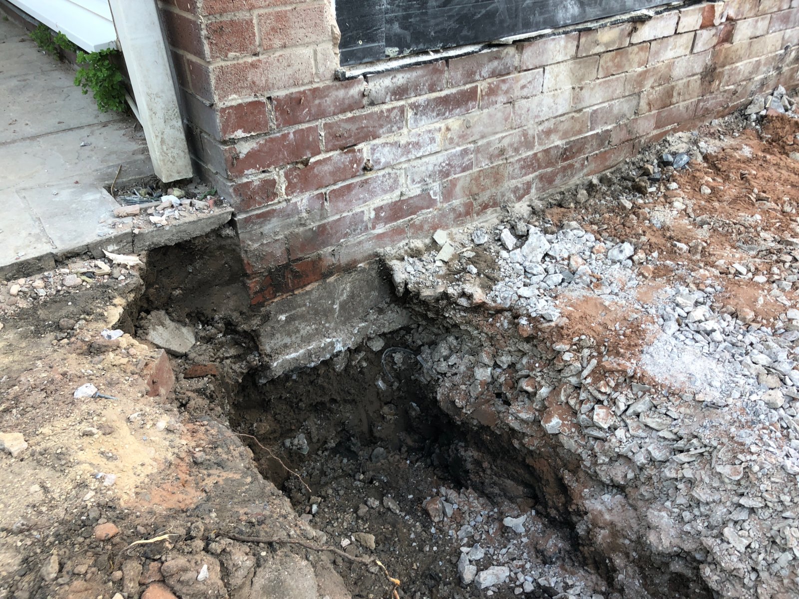

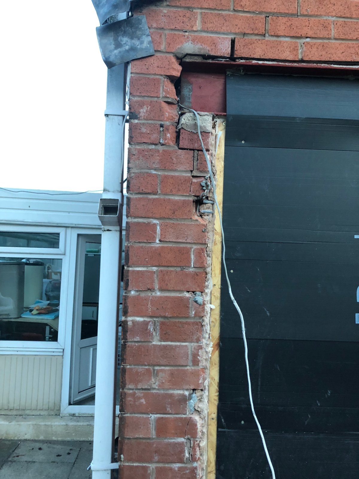

The old extension had obviously had problems with cracking, hence the helical bars. There was no other means of connecting the old extension to the house.
The wall where the previous extension butted up to. The building inspector has said this needs opening up for a vertical DPC so i'll have to rebuild this section of wall under the lintels.

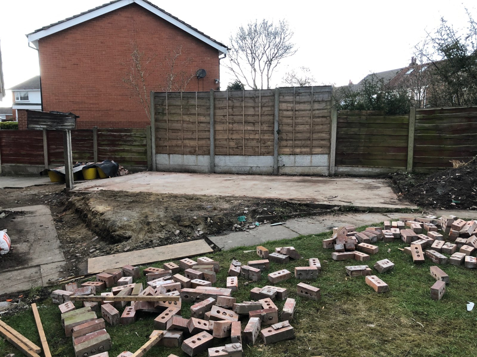

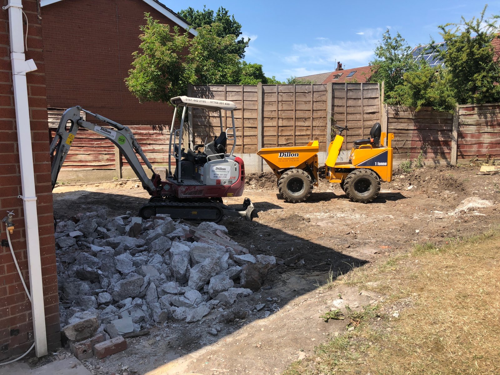

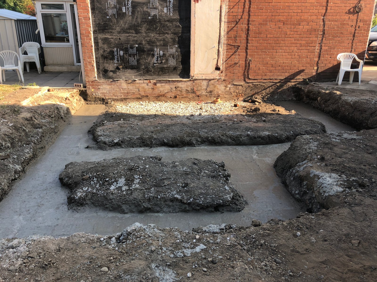

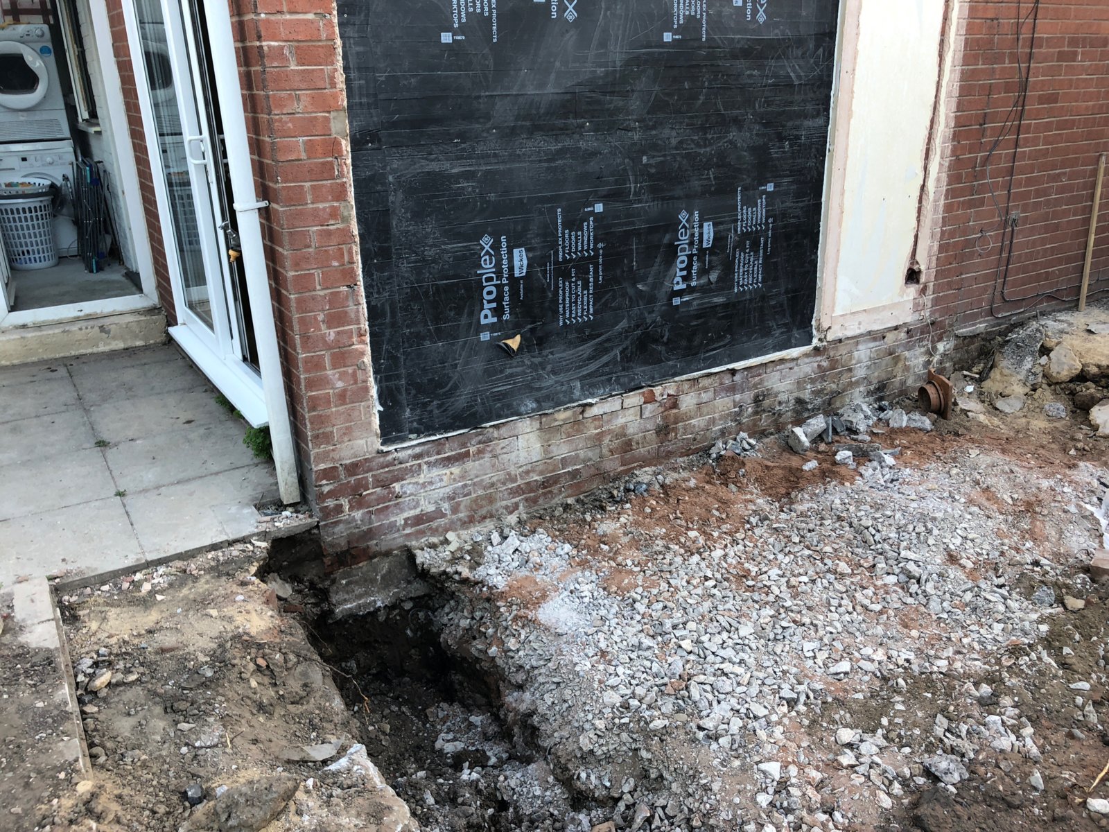

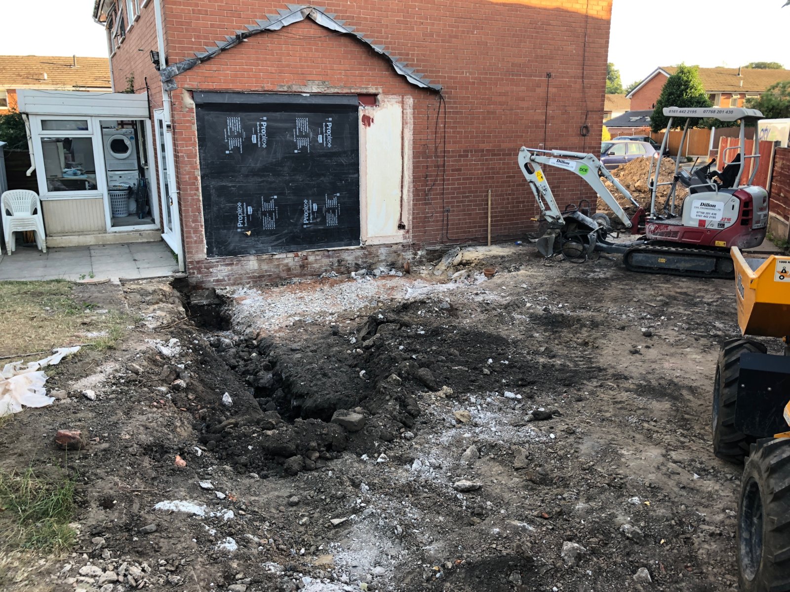

The last part of the demolition was to remove the old extension footings, a raft. I decided to hire the guy with the digger for this part again, so he broke up the raft and levelled the site.

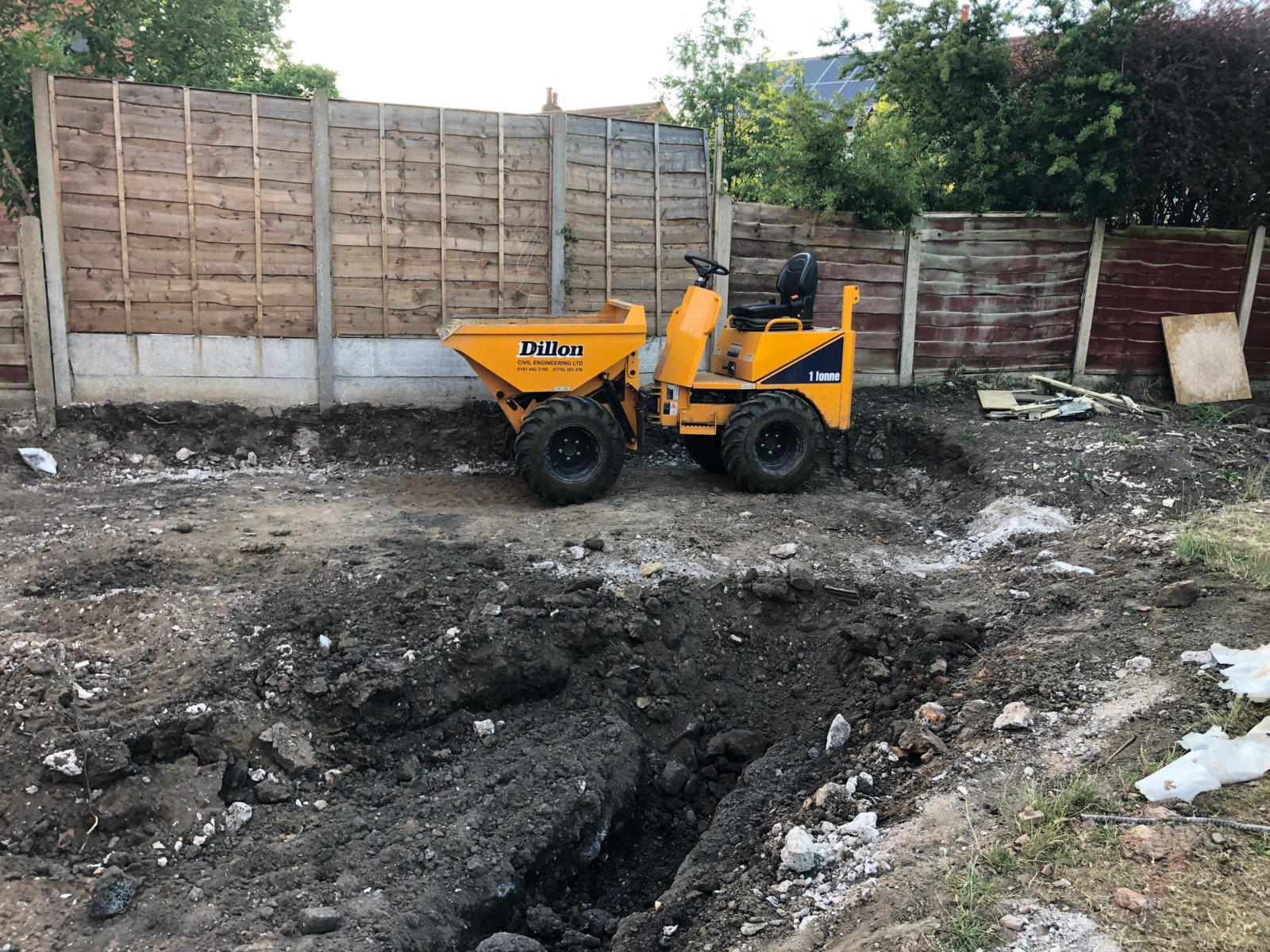

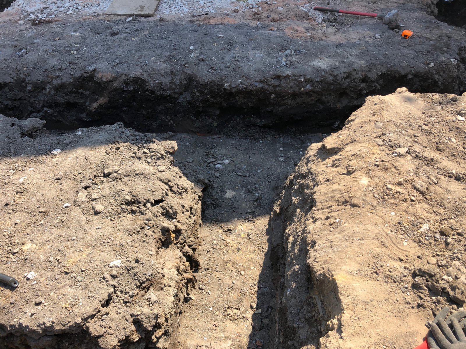

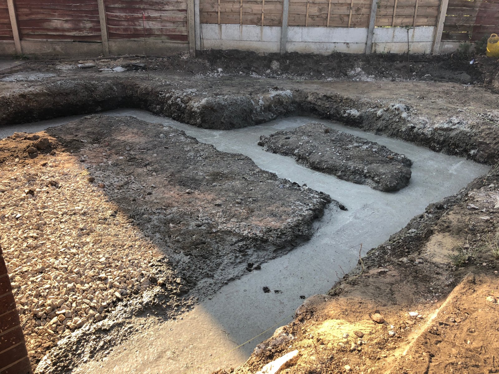

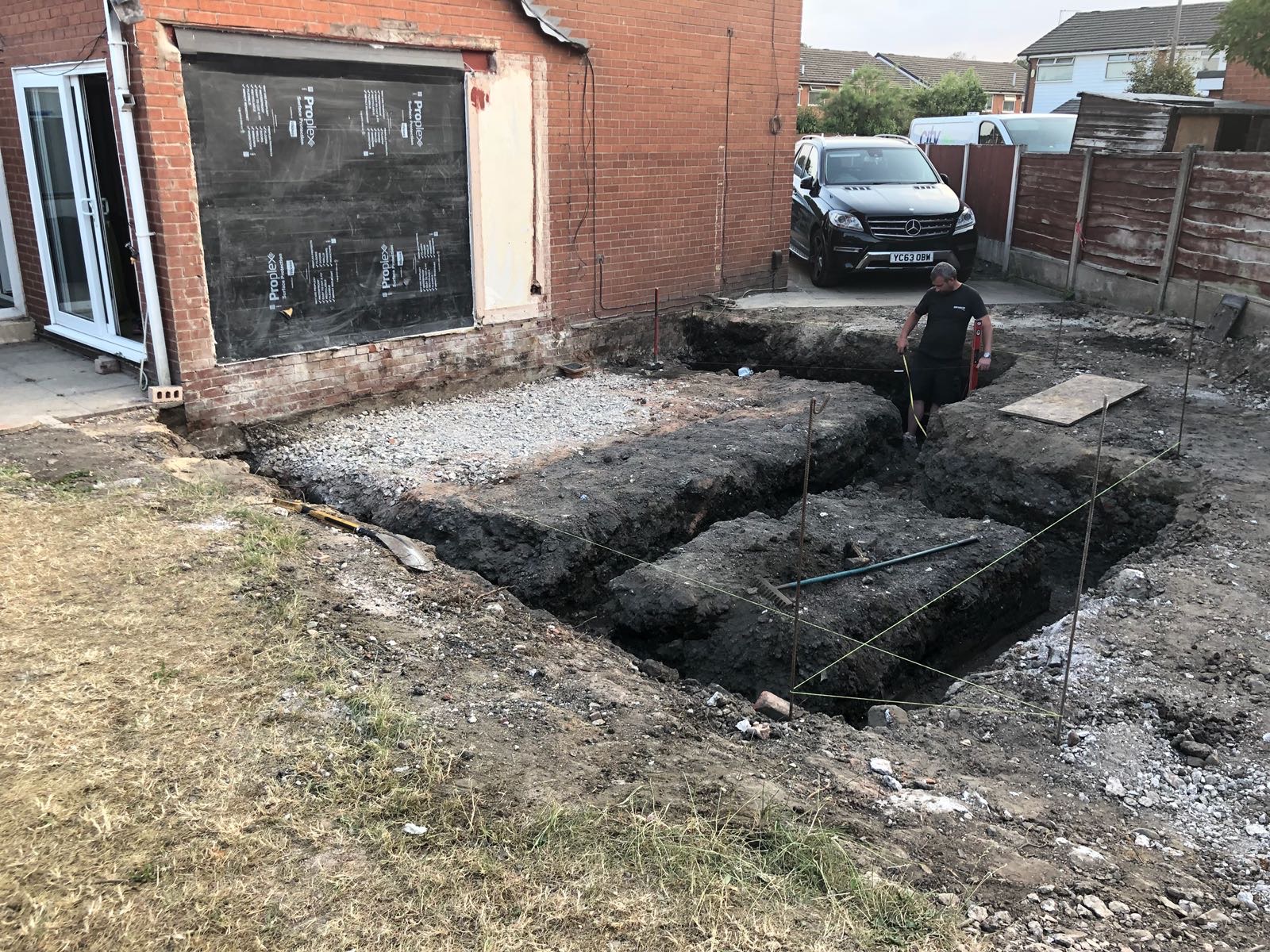

Dig the Foundations

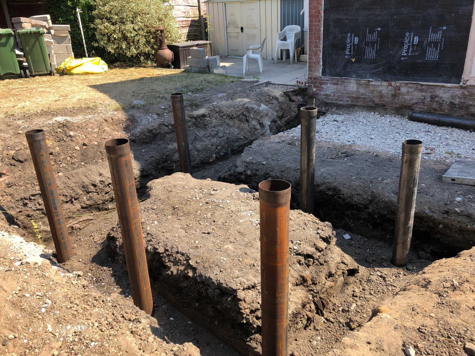

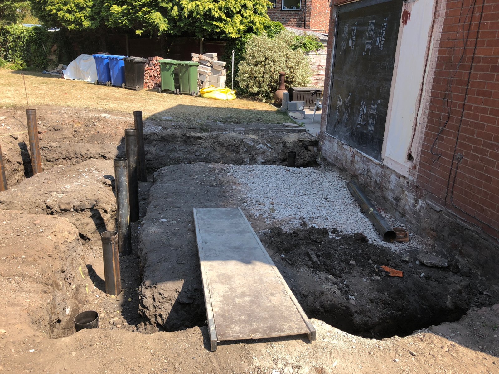

I was going to have the foundations piled on recommendation from various sources, including the building inspector so I used the guy with a digger for this bit too. It was funny actually, because I had the guy in my phone as "Martin Diggerman" and when my son saw it he said in all seriousness... "so his name is Diggerman and that's what he does for a living too!" DOH! :ROFLMAO:
After he demolished the extension footings, he dug the trenches and cleared the site ready for the piling guys to come in.
The ground was hard and awful to dig. Quite possibly an old industrial site i was told by building inspector. The trenches didn't stay nice and straight, they just collapsed around the sides.

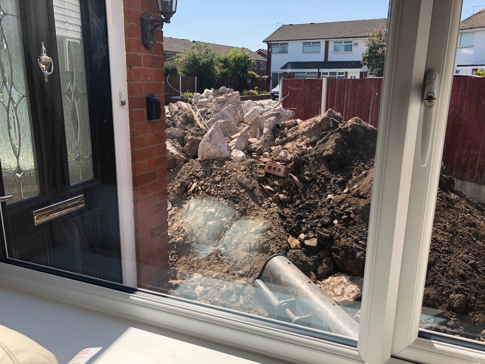

House on a raft foundation.
I bet the neighbours loved us! About three loads of this went out via muck away trucks.
That's me in the trenches, just doing some checks on the sizes and squareness! After the piling goes in.... time to start getting my hands dirty again. :D

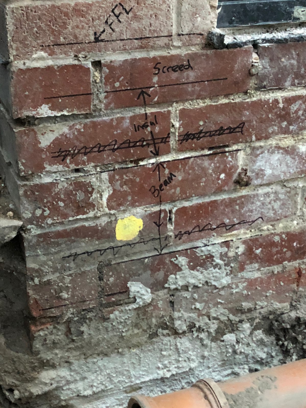

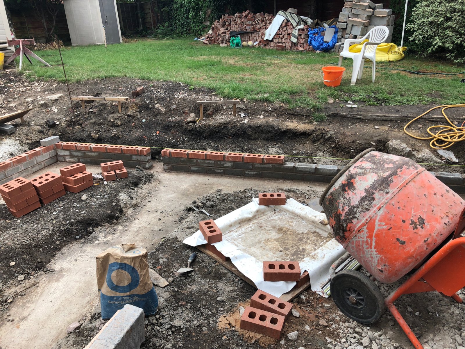

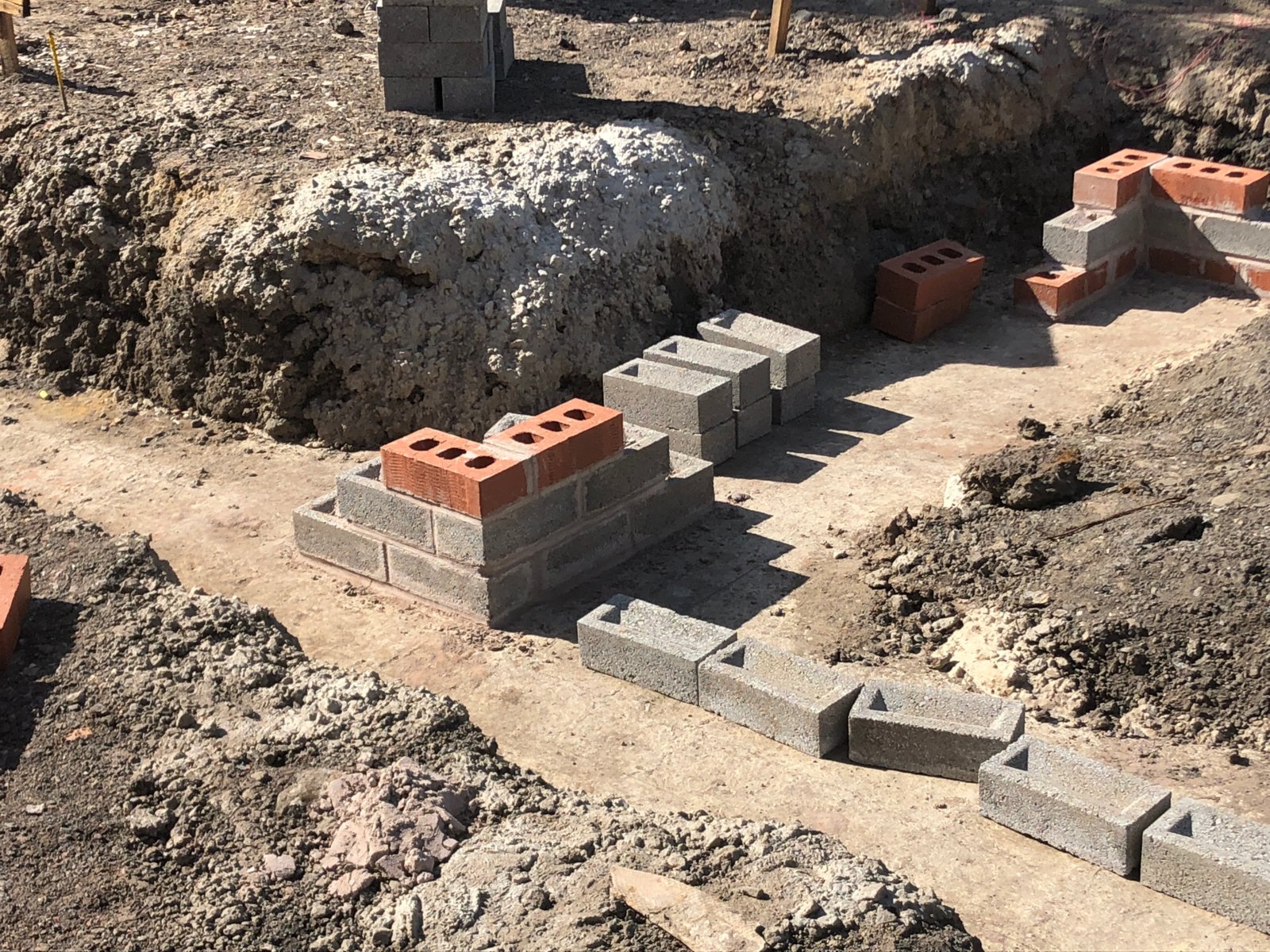

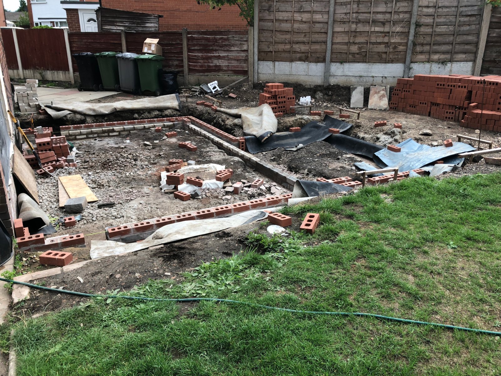

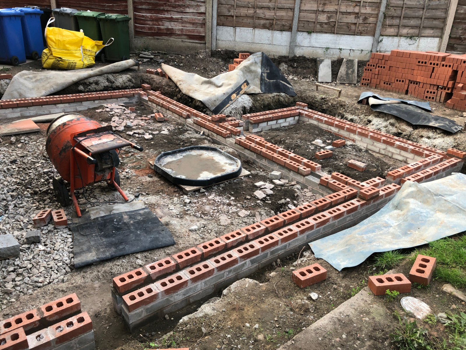

Okay, this is where I start properly now. I measured out the extension using a combination of measuring from the existing house and the 3,4,5 method to square up the extension. Once I had the exact corner locations i was able to set my gauge levels.
First of all I worked down from the existing house DPC to get my levels, allowing for the screed height specified in my building regs, the insulation height and allowing for the block and beam flooring that i would be installing.

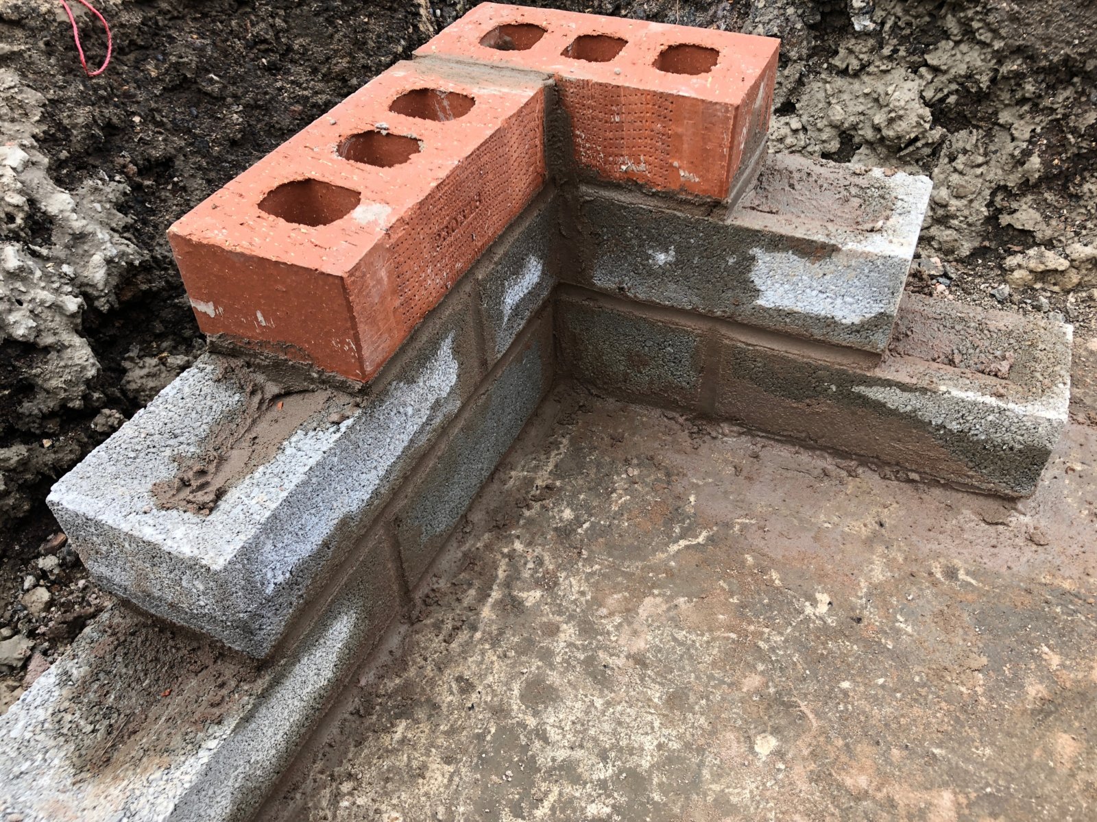

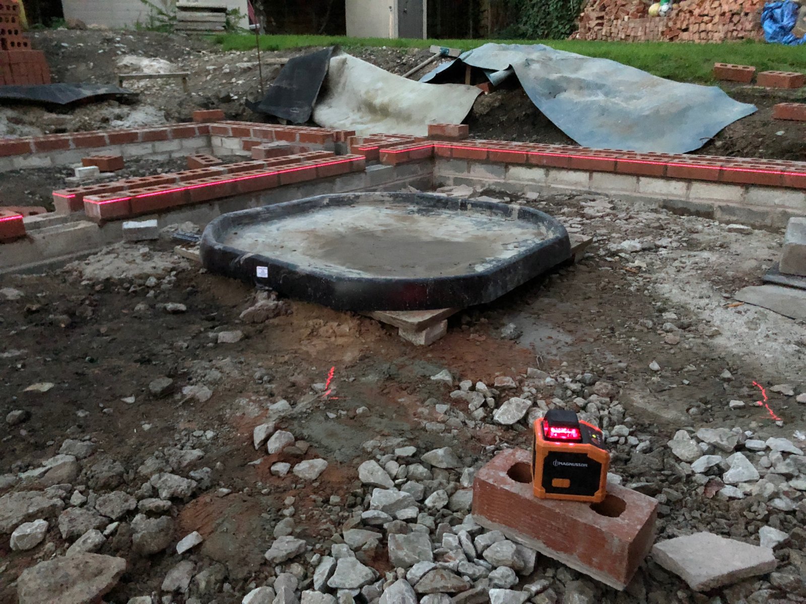

I setup bricks at each corner location and setup a gauge rod. I used a 360 degree laser level to set the height up to four brickwork courses (the height where my block and beams would sit).
Basically, the laser (not pictured) would project onto each wooden rod (each one sat on the concrete, just using the bricks to hold them upright).
Once I had the 300mm height on the laser, I could mark each rod and measure down to find out how high each corner was. I could then mark the 75mm brick courses on each rod.

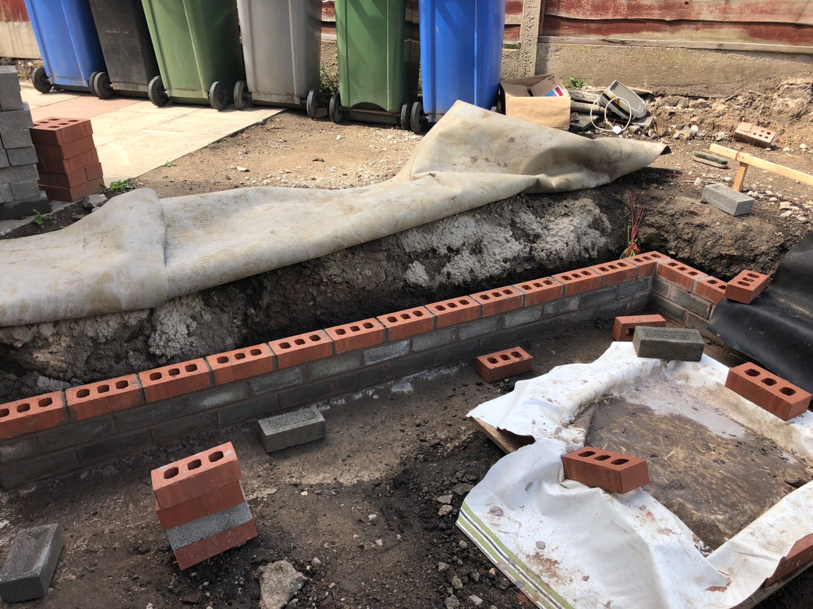

Using my newly create wooden gauge rod, I built my first brickwork corner! (y)

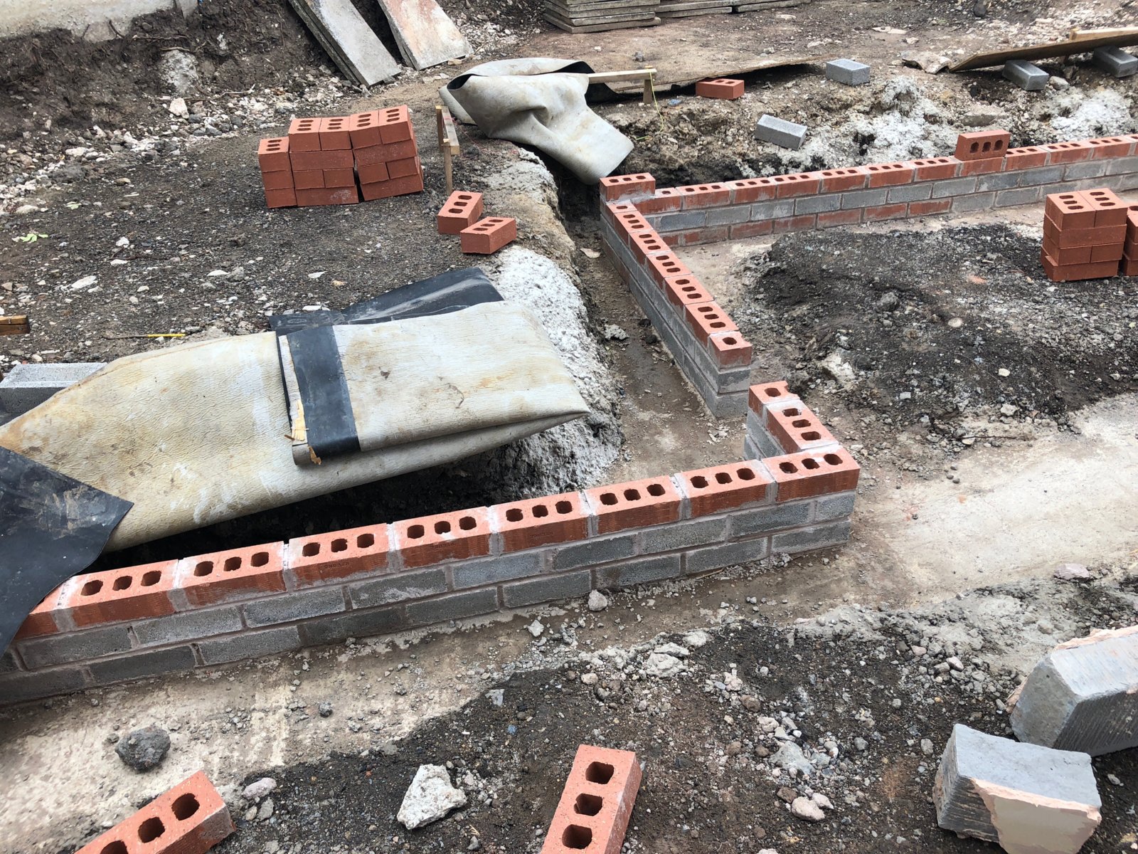

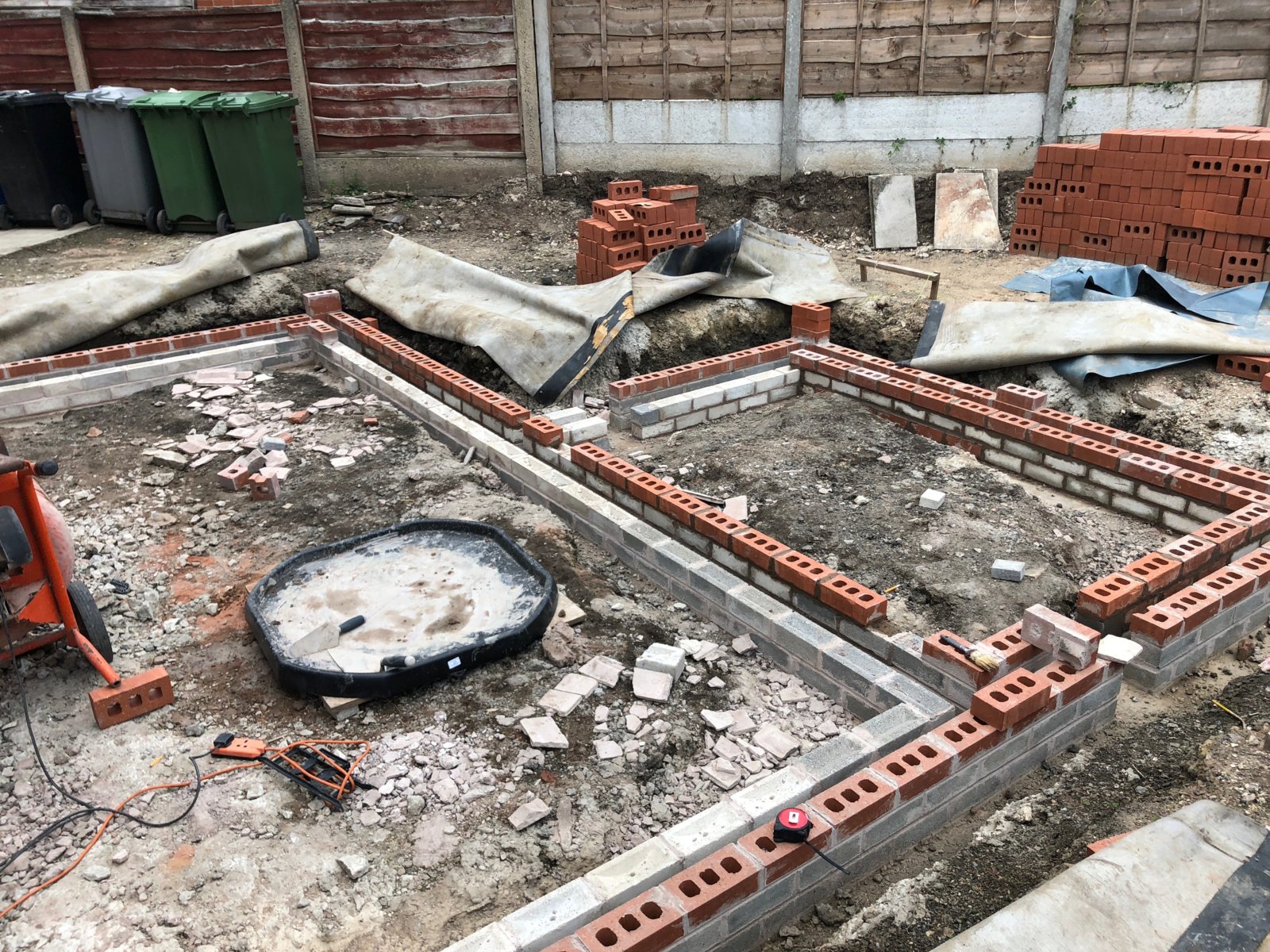

After the corners were built, I could dry bond the walls.

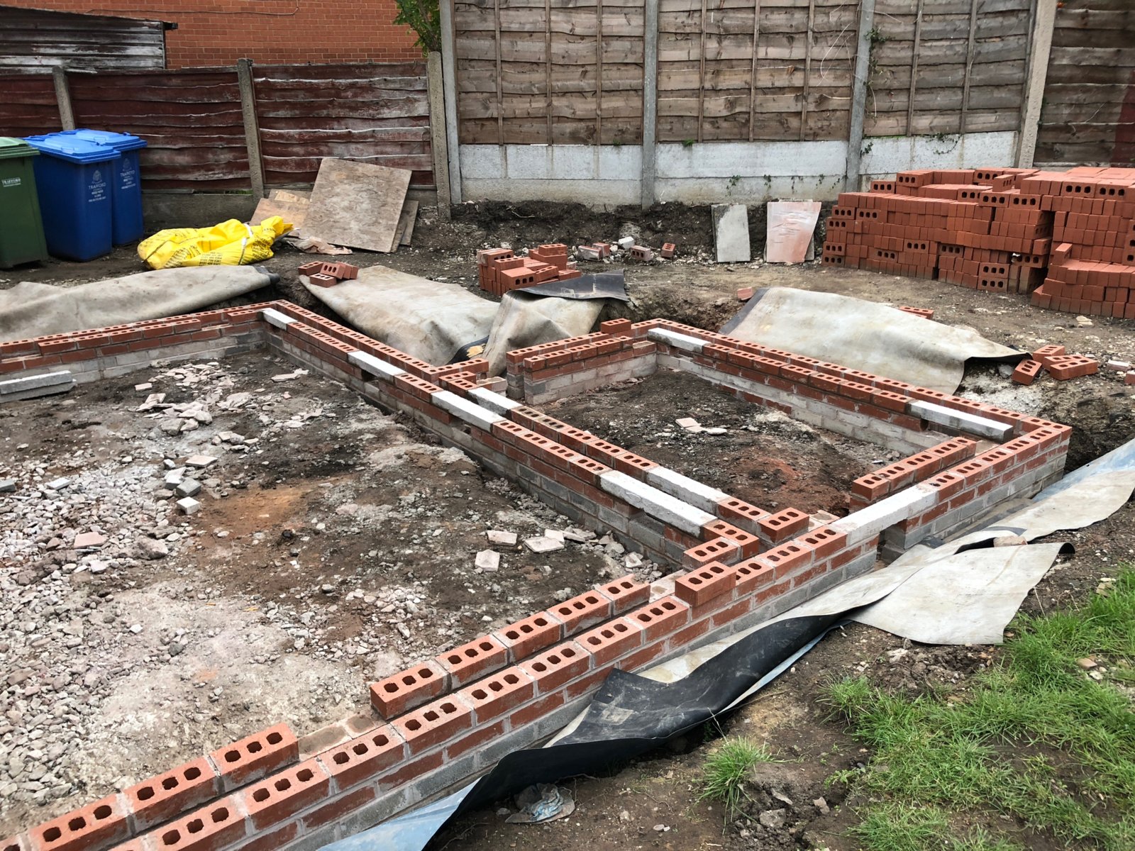

I setup my brick lines, and laid the first rows.

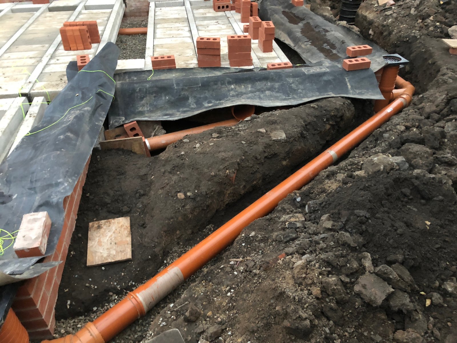

The gaps in the brickwork are where the drains will run under the extension. I have a rainwater drain and a foul drain to run under the property.
My trusty cement mixer which I bought second hand off a guy for £50.

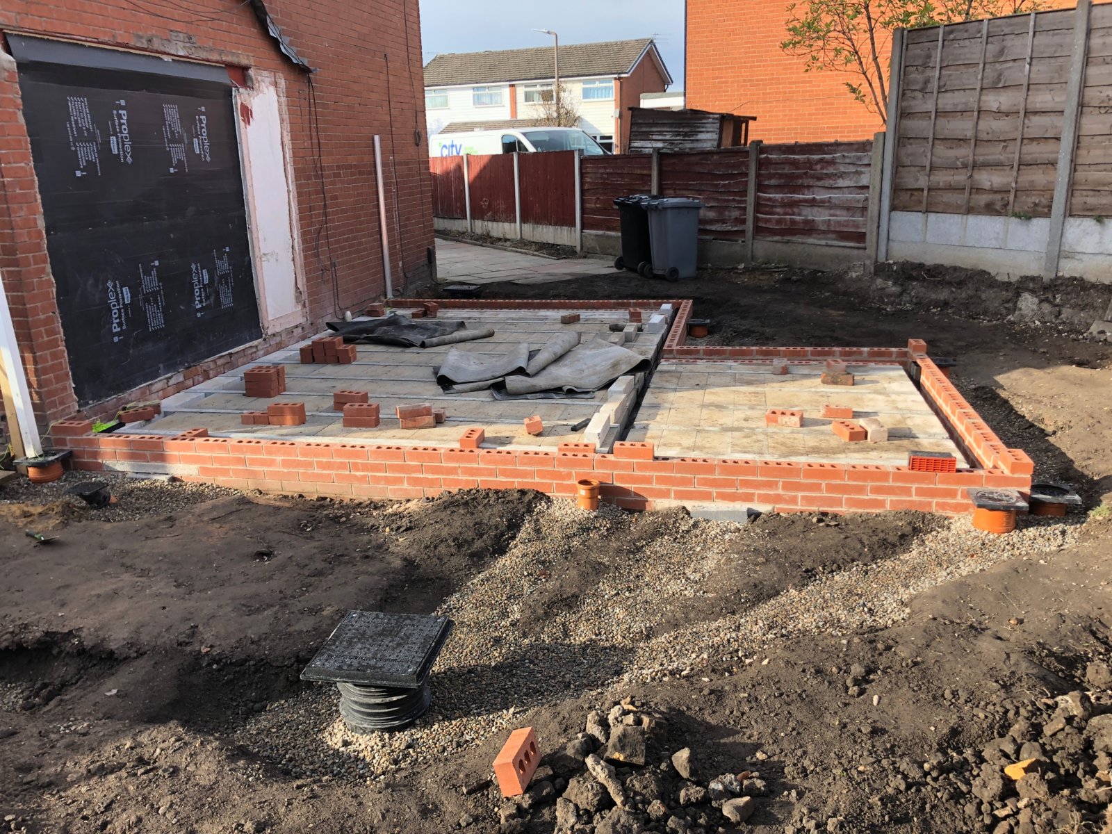

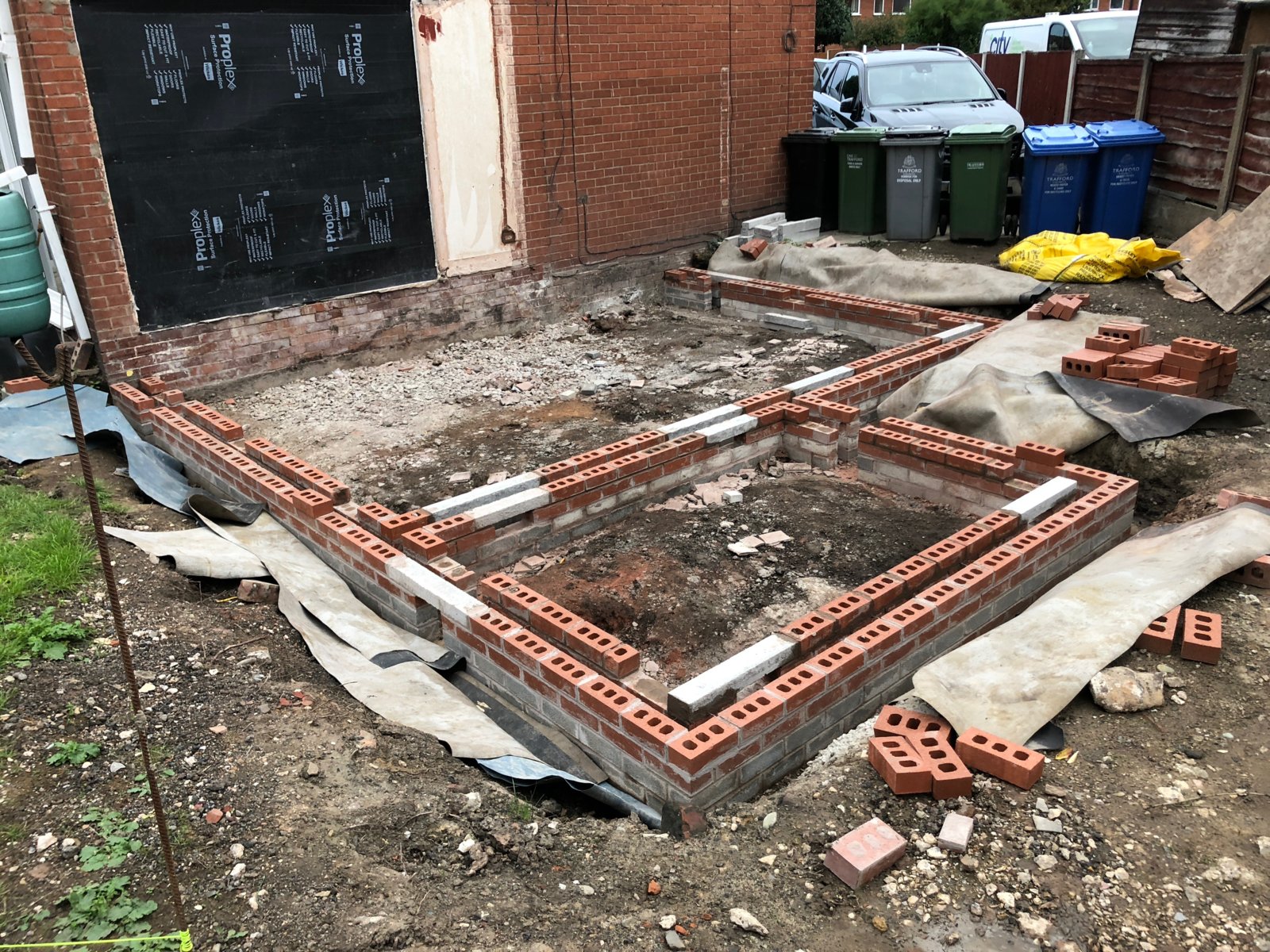

Finishing the brickwork to Block & Beam Level
The brickwork nearly finished up to the block and beam level.
A check with the laser level!

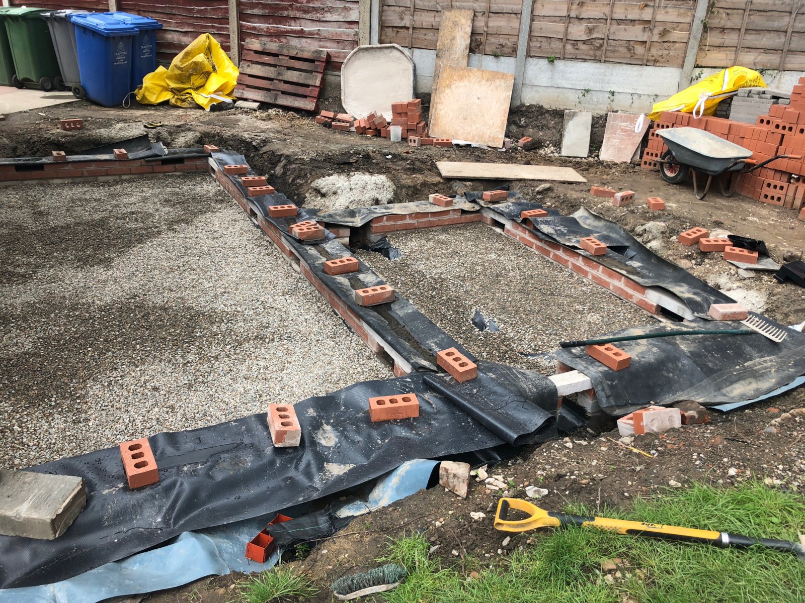

Concrete lintels installed over the periscope vent locations and over the drain runs.
Internal area levelled, weed killed, tough membrane installed and gravelled over. Weed killed again.

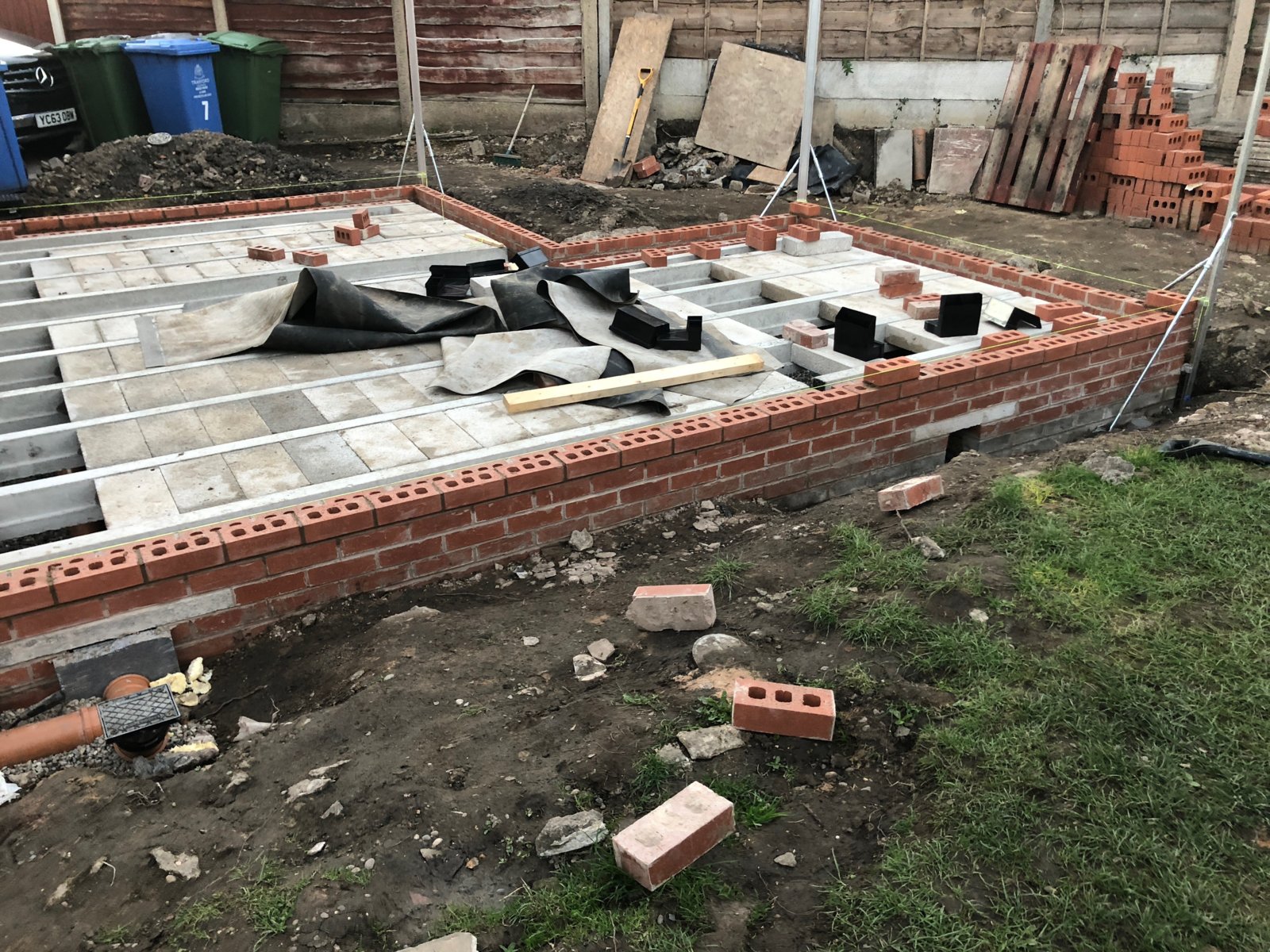

Block & Beam Flooring

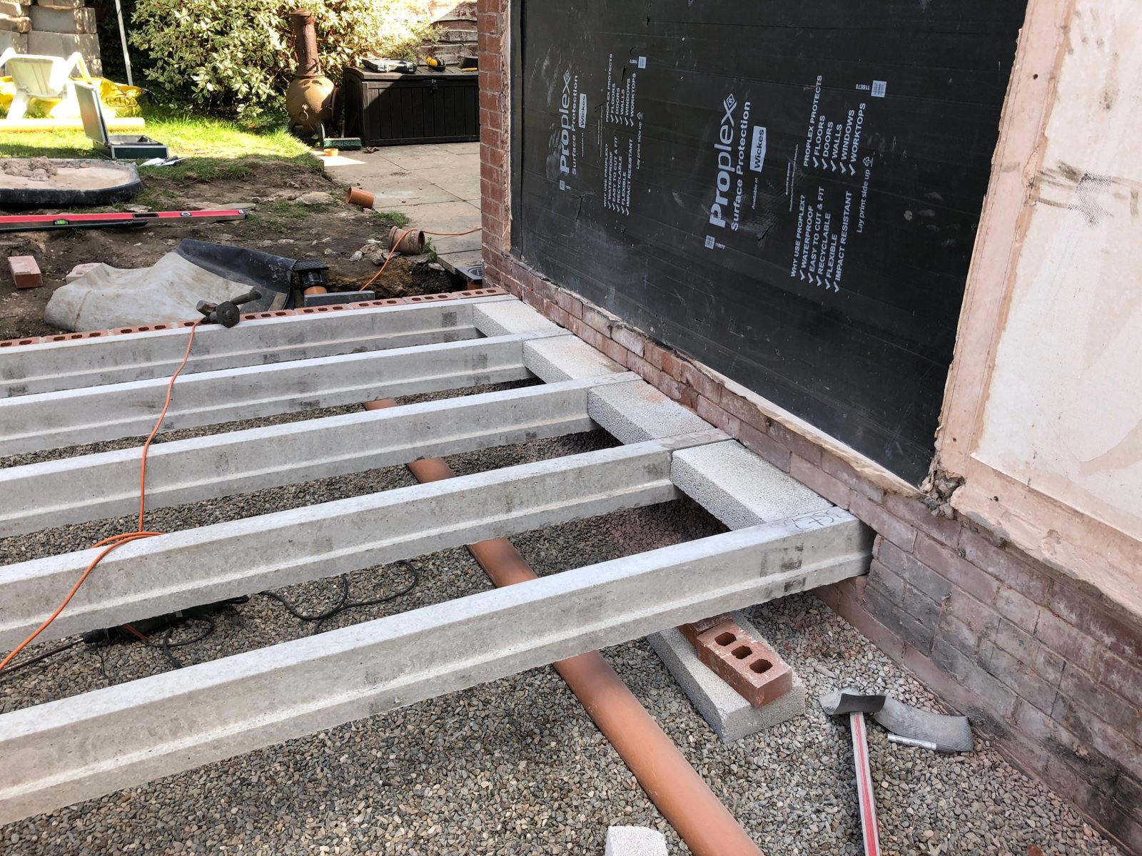

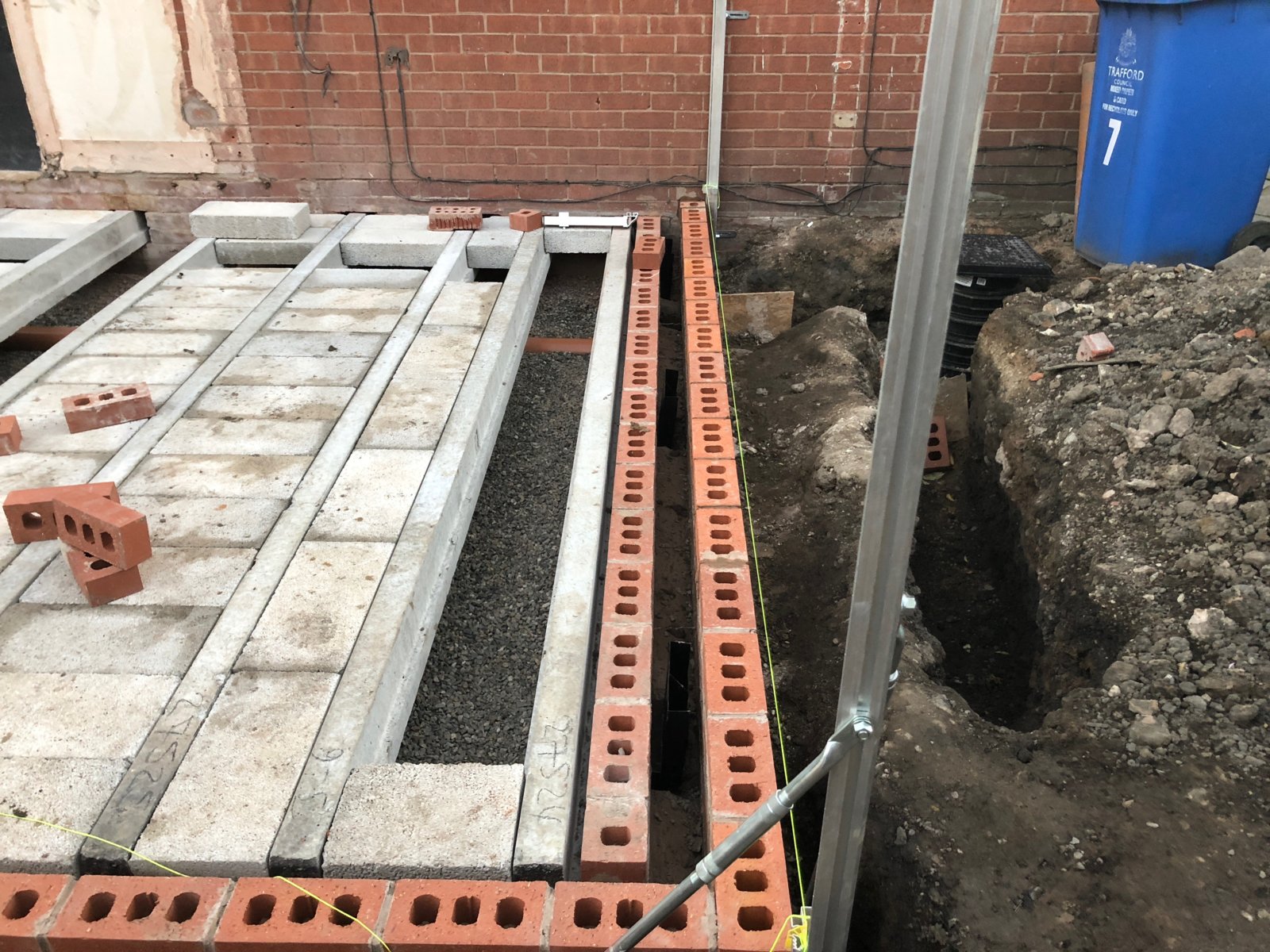

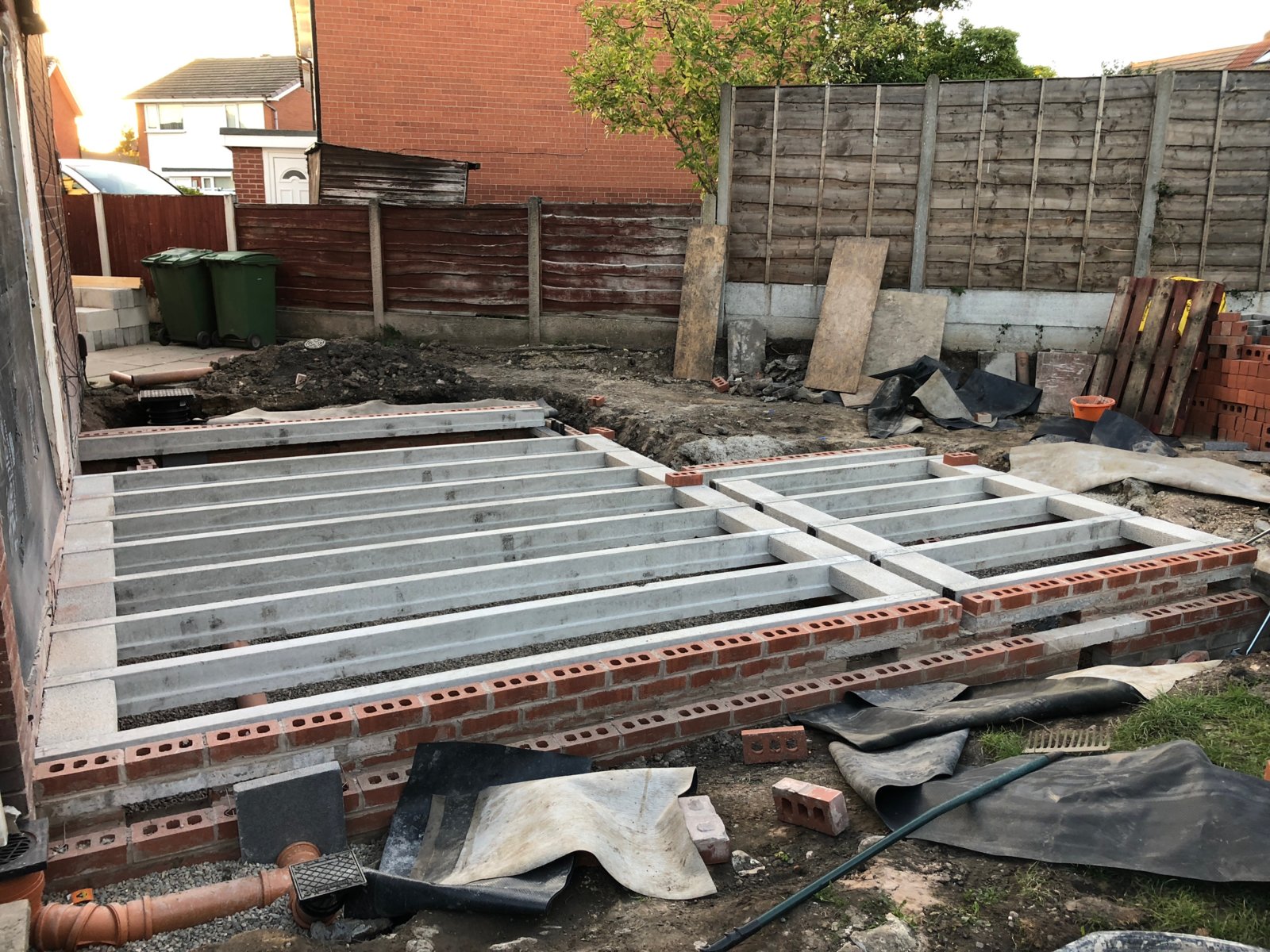

Next came the block and beam flooring.
I drilled out the pockets in the existing house wall to sit the beam ends on, then came the tricky part; moving the beams from my driveway into place.
I moved and installed the beams by myself (not something i'd recommend). The 3600mm beams weighed 124KG each :eek: and there were 11 of them to manoeuvre into place. I used a sack truck mid centre of the each beam to balance the weight and wheeled each beam as close as possible to the extension. I then lifted and moved the end 500-1000mm a time until they were in place - hard work! I made a video of this actually, so will hope to post up soon.

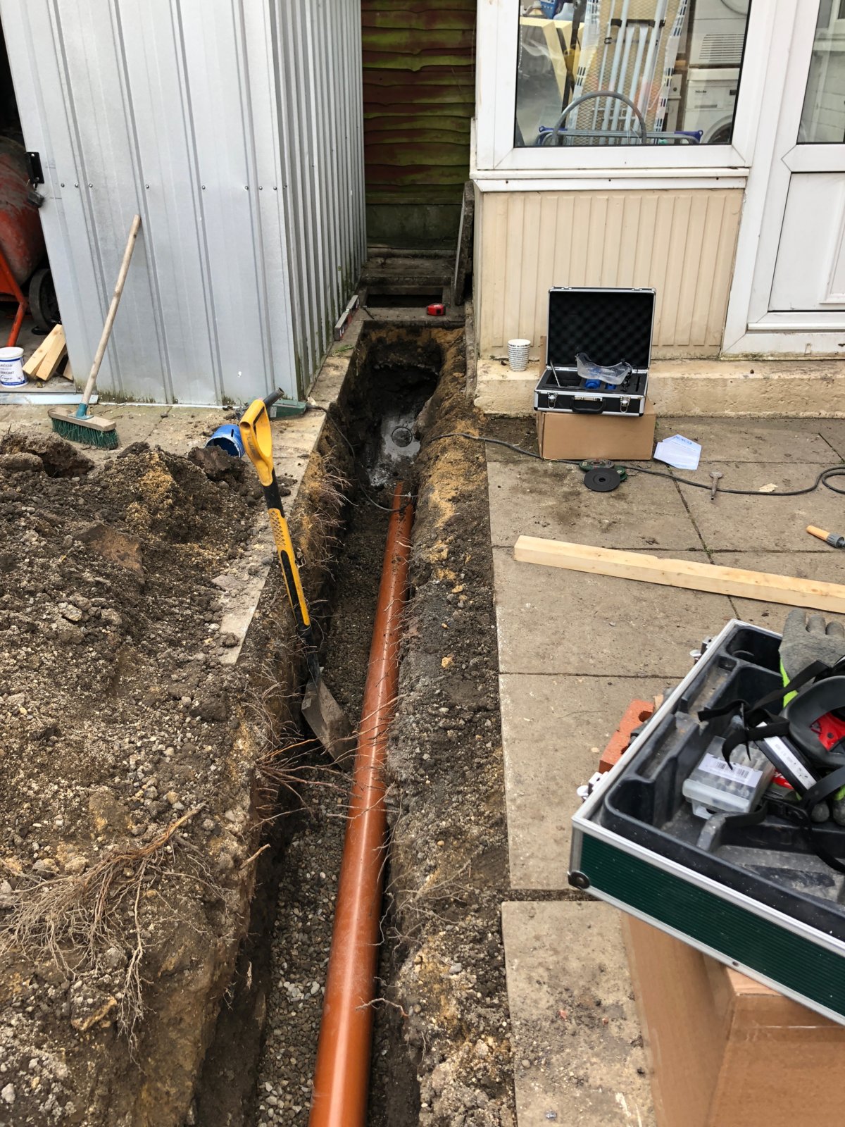

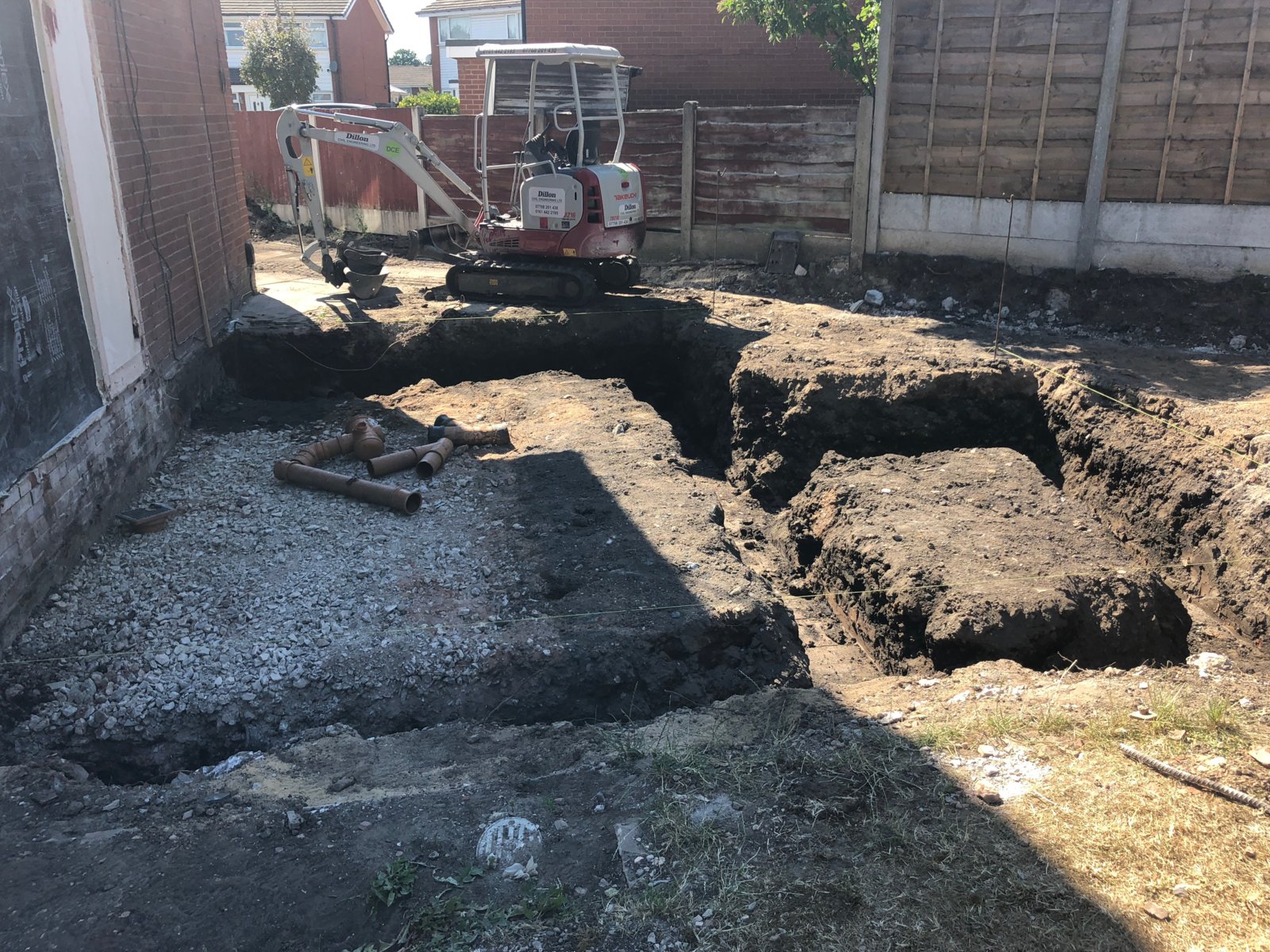

Drainage

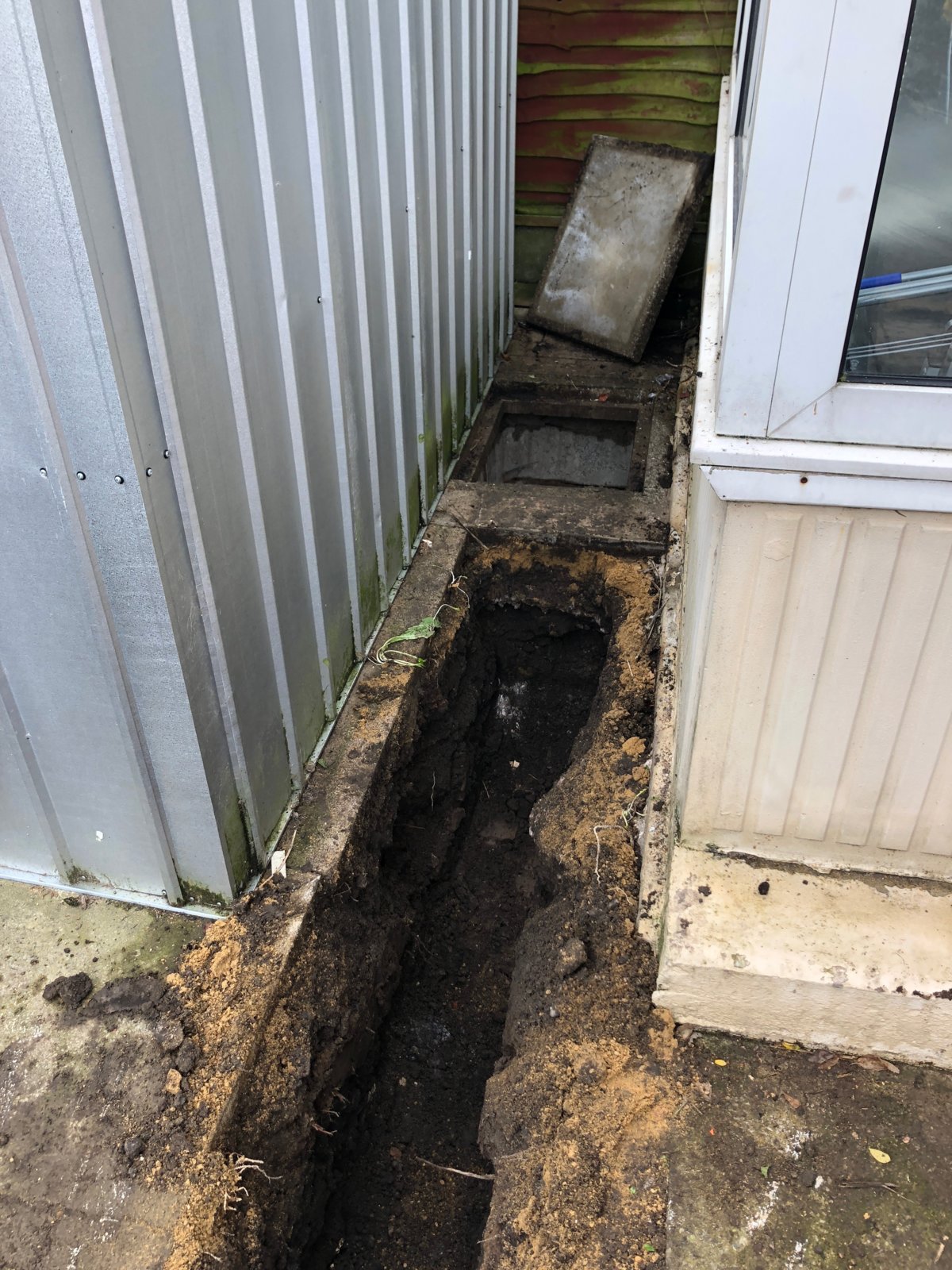

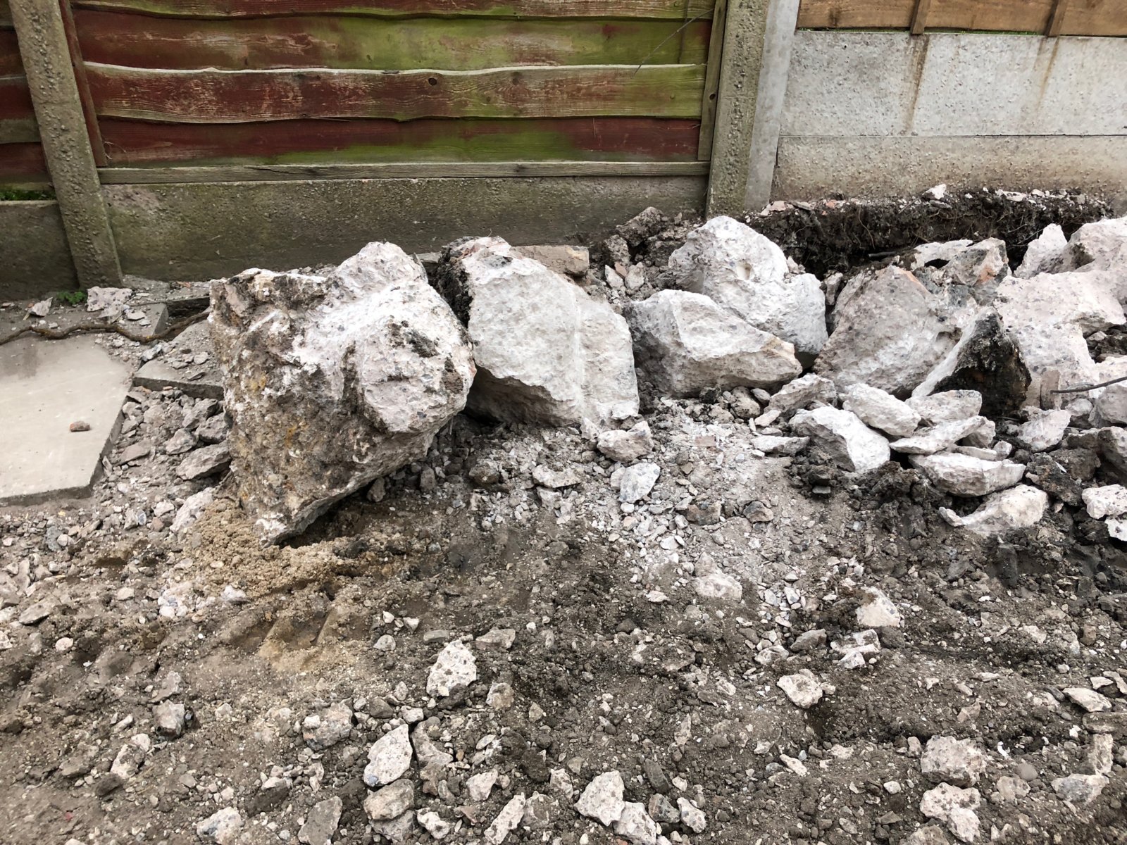

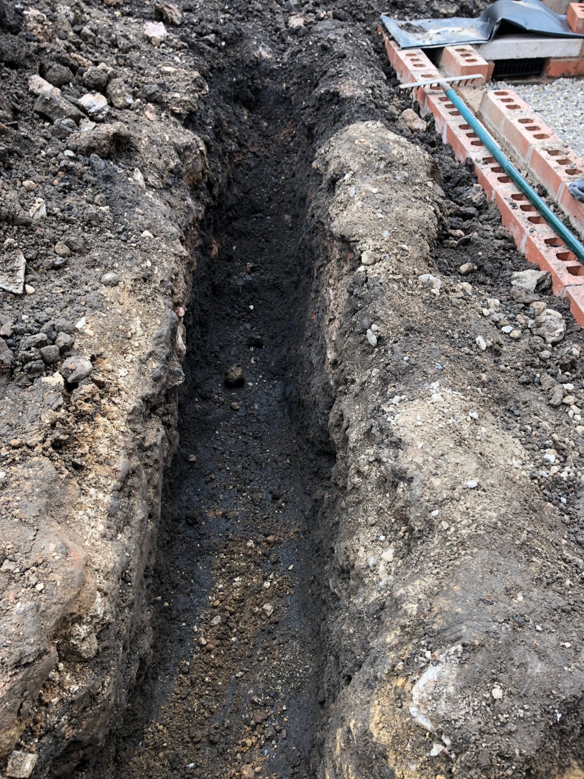

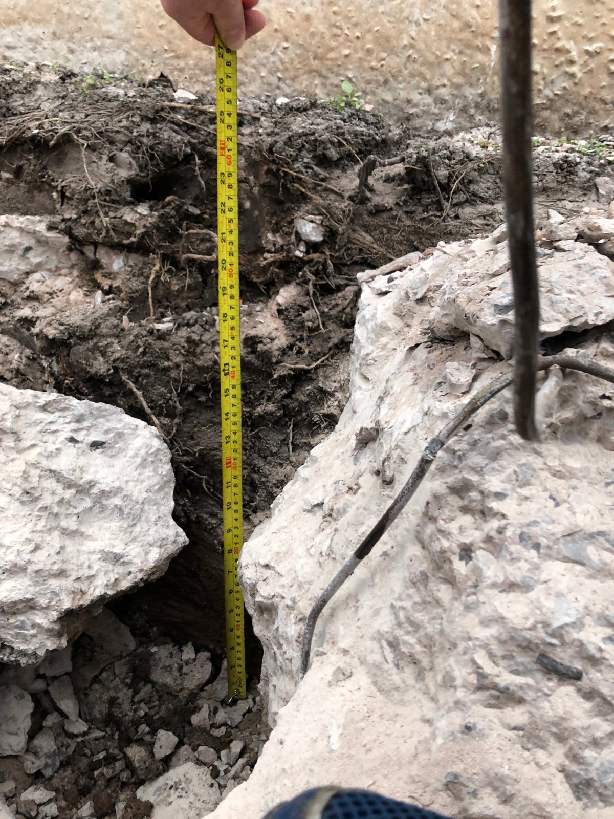

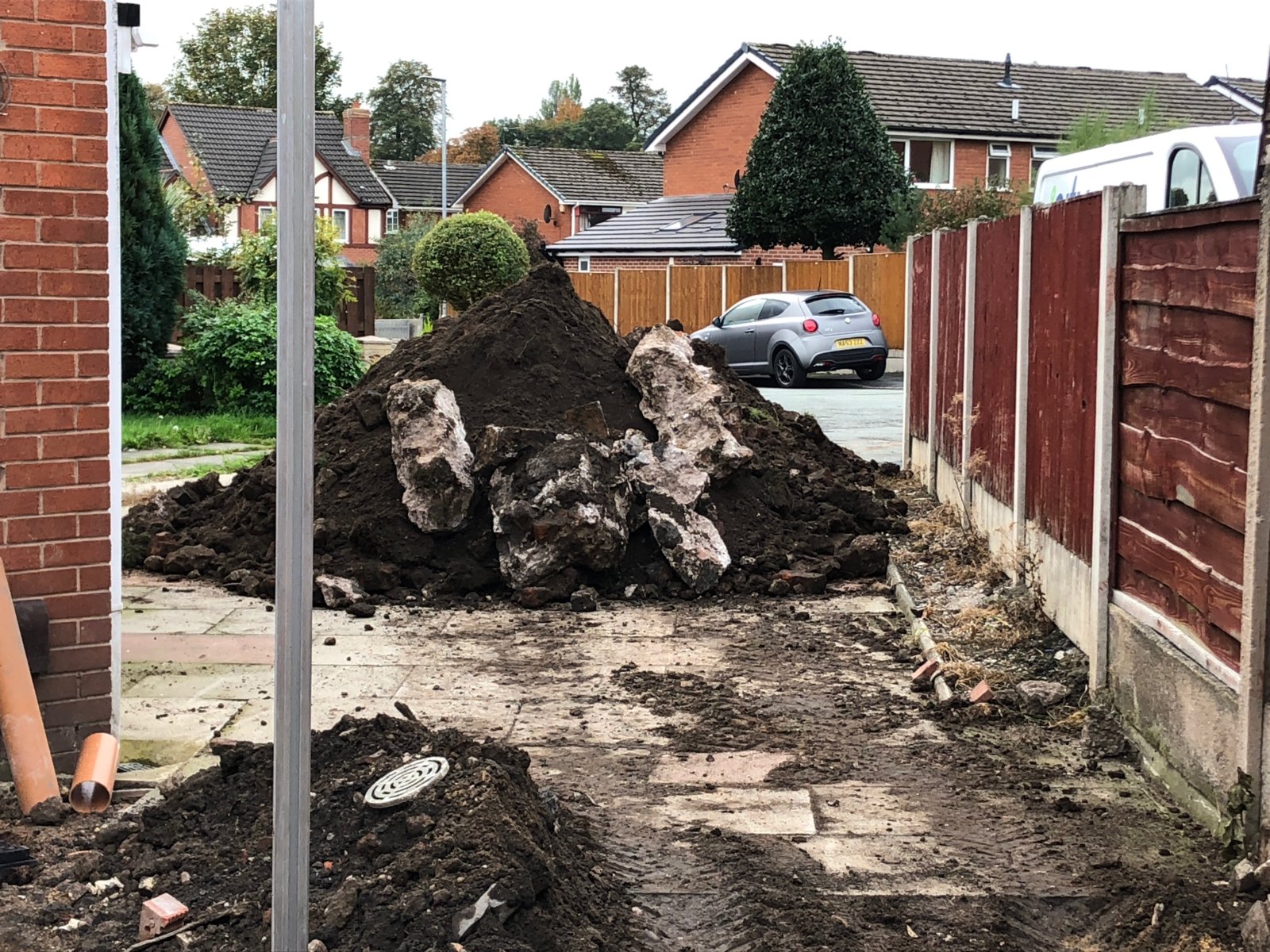

I started to dig some of my drainage channels although this ground is impossible! After battling with this trench for three days with a mattock I decided the rest would be dug by the guy with a digger!
Trench to the foul drain, just need to core drill through that concrete at invert level now! ;)

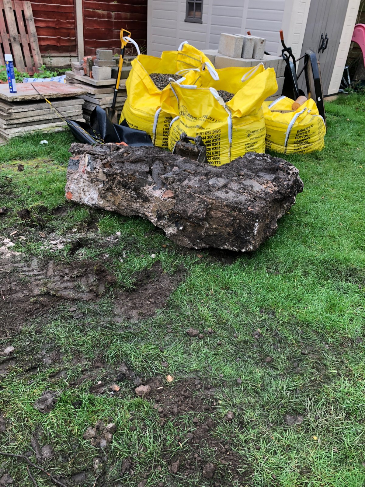

More ground out, size of some of them pebbles! :LOL:
Digger guy pulled this beauty out of the ground, he said "nearly broke my bucket"! :eek:

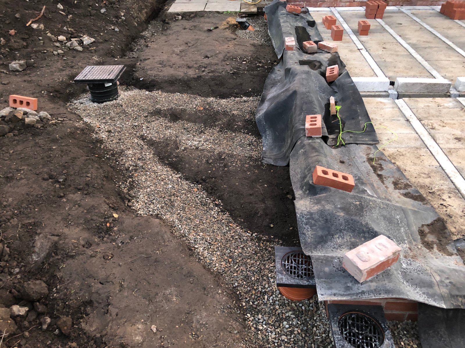

Core drilling through the manhole!

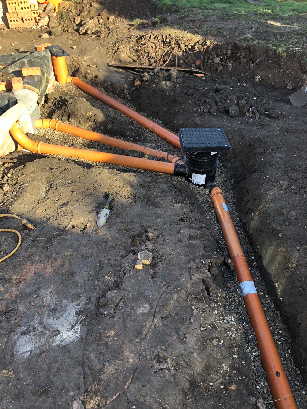

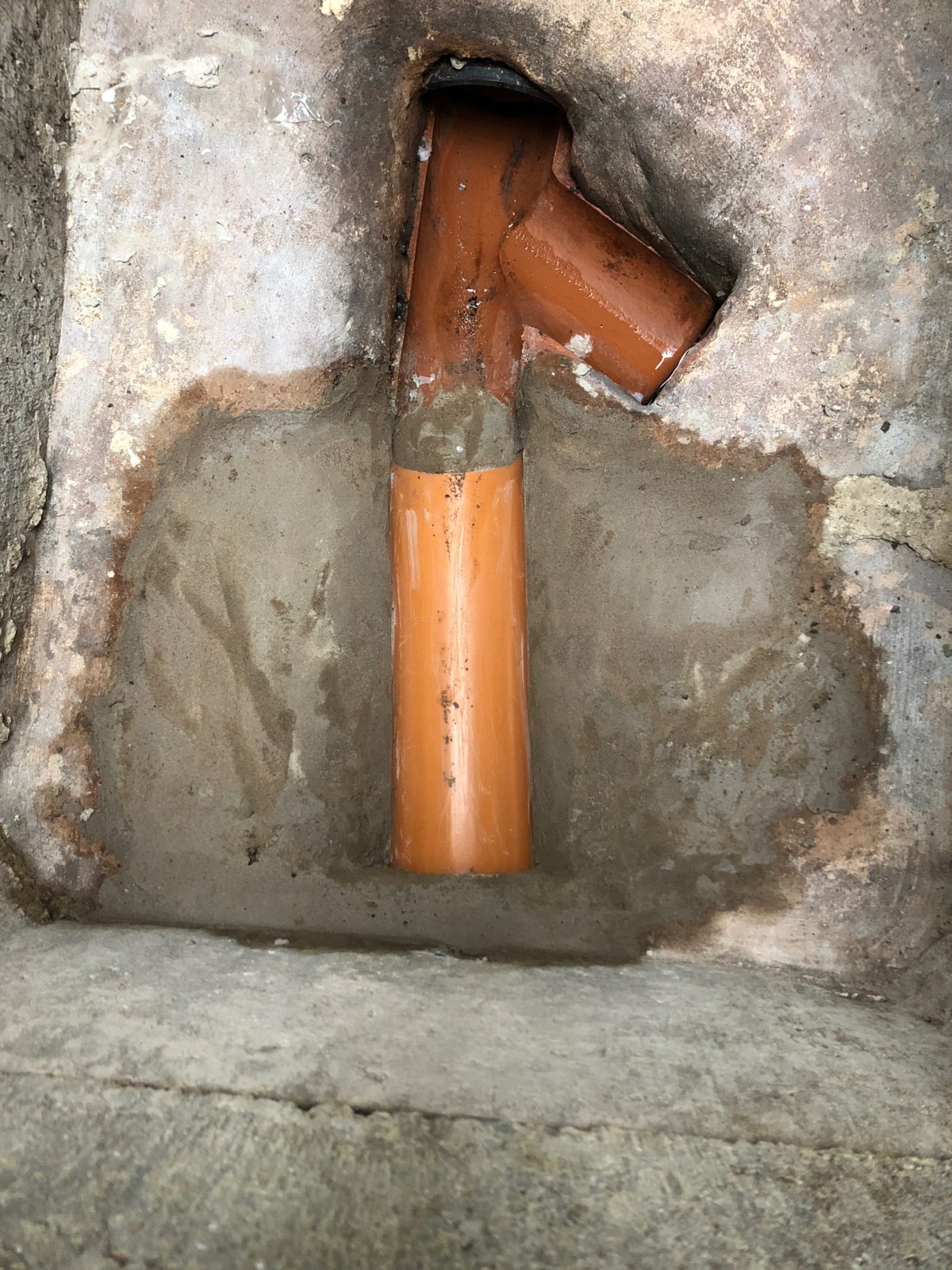

Installing the inspection chamber and the foul drain runs for the kitchen waste, ensuite and utility room.
Rain water drain run.
Foul drain through the manhole at invert level, concreted around.
Drains inspected and back filled.
Slowly getting to DPC level. Block and beam done, drainage installed and approved. Starting to resemble a building. (y)

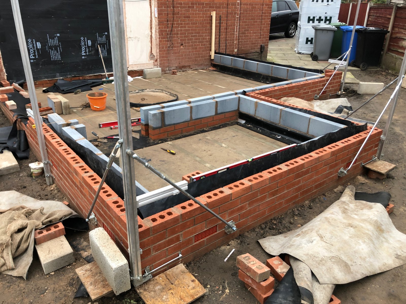

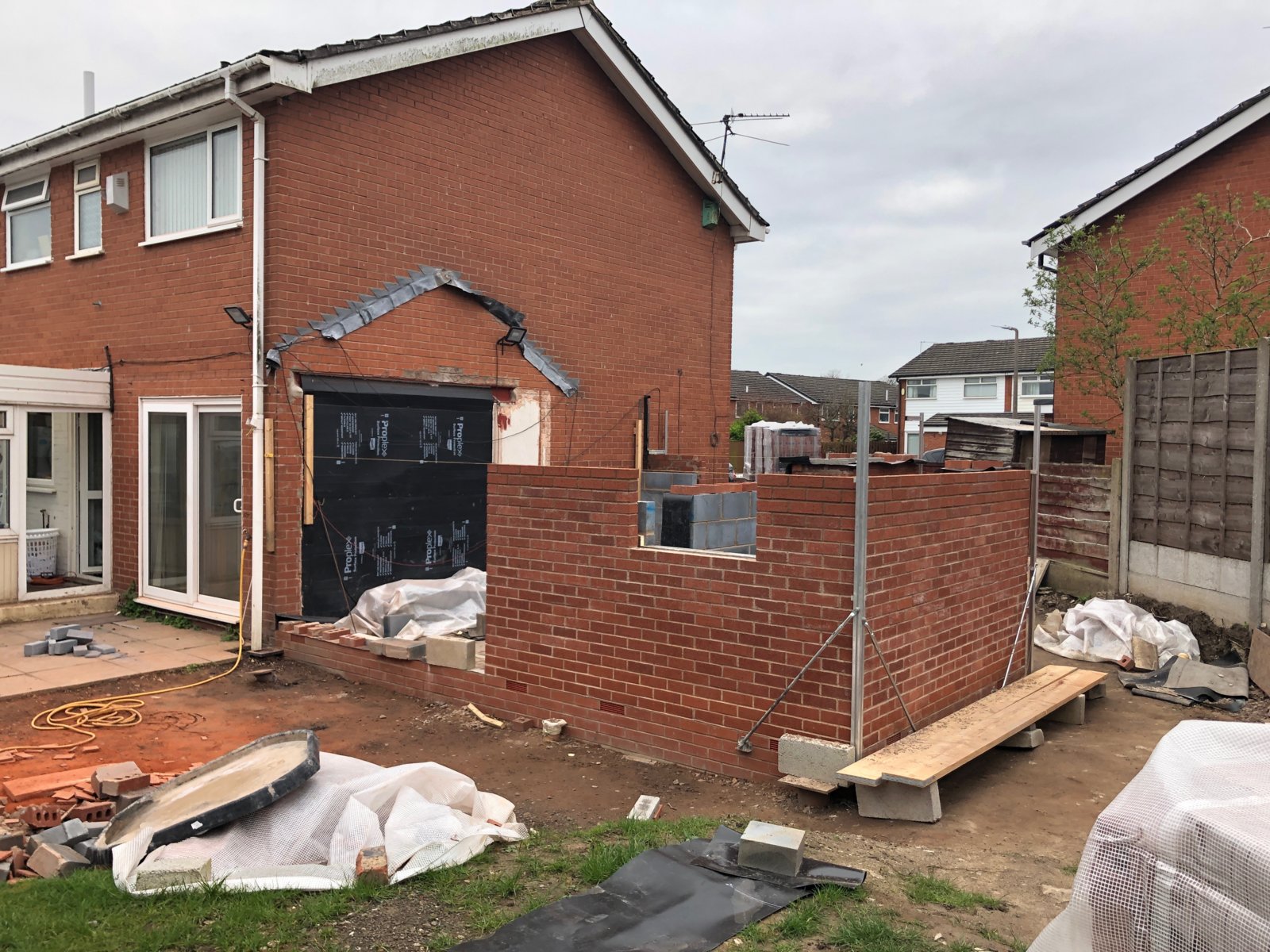

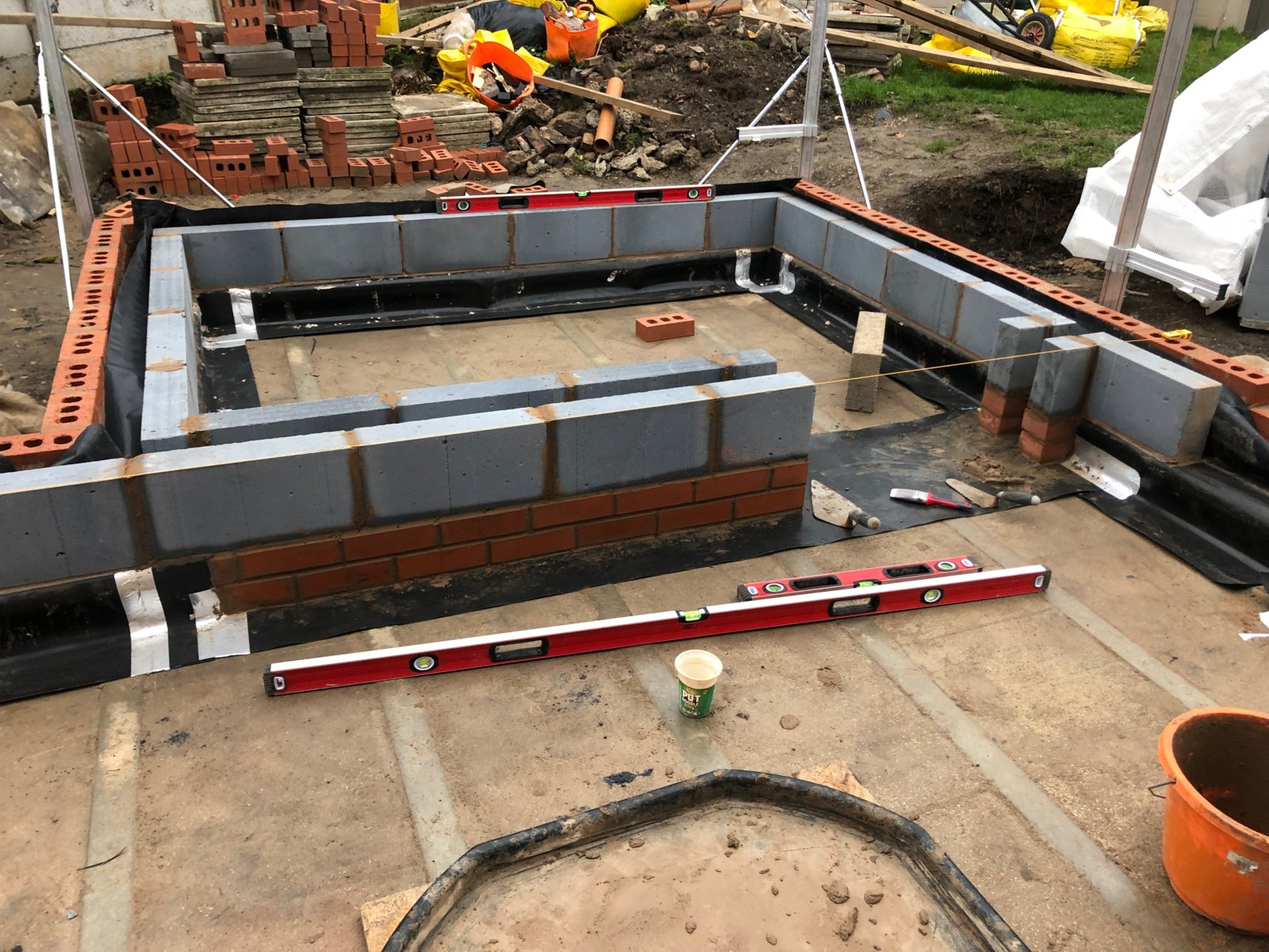

Installing the gas DPC and starting the Block work
Building control happy up to DPC so I started the block work early Jan 2019 (might even have been 1st Jan!)
First to do was grouting the block and beam floor with a wet slurry mix as per the block and beam suppliers spec. Trusty £50 cement mixer still going!

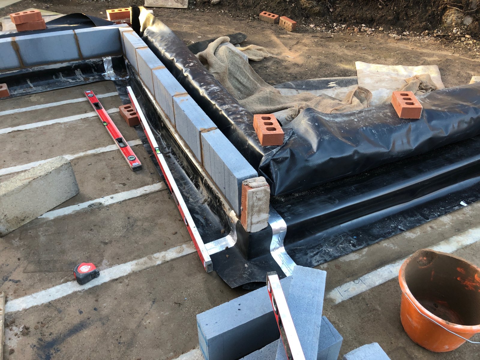

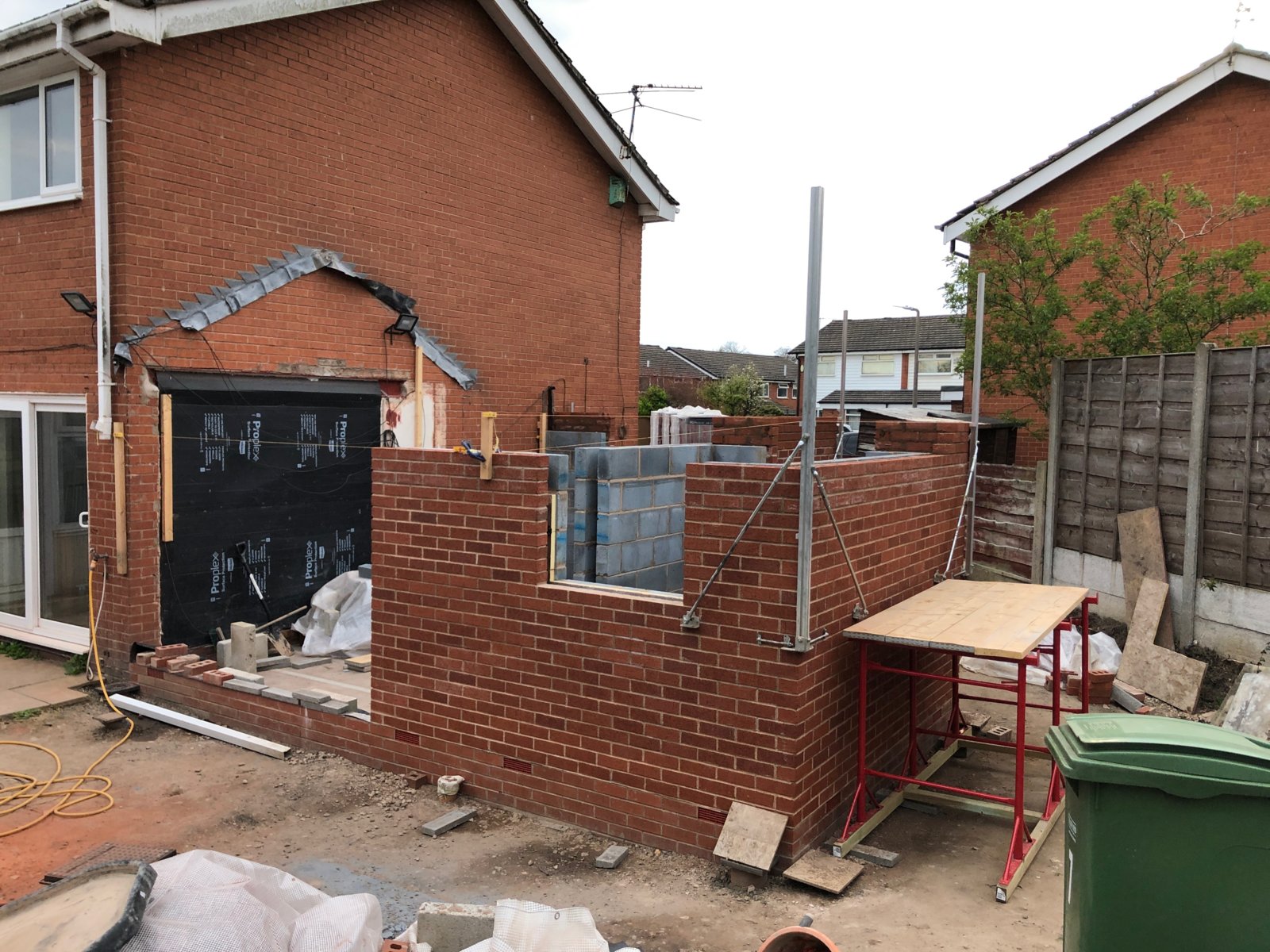

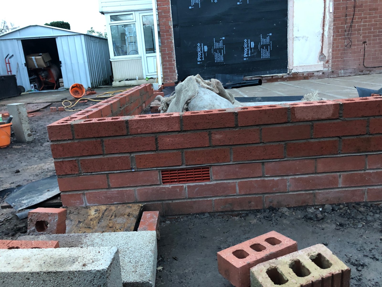

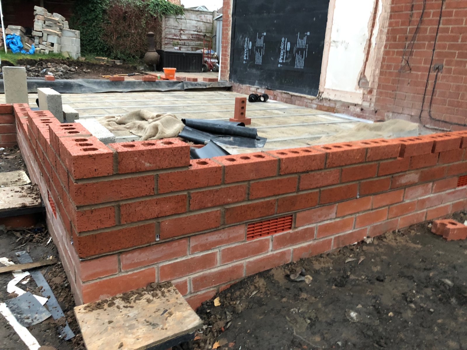

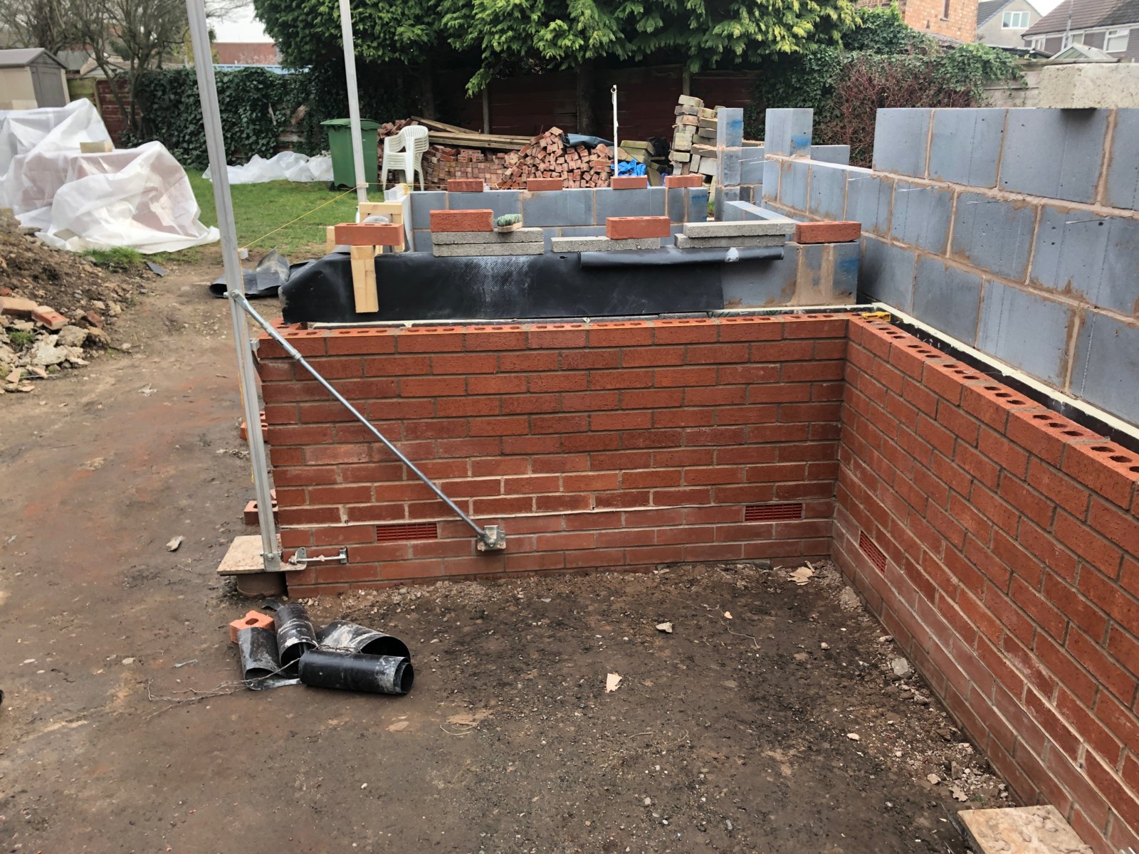

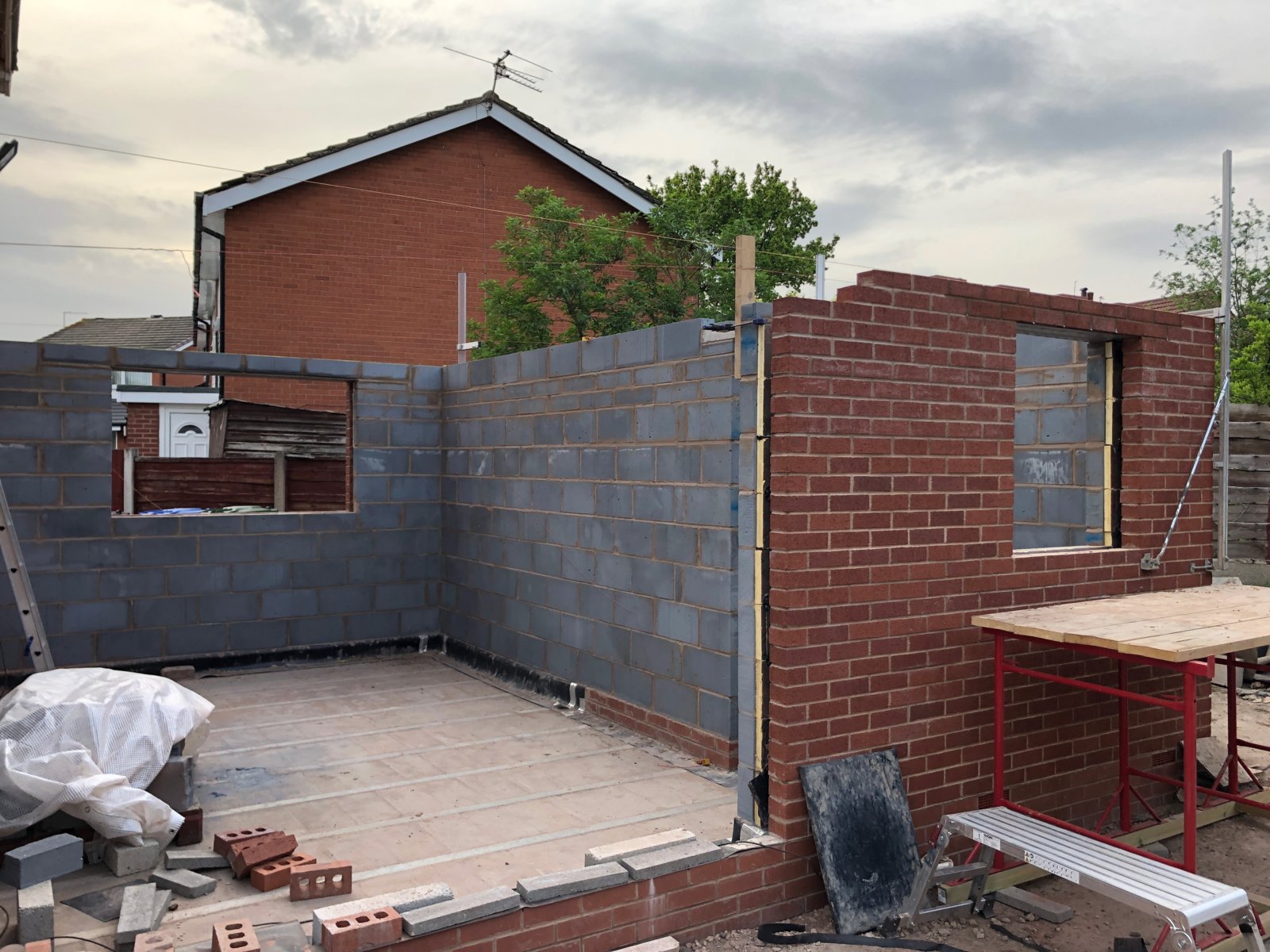

Started some of the external brickwork, including the weep vents at DPC level as I needed a cavity tray due to the gas DPC spanning the width of the cavity.

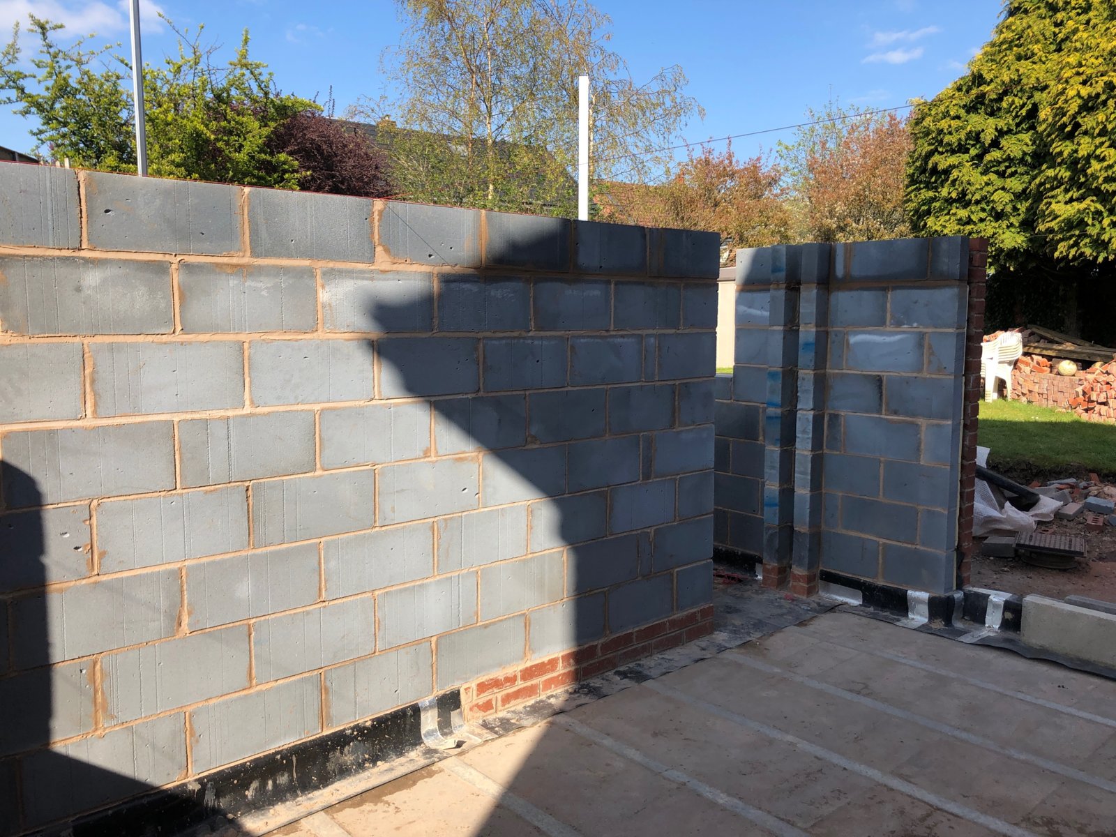

Struggled with the brick bond since the brickwork started. Learnt a big lesson here from a designer perspective; size the building to match the brickwork measurements! :mad: The facing bricks are longer than the engineering ones too, so that has caused me issues, not to mention some of the facing bricks can be a few mm different to each other.

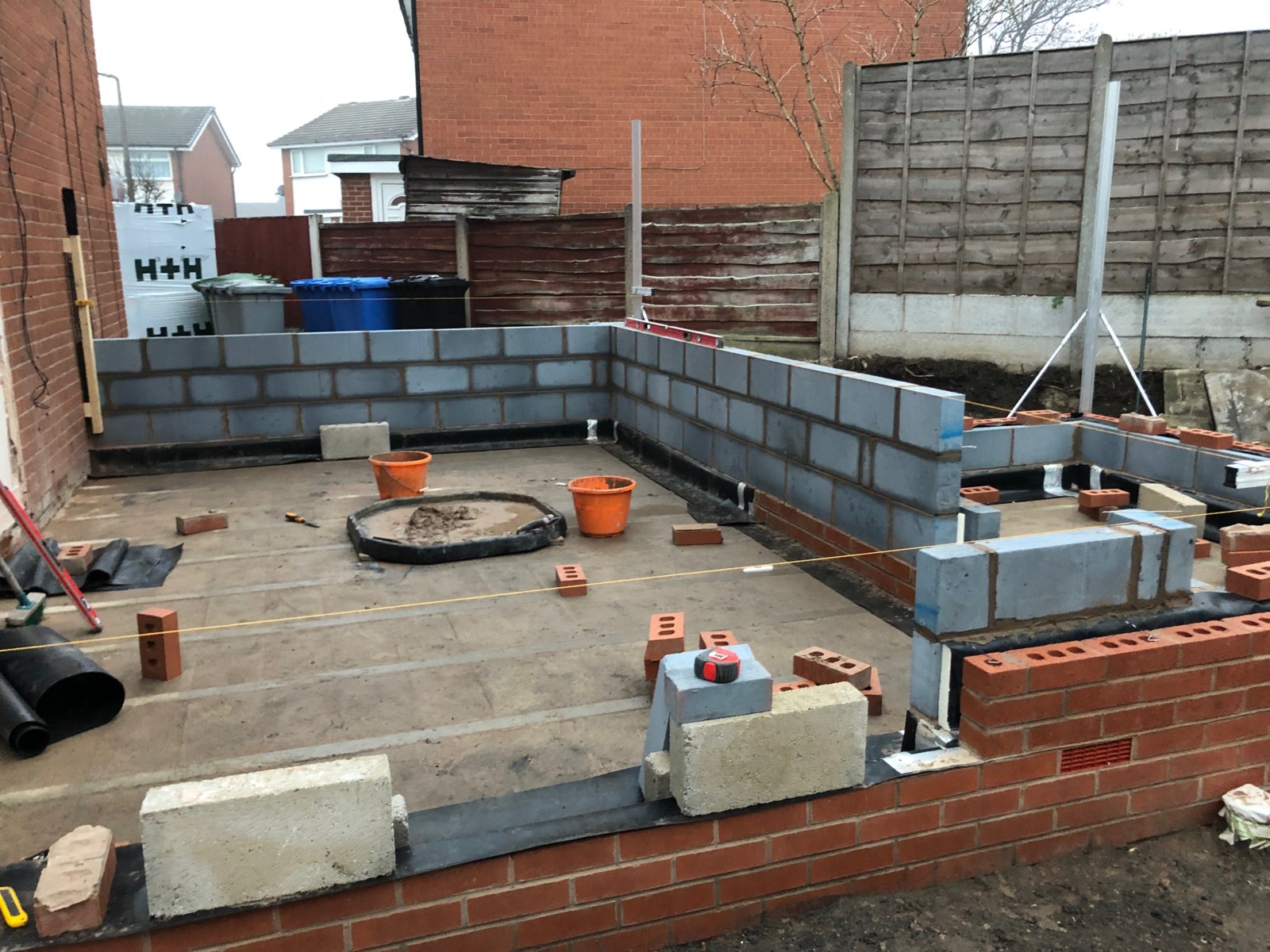

Gas DPC going in, corner cloaks taped. I'll tape the gas DPM to the DPC when the roof is on.

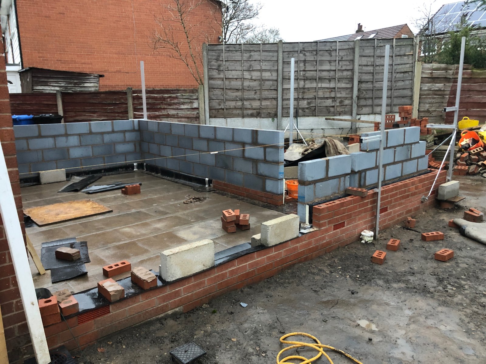

We have baby walls! :D

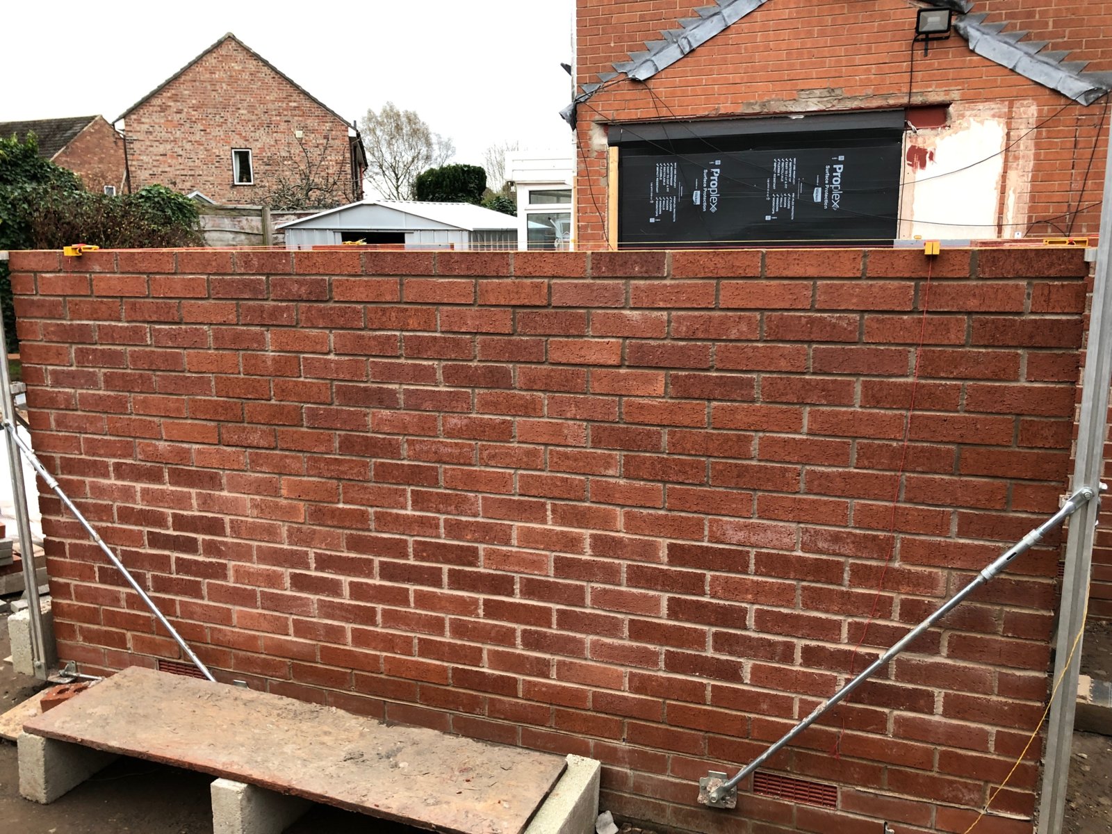

Brickwork coming along
The brick and block work is higher now. Not 100% happy with the bonding but hey ho!

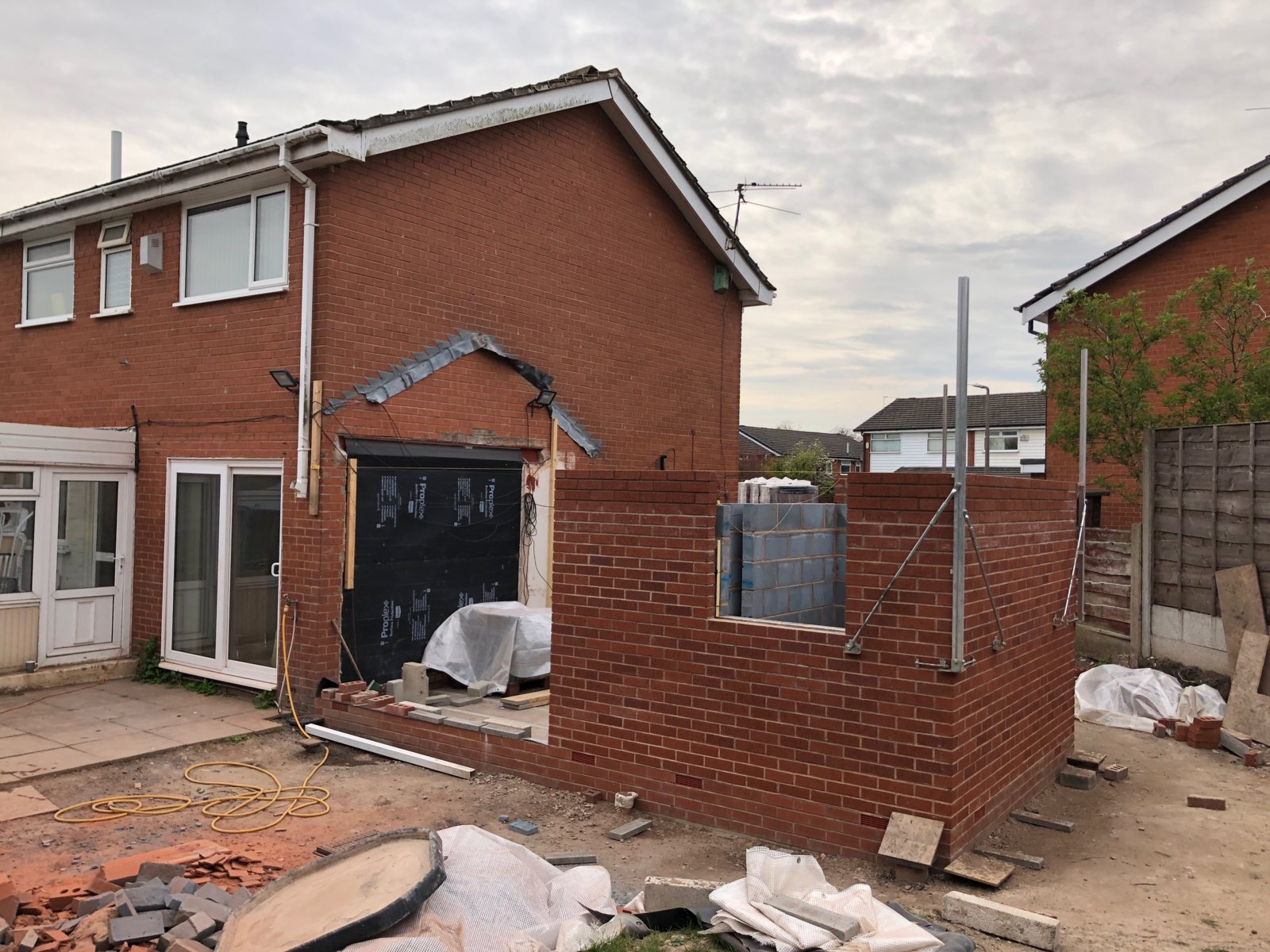

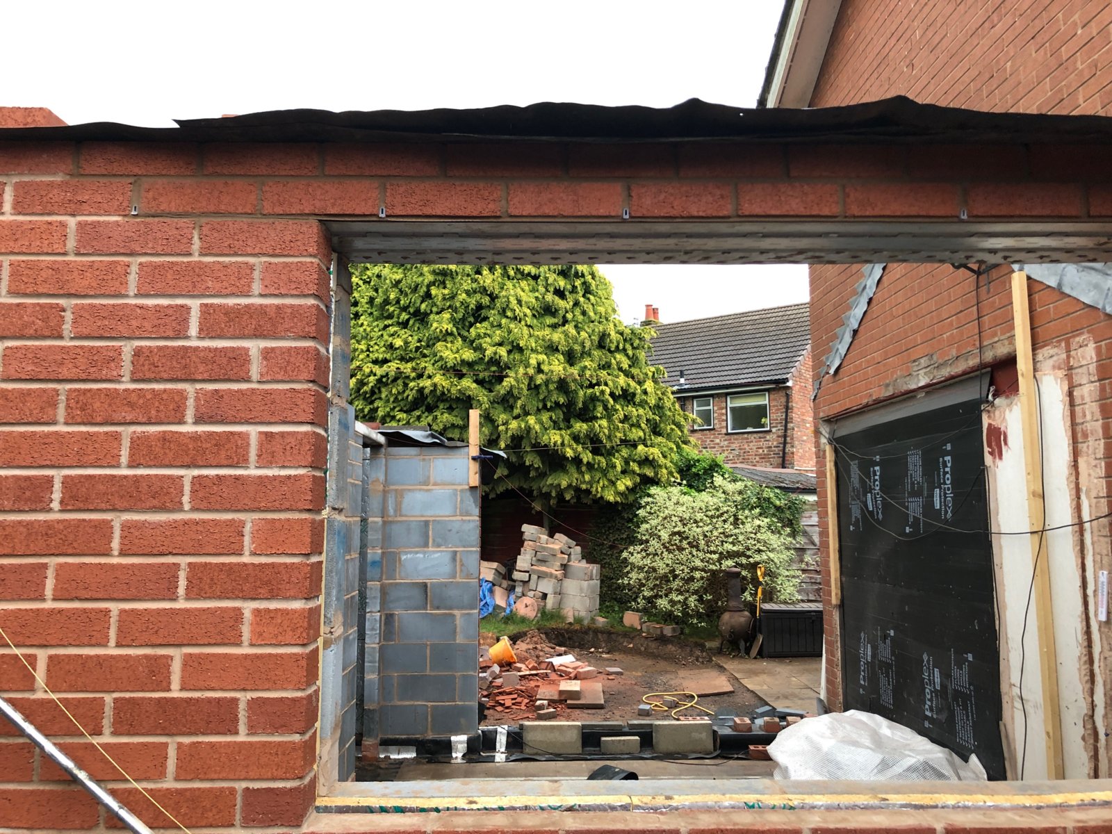

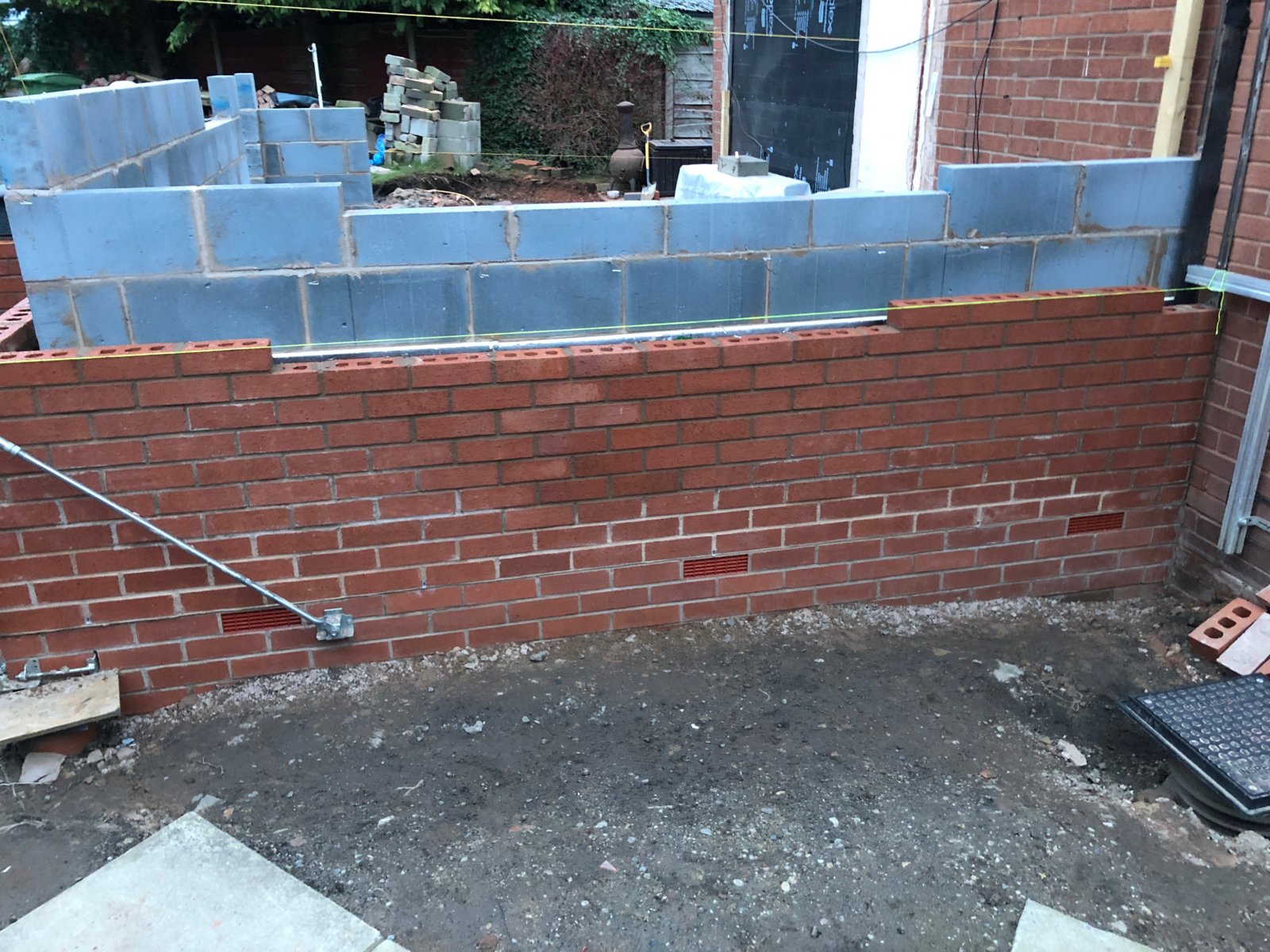

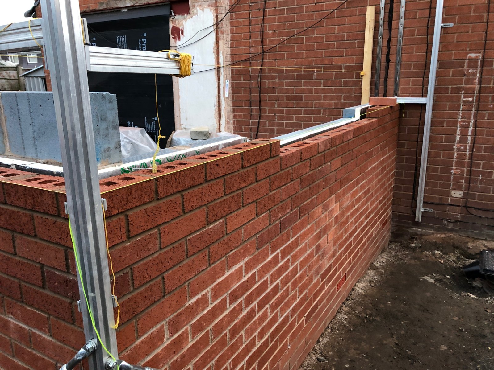

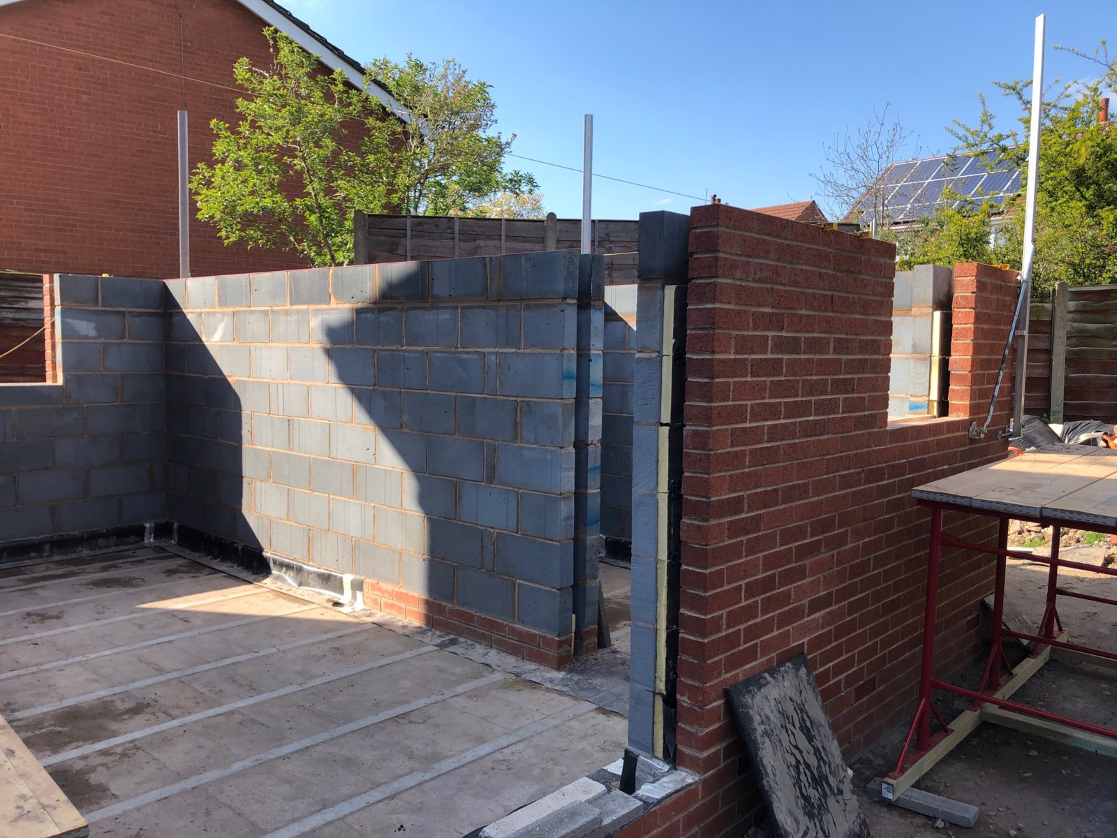

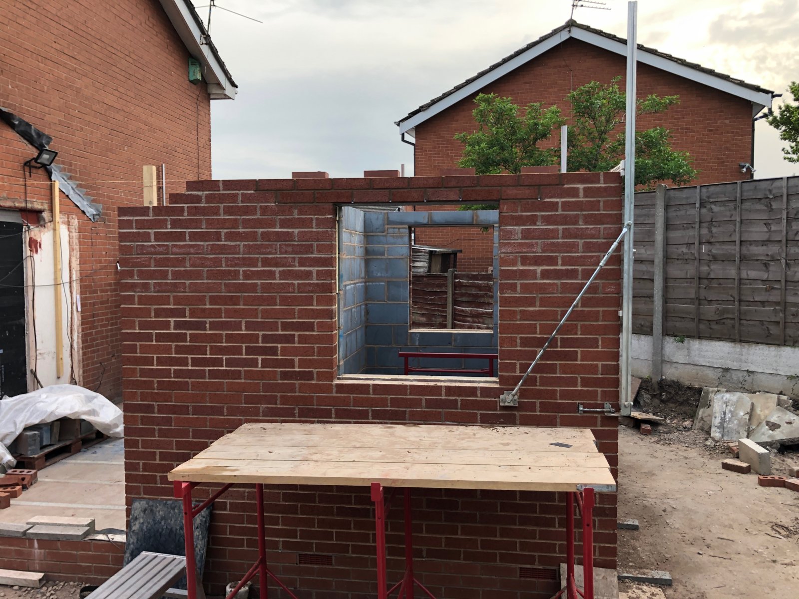

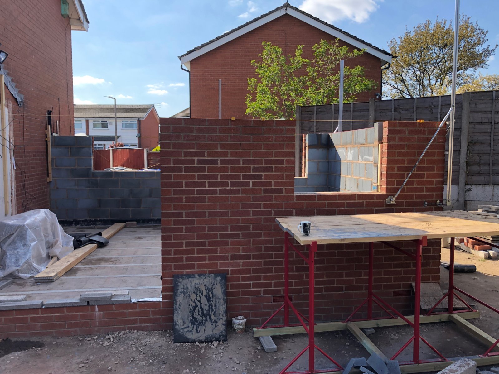

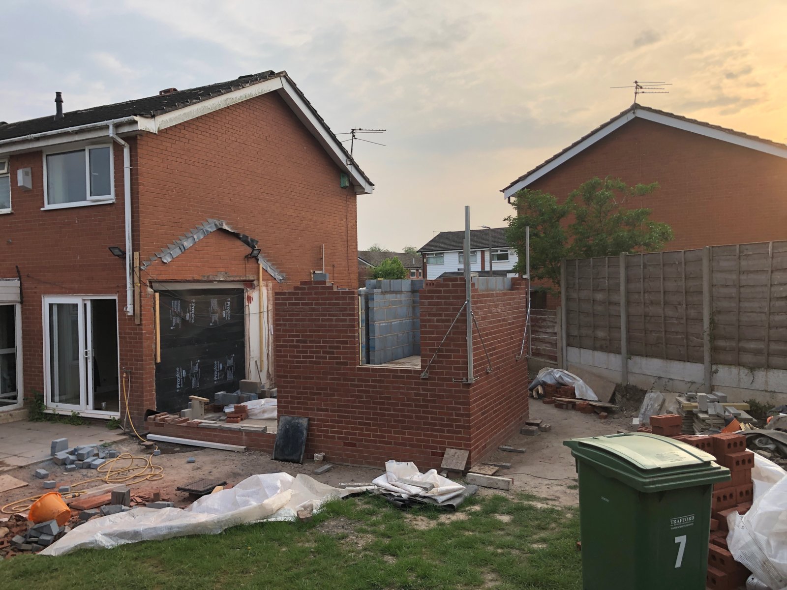

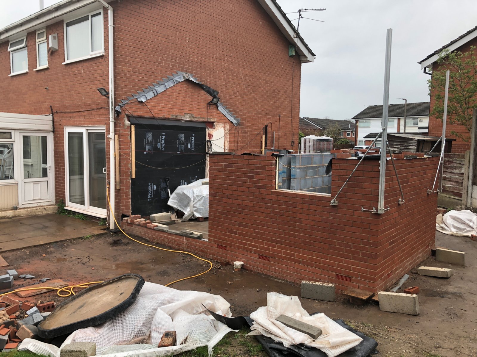

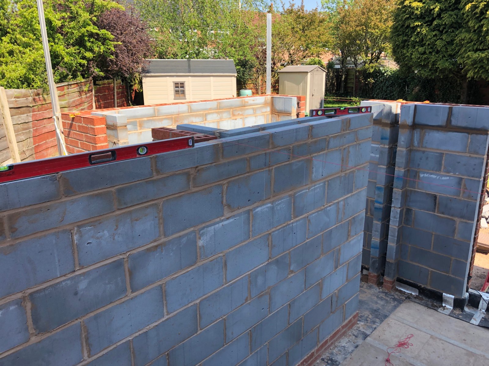

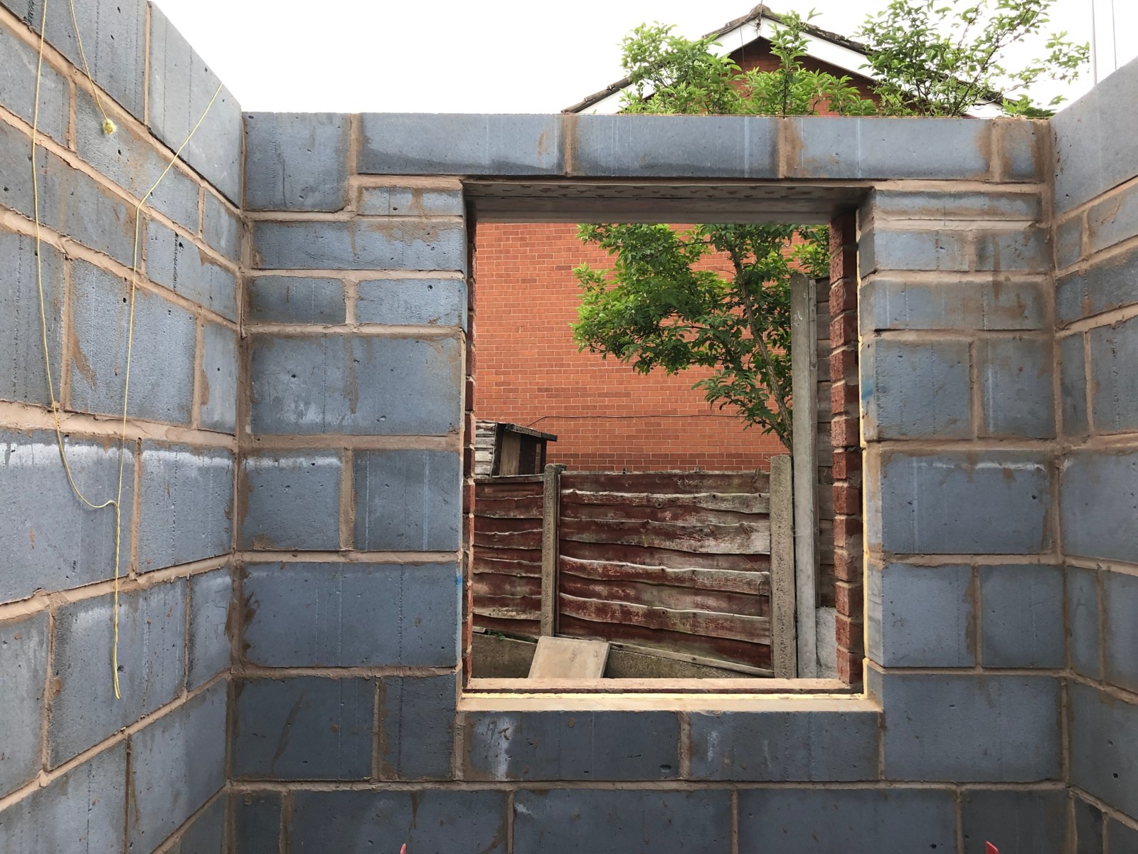

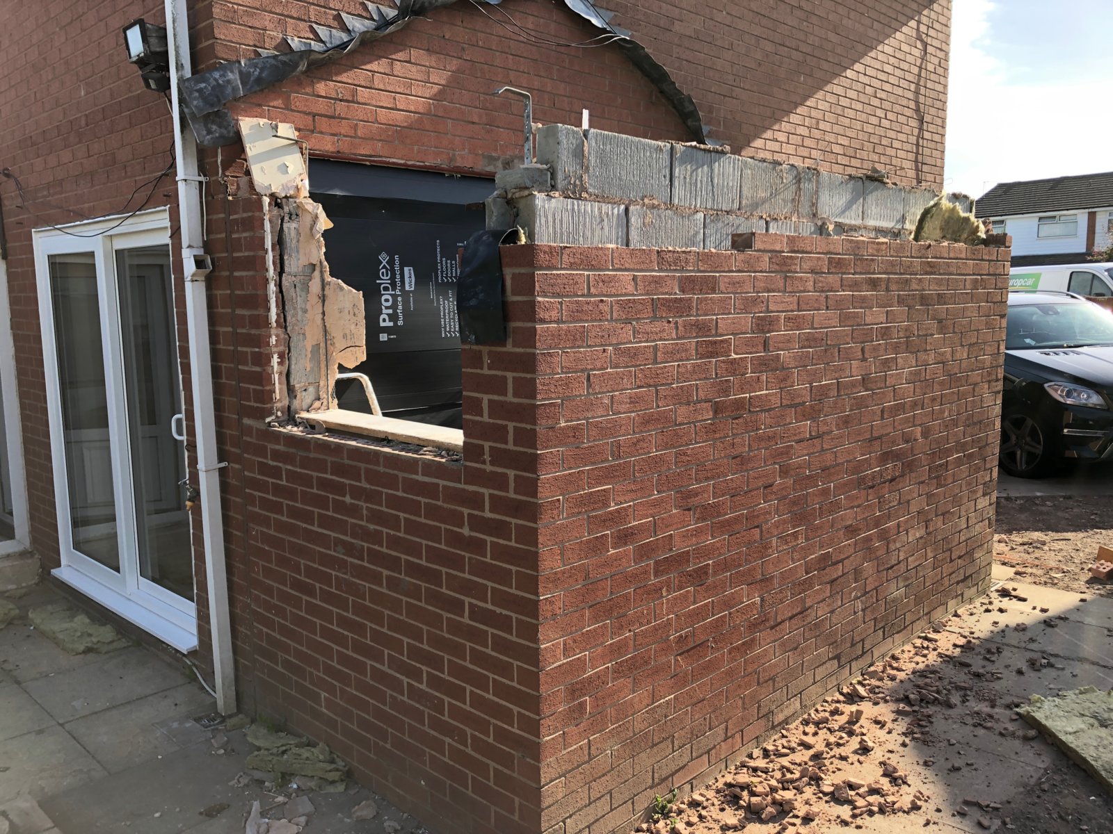

Brickwork to Window Lintel Height
So this is pretty much up to end of April 2019. I have the brick an block work up to window lintel height. The lintels are installed, cavity trays and weep vents fitted with them.
