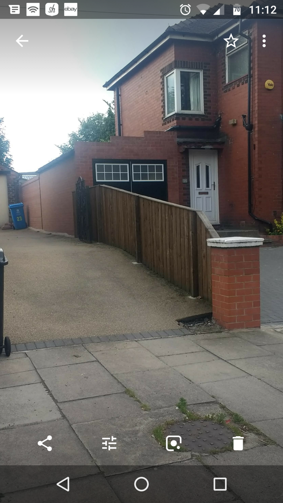

I know people laugh at them but try a "Brickie" tool. Having never laid a brick in my life I built the gate post, garage and 5m wall beyond the garage last year:
I will be building my large rear extension next. My dad is a retired bricklayer, said the silly plastic thing was a waste of time and initially offered to teach me how to do it properly but when he saw how (relatively) quickly I could get the bricks down with it he begrudgingly admitted that it would take weeks if not months to reach a similar standard the traditional way. I didn't use a line, just a level and a long straight edge. You need to keep a close eye on the your horizontal levels and keep it plumbed as it goes up. You need to manage your perps as the tool applies a uniform thickness of mortar which sometimes isn't enough if you have a slightly shorter brick.
In terms of time, if you think about it, a good part of your "bricklaying" time is spent mixing, laying out your bricks, setting up your mortar board/bucket (I worked out of a flexi bucket with a bucket trowel), cleaning your tools and jointing up etc and a Pro can't do this a great deal quicker than you.

I've never used the Brickie tool, so I can't really comment on it's use, but the brickwork looks OK as far as I can see in the photo.
However it does look like you have got a split course at the top of the door jambs. Was that because it's difficult to adjust the bed joints with the Brickie tool?
