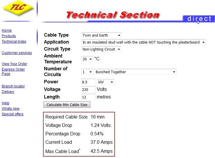

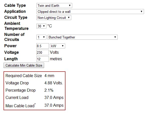

You can go to the site and change the values if you want to at https://www.tlc-direct.co.uk/Technical/Charts/VoltageDrop.html
where did the insulated stud wall and the 8.5kW at 230v come from?
The route the cable takes, whether it is buried, exposed or clipped makes all the difference.
Probably because he doesn't know what he is talking about, or maybe he wants to make some money doing unnecessary work.
Do you ? ... <TLC cable calculator screenshot
For some reason, you have selected the worst conceivable installation method ('buried in thermal insulation'), whereas the OP has indicated an installation method which sounds like Method C ('clipped direct'). If one feeds that into the TLC calculator, one gets a much more sensible answer (and that's assuming that it really is 8.5kW at 230V, which I doubt)! ...

Winston made a statement without mentioning / considering the method of installation. Maybe the cable is clipped direct to a wall and doesn't have any section of it laying horizontally across a ceiling in which case 4 mm² might be OK But dropping almost 5 volts at 37 amps is 180 watts about 2 % of the power measured by the meter and thus paid for is being wasted in heating the cable..
