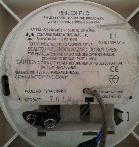

I need to replace the fire alarm in a 2 bed flat. The alarm is in the hallway to the door. It is the only alarm in the property. The existing alarm is mains powered with rechargeable 9v NiCad. It has 3 wires: brown, blue and white. The brown is connected using a connector block to a red wire in the ceiling. The blue wire is connected to a black (I think) wire in the ceiling the white is not connected. Do I need to replace the alarm with a mains powered one, or can I use a battery powered instead? Will any mains powered alarm work with the two ceiling wires?

Seems stand alone. The alarm is powered by the circuit for lights. If the lights switch on the consumer unit is turned off, the alarm would have no mains power.
sounds like a stand alone unit if there is no connection to the interlink wire …..as allways photos will help
I will get the model number once I am at the property. It is more than 20 years old. I don't think interlink was invented then.

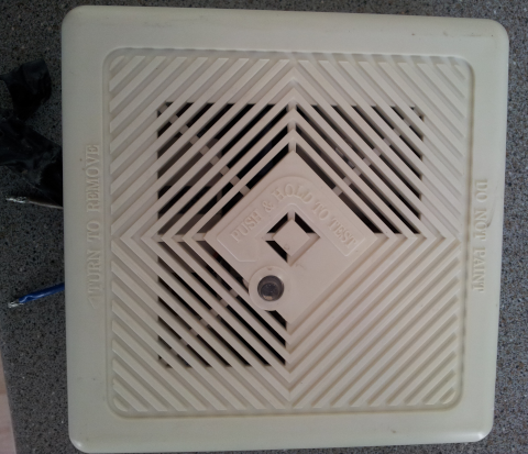

Here's the alarm. It will probably be fine with a new battery.
And it probably won’t ….just replace it with a new one …..or if you don’t value your life ….don’t
