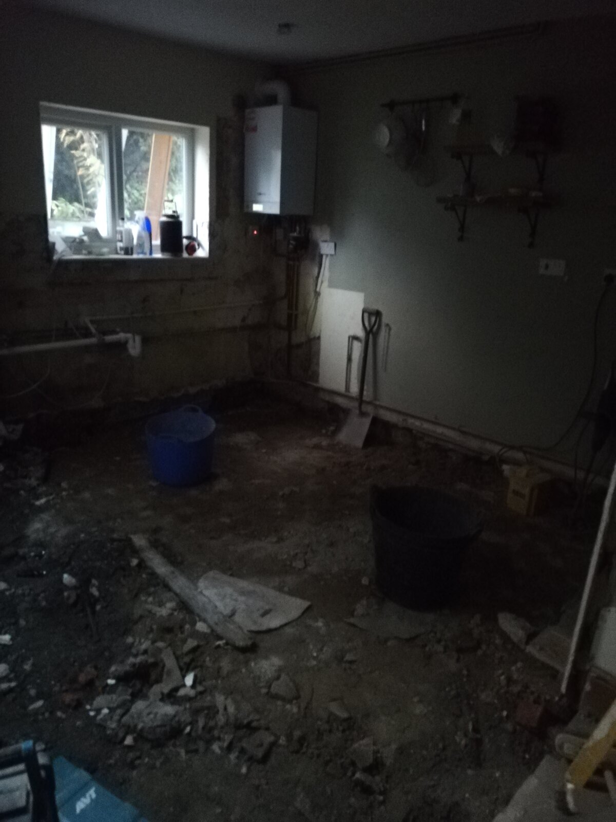

Hi!
We were quoted for a floor to be smashed up and replaced with a new floor. The estimate described there being a sub base, sand then DPC, insulation and 65mm fibre screed.
We were away the day it was prepped for the screeder, but when we had a peek under the dpc just before the screeder arrived, we noticed it was just the soil that had been there under the original concrete.
When we questioned the builder has said that there was no need for a subbase or sand as he used a 1600 DPM, but we were wondering if:
a) will this be enough to provide structural support to a kitchen floor? We will have a 90cm range cooker, cupboards full of stuff, table and chairs, dishwasher, washing machine (which will likely move around) and the area is about 5m by 3m.
b) this meets BC
He is chasing for the full amount but I want to check this before we pay. At the end of the day, we don't mind if it's structurally sound, watertight and meets regulations.
Cheers!
You are talking about a solid concrete floor which has to be on load bearing stable ground.
It needs: 100mm or more of well compacted type 1 MOT, sufficient sand to blind, DPM, insulation, screed.
you cant make a load bearing concrete floor straight onto soil -I'm sorry but your base is no good

Photo shows the floor before they put the dpm down. They may have dug down more as I was away the next day, but I know they didn't put any new subbase or sand.

That alone indicates that the builder is clueless and trying to blag you. A DPM (polyphene!) has nothing to do with the strength of a floor now will it stop a floor sinking if the sub-base is inadequate.
And the cluelessness is confirmed if he said that you should expect settlement.
TBH, I would have doubts that you can trust what he did or trust him in his comments about why he didn't do the sub-base. Digging and removing the spoil and then barrowing a load of stone back in is a lot of work. Did he reduce the bill by around 30% to reflect the work not done and materials not purchased?
You could either chance it, try and retain some money, involve a local surveyor/structural engineer to inspect the work and comment - see how the builder responds to that suggestion - he should welcome it.

No hardcore, no concrete sub base?
If that's what you've got, it is highly likely you will have future problems. If you tile over that, you risk wasting the cost of the tiles too.
Screed itself has little strength. The purpose of screed is the equivalent of plastering walls - it turns a rough uneven surface into a flat one. It is cosmetic not structural.
The odds area against it being ok.
As above, I don’t understand why the original quote didn’t include a concrete slab. And I understand even less why they’d then cut corners and not even put hardcore down. I can’t see Building control OKing it in a million years unfortunately
