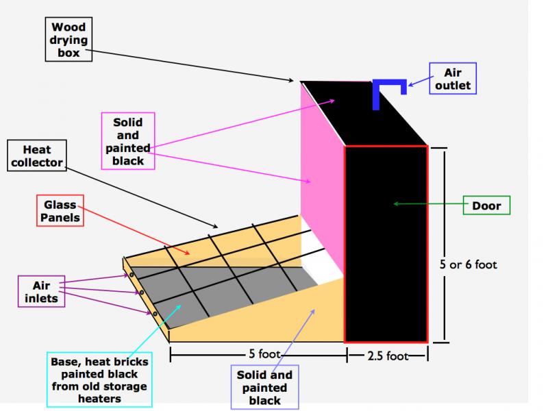

I'm building a solar powered wood drying kiln and would appreciate some input from members.
I have a wood burner to heat the downstairs of my house and also my wife does a bit of woodturning, so I'm always looking for free wood for both.
Both requires the wood to be dry hence the kiln
I was going to single glaze but I think it might be a better option to double glazing as it lets heat from the sun in but doesn't let it out so quickly
I've been given a pile of toughened, heat resistant glass and I don't know if it'll let the suns rays will get through as good as normal glass.....does anyone know the answer or have any comments.

The glass looks completely transparent. I was just a little concerned that it's heat resistant. The way I understand it, is the suns rays are different from heat, and the heat resistant element of the glass should keep the heat in, but, if I double glaze it, will the suns rays turn into heat between the two pieces of glass and then be stuck there.

Not really, no. It is true that double glazing is symmetrical for heat conduction, but solar heat is radiated not conducted. The coatings on modern glass can reduce radiated heat loss, but they are asymmetric i.e. only one side is coated.
It sounds like the glass in this case is toughened but does not have a coating.
The thermal properties of the many south facing conservatories demonstrate what will happen.

I got it from freecycle and the guy that gave it to me had light's fitted in his works, the lights ran very hot and the glass that went under the lights needed to be both toughened and heat resistant but, he didn't want the glass fitted. I understand that the toughened bit should be OK for the suns rays to go through but I don't know if the heat resistance will trap the heat between the pane's if I double glaze it

The box will have ventilation to allow the moisture to escape on the top and also ventilation to allow air into the box at the bottom at the front of the heat collector.

I've looked at lots of designs for this and I've come up with my own design taking the best bits that suit me, my first enquiry to this forum is about the glass I've got.
From the amount I've read on the internet the drying time can be reduced from 3 years down to 5 months, as for the wood twisting and warping I don't think my wood-burning fire would mind lol
Here are some of the designs I've come across http://www.builditsolar.com/Projects/WoodDrying/wood_kiln.htm

Back to the question of whether heat resistant glass would stop the suns rays getting through, discussing it here has made me think about it more and I think I know the answer, the suns radiated will go through both pieces of glass because they're rays.....not heat, Thanks endecotp
they are infra-red rays, which are a form of heat energy.
most of the heat that double-glazing saves is not radiated (infra-red) but conduction of warm air touching the glass.
the objects inside your room will be far cooler than the surface of the sun, so they will emit very little heat as radiating infra-red.
