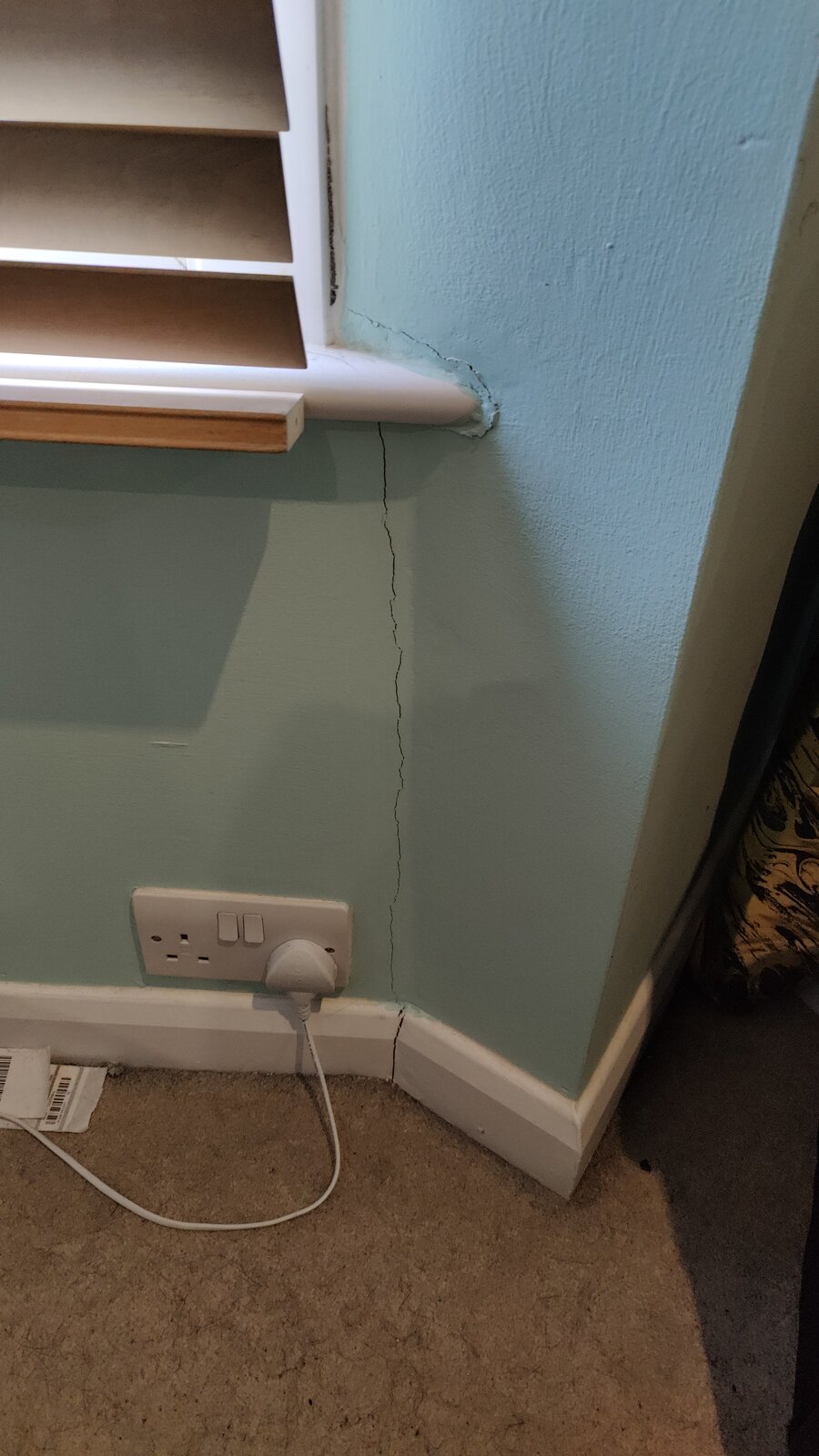

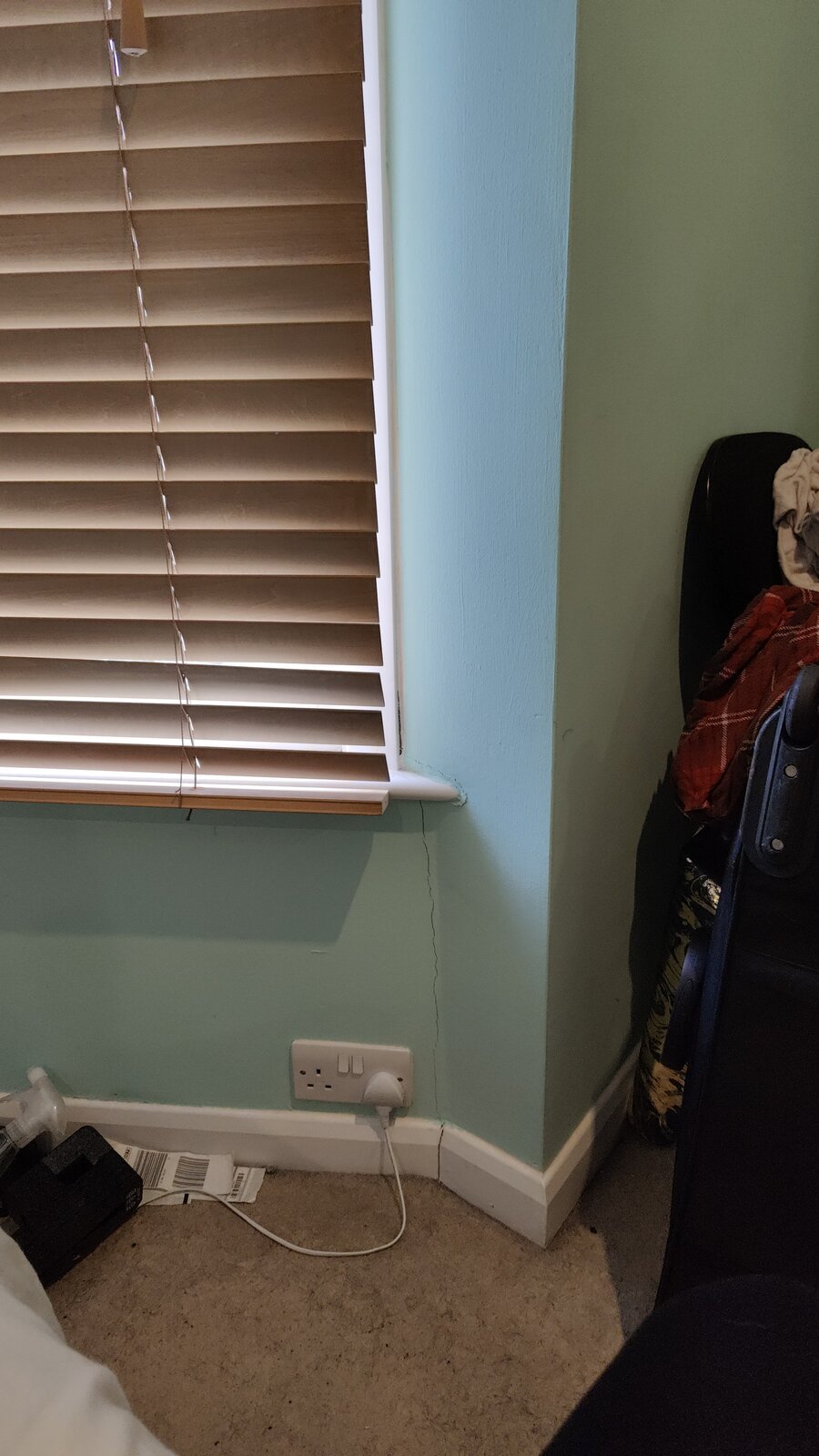

Hey, noticed this appear recently wondered if it looks abit dodge?

Its a common place for vertical cracking.
Can you show better focused pics of the outside of the bay?
Any disruption to the floor?
Has any building work been done recently?

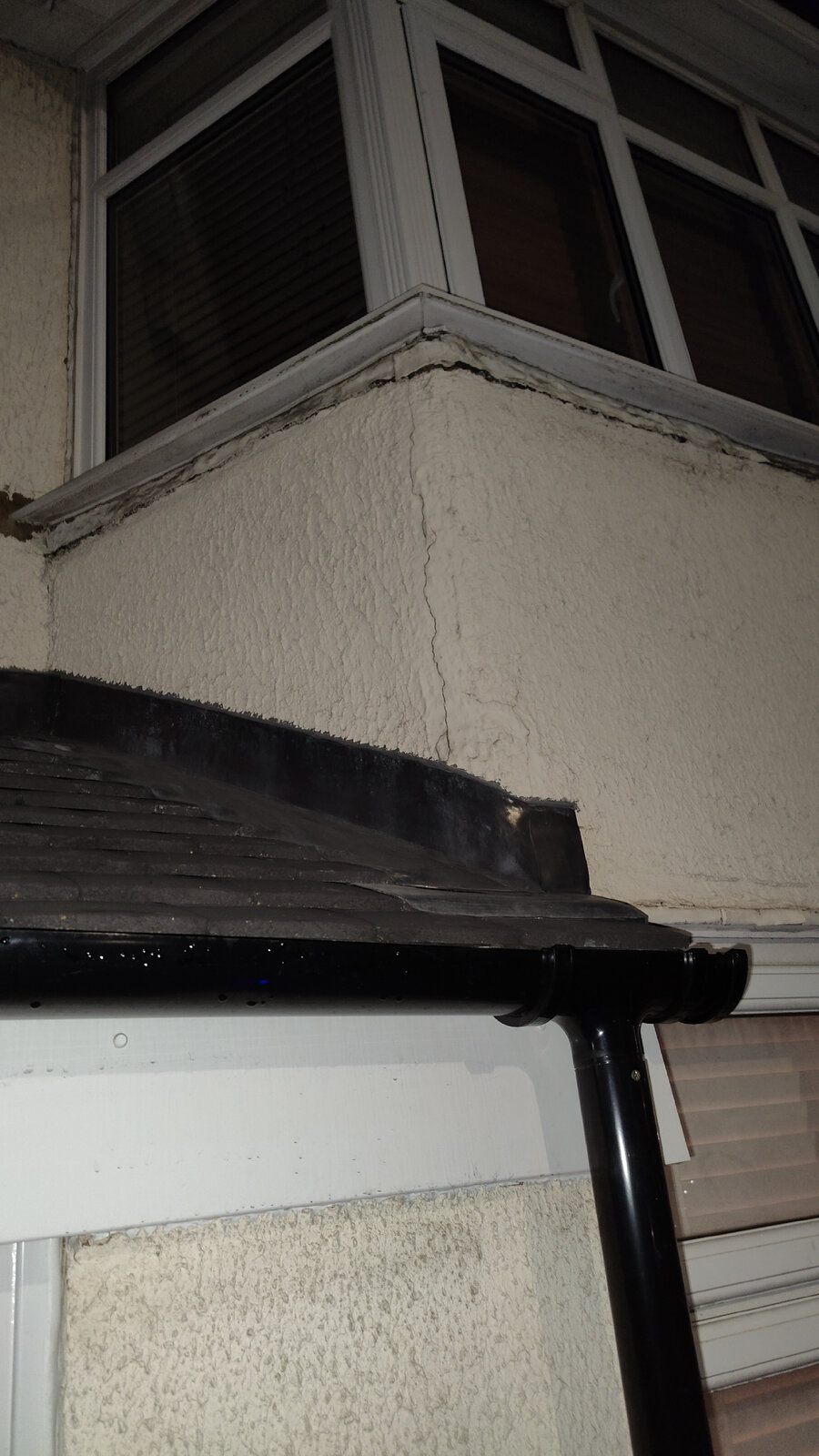

I've had a look and there is an obvious crack on the outside. Not sure if it's in the exact location as the inside, but I'm pretty sure that's been there since we moved in just hadn't put 2 and 2 together.

The exterior crack on the outside corner is in a different position to the interior crack.
Does that side wall of the bay drop down to ground level or is it supported below?
Is there a lintel above the ground floor bay window?

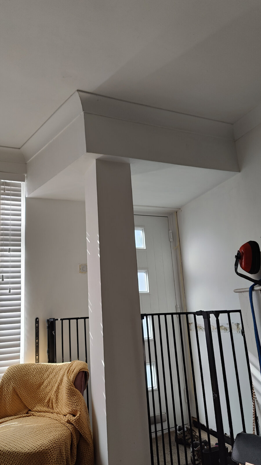

Yes there no cracks and looks good. See attached.
Can't really answer the questions fully as I just don't know :( so sorry about that.
The cube like form on the roof, is external to the original floor plan of the house, there would have been a wall and door into the lounge originally.

That’s nothing to worry about. There is always cracking in that place in bay windows of old houses. The foundations weren‘t built to the same standard as the rest of the house so you get differential movement,
Cheers, ill keep an eye on it hopefully it's old movement and has settled. Back to putting on the skirting boards :( haha.
