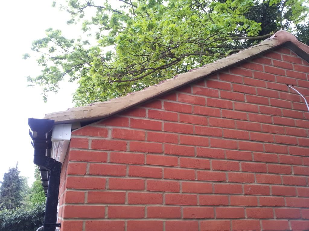

I had this outbuilding made recently. It is double pitched with a tiled roof.
When I look at the slope from the side I notice that as the tiles come close to the eaves the slope angle decreases. Will this cause a problem? Thanks for your help

The roof detail is fine. The only thing I would say is to point up the "triangle " shaped gap to prevent insects getting in and nesting.
Thanks LL and CB.
Is the triangle shaped gap best pointed or having some sort of grill/mest on it?
Thanks again
I have a roof detail like that on my bungalow - done c.1982. Have just had to renew the bottom 3 feet of roofing underlay felt - replaced with eaves felt - because there had been a bit of water ingress on the shallow pitched bit and the felt was the old fashioned hessian backed slaters felt , which perished - So although I wouldn`t want that detail like yours , with modern membrane /felt you`ll still get a good 30 years + out of it ;)

I have always assumed the change of slope is in order to slow the flow of water so it doesn't rush off the roof, missing the gutter in the process. Many roofs have that detail, at least where we are.
