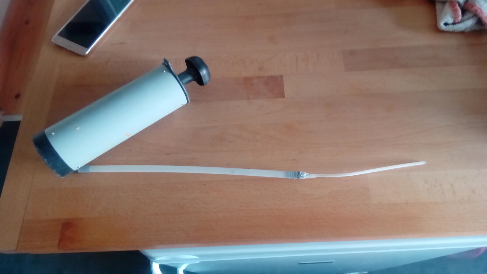

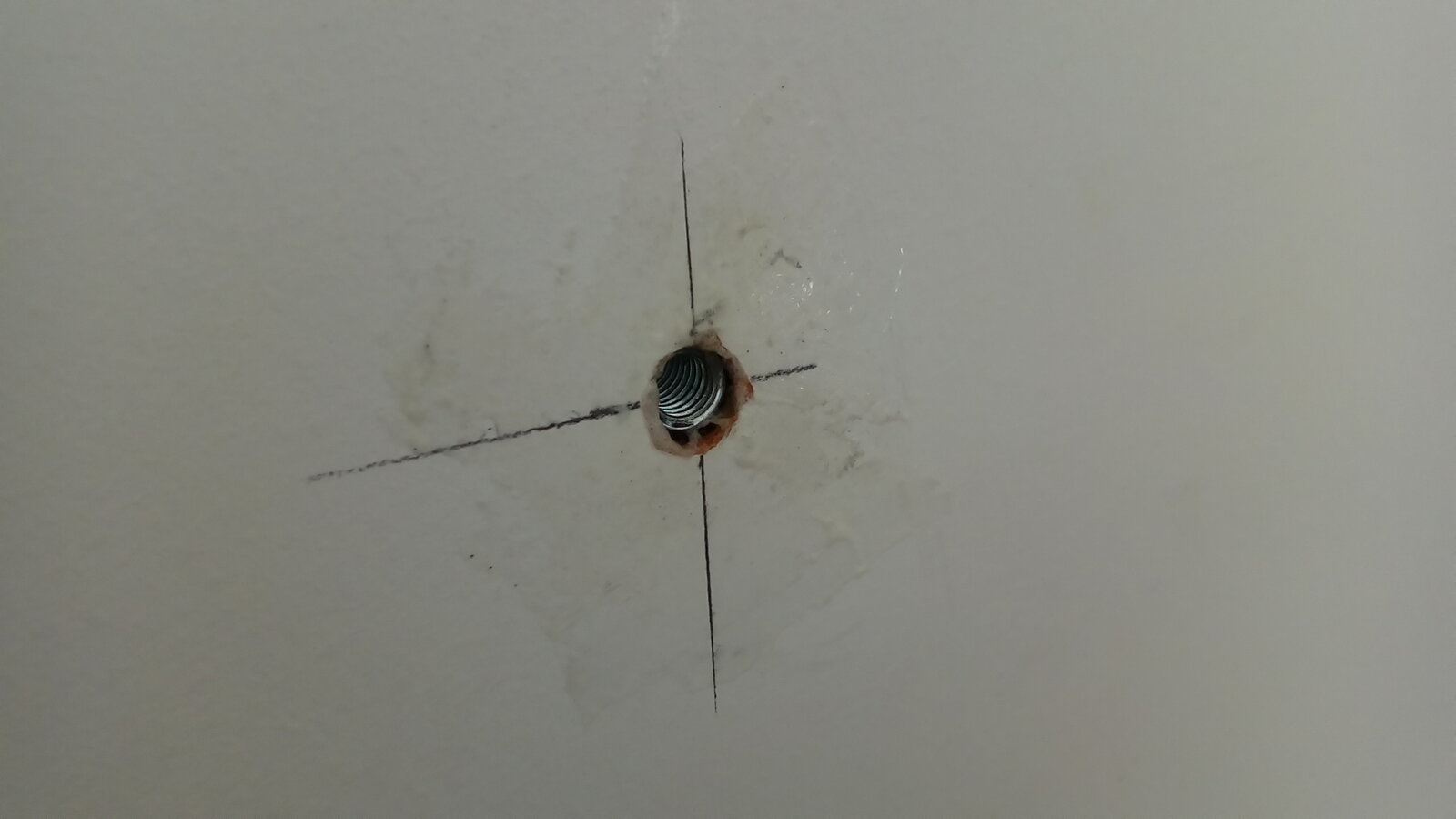

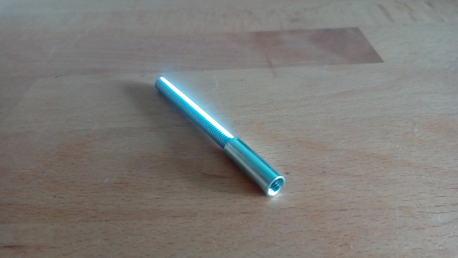

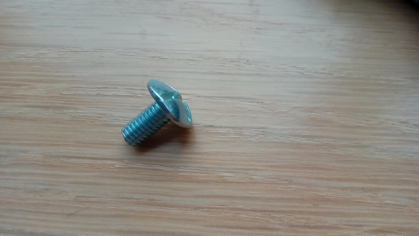

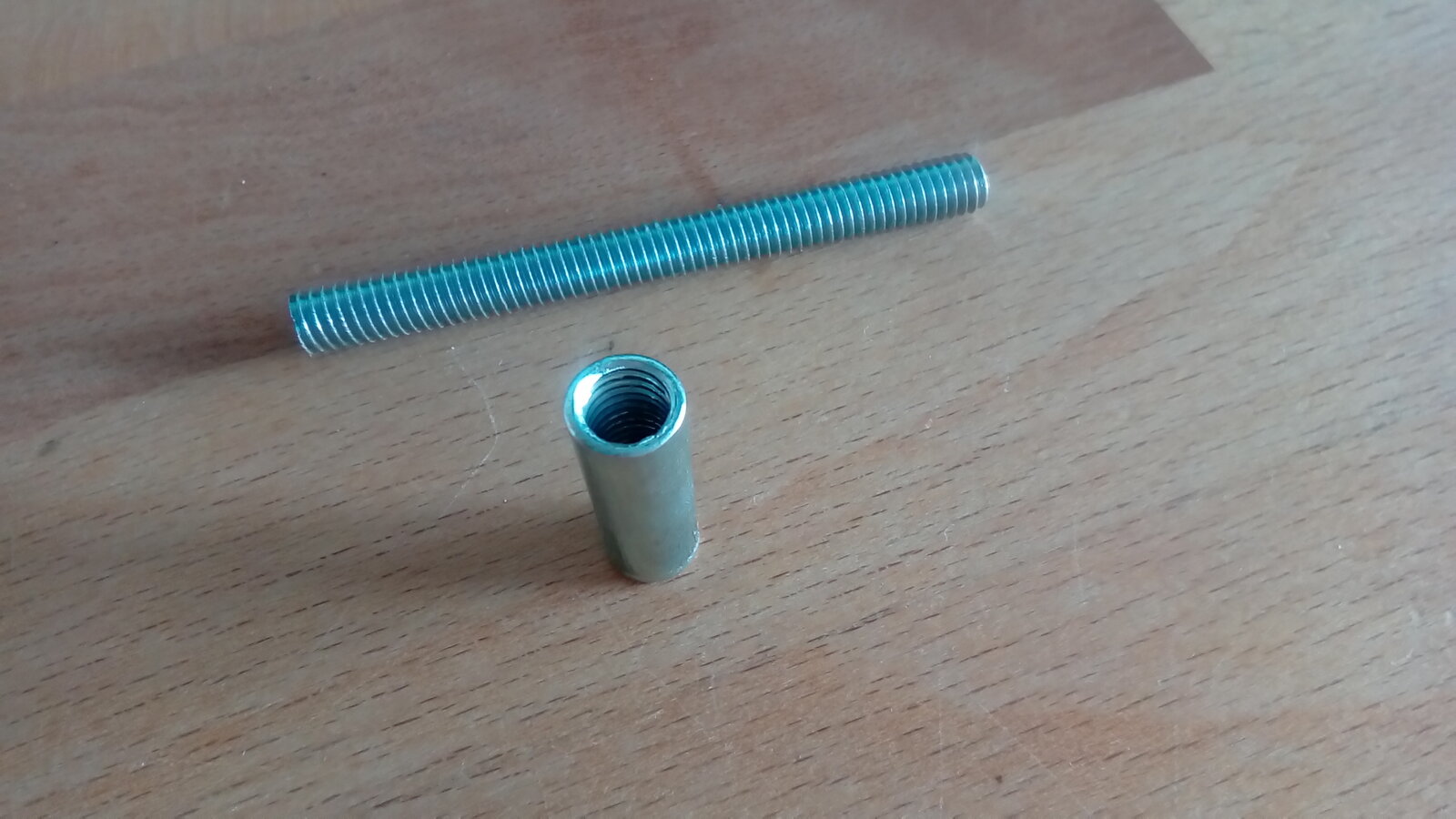

Or maybe get some M6x75mm coach bolts from wilko and cut the heads off, find M6 sleeve/joing barrels online, drill 8mm holes without using hammer. Blow the holes out. Polyurethane them in. Can be a bit messy on a painted finish, masking tape around the hole might help. Keep an eye on it for 20 minutes or so bc the expanding PU will try to push the whole thing out a few mil, and you need to push it back in.
Then I used M6x12mm roofing bolts from Wilko to secure the brackets, make sure you leave enough depth in the sleeve to take the 12mm, or you'll need to add washers.
I'm putting these in for 1200x500 type 11 radiator brackets.

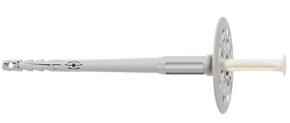

I did mention on another thread that I was sure I'd seen some long "plastic" hammer fixings with loads of fins for fixing insulation but I haven't been able to find them since, maybe it was a dream!
The concrete screws work, well but instead of drilling 6mm pilot hole like you would in brick use a 4mm bit for your pilot hole.
You weren't dreaming:
Fischer do quite a range of them (as do several other manufacturers) to fit lightweight insulation without thermal bridging - you drill a hole with an SDS drill and a long bit, push them in and set with a hammer. They are designed to work with blockwork, though, not brickwork.
