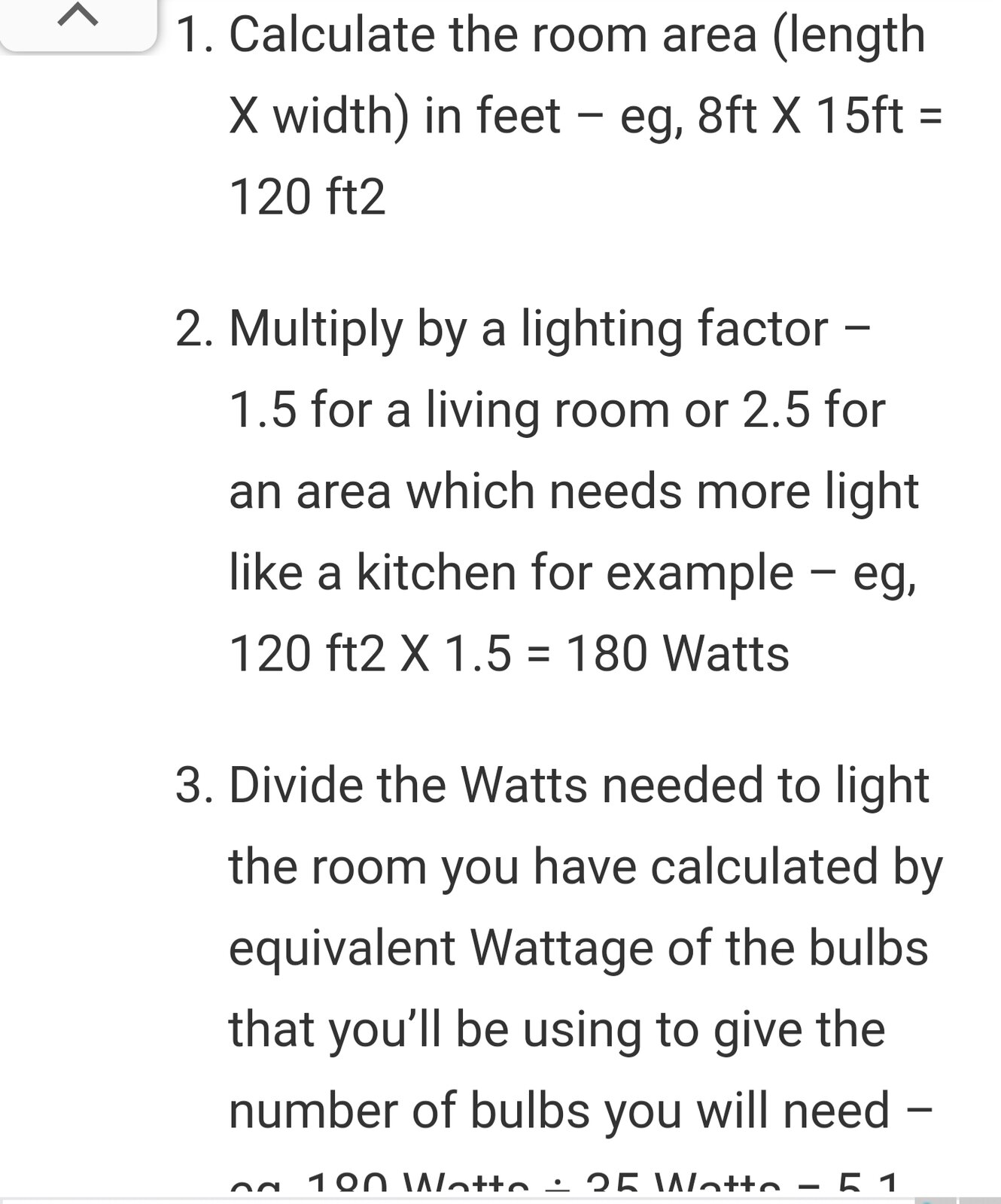

The amount of light (in lumens) required to effectively illuminate a room depends on several factors such as the needs of the user, the shape, height and size of the room and the colour of its decorations, furnishings and wall coverings.
Each lamp emits a beam of light and the spacing of these should allow for an overlap to give as even a spread of light as possible across the room.
You also need to consider where light is needed (for example, over worktops in kitchens, chairs or sofas for reading or over a bathroom sink for make up etc).
Recessed lighting should not be too close to the edges of the room or it may create shadows. I aim for around 0.8m between the walls and the centre of the fitting. The beams of light from each lamp should intersect before hitting the floor, I try to aim for 0.8m.
As for the distance between the fittings, some people divide the ceiling height by two and use that figure. But I prefer to take account of the other factors I mentioned previously.

Thanks for the replies. I also saw this, not sure if anyone has used this as a template before (see attached photo). Also whats your preferred method of making sure no joists are within minimum distance? Would you draw template hole of light and use the knocking test for the joists, or make little holes either side of light template etc? (Assuming you dont have a stud detector)
