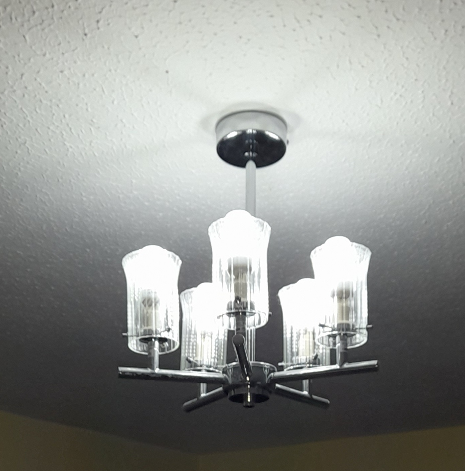

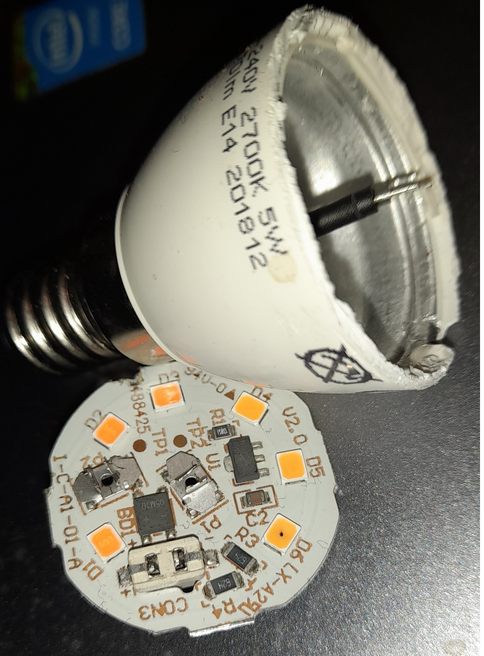

Look at an LED bulb and often the LED's inside are on a flat plate 1699933772690.png so although sold as a candle bulb, the light is projected out nearly the same as a MR16, the chandelier reflects the light off the ceiling 1699934122578.png so gives a better spread, but a simple pendent is shining down onto often a dark floor. The problem is batten fittings are often integral so when they fail the whole thing needs changing, and you can't simply alter lighting by simply changing a bulb.
