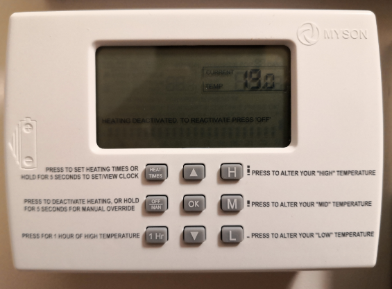

  • Downstairs radiators keep coming on by themselves, even when thermostat/programmer would indicate CH either shouldn't be on at current temp/time or programmer is deactivated but CH still comes on.
  • Upstairs rads function at the correct time/temp as per the programmer.
Tried so far...
  • I have switched the programmers around (up and downstairs, the display part of the body which contains the batteries is removable) but this does not solve the problem, downstairs still randomly comes on.
  • CH downstairs randomly comes on when the hot water programmer is off, which makes me think it's not the diverter valve stuck in position.
  • I can get the downstairs radiators to turn off by forcing the programmer to click on (audible click) then press deactivate, but if I leave it deactivated eventually it will turn on again by itself. Again, upstairs functions normally.

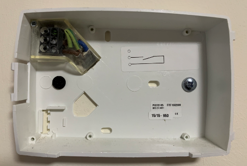

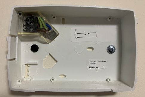

I'm a bit stumped at this point - any help is very welcome! Some pics below if that helps...
Myson Programmer and Backplate

Additionally I waited till the rads downstairs went cold and just removed the programmer from the wall and so far they have stayed cold all afternoon. Bit of a crude stop gap at least.
