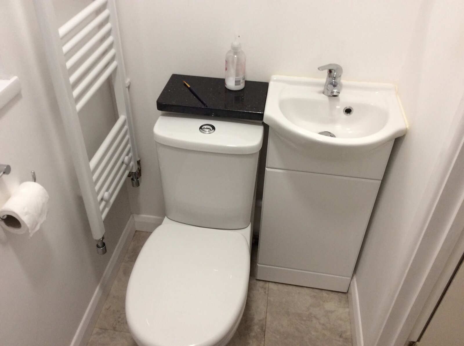

Bit of a tricky one to answer; they can be tiny, but fully functional and not feeling cramped if you buy the right gear (concealed cistern, short projection WC, compact basin, outward opening door etc) - probably 800 wide X 1500 long upwards.

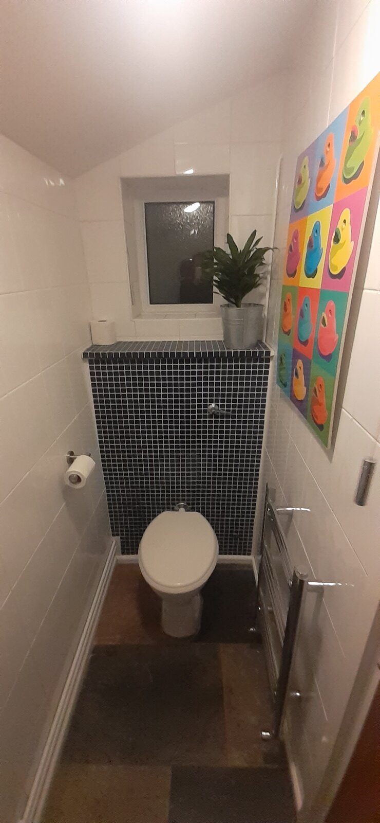

My downstairs loo is 1.7m x 850mm.
It’s ok, just don’t get a really deep sink if mounted on side walls.

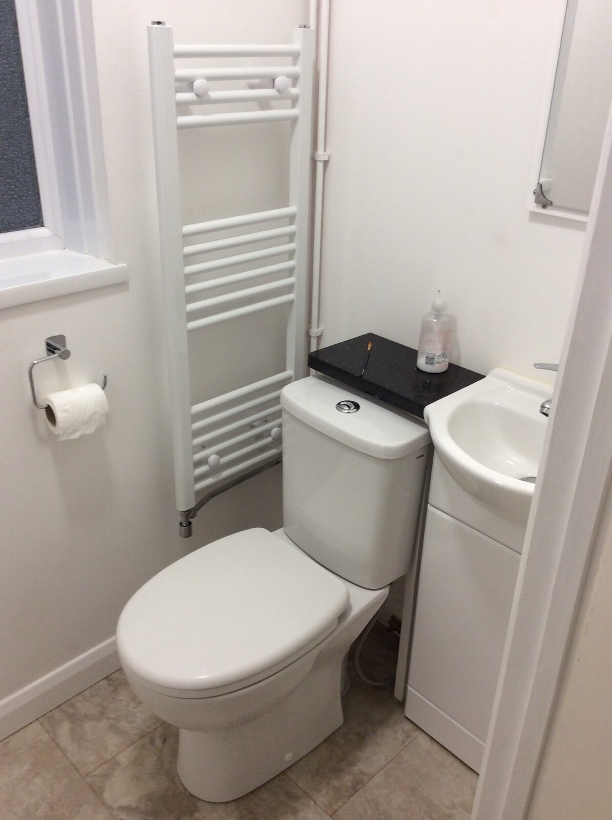

Just measured ours. It's 750 x 1900. I nicked it off of the hall so couldn't go much bigger but it's big enough.

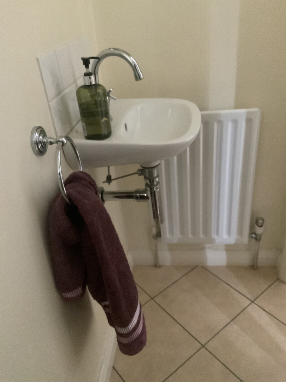

and a radiator? The wash basin could be the type which is part of the low level toilet cistern.
Side hung basin you can get a cloak in a space 1400 x 850/900. Opposite hung basin needs to be longer - say 1600/1700.

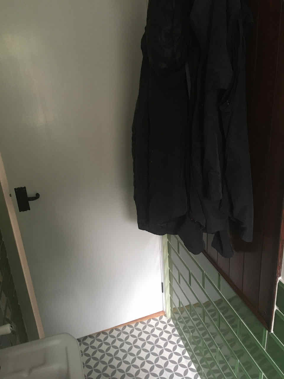

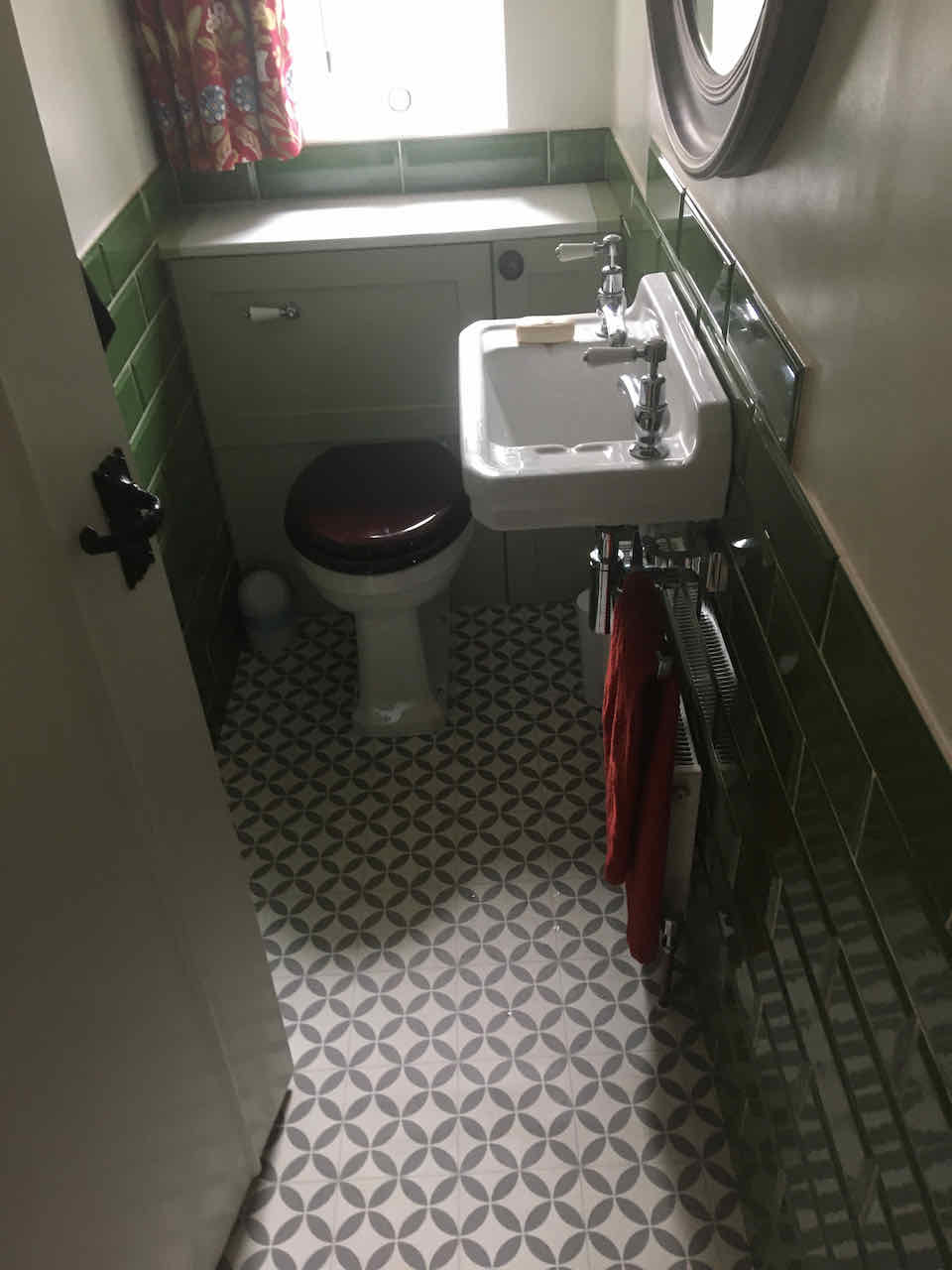

I redid out cloakroom earlier this year
its internal size is 2.1m x 0.9m
And we use as a cloakroom, and have a reasonable size basin fitted

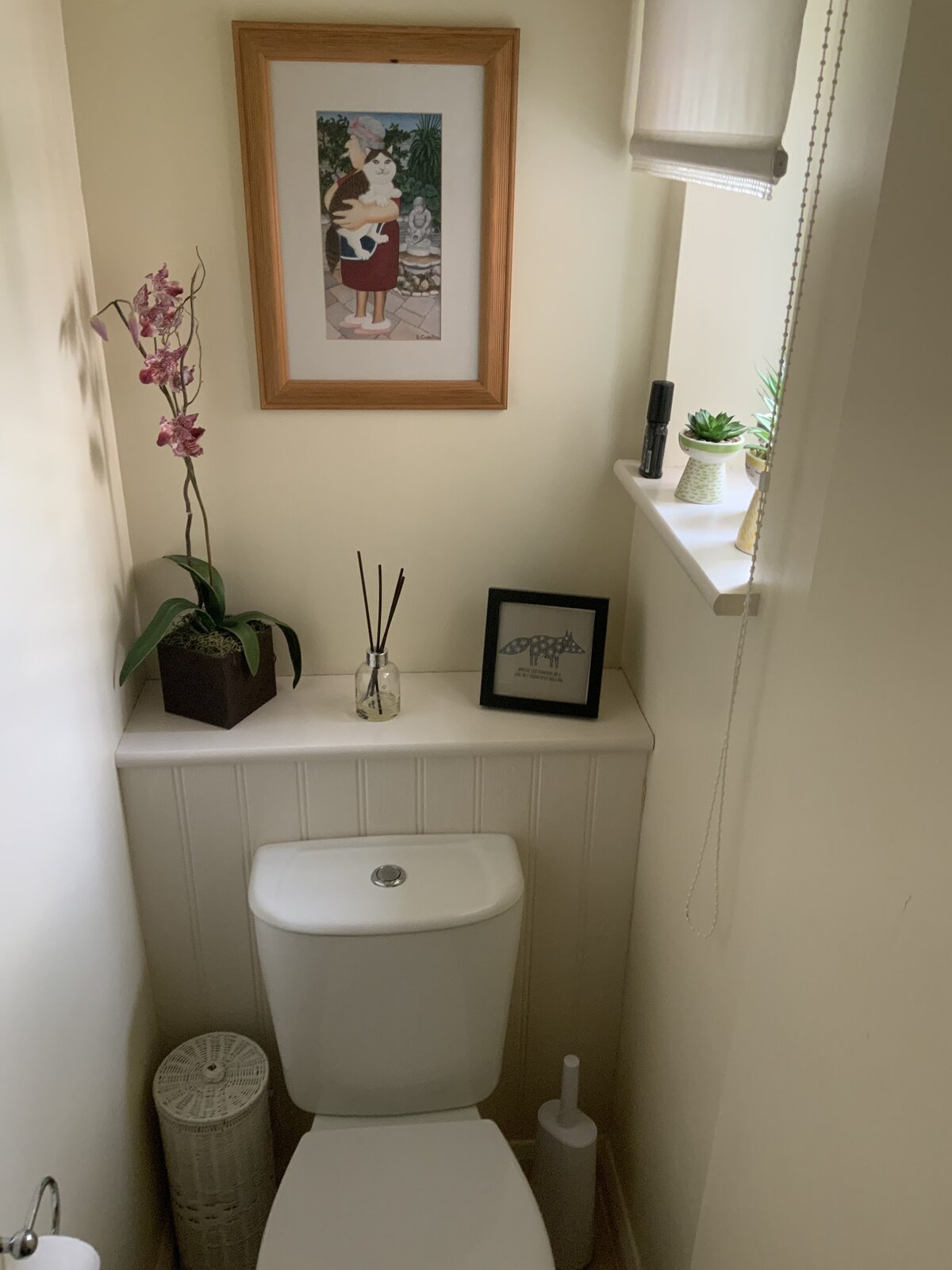

My downstairs loo is approx 1.5 m square with a reasonable washbasin and a maybe 50cm wide cabinet 6 feet tall in it. The loo is opposite the inward opening door, the basin is under the widow and next to the loo.
It’s slightly too small to include a shower unless you turned it into a wet room, which would be too much effort and expense. But worth considering if you intend to build a partition wall.

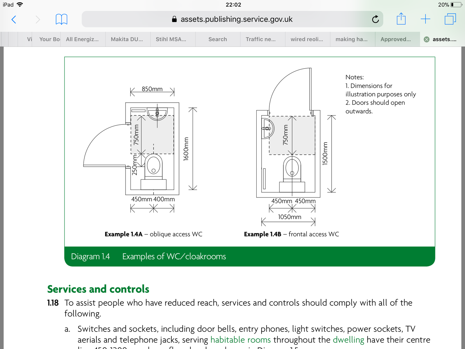

Agree on the 90cm ish for the width, but do think about where the door can go, which way to open, and whether the soil branch needs to be boxed in along a wall. Boxing in would probably need 5-10cm extra room with for the same feeling of space, and if you want the door right against the wall, that prevents you having cabinets or shelves etc "behind" the door in either room.
Ours is 90x200ish and the door opens into the middle of the toilet room, allowing plenty of space in the utility room, but we use the sink in the utility rather than a basin in the ensuite, which saves space for the boiler and fans and pipes behind the door out of the way.
Only out of interest I did have a look at part m of building regs when planning an ensuit and cloakroom .
